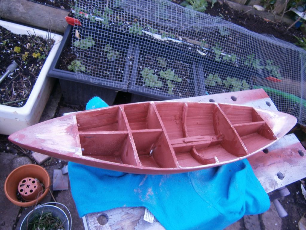

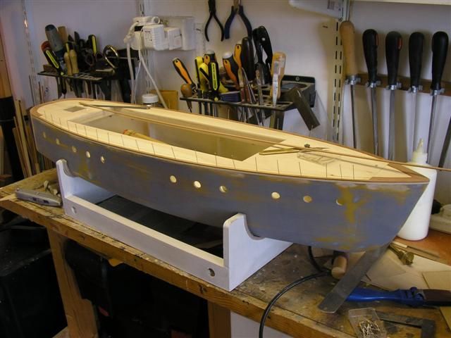

I was supposed to be building an enlarged Guardsman- and still hope to- but Veleta took my fancy and | thought I'd have a go. I was worried that the design might be too simple to stand enlargement, but I think the hull is very elegant and should look good in the water. There are photos in the albums section.
I enlarged the plan by 1.5 times giving a hull length of 36 ins, and used the construction method described on the plan, ie laminated plank bottom, sheet sides and blocks for bow and stern. This proved rather expensive in balsa and I would like to try using blue foam for the block sections on another model.
I used a product called Poly-C, which is a water based resin, in conjunction with nylon tights to toughen up the hull. I couldn't get one leg of the tights over the whole model so had to overlap from each end, creating a hump in the middle. This sanded out well with the aid of a bit of filler. A friend of mine helpfully pointed out that not many ladies have a 36in inside leg!!
For the first time I have logged the hours taken -46 hours to get to this stage. I have found this has really helped to keep focussed and in planning the process- interesting in view of the article in this months MB about maintaining impetus with a model.
