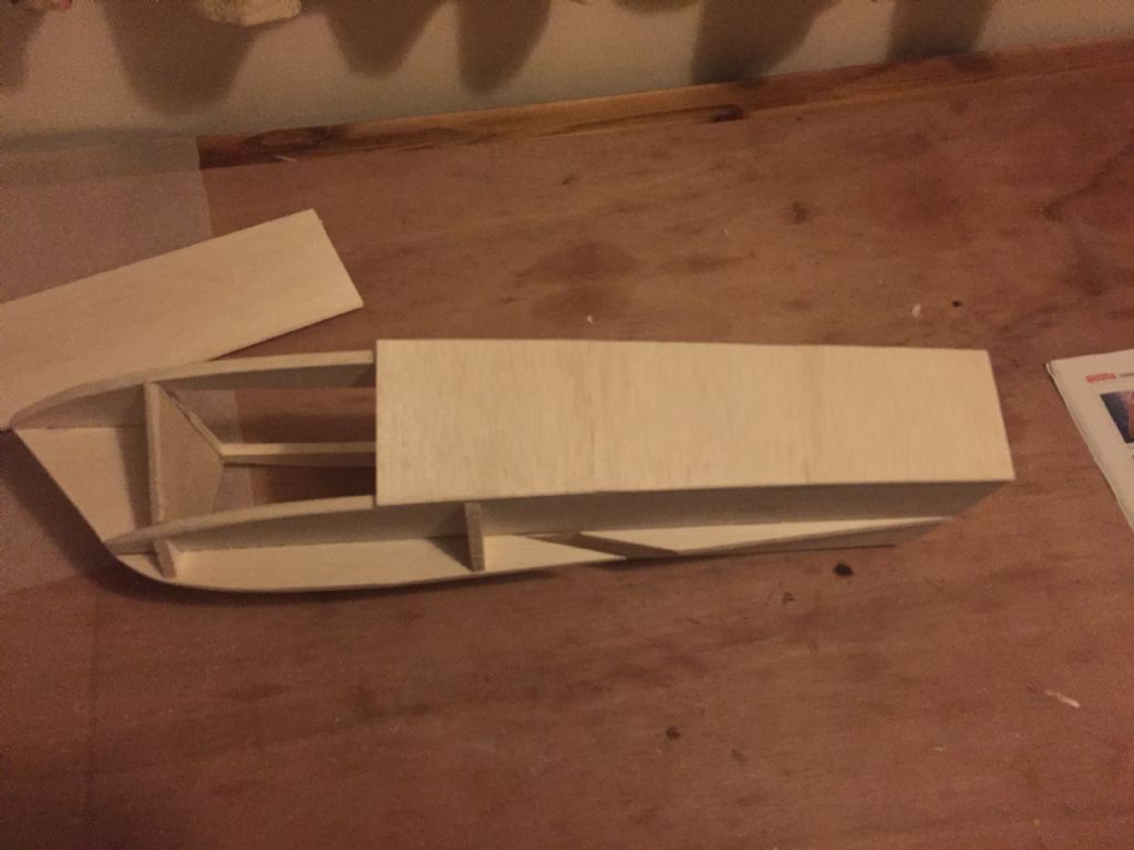

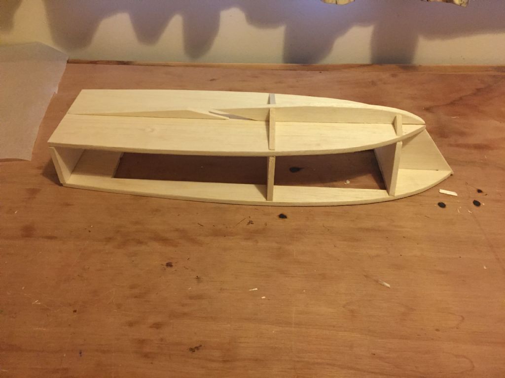

                                At last the build has started . ( about time I bet some may think ) I can see the construction will not take too long to contruct the hull at the speed it's gone this weekend with only a few hours spent on it .

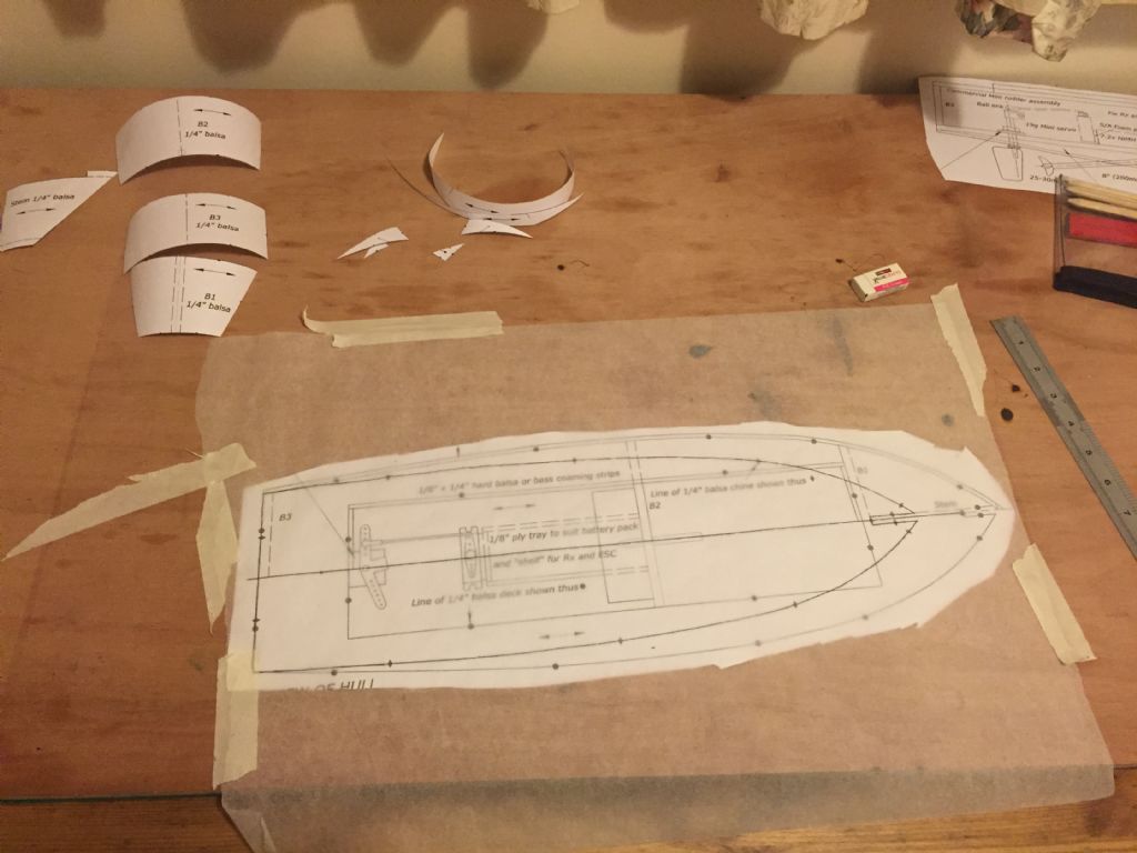

                                I found 2 decent ways to copy templates onto balsa . 1 was with prit stick and glue paper templates onto wood at cut out and peel off after and 2 tpins from slec , hold template and pin line of shape and remove pins which leaves a nice dotted line to follow . I did also tracing using grease proof paper but a steady hand is needed . I found out trying to draw around a template is not as accurate as thought if not stuck or pinned down .
                                Template cutting out and hull frame assembled and then sanded ready for sheeting .
                                Started to sheet sides of the hull . I found was easier to cut oversize glue a few sections and then sand back to desired shape / profile . So far going well .

                                  Has anyone got any tips when sheeting over the keel to chine section ? As when lay peice on what's best way to meet at keel and edges nicley ? Or just put joint sand and fill etc .

                                      Paul , I am using medium grade balsa . Sheeting the side of hull of more less complete just thinking on best approach to lay keel to chine sheets to feather or bend in ? Sand an angle on the back or cut sheets smaller and use planking method ?

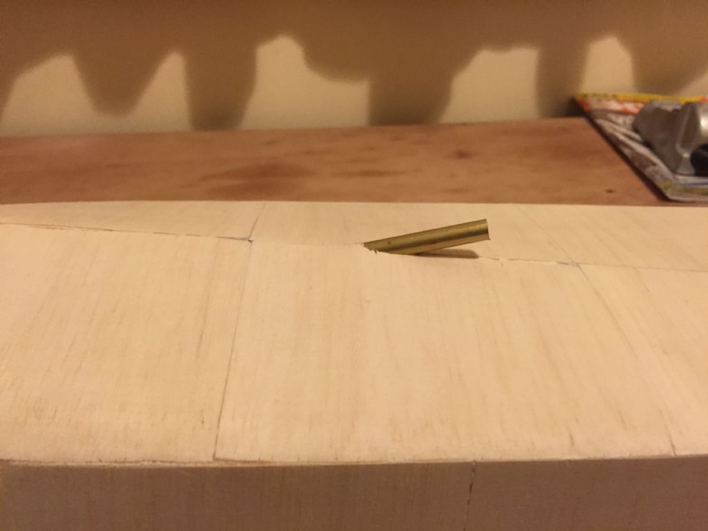

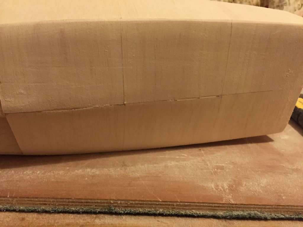

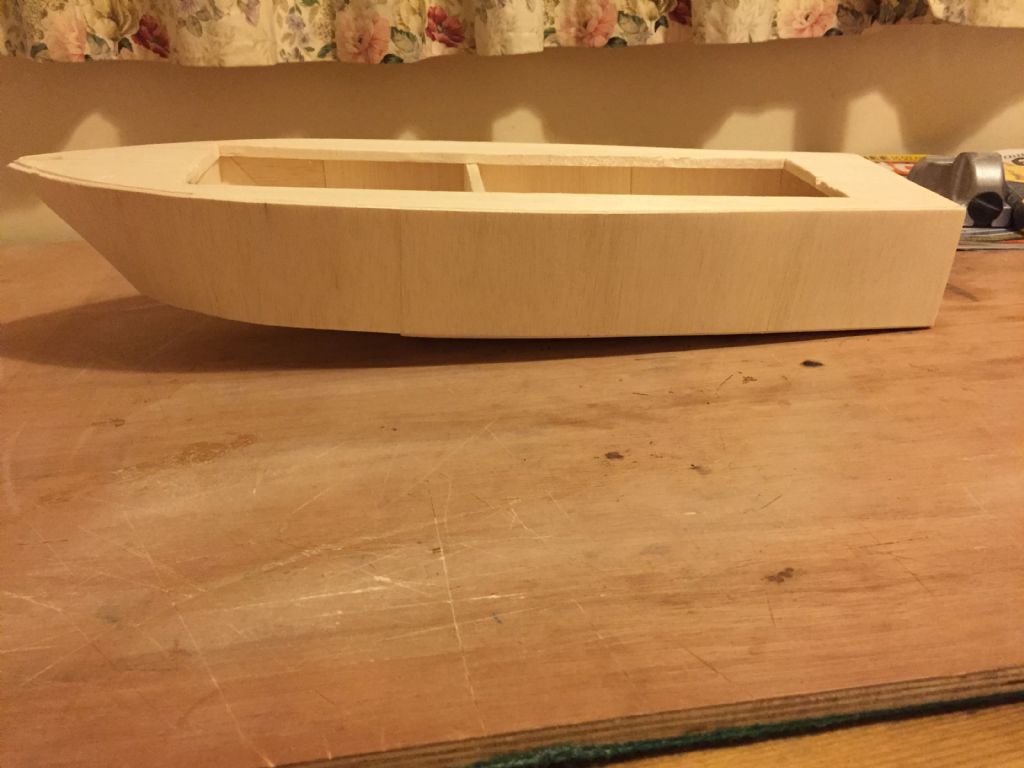

                                          A few more bits done finished sheeting hull sides and started on chine to keel . Gave a sand down to bring peices with too much material or that's too proud down to correct size and blend in . Also cut hole for prop .image.jpegimage.jpegimage.jpeg

                                            Matt. Balsa is difficult stuff to get a smooth finish on. Were you going to cover the boat with resin or what-have-you? By the looks of it you may want to use a finer sand paper to avoid more work later on (just a suggestion). Ashley

                                              Ash I'm using 240 sandpaper and not done any filling yet but il be using fibreglass and z poxy is it needed to fill all sanding marks etc in if covering with glass tissue ?
