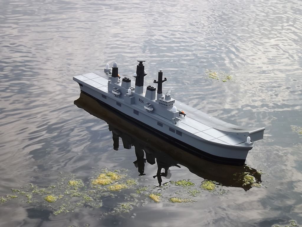

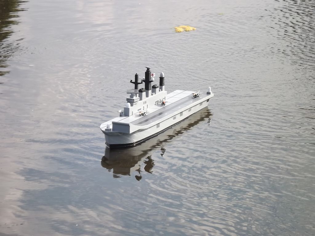

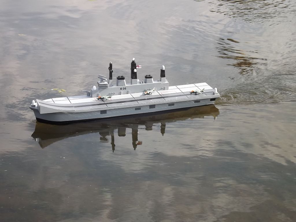

                Gahhhh!!! bombed out today.. a full quarter of the pond, and it was gathering around the conrete jetty.. was covered on that horrid bright green weed. There were clumps of it floating about and I judged it odds on that anyone out for any length of time would suffer a fouled prop.. followed by a boat driftingin the breeze to rest offshore on a weed bank. Sailed the carpet carrier for a few turns and retired.
                Speaking of which, the carrier went ok, looked quite good and was more stable (although not a GOOD test today) than I thought. The stern (see snaps) is sverely cut up to allow the rudder and prop to be on a level with the bottom of the hull (so allowing it to be carpeted even with the hull on) and the rear flat is only just below the water. This, as I surmised has allowed a modicum of air to slosh underneath and so cavitate a little bit, but not too much, and as a by-product gave a good prop wake. BUT I put the thottle on a bit and the 10A fuse blew. I have an S45 prop on there to keep the current down, it being a 10-12A sort of motor, and MFA always specified an X50 on these…SO..I need to find one of my 25A ESc`s.. the one on there is 15A, which may do the job but might be on the limit.
                It is a shame that I didnt make the under deck edge stiffeners thinner, say 1/2" square or even 3/8"..rather than 3/4", as the pronounced overhang that rather gives the game away now would be not so noiticeable..but then I didnt make it to be sailed, did I??
                carpet carrier#1
                carpet carrier#2

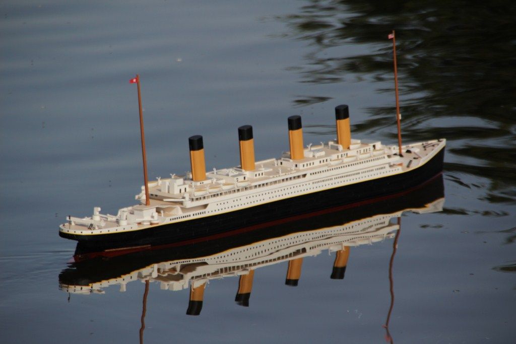

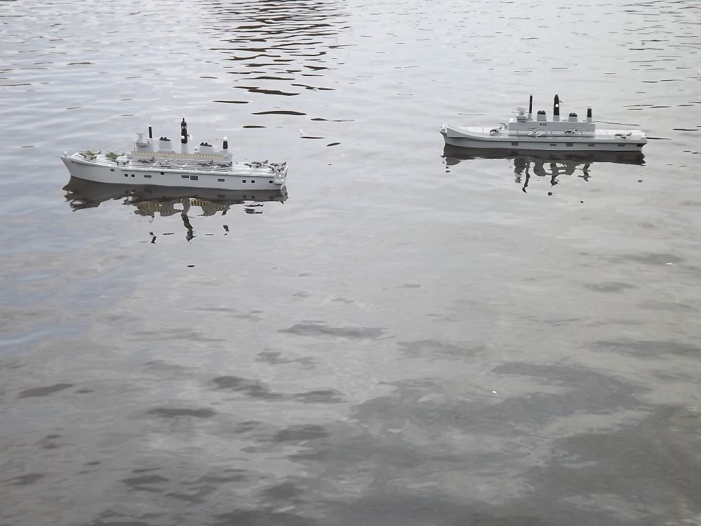

                          Fellow boaters. What a day., no weed and fabulous sun. AND a visit from our very own Colin! I knew who it was as soon as I saw the Rolls pull up. I only wish i could have a couple of good looking cheuferesses to carry my boats to the pond.
                          Colin bought down a trio of quite amazing Deans boats, one of which at least has been in the mag and one of which WILL be in the mag as a review, and for which I had the honour of twiddling the stick while pictures were being taken. I think that we may have got away with the swamping and bashing by taking pictures only on the starboard side…I hope the mud in the hull washes out ok.
                          Had rather a full car today, so that Colin could see and judge the merit of such craft as I witter on about.. Namely, The Illustious (carpet carrier), Invincible, Titanic. Nelson, Hasty and the A90 Ecranoplan.
                          The carpet carrier`s first full sailing was a success. Stability possibly better that the "proper" carrier, to the amazement of all, and adequate speed. Good bow wave, but I did end up with about a pint of water in the front two compartments due to the obvious lack of seal between the loose fitting deck and hull. Not a problem on a boat this size, anything electrical is situated at the rear and well above the bottom of the boat, rear end remained dry. I could counter this by keeping the speed down but you know how it is.
                          The Invincible now has the correct X50 props fitted and wow what a difference! The chuckability of the thing just has to be seen. It responds really well to the helm, has a bow wave you wouldnt believe and stops on an old 2 1/2 p coin. Fabulous performance (not sure what Colin thought of that, but..). However the important thing is it now stops very quickly, which it didnt do on the 3-blade plastic props. We had both of them out together at the end, something of a first, TWO carriers on the pond at once.
                          Right busy it was, Ray ,pete, Spencer, Tom and a couple more down. The grassy knoll was full of boats (mostly mine!). Colin stayed untill mid-day and said he had to go back for his roast dinner. We said it was very generous of him, but we were not sure we could do a full roast justice in this heat.

                            Yes, a very enjoyable morning and it was good to meet Ashley and his fellow modellers. When I arrived, Ashley was sailing his Titanic which I thought went down really well and I was grateful that he didn't throw me straight in th pond when I enquired which kit it was made from, it really did look that good.
                            Ashley is indeed the 'parfait modeller' being able to turn his hand to all sorts of different projects and is the only person I have ever met who has made a successful boat from hardboard. 'Less is more' is indeed his motto and he backs it up with some very practical lateral thinking. I enjoyed seeing all his boats but was particularly fascinated with his Caspian Sea Horror – sorry, Monster – which is really something out of the ordinary and performs most impressively.

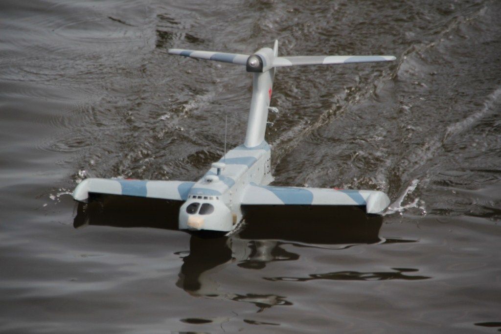

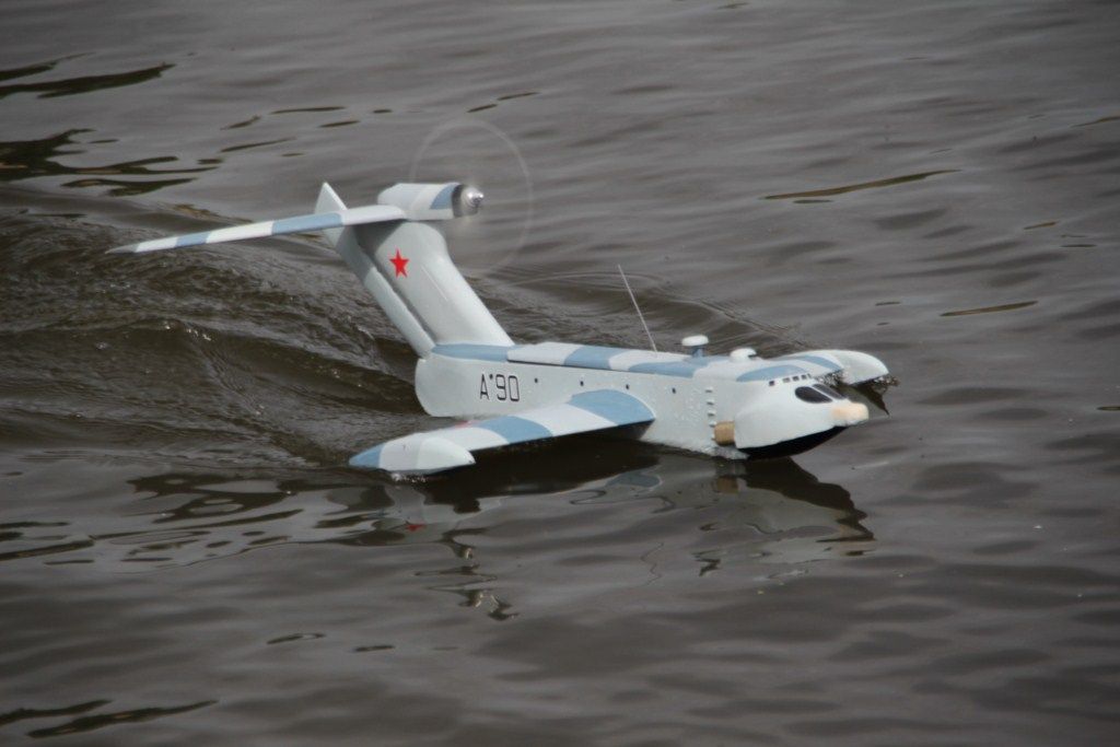

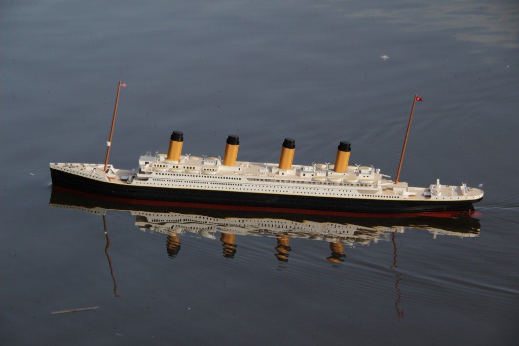

                                Ah, Colin is too kind regarding the Titanic, he should have added "at a distance", but it does show what a bit of time spent doing the windows and portholes can achieve!
                                Perfect weather for the Ecranoplan, mirror flat on the water. I still cant get over the performance difference on the Invincible. Anyone with any doubts on the effaciousness of the humble MFA 800 and and X50 prop would do well to try one.Stonking pull.
