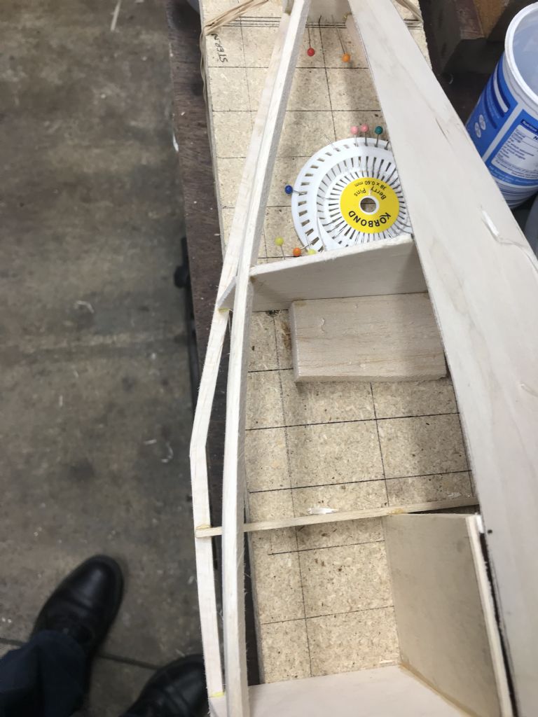

          I had one of those annoying moments during my JIF build. Bearing in mind i do not make a lot of boats and usually play with metal, i forgot how important it is to select good wood. I built the frame up and started putting the sheeting on one evening. In the morning this had happened. Luckily is was still on the building board so with a bit of careful cutting with the razor saw and knife i managed to remove the whole length and replace it.
          #84348
          Richard Barnett
            @richardbarnett67129
            Ahh Brian, if in doubt a quick warm water bath usually does the trick. Always check the wood for odd graining or knots, been caught out myself with that one.
            Ricky ye pirate 🏴‍☠️
            #84349
              Yes very annoying. Hot air gun and water handy for “on the spot “ bending at well.
              #84352
              Richard Barnett
                Getting wood to bend to the shape you want can be a pain sometimes,here are the types I have found work the best.
                Lime is one of the best, it has a nice tight grain is not too soft and when soaked will bend very nicely. Many moons ago I built some paddle wheels from Lime which I managed to bend in a full circle!
                Obechi is a very soft wood but will bend even sideways without wetting usually, ideal for handrails but needs support between fixings, also takes a wood stain really well.
                The usual hardwoods, Teak, Mahogany,Walnut etc, will all need soaking or steaming to bend well without splitting.
                Pine is only good when used in a straight run, it will bend in a gentle curve but is has a very large grain which can be hard and soft across it which can make it splinter easily depending how much you stress it.
                Balsa is everybody’s favourite, it bends well (although you do have to be gentle) cuts well, takes a Stain very well what’s not to love! Although classified as a hard wood is very soft, great to work with but not to good to bash against a jetty. A good dose of varnish will stiffen it up though.
                Hope this waffle is useful to somebody.
                Ricky ye pirate 🏴‍☠️ (sweaty palms and bent wood)

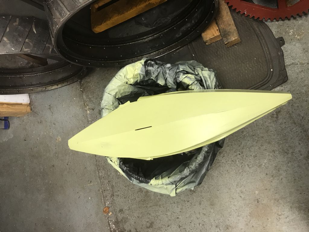

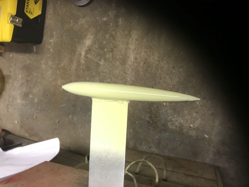

                                                Tomorrow i will be going to Wilton park to sail for the first time in three weeks. Looking forwards to enjoying a couple of hours at the lake, now all the algae has gone.
                                                Still not finished the JIF, i made the rudder and added the shaft to it, i used some 2mm SLEC control wire which i thought was 2mm but ended up being 1.7mm so it was a bit sloppy in the stern tube, doh!!!
                                                I have made another one tonight but its will not be ready for tomorrow. They must roll a 2mm thread onto the shaft which brings the o/d up to 2mm.
                                                I have used some Synthetic paint from Aldi which is a great primer builder. Cheap too.
                                                Brian
                                                #84525
                                                  Hi Brian,
                                                  Your yacht is looking good 😀 we are massive ALDI fans such practical stuff in the middle of the store.
                                                  #84531
                                                    Yes, looking good Brian.
                                                    2mm and 1.7mm…hmmm… when I made all those landing craft for our DxDay event I used those cheap 2mm propshaft/prop assemblies for economy, and they worked ok considering how cheap they are. But, the shafts rust over time without regular cleaning and degreasing, so I thought I would replace them with stainless. 50 cycle spokes St/st in 2mm later and we discover the shafts and props are 1.7mm…why are they sold as 2mm??
                                                    Fancy being so stupid as to naively believe 2mm shafts we’re actually 2mm!
                                                    I have since replaced the tubes with “fine line” ones in a 4mm shaft and they are not much different in size. Made such a difference finally having some reverse power with the pitchier 2 blade props.
                                                    Edited By ashley needham on 20/11/2019 08:26:22
