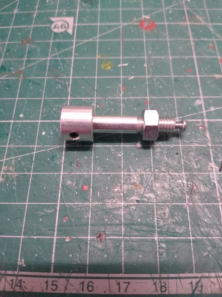

                Ashley whats that prop adapter you want for 4mm?
                #84571
                  Noel. Not sure regarding the adaptor, but the chap at SMC was very helpful and will know which one it is. As you can only fit a small prop I would err on the higher Kv spec, but not necessarily the 3000 plus ones. So saying, mine goes well on the 3700Kv turning a 5.5×3 prop. It may of course go much better on the 2600 with either a pitchier example or two props on the adaptor? In theory more blades would reduce the torquereaction (important when it starts to leave the water!)
                  I have a selection of smaller props if you want to try stuff out, the only issue is the adaptor shaft size which you have to alter on the prop using (supplied with prop) sized rings.

                    Spoke to SMC. Ordered a couple of 4mm adapters. Long one with threaded bit, and a normal one for me.

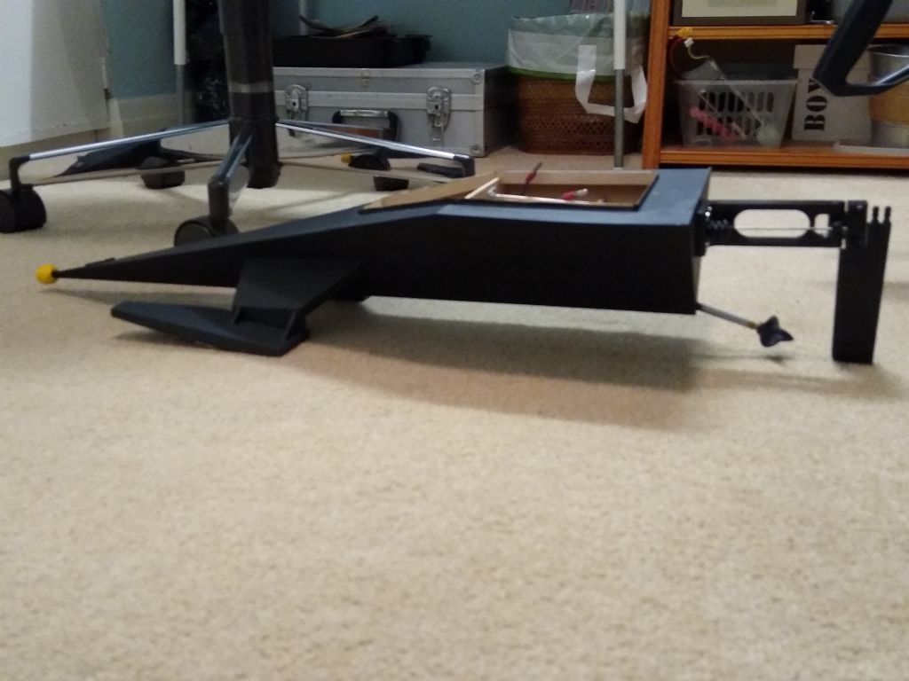

                      Hopefully it will not be raining Sunday. I may bring the Walrus down for a test float to see where the wing floats need to be set. It is all plumbed up for motor and rudder…so you never know.
                      need more paint. In theory I have three that will cover, but I don’t want to be scrubbing the last bits to eke it out. The Matt Humbrol gets that “brushed out” look if applied to thinly.
                      I am doing the lower hull half in a pale colour and the divide will be a wavy line calling for some artistic brushwork. Underneath the wings I also wished I had smoothed off a bit more as the brush needs to be scrubbed a bit to colour adequately, however the finish here is not so critical.
                      I also want to get a pair of 7×4 props to double up on, as the motor was drawing 18A on twin 7×5, which is probably a touch high on a 160 watt motor on 3s. 167 watts was being shown on the wattmeter, but does that actually mean the motor was developing 167. Watt? Not sure.
                      Hobbies Hydro on Sunday as I have a three blade 7×4 prop now and want to try it out. Hopefully the torque reaction will lessen a bit (another question mark!).

                            Boating marred by fun run and the stuffed car park!
                            tried three. Blade 7×4 prop on Hobbies hydro with no discernable difference to the 7×3 prop,
                            Walrus good first outing and showed me what needs to be done to the bottom. At one point is must have hit a small wave and it showed signs of taking off….
                            Trevor’s yellow peril running very smoothly, appears to need some work to counter torque roll.
                            Devils toothpick fast but overturned, and had to be expensively rescued by a lander. A few mods also identified for this.
                            Lastly Woody rower going well barring the steering servo which goes a bit intermittent and may need an operation (servodectomy).

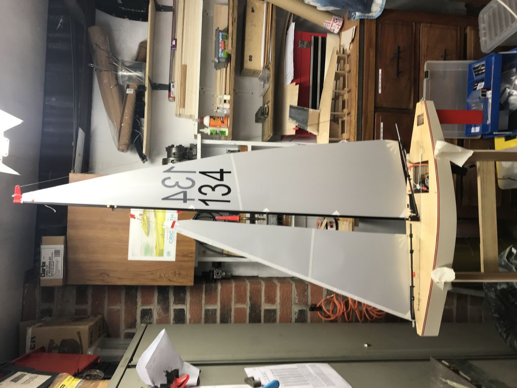

                                Boiler Bri
                                  @boilerbri
                                  Jif ready for the water. 🤔

                                    Brian. That's very tidy indeed! A yacht does not look like a yacht until the masts/sails are on. I presume you have hatch covers somewhere?? Like the colour, a nice pale almost woody colour.
                                    Have been busy with foam, glue, knife and sanding block and produced a set of under hull chine-y bits, and if I say so myself they look jolly good…or at least, I was unsure as how good they WOULD look.
                                    Epoxied in place but not sealed yet as I may want to sand some off after trials, and hardening the surface makes sanding off bits and blending it all in difficult.
                                    I often wonder if anyone has copied any of the weird things I/we make at the pond? Someone said why not produce plans for some of your stuff, but to be honest most of it would read "shape to suit" "blend in" "bend to fit" and so on, combined with any amount of "artistic" modelling, and a plan person presumably wants to simply cut bits out, stick and fill as necessary???
                                    Testing of the Walrus was done with a 3s Lipo but if these mods deliver the goods it may be a 2s is all that's needed.
                                    Off to Addlestone models Friday to get MORE props and paint etc.

                                    Noel
                                      @noel26080
                                      Ashley, heres yer prop adapter:

                                        Boiler Bri
                                          @boilerbri
                                          A member of the rofwacs club made them for me.
                                          finished her off tonight and tomorrow she goes on the water.
                                          Most club members tape flat hatches on so I am going with that.
                                          I will let you all know how I get on 🍺🤔

                                                    Boiler Bri
                                                      @boilerbri
                                                      I got to the lake early as the Jif was out for the first time. You know how it is -better check it before everyone arrives.
                                                      now I am no expert but in light winds it was pretty nippy so captain Bri was happy.
                                                      turn up the experts. Yes nice boat Bri but let’s set it up for you you need to tweak this bend that re adjust the other💥 it sailed worse after they had finished 💨🙄. Now I am not competitive but they are and I just wonder if they have done me a favour or had me up the lagoon🤔
                                                      I was retry chuffed though as it did not sink😂
