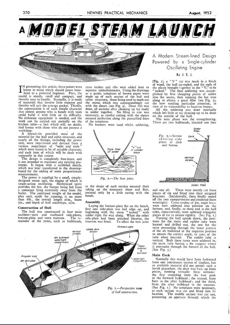

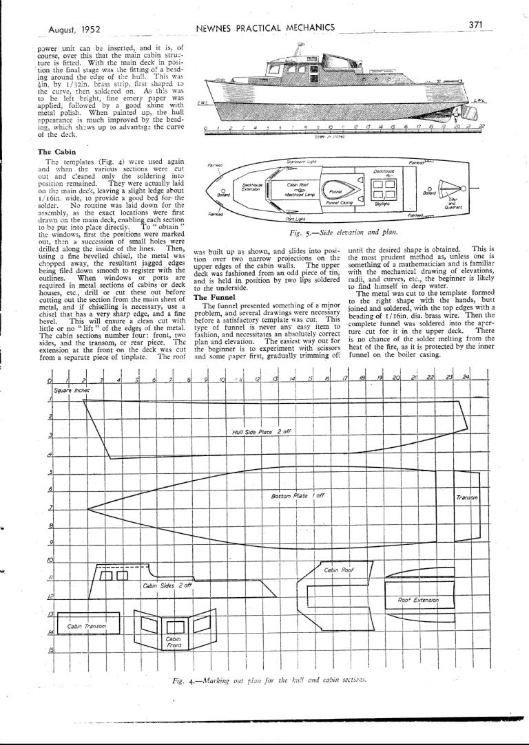

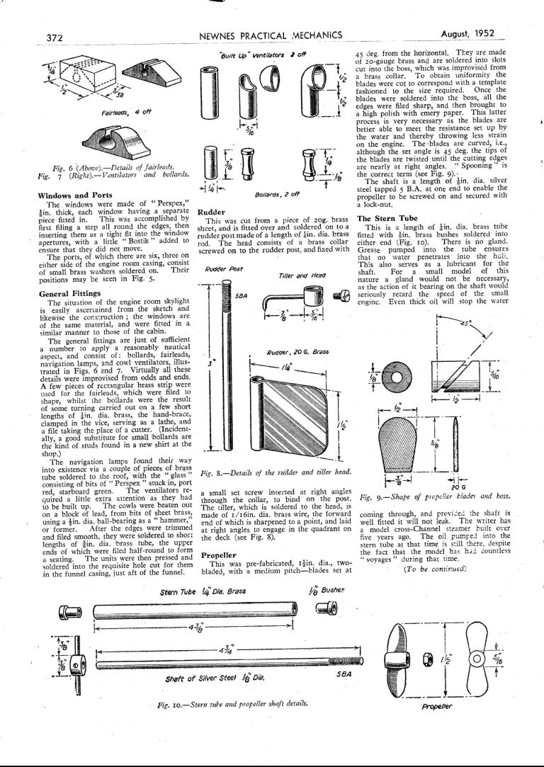

              Vanesa, a 22" tinplate design by J.E.Jane, from Practical Mechanics, August 1952. Also a larger 36" version available. They were designed for steam, either oscilator or turbine. The steam version was also in Model Boats magazine, January 1969.
              If any further information would be useful, it would be best emailed, just too much for a forum post.
