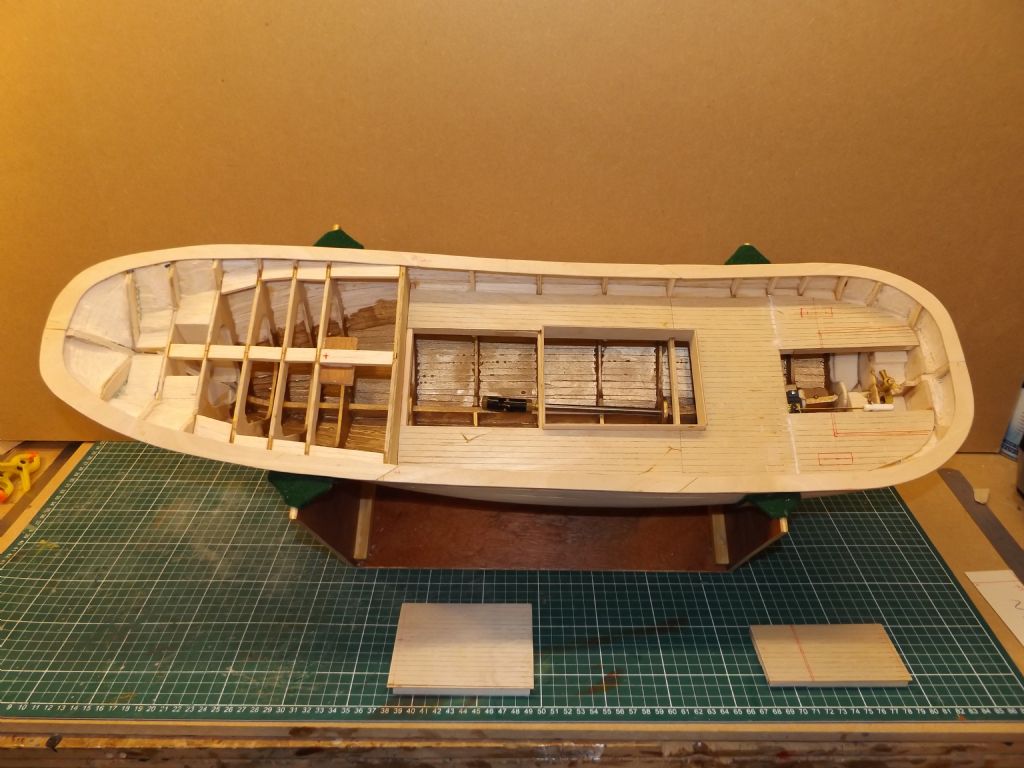

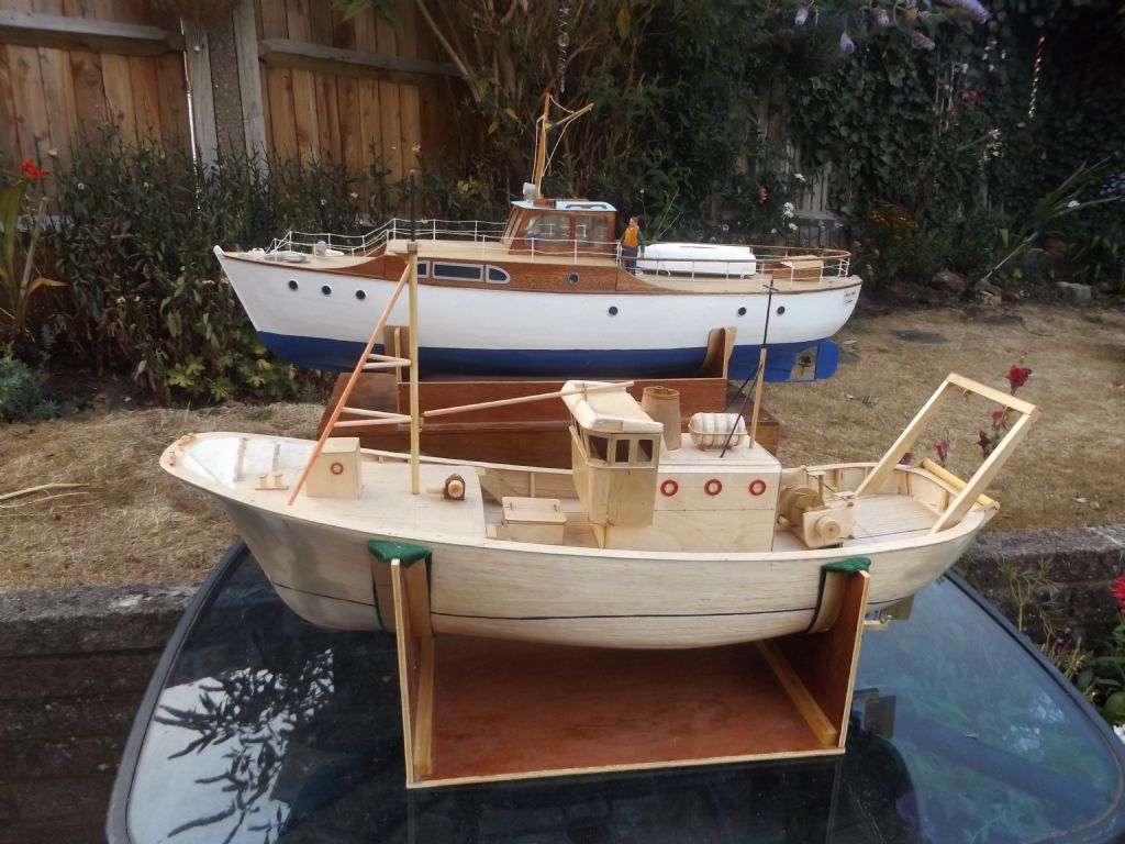

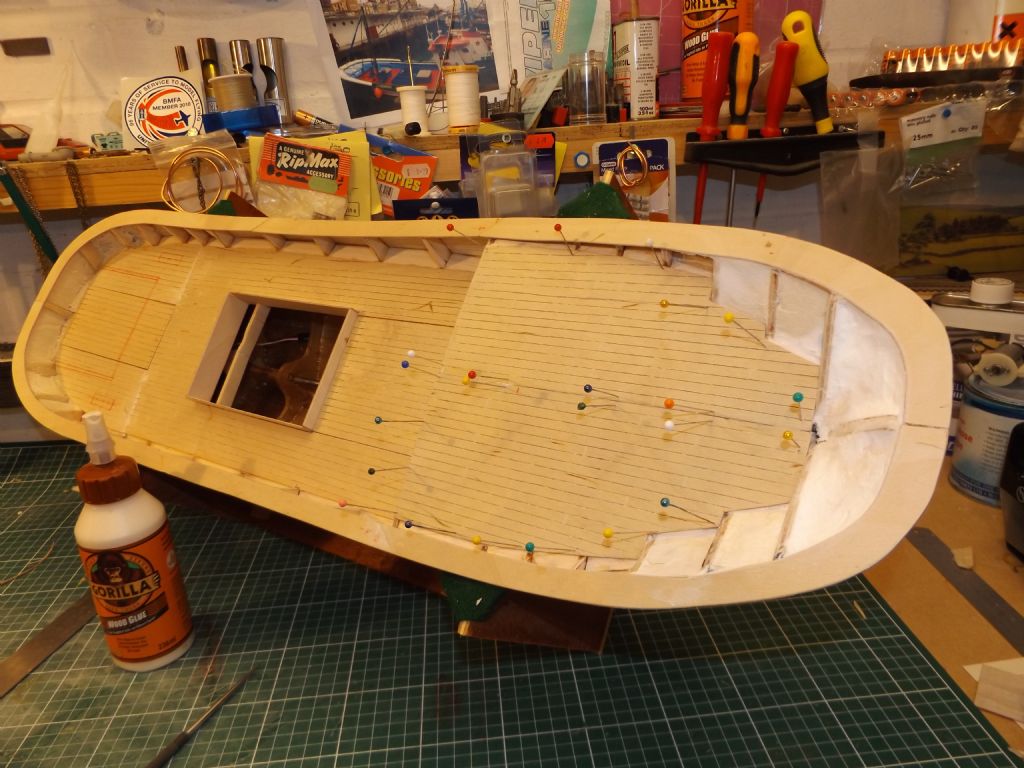

            sfb120318 005.jpgsfb120318 002.jpgHi All,
            Major milestone achieved this weekend as the weather not conducive to much else, deck and access hatches made and fitted, deck from 1/32" ply with planks formed on the surface with 3 pass's of a metal working scriber, just enough to show the inner lamination, but as the decks will be painted should break up the look, sanding sealer next, painted the bilges gold very posh !sfb120318 004.jpg. The front bulkwarks not too clever as I used soft balsa block hollowed out and filled, just the superstructure, winch, trawling gallows and fittings to get on with

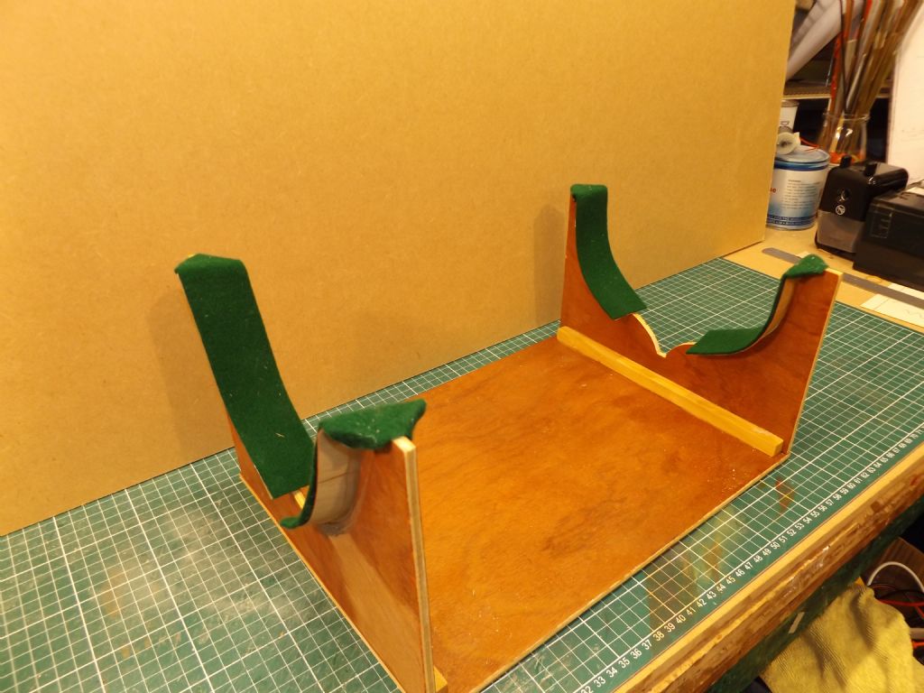

            Eddie the stand now has it's felt lining

              There's a lot of thought and work gone into that decking etc.It looks good, a very 'pretty' hull even though it's a working boat, the full size that is. I have just made the stand for the pond yacht, I will finish it as you have done, I will also fit out the stand for Ardent, as your idea will spread the load across the hull instead of all the weight resting on the thin sides of the stand.

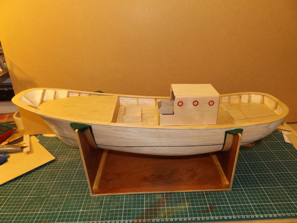

                        On with the deckhouse lower section 1/16" ply which fits over the ply upstand, with Aldi fibre washers for portlights. The bridge will be the next unit to build, and loads of window openings and frames to cut. Waterline marked to ensure superstructure is plumb.

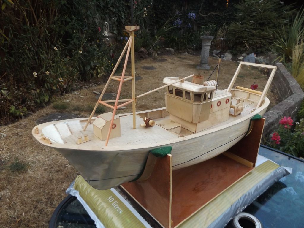

                          The SFB has had a break in construction for a few weeks, good to change projects occasionally, now we are sporting a small funnel and the trawling gallows at the stern, next big project is the winch
                          Cheap £5.00 kites from ALDI great source of GRP/Carbon rods for masts etc

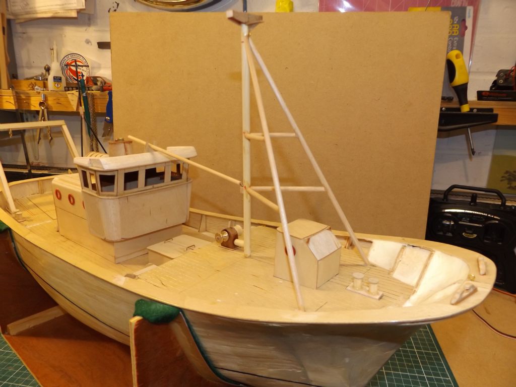

                            #78103

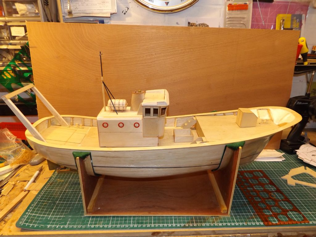

                              sfbjuly2.jpgHi All
                              The fishing boat has been on the shelf for a while, so on we go with the mast, and fittings

                                  #78183

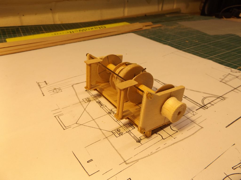

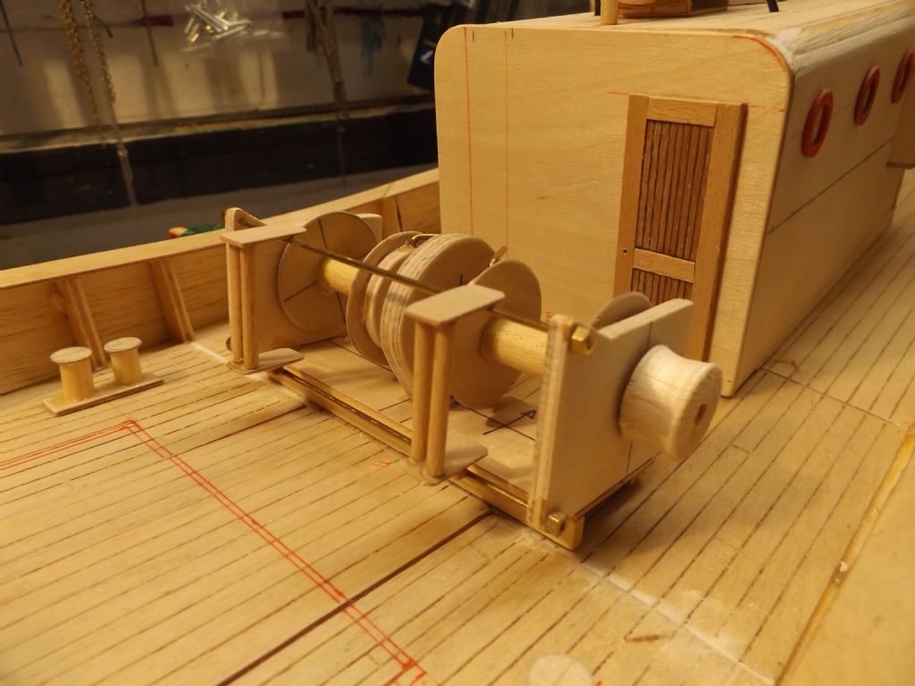

                                    sfbjuly2winch.jpgHi All,
                                    The main winch had been a major milestone in my mind, should I fabricate it in brass? but settled for wood as it only has to look right not actuallysfbjuly3winch.jpg work, so ply, dowel and balsa has done the job

                                      #78211

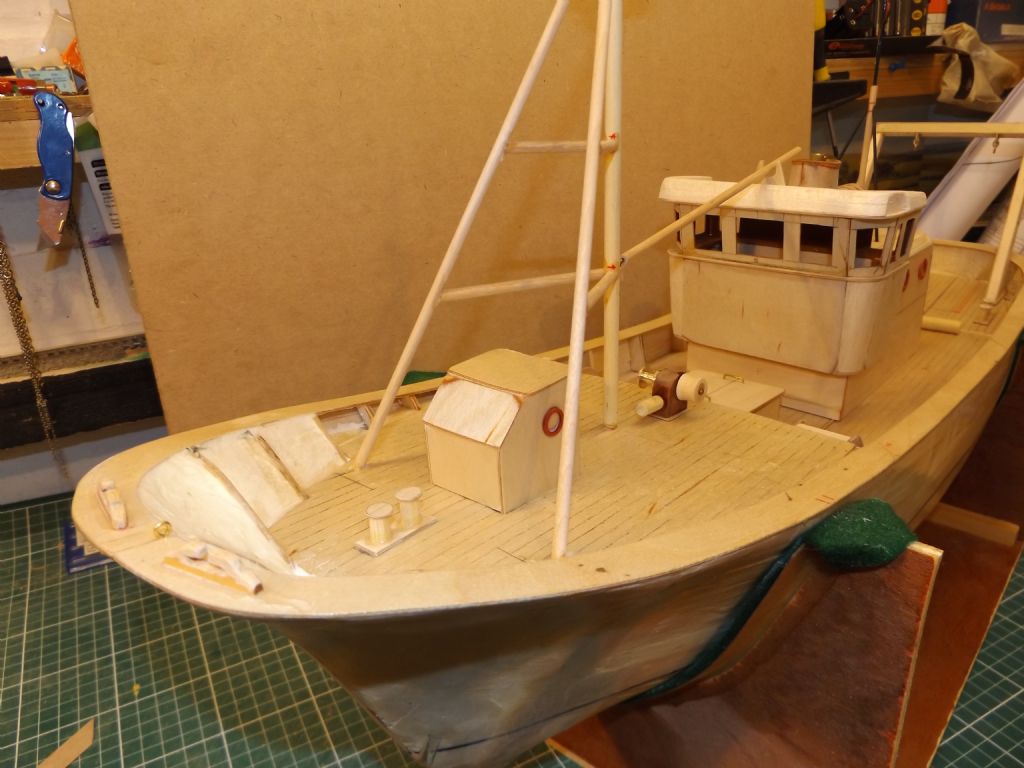

                                        sfbjuly4.jpgHi All,
                                        Last pictures of SFB in the wood, primer spray cans at the ready, she has 2 coats of sanding sealer already,
                                        Mrs Wood who commissioned the build is happy with it, but asked if it could be half that size!!

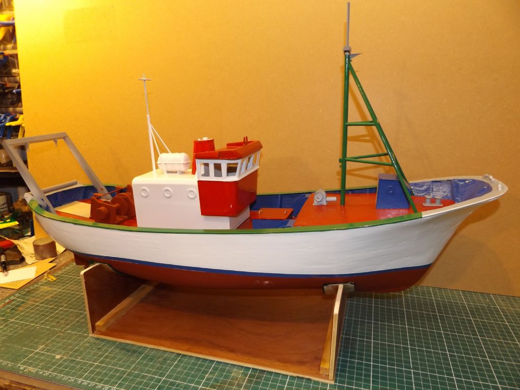

                                        #78895

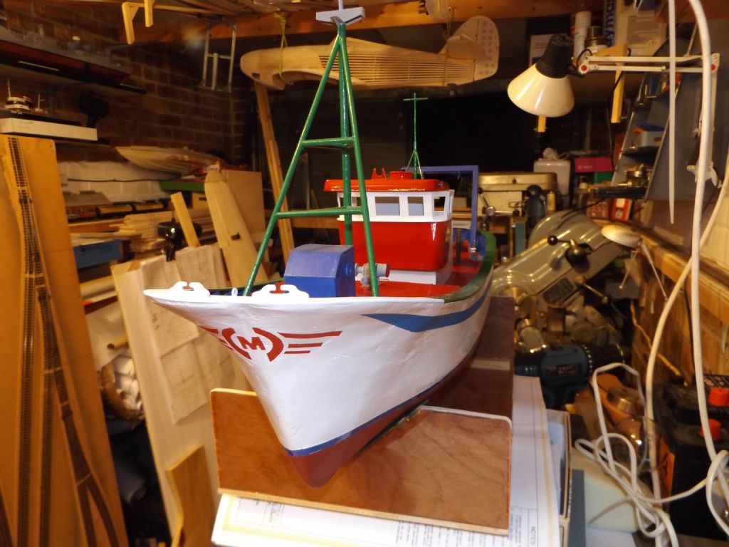

                                          Hi All
                                          Just an update on the Fishing Boat for my wife, who has asked if it could be smaller!! Lesson learned on this balsa planked & block hull is do not rely on 4 coats of sanding sealer as a base for paint, It cracks & crazes like mad, I should have glass clothed the hull but as It's going to be an ornament most of the time I didn't bother ! lesson learned many more colours to go.

                                          Eddie Lancaster
                                            @eddielancaster
                                            Hi. Ray, what a lovely boat, nice shape and colourful and just a hint of planking, you must be pleased with that, well donesmiley.
                                            Do you think the acrylic paint attacked the sanding sealer or was there some solvent left from the sealer to attack the top coats?
                                            I was thinking of using the same technique for the deck of my TSB but I will have to rethink that now.
                                            Eddie.
                                            #78911
                                              Hi Eddie
                                              The sanding sealer cracked up before I sprayed the hull, I think too many coats was to blame, perhaps the clue is in the name ? I've never had a problem on plywood, Veronica's deck is only sprayed with grey primer, now 4 years on its beginning to wear slightly. PS booklet in the post this weekend
                                              The fishing boats ply deck is fine only 2 coats.

                                                #80274
                                                  My fishing boat build is progressing slowly, my wife was more interested in me finishing the bathroom than finishing her boat for the lounge! but it will be nice to have a new boat in the water in 2019 Slight distraction in the back ground Hurricane
