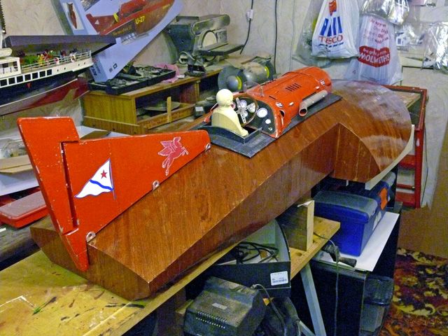

          #24245
            Due to the over zealous use of the orbital power sander and the veneer being only 0.022″ thick………The veneer was wafer thin in parts!……………and little ugly swellings appeared after the initial coat of varnish
            Problem sorted!……..The lump was sliced with the grain and PVA rubbed in, followed by the weighted string clamp and wood blocks
            Fingers crossed…………..Bob

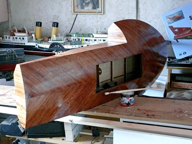

                                        Another work in progress picture…………….( Yawn, Yawn )
                                        Varnishing the sides and end walls…………………Bob
