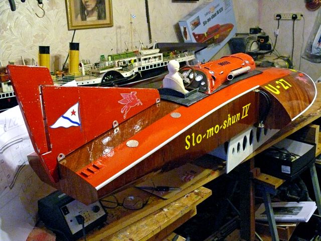

      Making progress with the lettering
      The letters were made by scanning the kit transfer sheet, doubling up on the PC, printing out on glossy paper, cutting each letter out…..painting them with acrylic and glueing them on with PVA and final varnishing…….a long process, but it`s worth it!

        It looks absolutelystunning Bob ! Remind me how long is this monster
        #24618
          Thank you Phil
          It`s only 1.5m long x 600 wide…….Not as long as GE but it really is a monster!

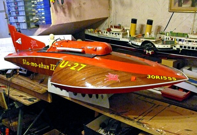

              The undersurface………..I was told by a speedboat expert, that a few “daggers” may be required, to prevent sideslip?
              Should be fun!………Bob

                He’s probably right Bob there’s not a lot in the water once she’s on the plane. But then at that speed I’m guessing she’s designed for straight lines only, or were these raced on a curcuit? Also I would have thought lots of wax polish might be a good idea here! Make her a slippery as possible

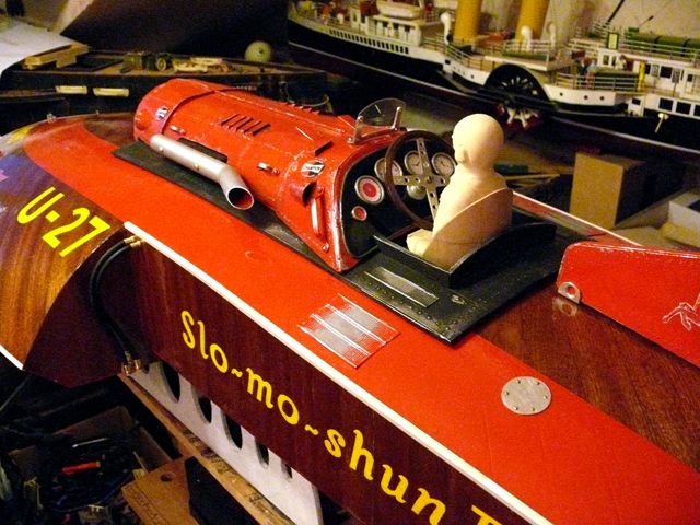

                        Work in progress picture

                          WOW looking the business Bob. The thinking behind the wax polish idea is, when a boat moves through the water the water molecules touching the hull are as it were stuck to it and the drag is caused by the rub between the molecules not adhered and those that are this action incidently works like an aircraft wing inreverse holding the hull down. now wax is hrdrophobic and repels the water stopping (hopefully) the molecules from adhereing to the hull allowing it to slide more easily. well thats my theory anyway. Pretty sure I’ve opened a can of worms here lol
