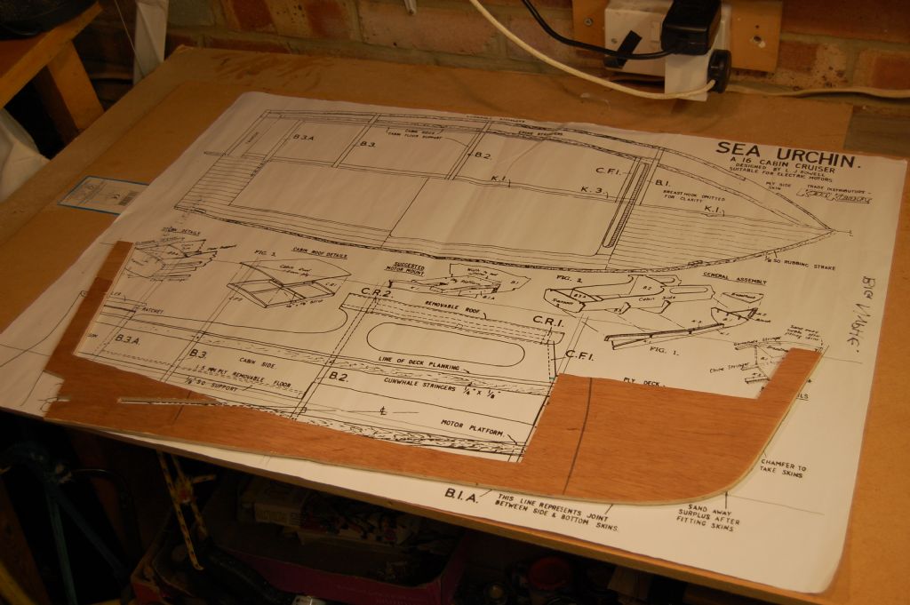

      su 1a 210722.jpgHi All,
      Well you all must know I'm nostalgic about the Aerokits designs and being the first one I attempted to build back in 1966 I thought it was time to build a slightly bigger version, the original was 16" long and the baby of the fleet, bit of a fiddle to build with 1/16" ply sides and bottom !! Plus in the 60's there was little in the way of Health & Safety (we were tough) so it was put together with Aerolite 306 wood glue and acid hardener , and it didn't half sting
      Well with the plan and elevation blown up to 28" LOA I have drafted the bulkheads and away we go, just waiting for some ply from SLEC.

        #101341
          @timrowe83142
          Hi Ray
          I have already bought shares in SLEC.
          Tell me what paints you are using and I will buy shares with them too! smiley
          Tim R

            Hi Ray
            Yes, 28" a lot better size and will make it a lot easier build !!!
            I resized the plan to 915mm, but, too many other projects to do first.
            Two Spearfish, a Slo-Mo-Shun, Bugsier Tug, Aeronaut Spitfire and two other unknown ones.
            A nice cold 14C today, but, it's Winter down under !!!!!!

              Hello Tim,
              I try to use Humbrol oil base enamels, but they are in the process of re-formulating their paints and if it goes acrylic water based I won't be using it, doesn't seem right on a boat somehow
              So for basic colours like white I may invest in some International Yacht enamel, I know Chris has bought some for the Faireys .
              Harry,
              We wouldn't mind some winter here it was 39 deg's here on Tuesday !! I think I'm using the drawing you pdf'd me a while back many thanks

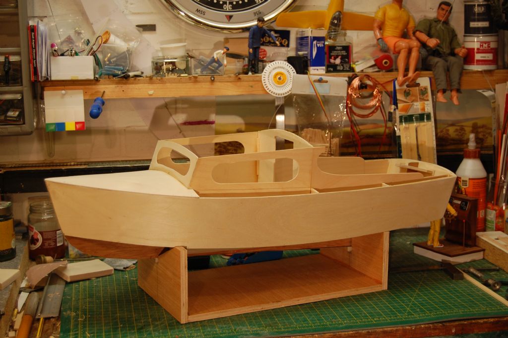

                #101465
                  Well the Urchin is progressing with 1/32" ply bottom panels, templated on a sheet of cartridge paper, I'm moving away from brass pins these days to steel veneer pins to hold things in place then taken out & P38 filled, I will be usingse 2 280722.jpg 1/16" for the side skins to make her tough as this one is destined for a grandson at some stage

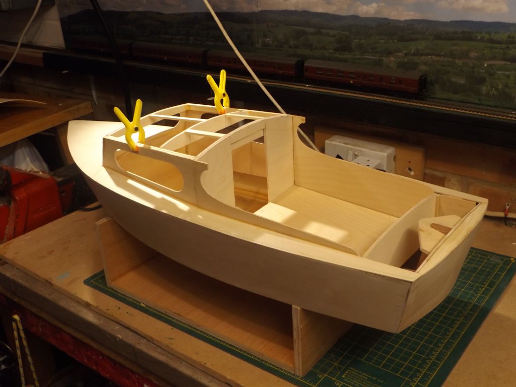

                    #101515

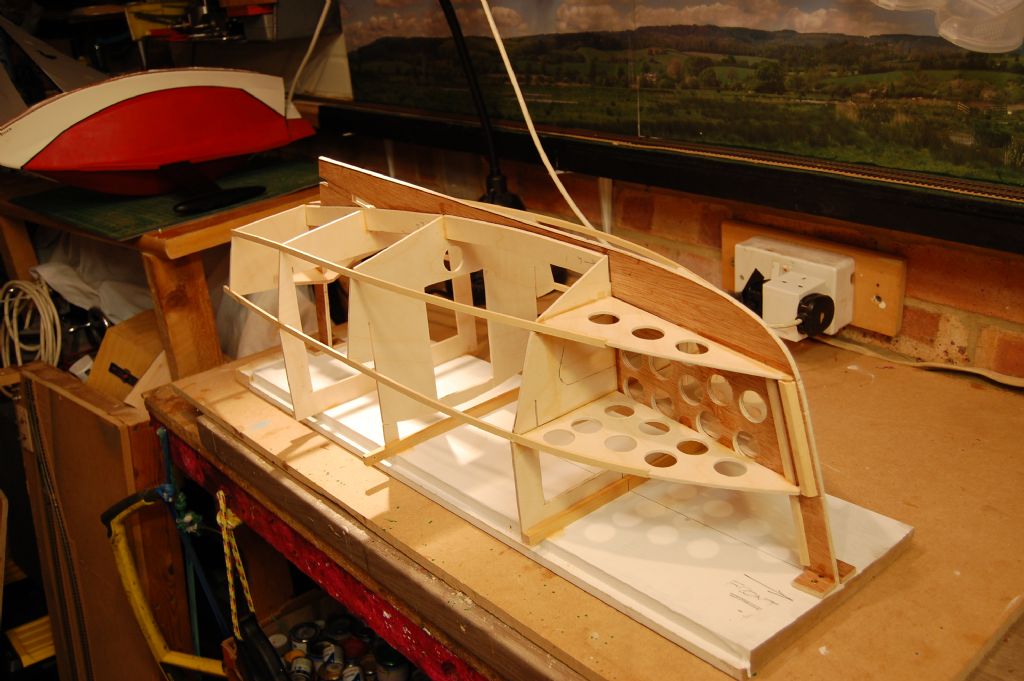

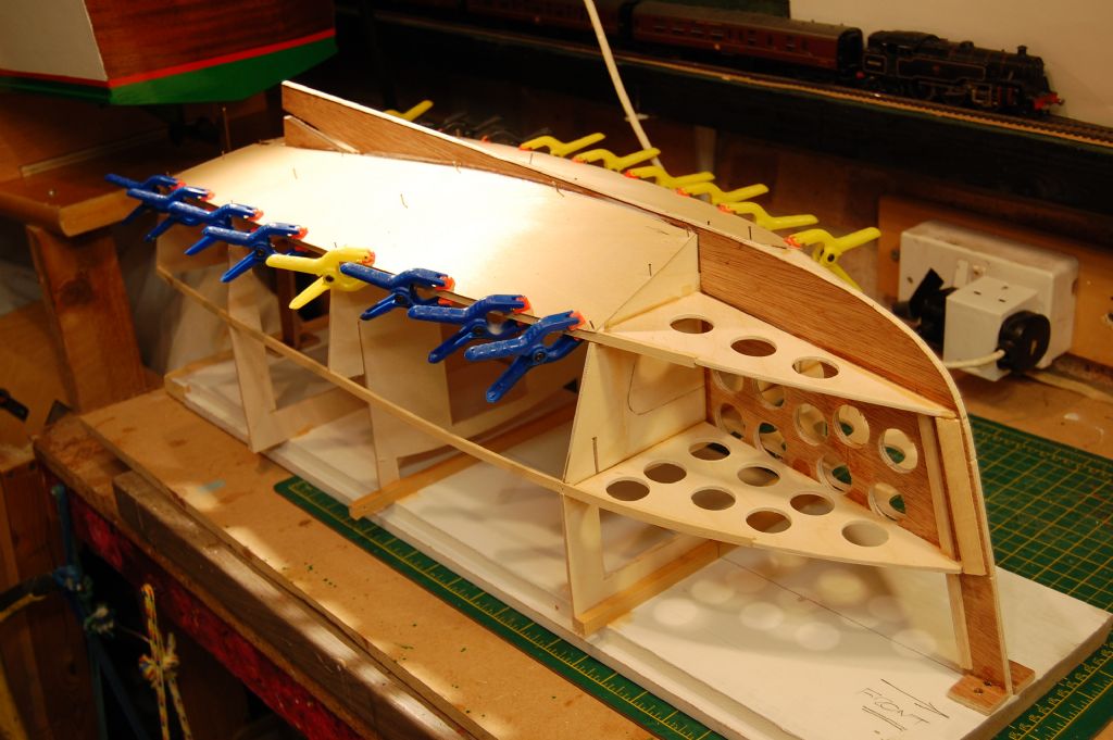

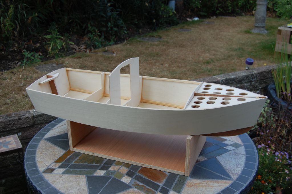

                      The Urchin has jumped off the board into it's stand so the upper works can begin
                      The block section below the chine at the bow will be Styrofoam carved and sanded to shape then just that part glass clothed for strength and make it ding proof. All the internal joints have been filleted with Gorilla glue, gone for the radius'd transom as nice feature onto which the rudder will be hung on pintels of some sort.
                      The Swiss cheese look is to keep the bow light in weight as she was designed strong for IC power not required so much now, I was tempted to put a glo motor in her but it would cut down where she could be run these days.
                      #101536
                        The Urchin is still progressing, a very enjoyable build, I will be buying some bits & bobs soon 600 brushed from the motor pool should do

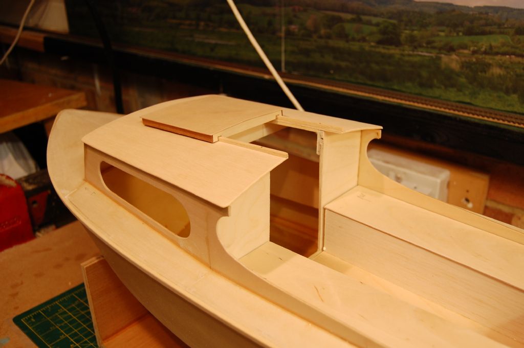

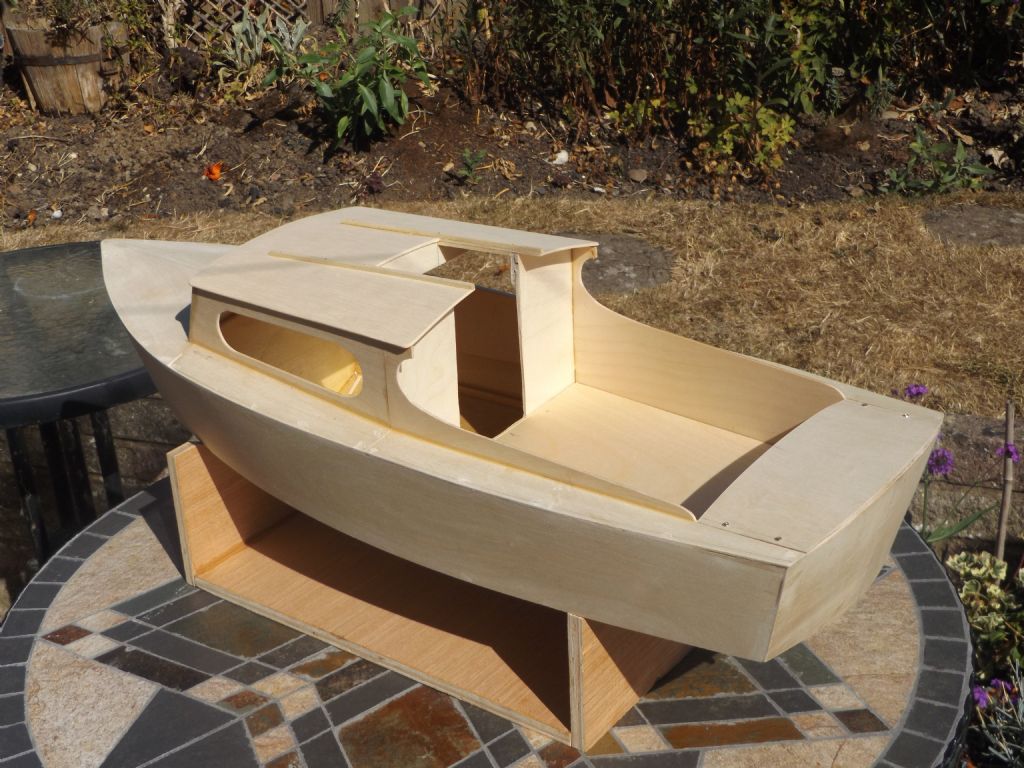

                              #101567

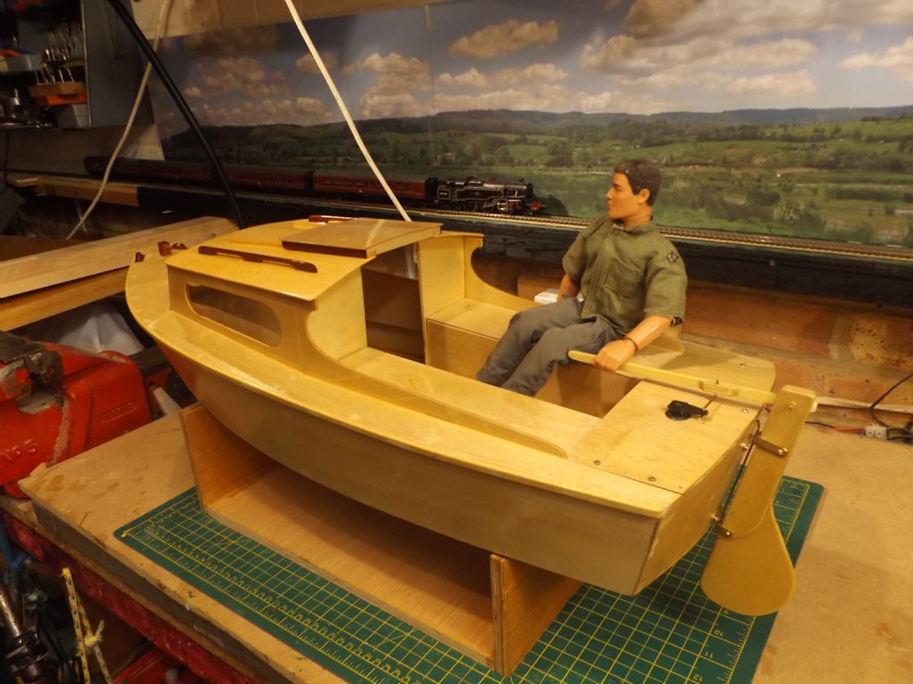

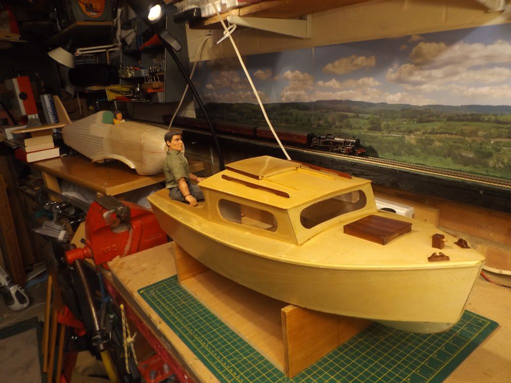

                                Hi All.
                                The Urchin is coming along now with the side decks in place and just framing for the cabin roof, I have gone for the radiused transom as it's much prettier, I'm now looking forward to the rudder which will be hinged on some pintels & gudgeon's on the transom, a nice different feature on this design, I splashed out on the running gear with the stern tube 10" 4mm fitted with a 35 mm 3 blade brass prop & Huco type coupling, we will go with the 600 brushed at this stage The cockpit floor will have bench/locker seats both sides for the batteries.

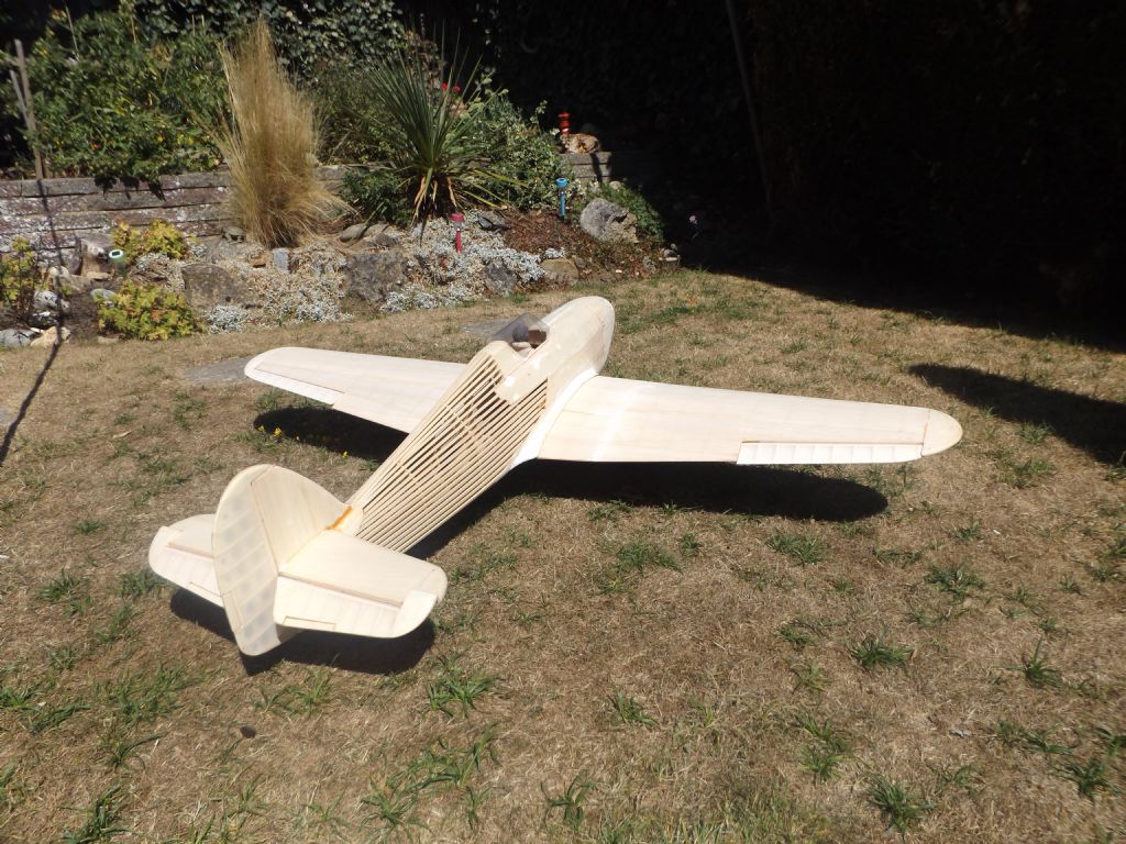

                                #101592
                                  su 6 100822.jpgHi All,
                                  Maybe it's this hot weather ? but I have reached a point with the Urchin where most of the heavy woodwork is complete and fancy a short intermission …………….. So I'll be finishing this Hawker Hurricane , it was originally built for an OS Four Stroke, but now realise I'm much more likely to fly her if it's electric powered, It also has electric retracts, designed by Tony Nijhuis and is 62" span should weight around 8 lbs AUW happy days
                                  #101593
                                    As always Ray lovely bit of woodwork. Lovely Hurricane as well that rear ribbing will look spot on when covered.

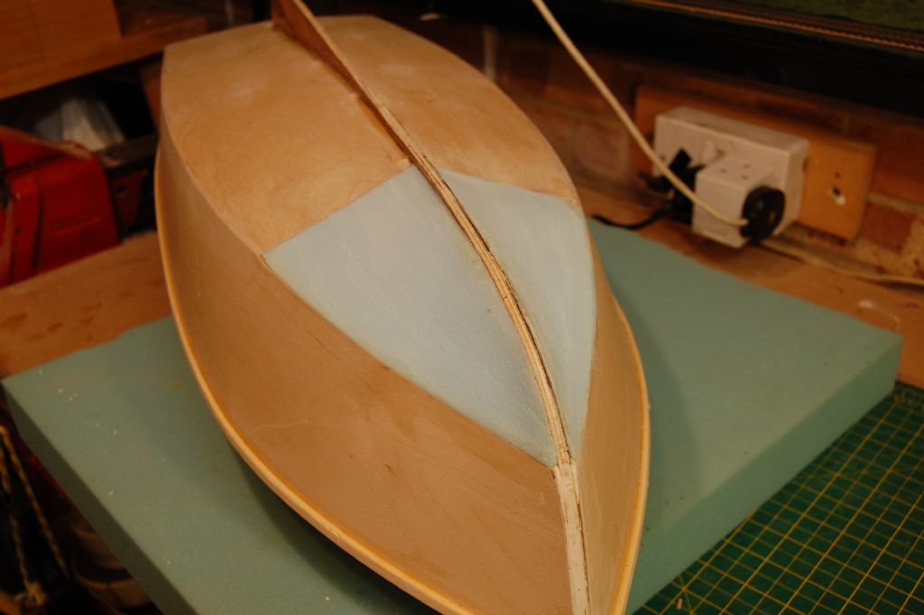

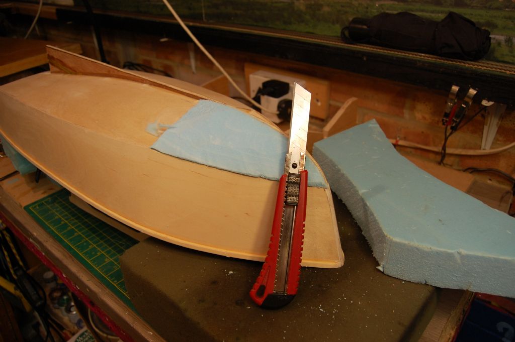

                                      su 6 bf bow.jpgsu 7 bow blocks.jpgHi all,
                                      I'm back on the Urchin for a while, I now remember boat building is cheap in comparison to RC flying models the Hurricane needs around £450 spent on it in parts to get in the air with electric power !! electric retracts are £170 !!su8 cabin hatch.jpg
                                      Still here are the blue/Styro foam bow blocks, they are now insitu sanded and glass clothed with water based resin, the side bench seats will house the batteries, one pack each side, the sliding cabin hatch just makes it more like a real little 16 – 18' dayboat, rudder next on the transom

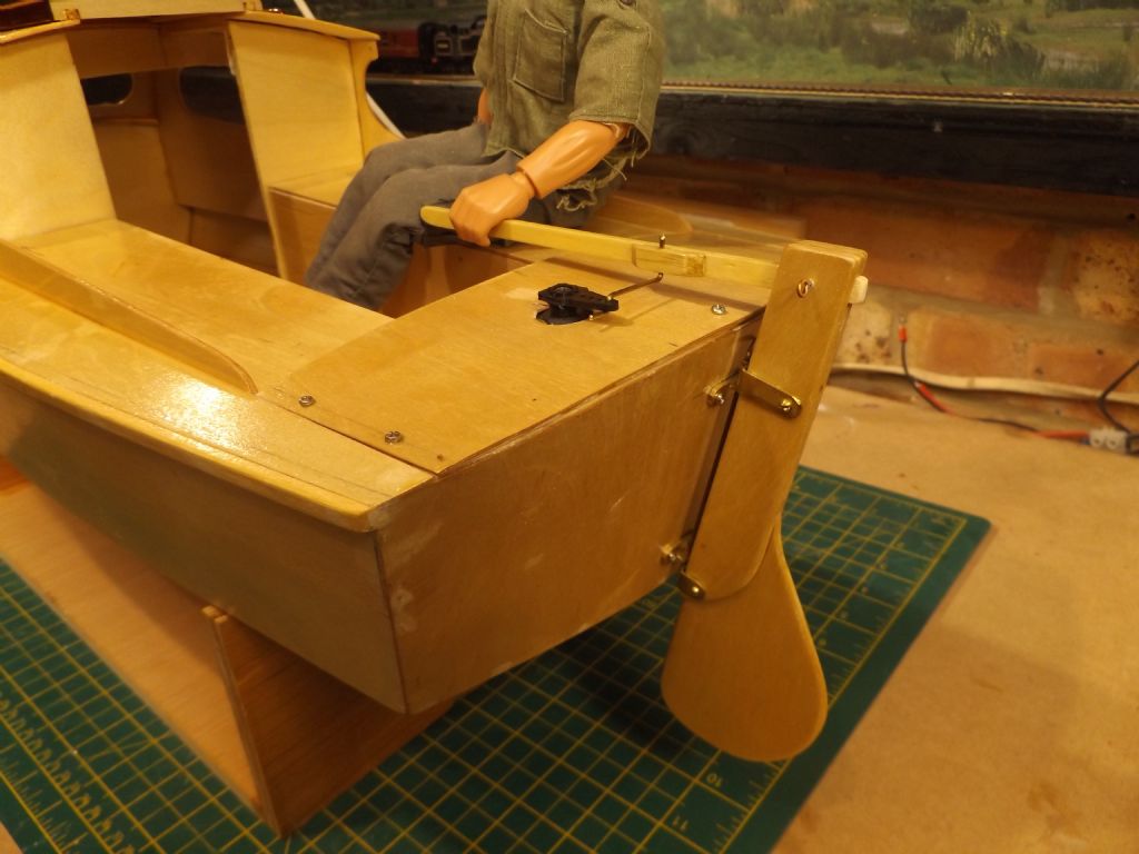

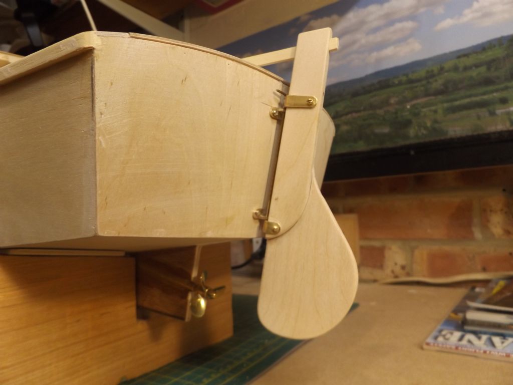

                                      #101684
                                        Hi all,
                                        This is what I like about building boats, most of the materials come from the scrap box Admittedly It's a big box !
                                        Some brass angle & strips with a pin to secure, job done, I'm rather tempted to just varnish the whole boat ??
                                        #101686
                                          Man after my own heart Ray. I would always rather varnish a piece of wood than paint it. Even ply. It just looks so much better.

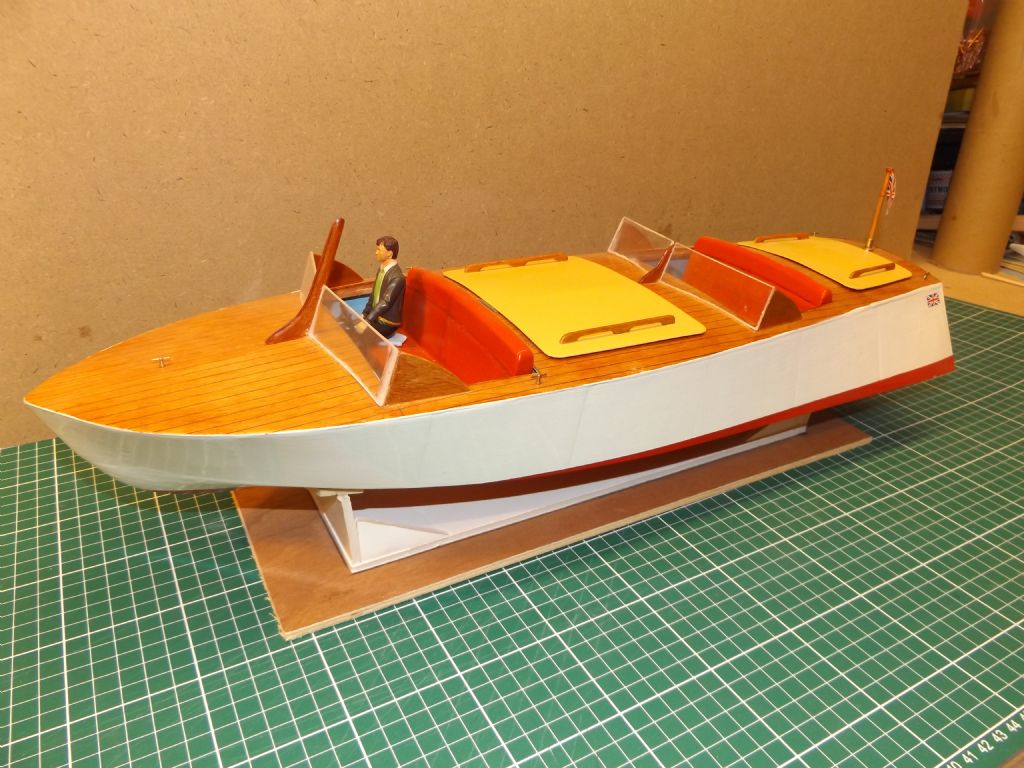

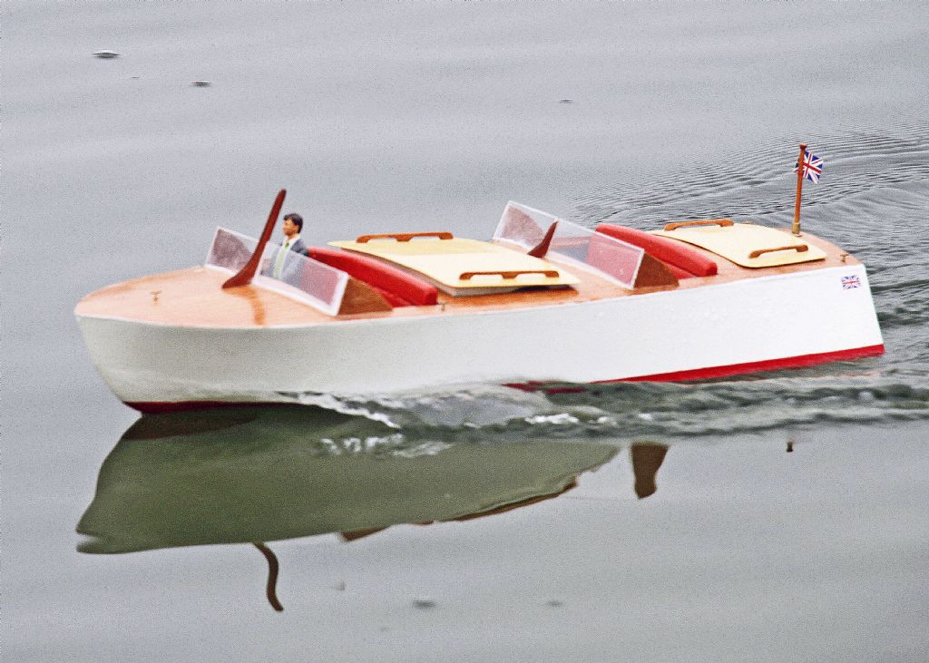

                                            sea hornet minor nov 16.jpgHi all,
                                            Good to see my scaled down redrafted  plan being used for the larger version of Les Rowell's Sea Hornet featured in this month's magazine as a platform for De-luxe products
                                            Not sure if the plan is still available , built with balsa a pocket money sized 400 powered boat .
                                            Edited By Ray Wood 2 on 21/08/2022 11:52:43

                                              su 11.jpgsu 10.jpgHi All,
                                              Well it's raining again so I thought I'd carry on with the Urchin, quite happy with just varnish all over it brings out the colour of the ply and mahogany parts, simple linkage from the servo under the rear deck to the tiller, the helmsman may be slightly big ! but I have a smaller guy , I think the real boat would have been 16' – 18' long so not that far out. the electric Hurricane is progressing in the background
                                              #102023
                                                Cor Ray. Trains, boats and planes! A man of multiple faiths!
                                                Know what you mean about the varnish. There comes a time in a build when the whole thing is wood and looks so nice you don’t want to paint it.

                                                  #102026
                                                    Looking good as usual Ray. Interesting way of operating the rudder, hadn't seen that before. Will bear in mind for my Faun build.
                                                    As per earlier post I don't think this is designed for speed though!
