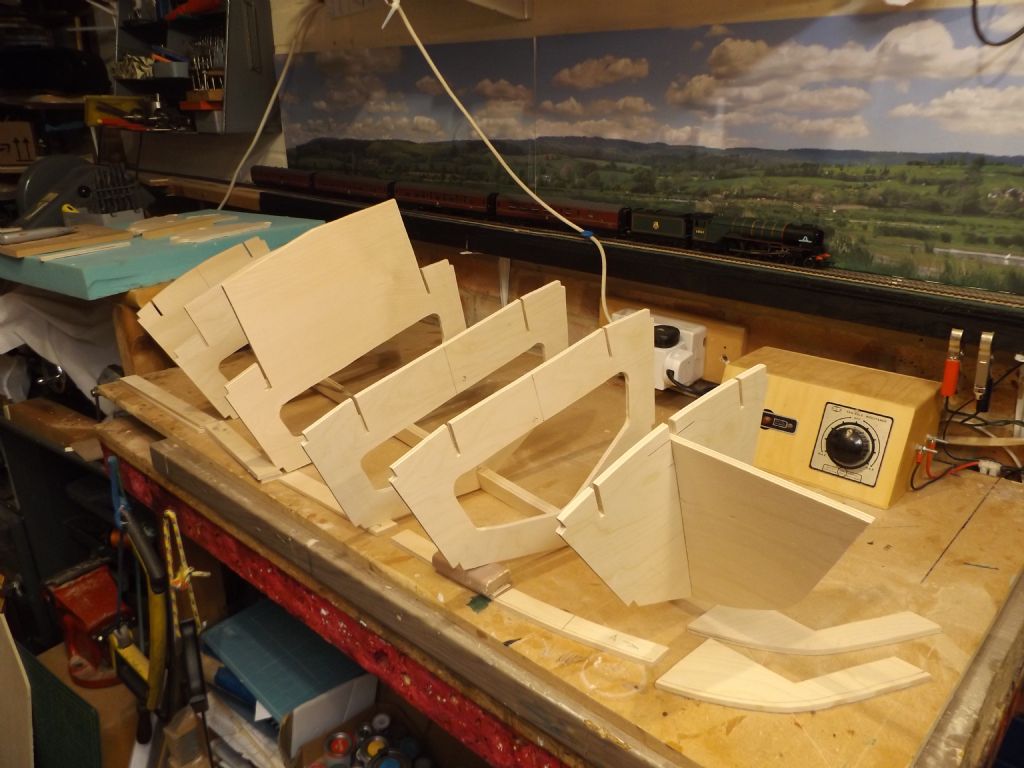

      sq1.jpgHi All,
      As I have not started a new boat for a couple of weeks and with some more time off over the Easter holidays I thought it was time for a new Sea Queen as I just enjoy building, this will be the third I've built, the first in the 1970's from the Aerokits kit, then the modern kit by Jontika around 7 years ago, but this time just from the original Les Rowell drawing, so I re-drew the bulkheads and with £90.00 of ply wood from SLEC here we go !! for anybody not familiar with the design she is 46" by 14" beam and a sort of Broads or Thames cabin cruiser.  Regards Raysq2.jpg

              Very neat woodwork Ray is that using a jig saw or a band saw?
              #100150

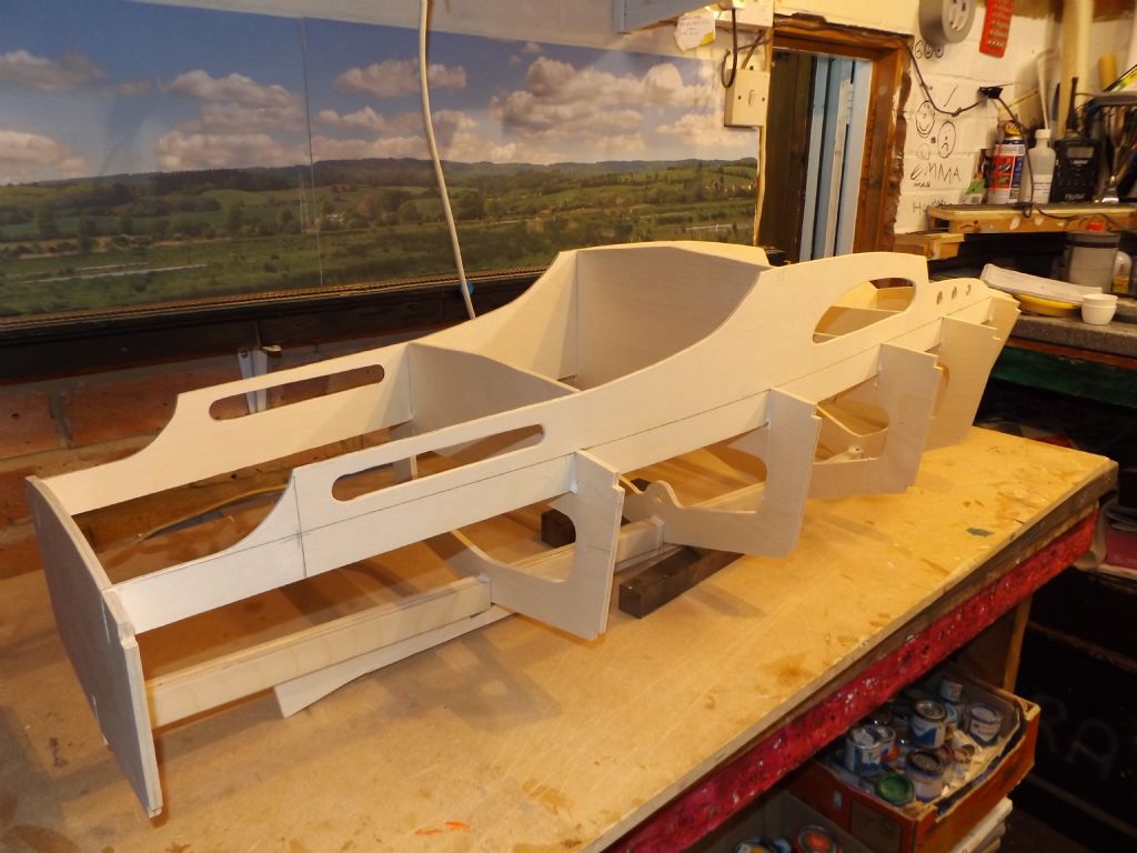

                sea queen dec 17 002.jpgHi Richard,
                My Axminster bandsaw has paid for it's self just on the saving on not buying another kit kids m 230516 009.jpg, best thing since the Permagrit sanding blocks were invented

                  That looks a lovely model.
                  Whilst I know that a skilled individual can draw them I am sure that there is a market for the bulkhead drawings.
                  #100154
                    Interesting Ray. I treat myself to an Axminster band saw only a few months ago and I was immediately asking myself why I didn't do it years ago. It is a superb piece of kit, well made and incredibly flexible. I actually used it to cut resin model railway buildings diagonally in half so I could put them against the back scene and it cut them beautifully.
                    It certainly made a beautiful job of your framework parts.

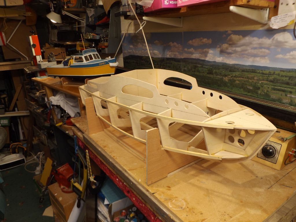

                      sq4.jpgHi All,
                      Well 4 days into the Big Brother House !! plus a couple for cutting out the main parts, we have something which looks like a boat
                      Being too mean to buy the kit at £250 but it's really good value as it's very accurate and just sluts together, you get the running gear included, which will cost me another £50.00 from Cornwall Model Boats this week.
                      Quite a few 1" diameter holes with my Starrett cutter to keep the bows lighter.
                      Stringers at deck & chine levels next which are 1/8" X 3/8" Obeche.

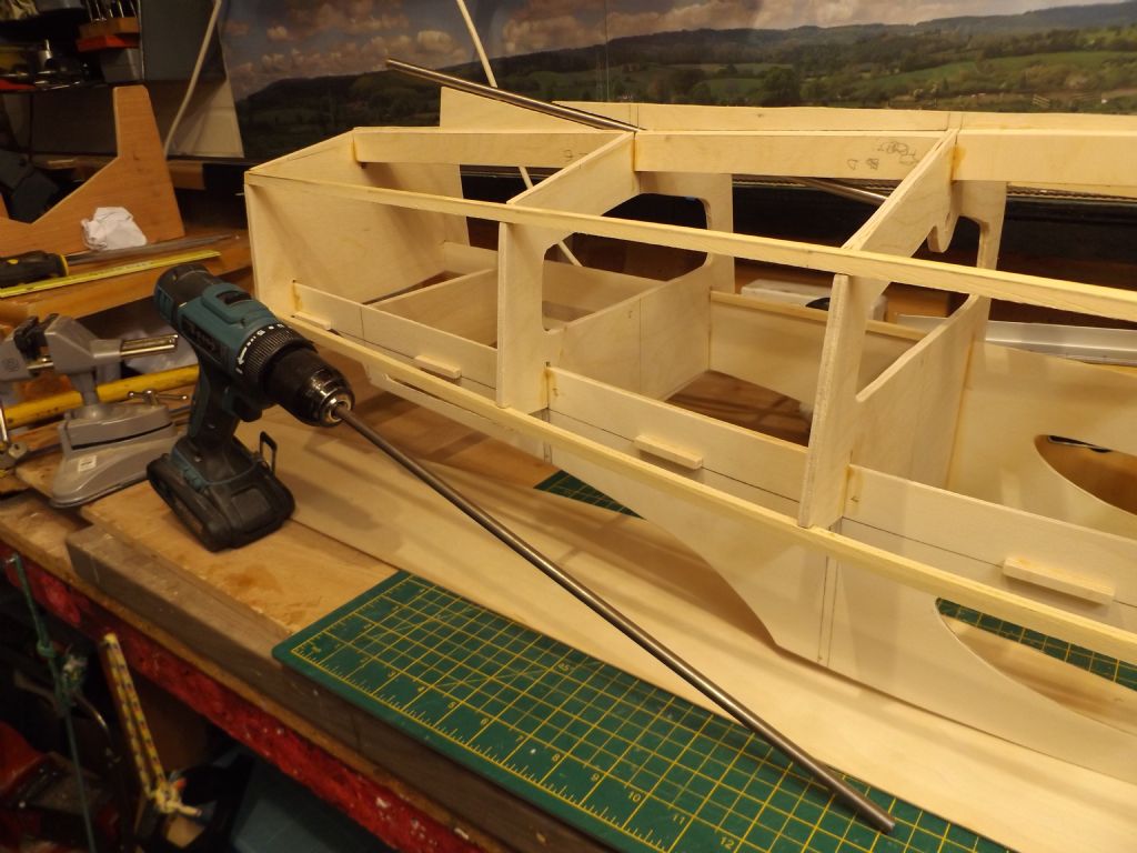

                            sq5.jpgHi all,
                            Well the stern tube, & rudder turned up today, always good to see if it will fit in the opening left for it, so for good measure I cross cut a length of 5/16" BMS rod and use it as a finishing drill for the stern tube, which worked well and the first bottom skin is on using a paper template to achieve the right shape

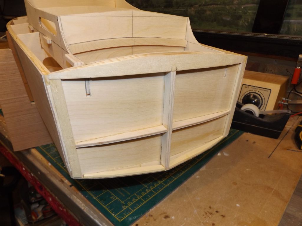

                                In an effort to make this Sea Queen the de-luxe version , here is the flat transom with the radiused build up ready for her 1.5mm mahogany overlay, fixed without pins Duct Tape to the rescue !!

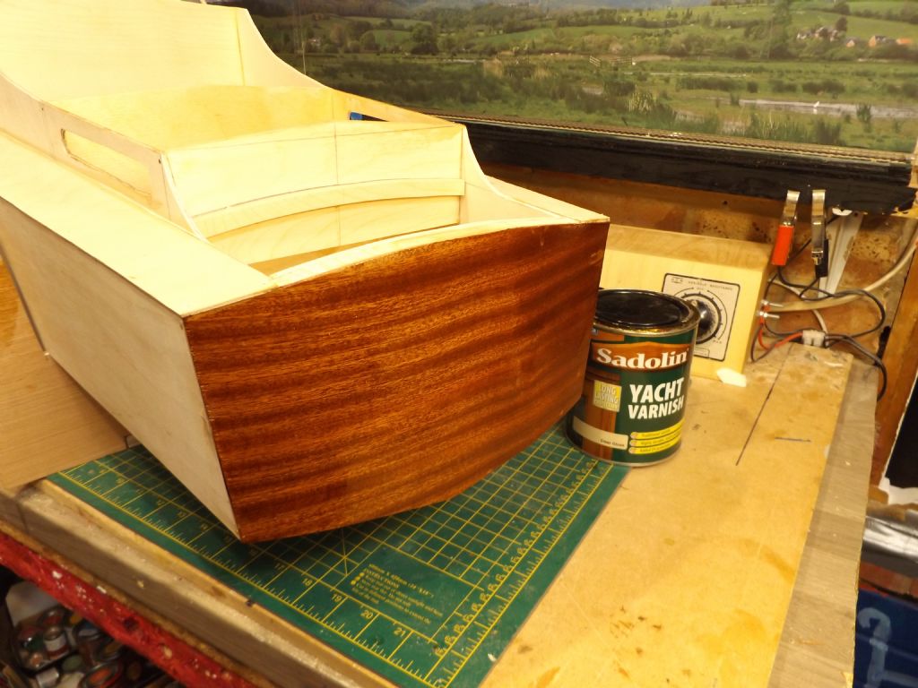

                                #100324
                                  Well the tape worked for gluing the mahogany in place , I did try dampening it and leaving it over a former to dry overnight to get a curve first but that was a waste of time it just sprang back flat
                                  So with a couple of coats of varnish to stop any paint from spoiling the timber, I'm now moving onto the decks, then the cabin roofs .

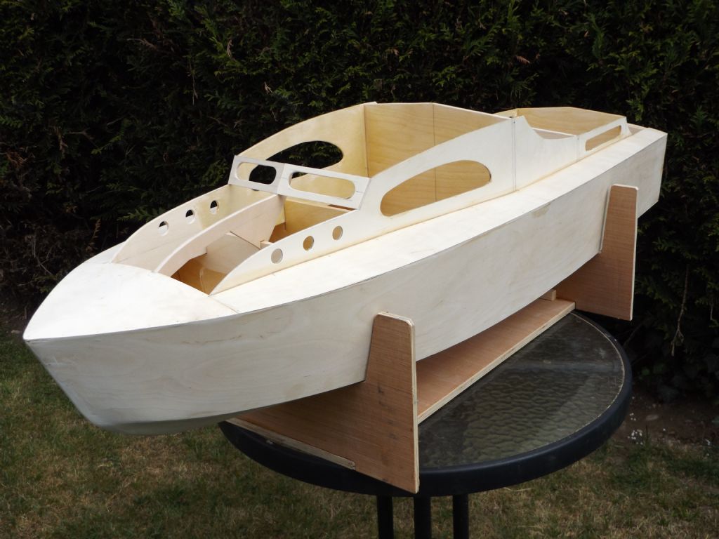

                                        sq11.jpgHi All,
                                        Well the old classic has progressed and made it out into the sunshine for a photo shoot
                                        Cabin roofs and cockpit floor next
                                        Tricky question this morning from my wife "what are you going to do with all these boats" not too sure
