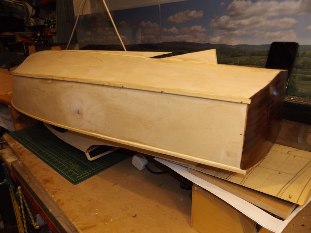

        Another task is the rubbing strips at the gunwhale level and the chine spray rail, which is not stock on the design but will help her get up and plane and stay drier, If I fit the the big brushless motor at a later date. Will be trying to make her look like a proper broads cruiser with the folding down cockpit roof , like my first design published in Model Boats magazine nearly 20 years ago called Margoletta.

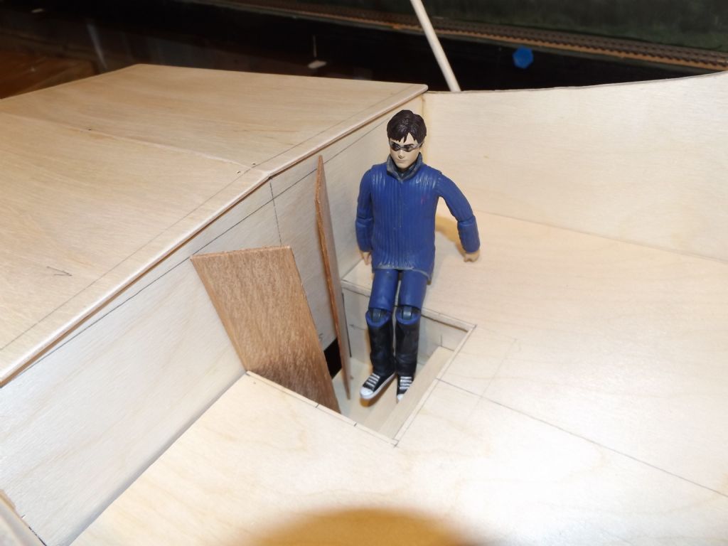

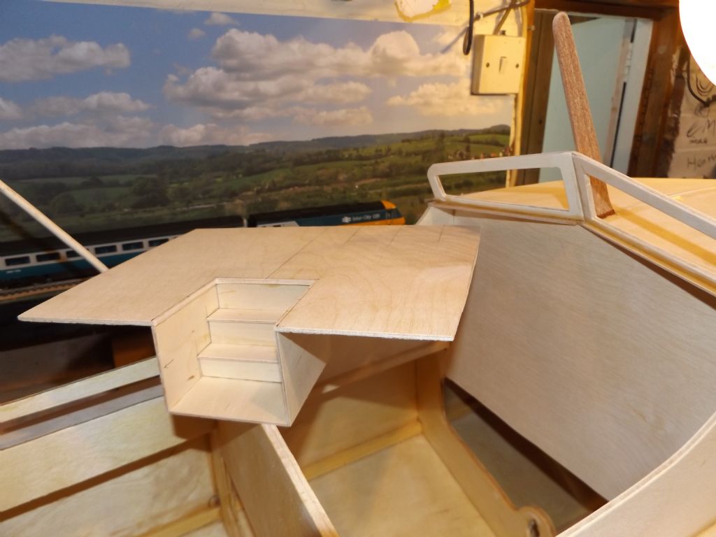

            sq19.jpgHi All,
            Here is one of my upgrades to make our Sea Queen more scale like, the doors to the rear cabin need to be put into a well with steps down which allows the doors to open, which they won't but could do and allow folk to larger than 3' tall to get in the cabin, the panelled doors have a way to go but Harry P is trying out the theory
            There will also be a sliding hatch on the rear cabin roof to cater for his tall dad !
            #100457
              Hi Ray
              Don't have that problem with my Faireys as the steps are inside the cabin.

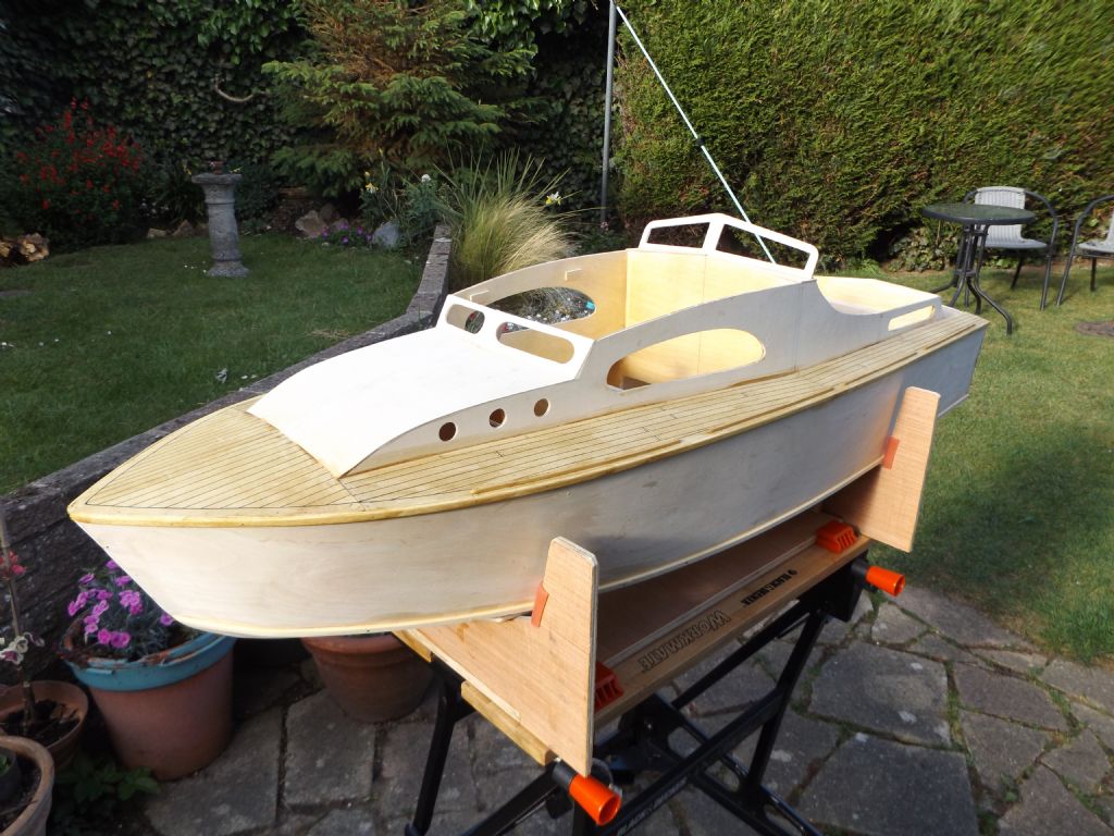

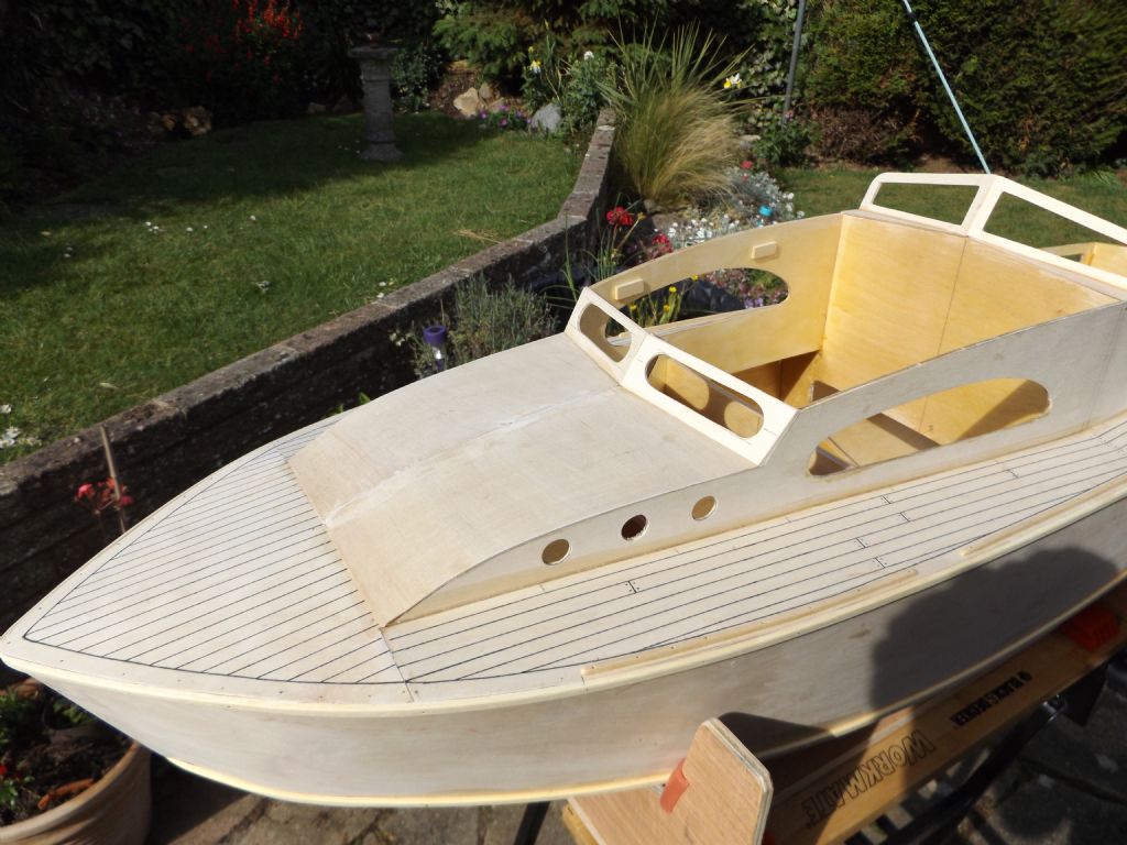

                sq20.jpgHi All,
                As I was too lazy to actually plank the decks so I opted for the black ink pen and a few plank joins to break it up.
                Pleased with the toe rails from 1/8"X 1/8" obeche, so I hope the crew won't fall overboard now !!
                The birch ply always looks rather anaemic varnished without colour so has been stained with light oak was, use anything like Burmese Teak and you won't see all those lines ever again
                Next a couple of coats of satin varnish on the deck before I start painting the hull .

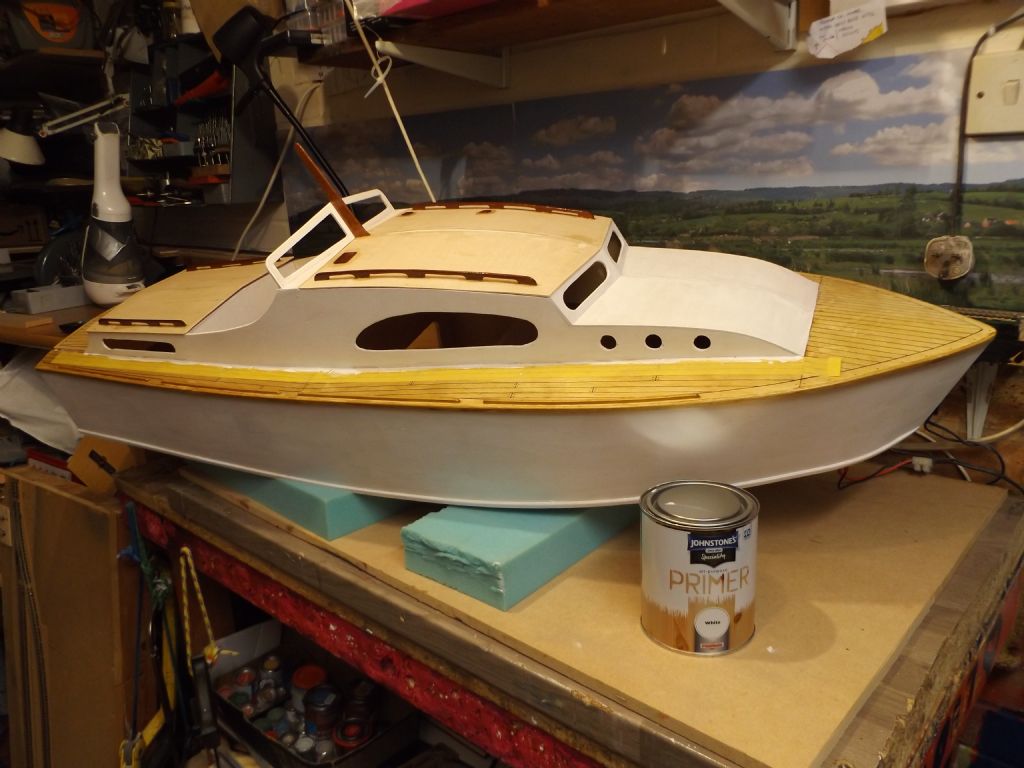

                    With a discussion on another thread about painting recently, here is how I'm doing it on a plywood boat, a nice rub down with fine paper and some universal oil based primer, I would not use water based paint on a fullsize boat so our smaller version deserves the best in my view, even if it will never be in the water for very long periods, Humbrol enamel is all I've ever used for the last 60 years so I'm not going to change now, and the larger size 50ml size tins are available again after many years off the shelves
                    Some mahogany cabin roof grab rails and deck are already sealed with varnish, I have epoxied the stern tube in and fitted the rudder, but you can'tsq22.jpg that in this shot.

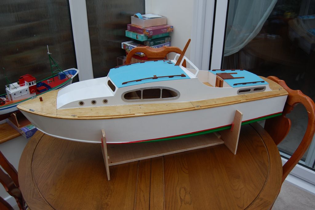

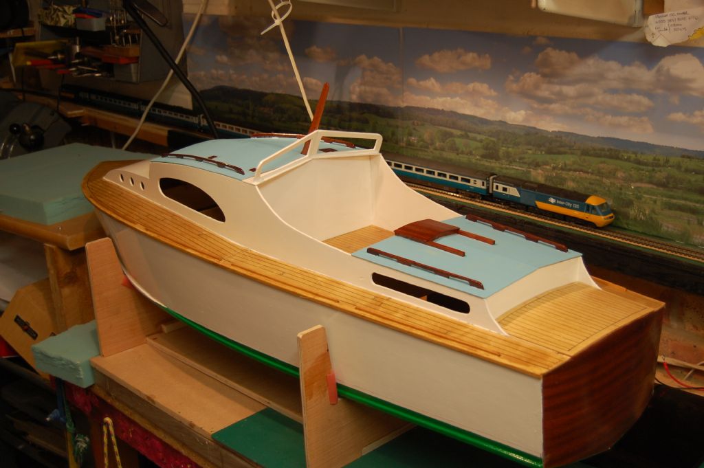

                            sq painted.jpgHi All,
                            This is the boring part, painting ! and compounded the situation by me using white primer and trying to cover it with Humbrol green 3 coats so far and putting the boot topping in by hand in red is my favourite scheme. Window frames & portlights to turn from brass next
                            Didn't quite manage to finish before the Jubilee but pretty close !!

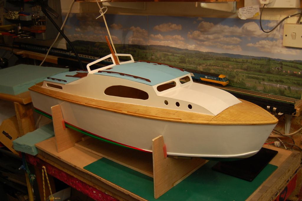

                              Happy Jubilee weekend everyone,
                              Glad the weather was kind to us on Thursday & Friday, but has now turned into good building weather down here in Kent
                              Well the Sea Queen is nearly there 99%,I'm now starting to get bored and move on to rigging the Silhouette I built a while back this week

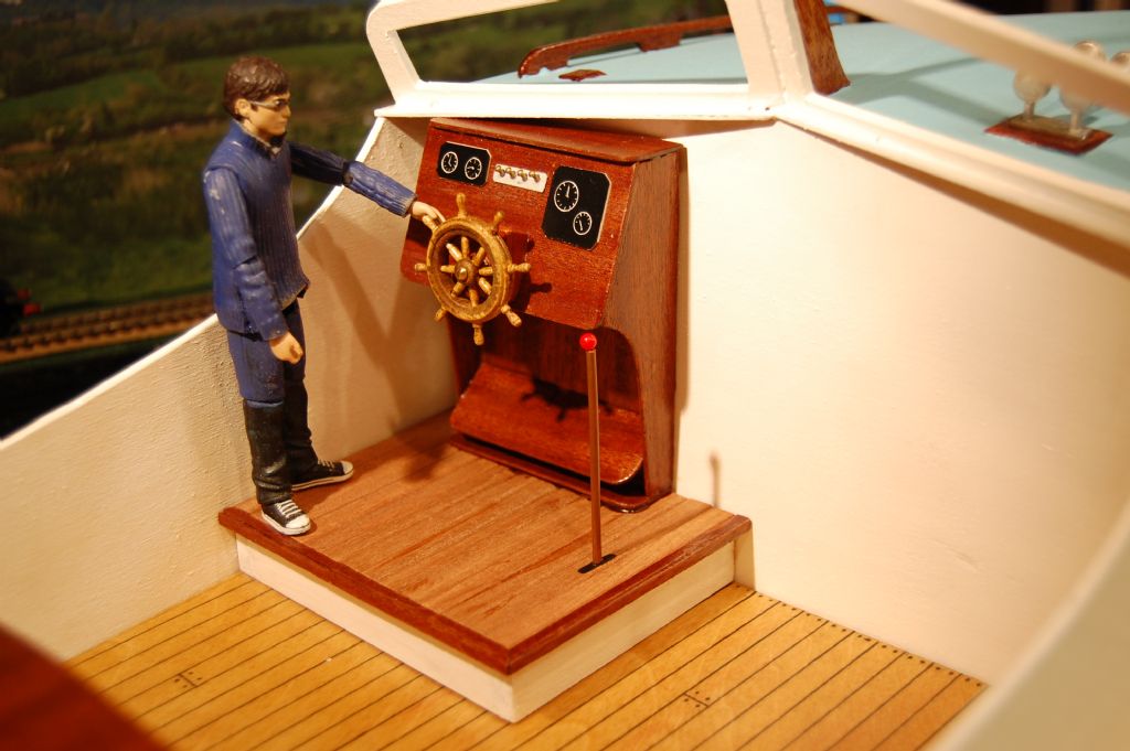

                                      Jumping back onto the Sea Queen for some finishing touches, here Harry P wonders if he will get a helmsman seat to sit on ?? I seem to remember the old broads cruisers having a big lever from the gearbox for forward & reverse
                                      #101482
                                        That guy looks a bit of a midget!

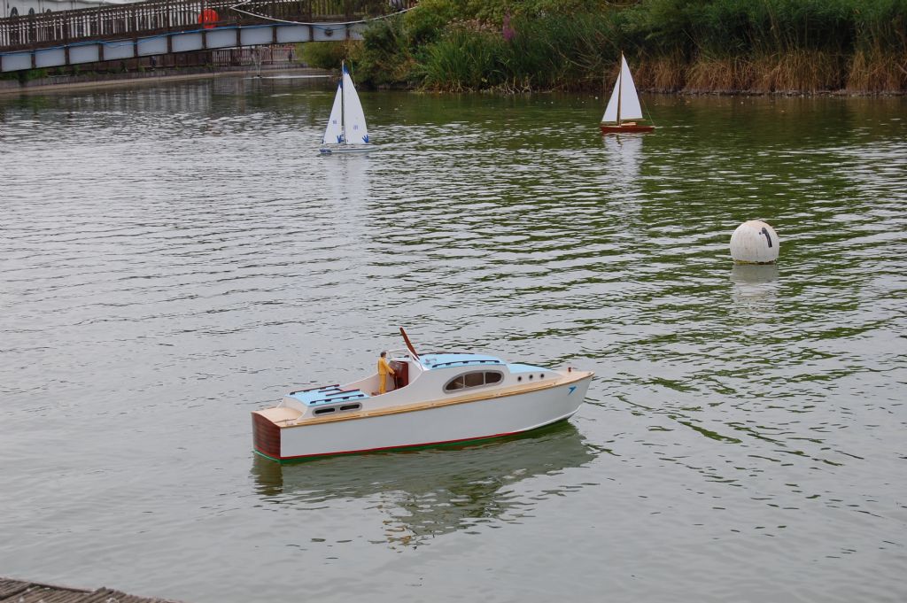

                                                hh cul june16 019.jpgHi George,
                                                You have made 3 exceptionally nice boats, where as knock them out a an alarming rate then wonder why, but I long ago stopped questioning why I wanted to build the latest one
                                                Yes the Sea Queen looks a bit to posh for your average wooden Broads Cruiser, my first design for Model Boats was Margoletta, much more in the style of the Broads boats.
