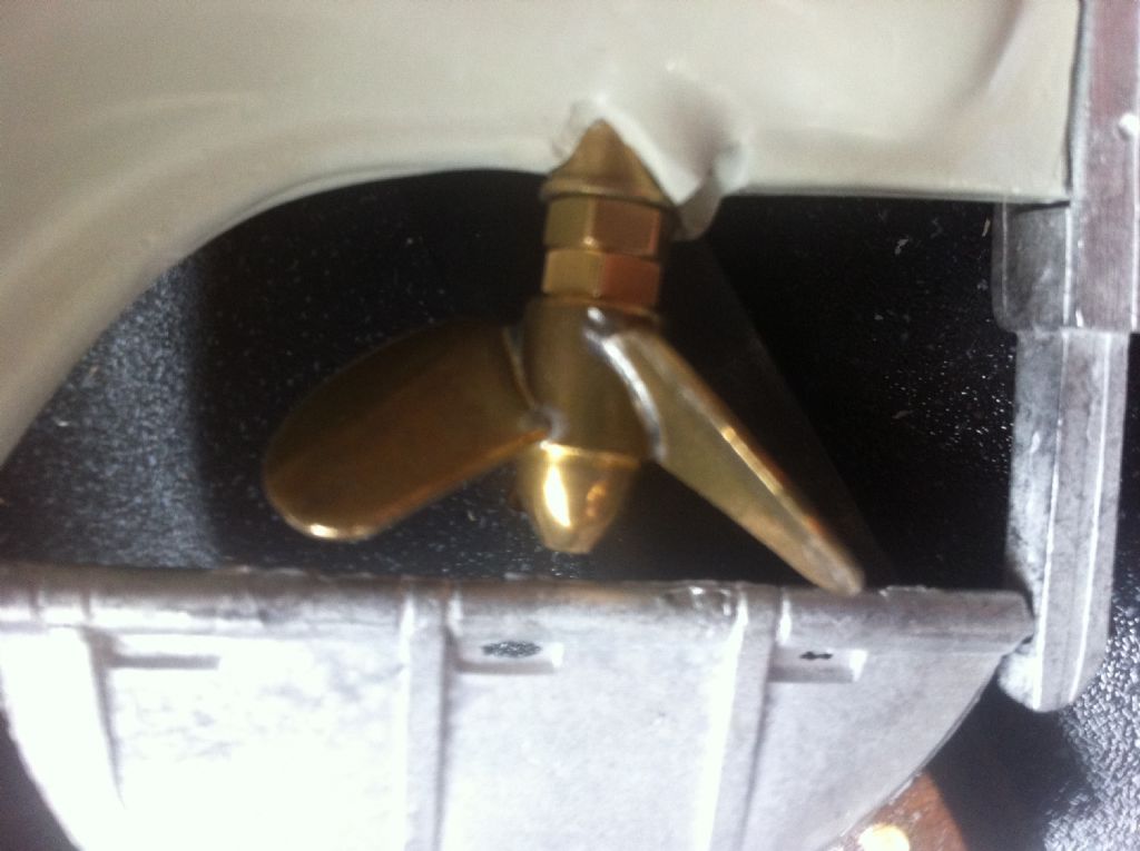

            Ashley i have added a photo of the trial assembly. The prop came with two nuts as you see but i cannot see the point of that as i will need to make good the grp around the shaft hole i have drilled. Am i correct in thinking that i can use a single nut to lock against the washer (i will also get a nylon washer as recommended) as then i can adjust the shaft so that it protrudes from the opening slightly to allow making good and also free movement of rudder! I appreciate the assistance! PAUL

              The prop should screw on. The there should be a lock-nut, tightened against the prop, to lock it there. Then it is usual to have a washer to spread the thrust load on the end of the prop-tube. This washer can be a multi-layer brass/nylon stack, or a ball-race, or any other load-spreading design you like…
              #58934
                Paul. Single lock nut. Sometimes I have seen people put on two nuts or a stack of washers to make up the difference if, for instance there is some adjustment issue, or the shaft does not properly match the tube length, and so some packing is required. IF this was the case, its better having the packers INSIDE the boat.
                I have a couple of boats with shafts like this, and have had to use a few washers to get the right adjustment.
