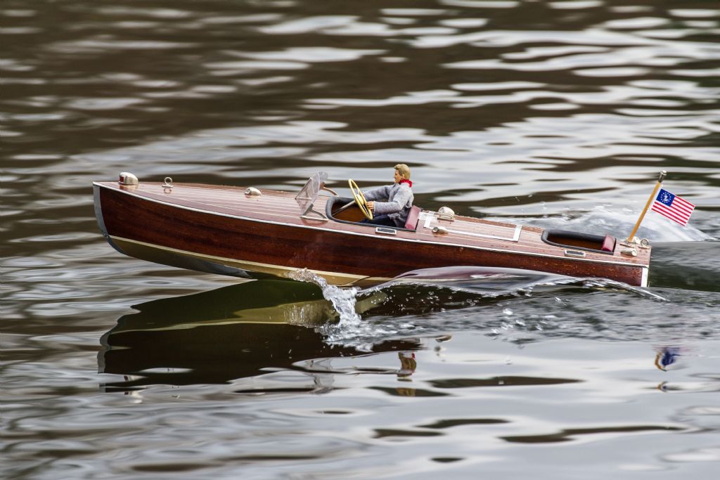

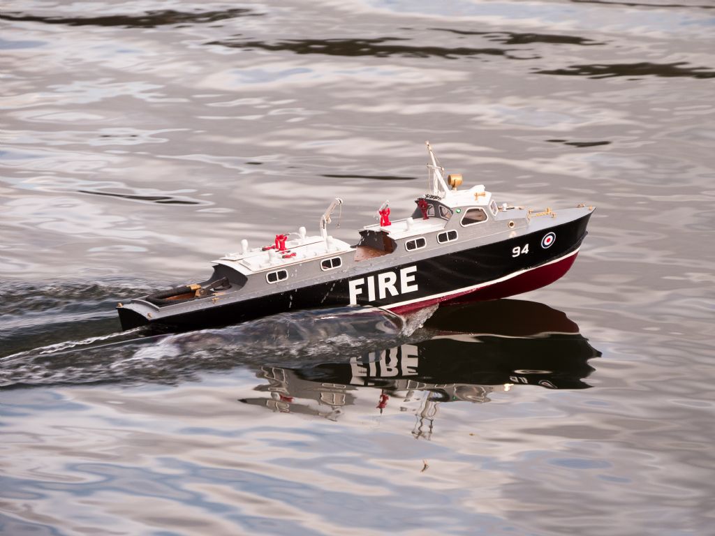

                                    I have read this thread with interest because I have a major problem with water getting into my Vosper fire tender. A bath test suggests that the hull is not leaking and I suspect that water ingress up the prop shaft is largely if not solely to blame. The other culprit may be the rudder shaft. The prop shaft is the type with bearings at either end. I have packed with Lithium grease but, to be honest, most of it gets pushed out as the shaft is inserted. Should I try O rings or some other means of seling the top end of the shaft. Any thoughts or advice would be much appreciated.
                                    I note Trevor's comments that water coming up the shaft is a major problem with a lot of models. Maybe strangely, whilst water ingress is a problem with the Vosper, I have no such problem with my Chris Craft which similarly uses a high speed brushless motor.

                                      Jeremy. We will not agree on this either.
                                      PERSONALLY I would use nylon, or plastic milk-bottle washers or as Kimmo uses , Teflon rings, and nip them up so there is absolutely no play at all. The water takes care of the lube at the bottom and a drip of oil takes care at the top.
                                      Other than that, I am not sure why they dont simply make the bushes, whether bronze or Nylon, much longer, say twice as long, to assist in the sealing of the shaft..
                                      Leaking up the rudder post may indeed be an issue, as this area in in a high water pressure region due to the water being pumped off your (obviously) well thrashed prop. Look at the stream of water it is possible to get off a water scoop in this area.
                                      OR just use a bit of water management to keep the suff in one place to be easily sucked out…
                                      Re the flag on first picture. I have taken to painting my own white ensigns or whatever now, and making them a sort of "streaming in the wind" shape, as I realised that although these printed flags are very nice, they do look a bit lifeless, even when artfully crinkled up a bit. It is not as tricky as it sounds, and I have managed some quite acceptable flags by doing this. They dont have to be super accurate as the flag shape is distorted (by the wind ) to start with. Just a thought.

                                        Thanks for the comments and advice.
                                        By nipped up to, I assume you mean held in place maybe with a collar. I will definitely try that.
                                        I don't quite understand your reference to a water scoop. There is one on the Vosper located aft of the prop and forward of the rudder. It is there to feed the fire montors via a pump.
                                        I have tried to seal the joins between the formers and the skin of the boat with epoxy resin. I should have done this when I first built the hull. Assuming this is working, most of the water appears to be in the area where the prop shaft enters the hull, much less in the rudder shaft area.
                                        Jeremy
