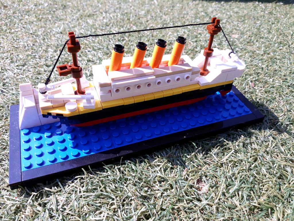

                                                    Almost finished now. In fact I have done a tiny bit more to it since the snaps were taken early afternoon.
                                                    The black holes went on very easily using a pair of very sharp tweezers and masking tape as a guide. It has to be said they are a bit big but that's just how it has to be. On the water they will sort of merge together and give the right porthole-y appearance. I have varnished them with clear gloss varnish to stop them being washed away.
                                                    The bridge windows will be squared off a bit with the delicate application of some white paint and that will look a bit better.
                                                    Last snap, sorry Colin, I know you liked this ship, but it seemed rude not to make an alternative top….
