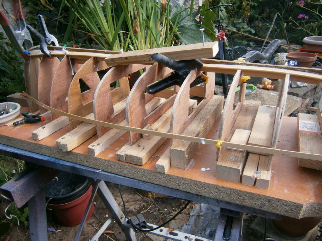

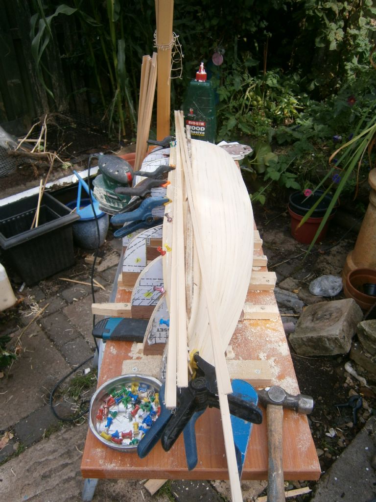

        Hello Nigal,

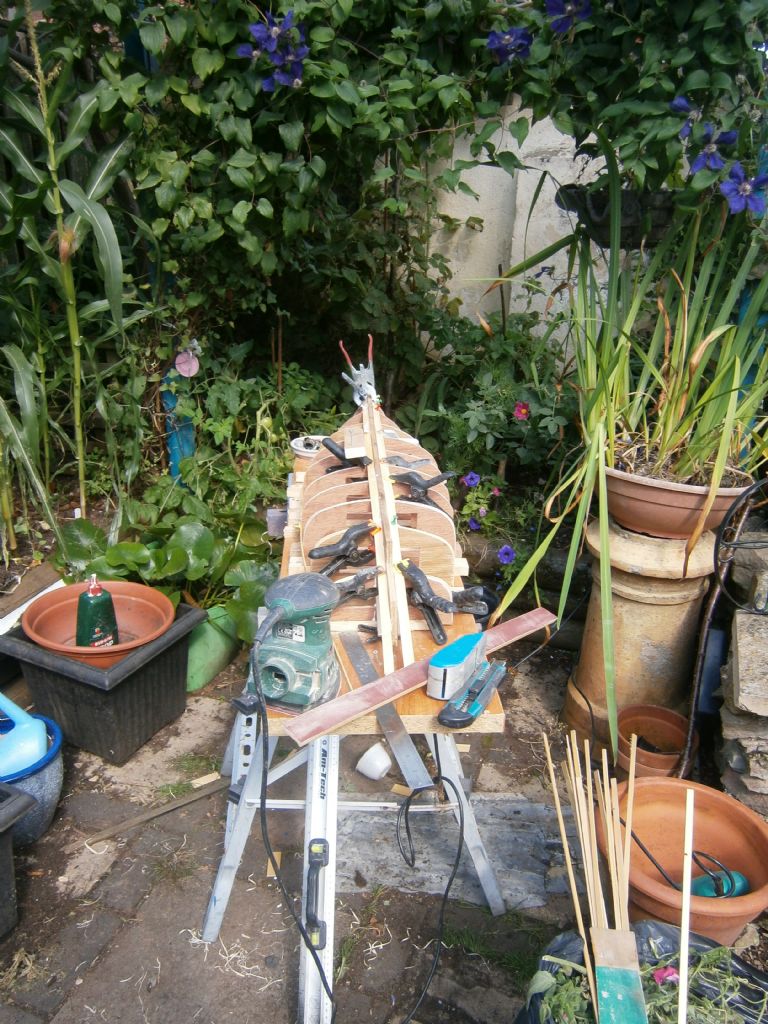

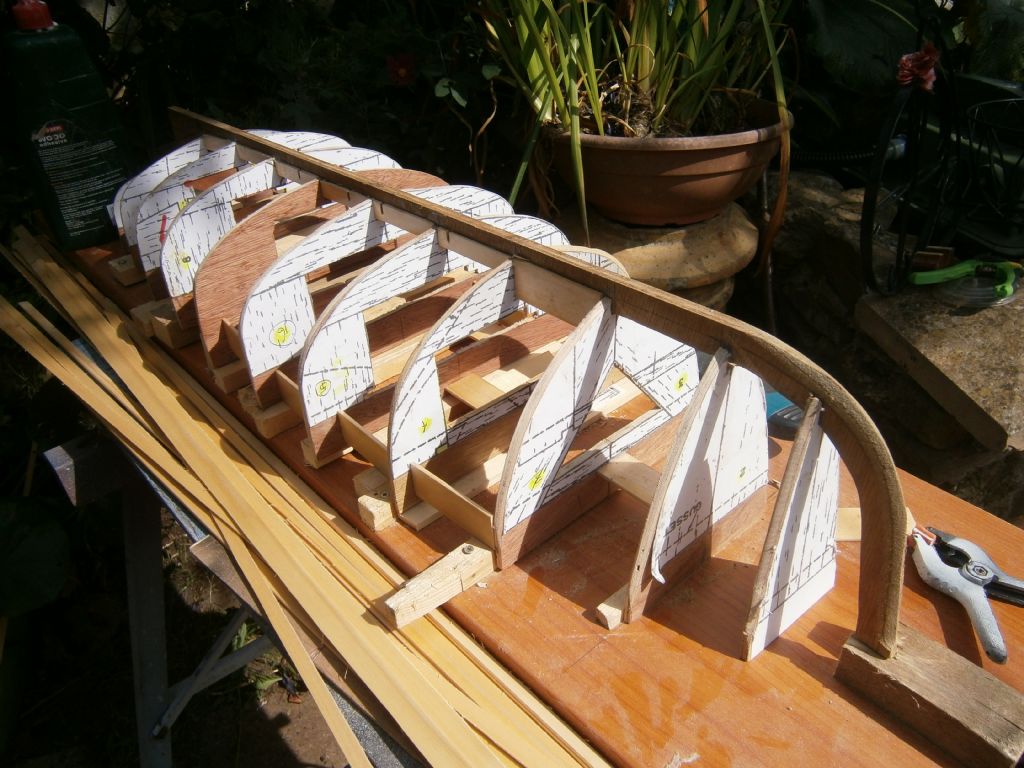

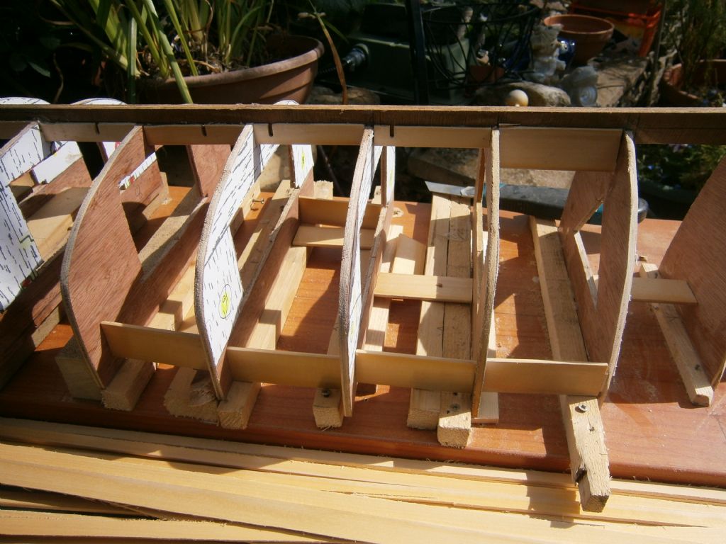

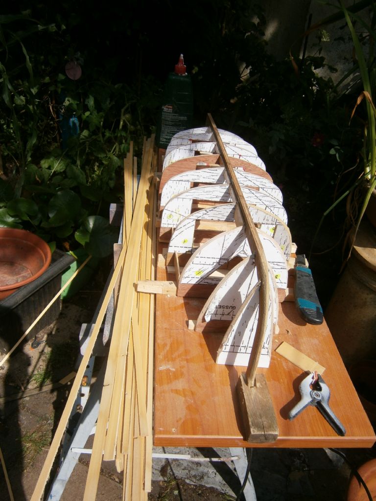

        had a bash at the build to day , setup and fine tuned formers and keel on jig, all boned up nice but one i noticed on photo, will put right at the next visit , first planks fited at keel and at deck level..
        you will see the collection of tools used, palm sander / craft knife/ mini plane / sanding sticks/
        a bundle of ikea blind cut down on band saw ….clamps / maping pins. a good wood glue.,…..
        nice to be back doing somthing,………cheers Larry…

          kingfisher build 002.jpgHELLO Again ,

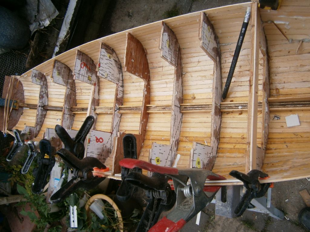

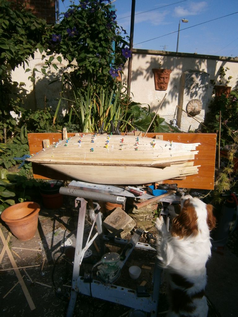

            LARRY WHETTON
              @larrywhetton68737
              harry aproves build ………cheers Larry..

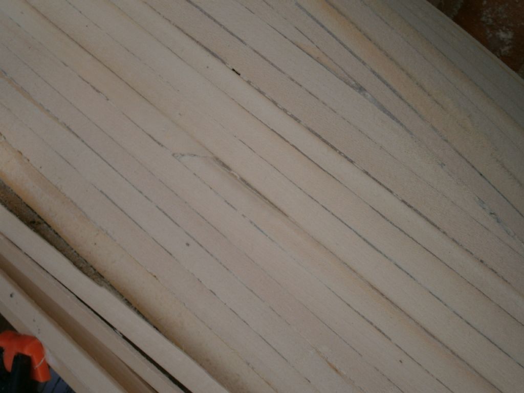

              kingfisher build  3 001.jpgHi All,

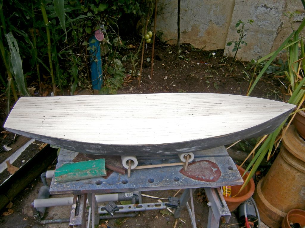

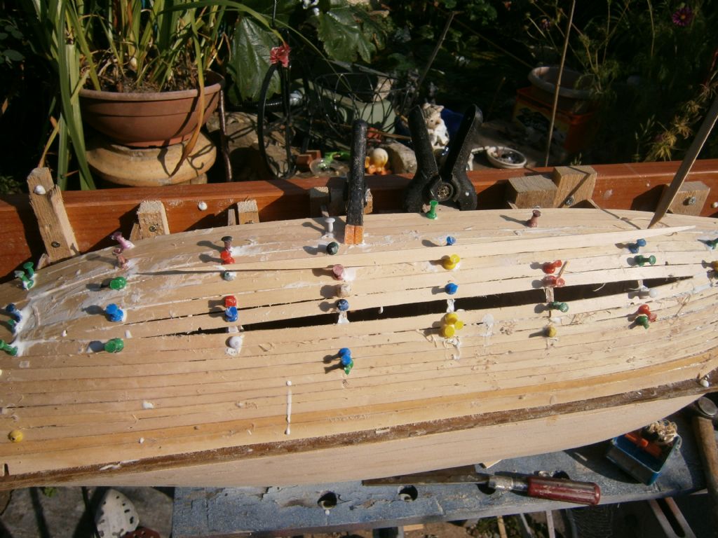

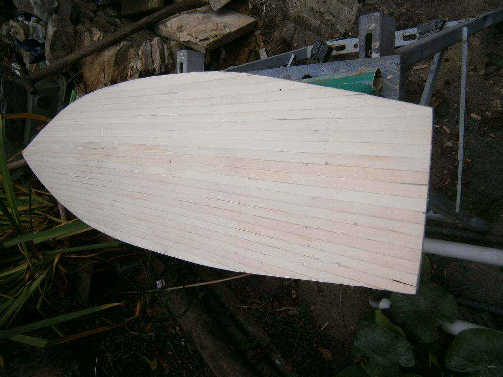

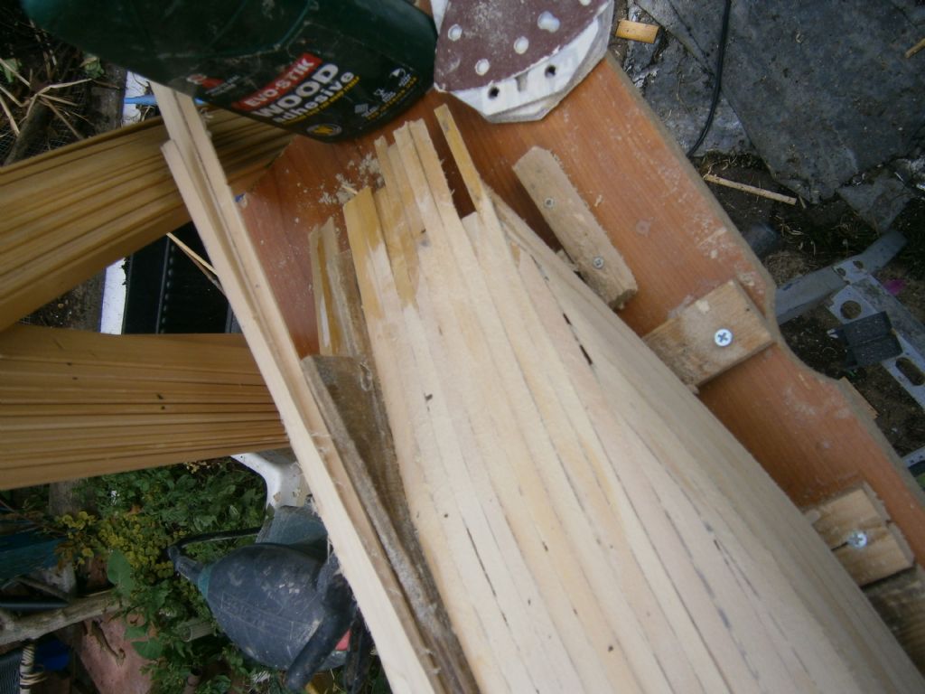

              weather good, so day 3 started planking weny well , ikea blind bends well pictures show one side snded and the other shows contcruction, note stern as no former at this stage, will explain later,
              #43250
              LARRY WHETTON
                @larrywhetton68737

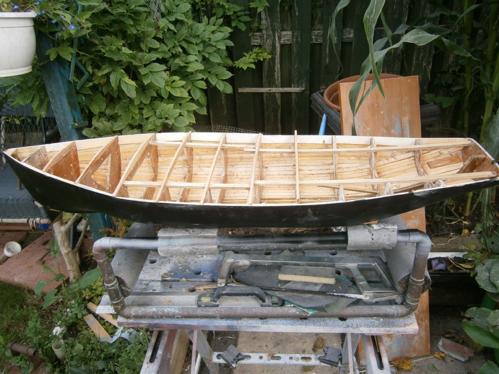

                resin coat

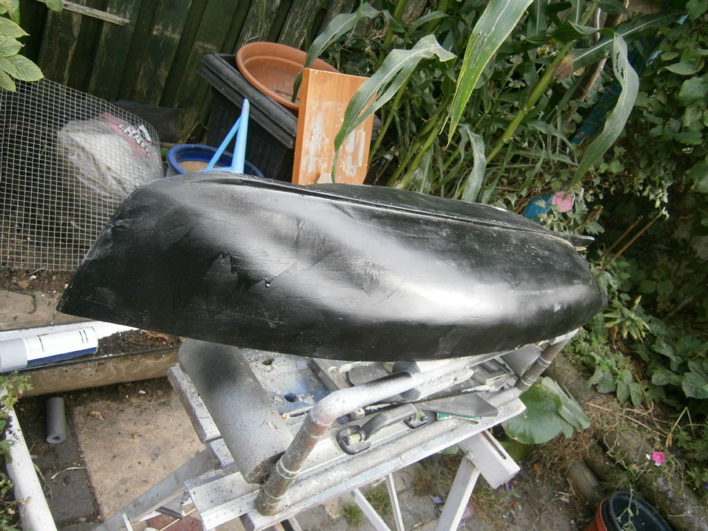

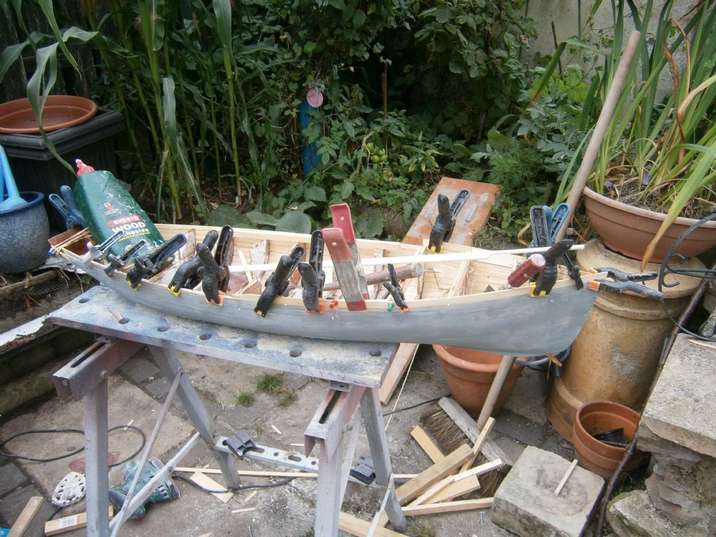

                kingfisher 4 002.jpgHello Again,
                Weather is ok for further buid day 4 ,,
                hul removed from jig a bit of filler and first tell primer, added ,
                bulk head extenions saw off , a coat of F/G resin coated inside hull .
                stern added new mod to help deck doubler added at deck level thats what the clamps are holding
                should fited stringer at former stage not shown on drawing , so if i build anther i will add them.
                next stage will be shaft and drive motor . before deck works, and then get back on hull finish .
                more primer and sand,……cheers Larry..

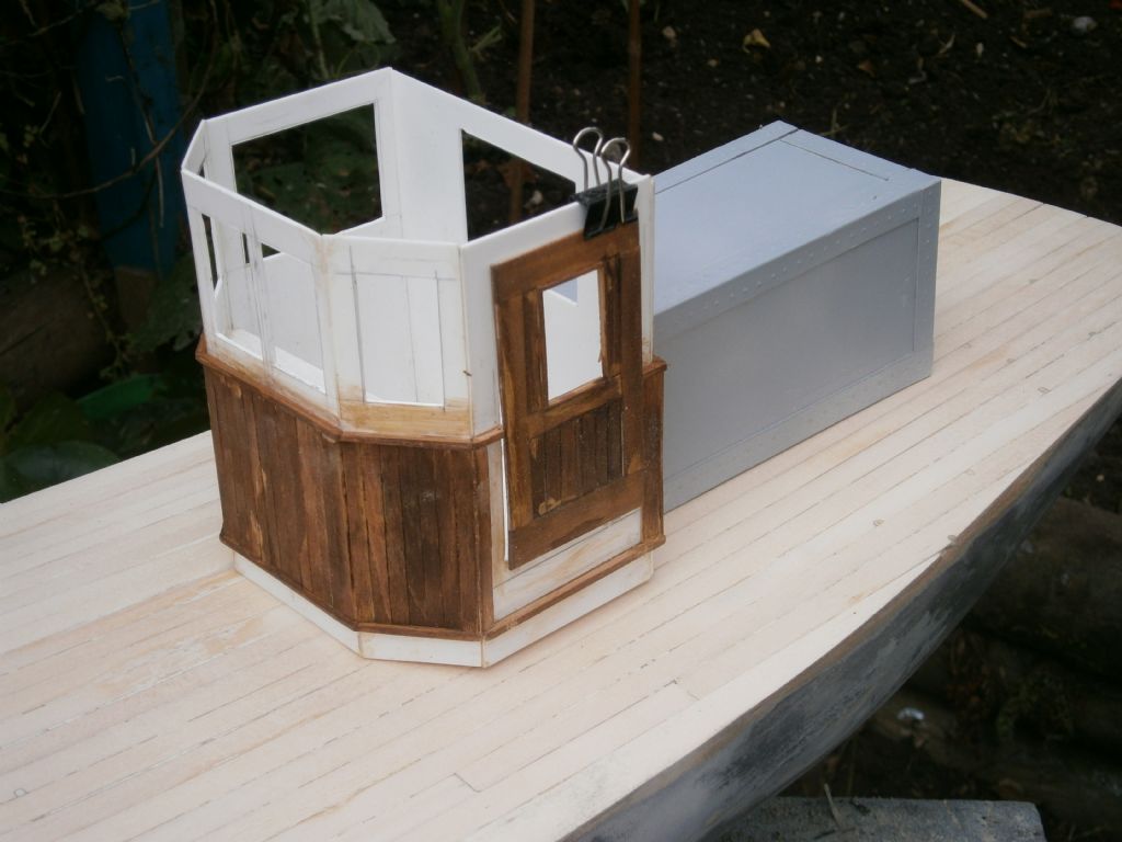

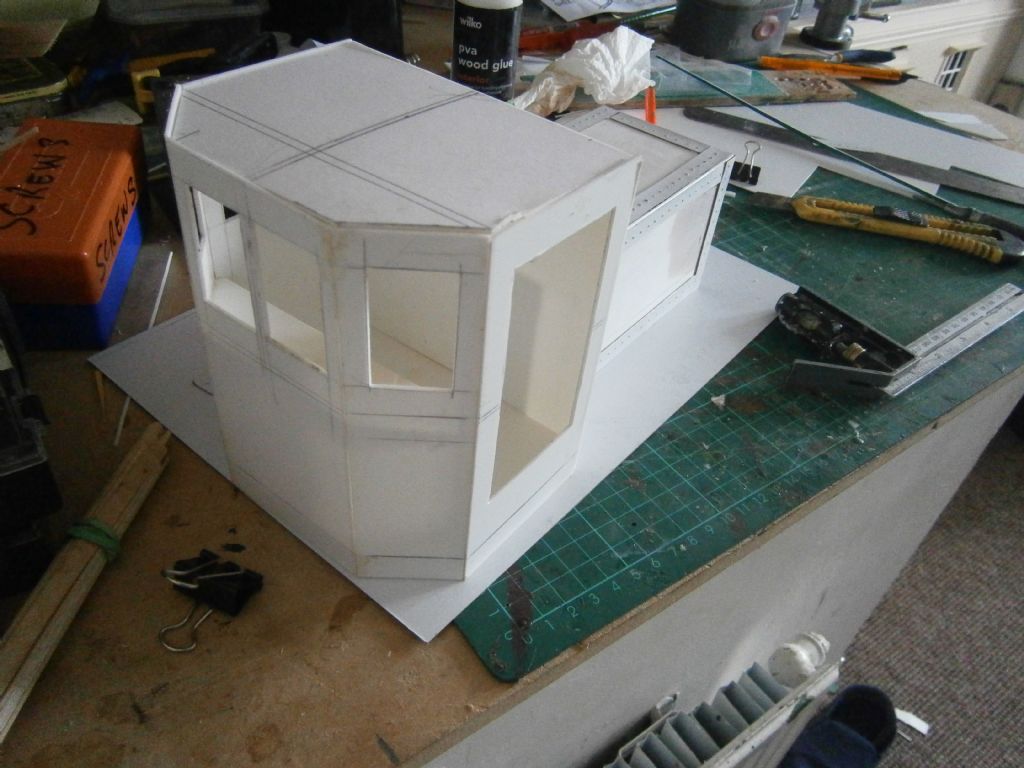

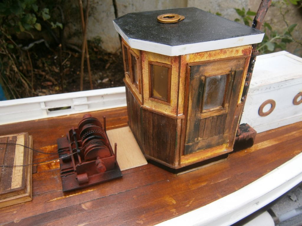

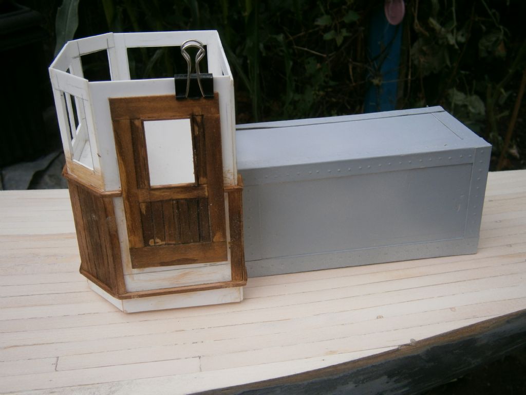

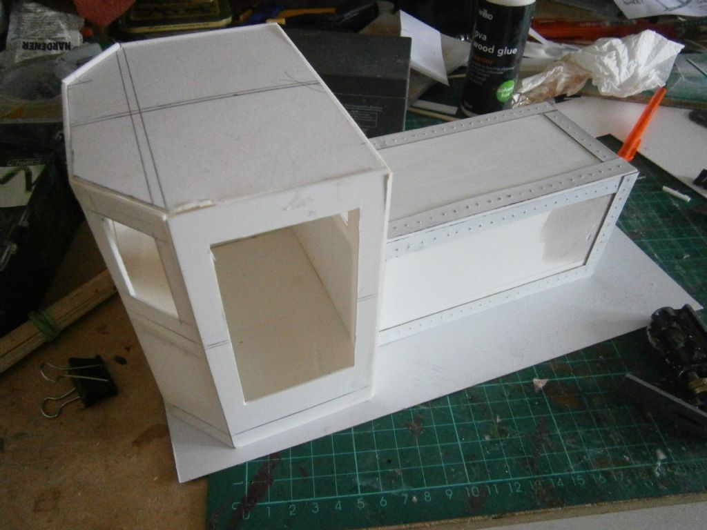

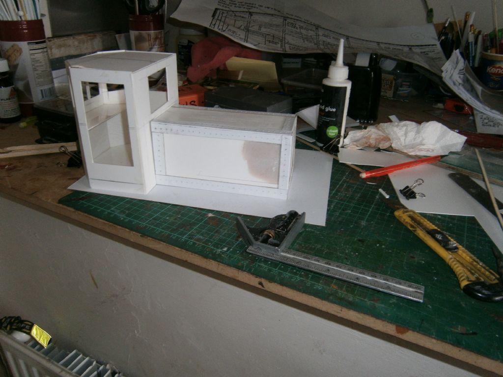

                  Good moning ,
                  Had another go at KINGFISHER, i was waiting for a new model to turn up ,
                  whent on back burner , now gone off plan build to to my version.
                  wheel house and engine room , altered styrene used , a bit of rivet added ,
                  canmber added to deck beams , and rough coat of black added to be sanded back to show hull
                  blemishes , also started on winch, photos show new model….smiley cheers Larry

                          wheel house half timbered and looking good ….
                          deck planking sawn and ready for camber deck ,
                          access hatches in planing ……..realy pleased with the nice lines of hull .
                          will suit many working boats ……….

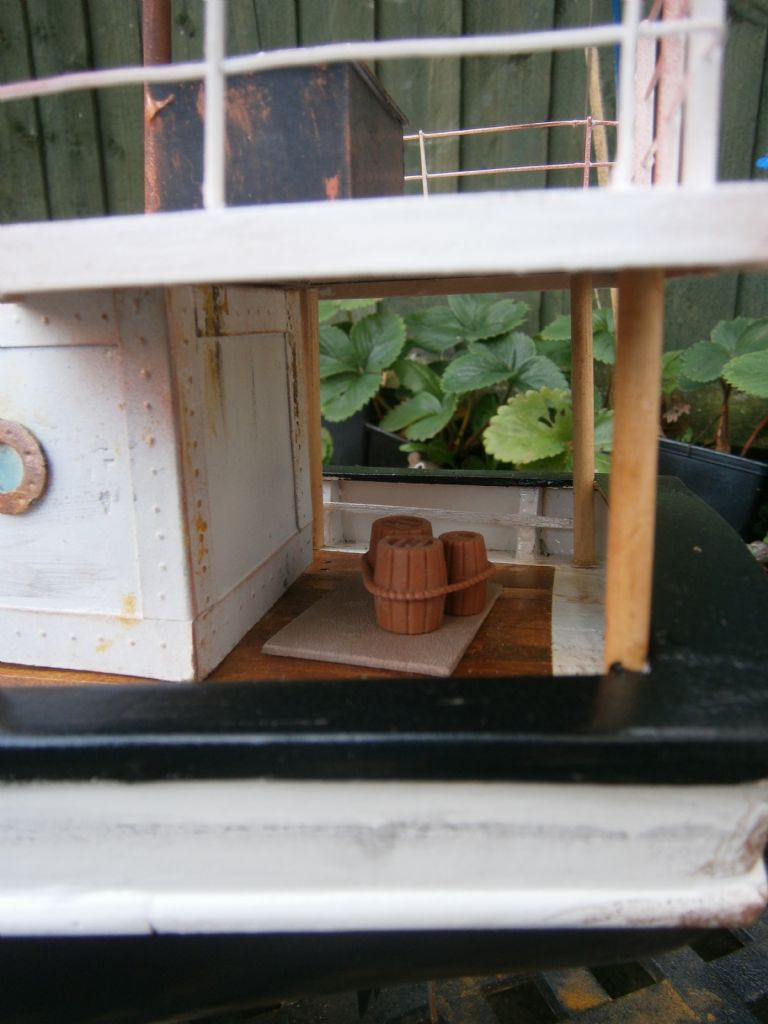

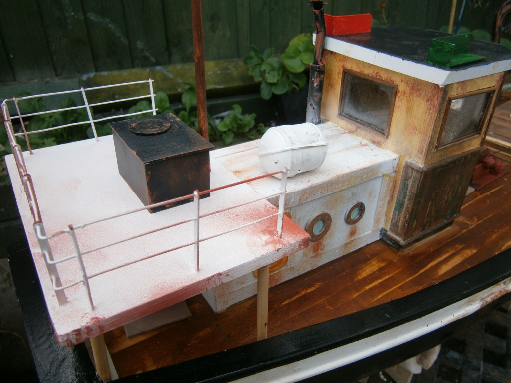

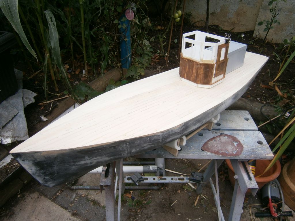

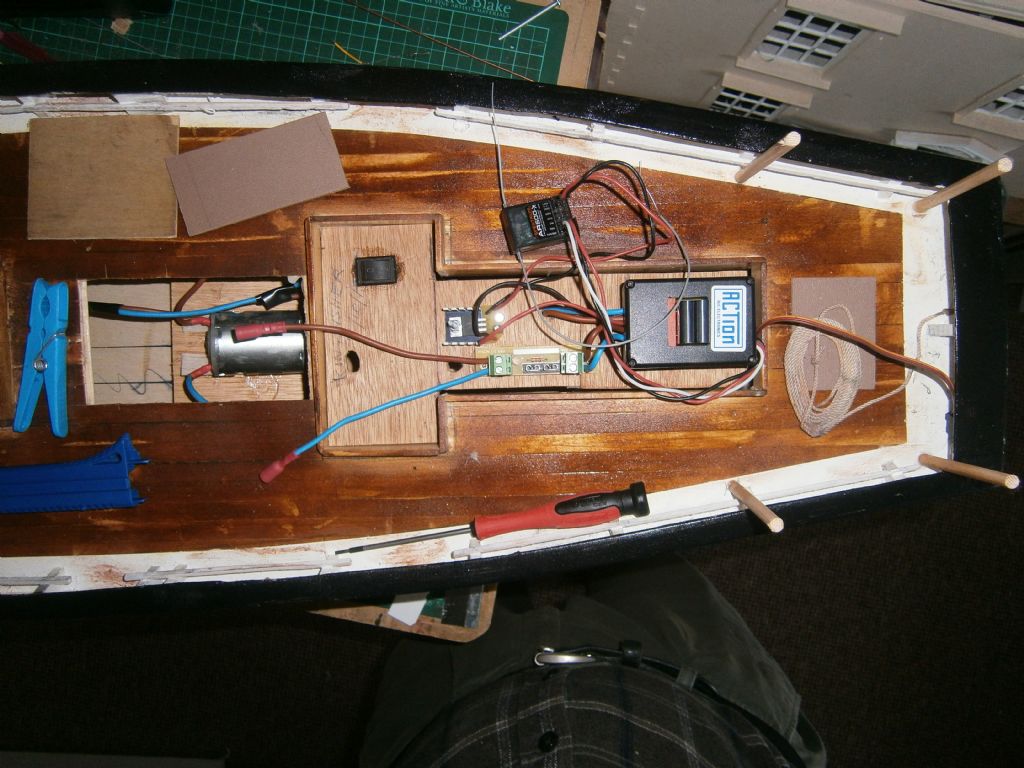

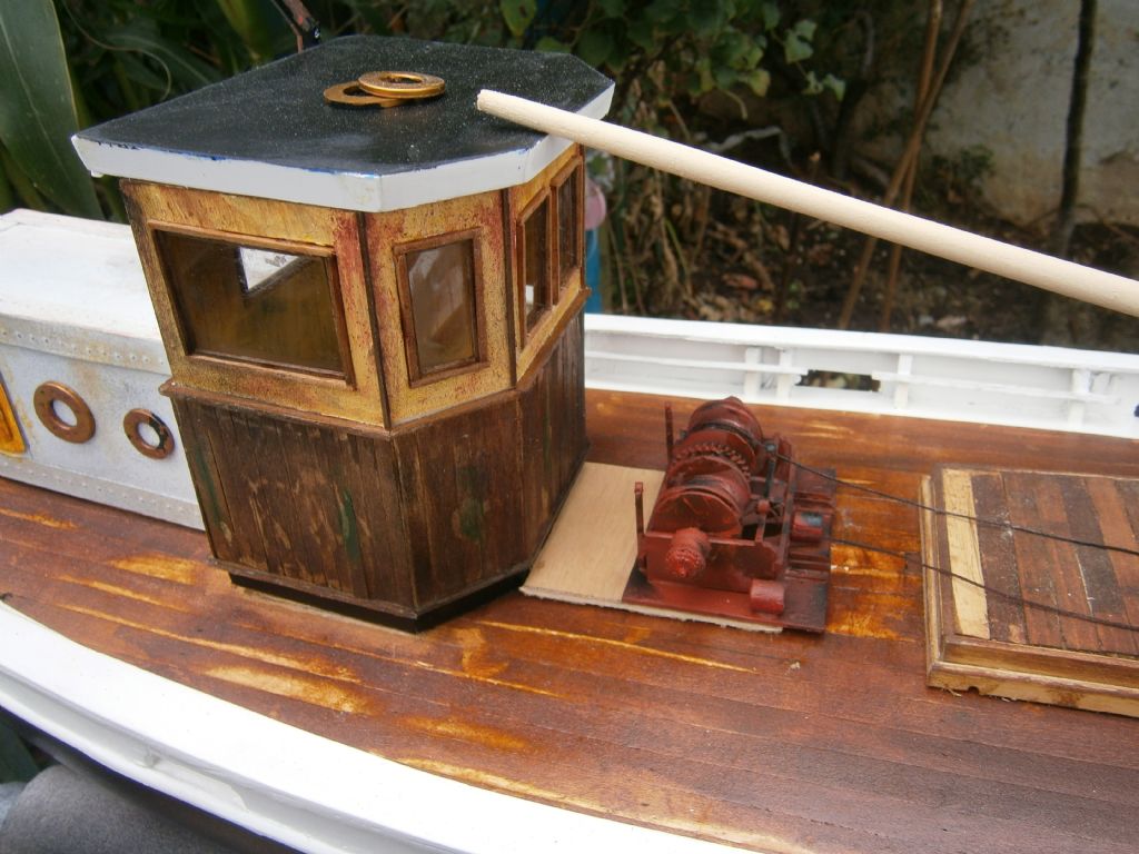

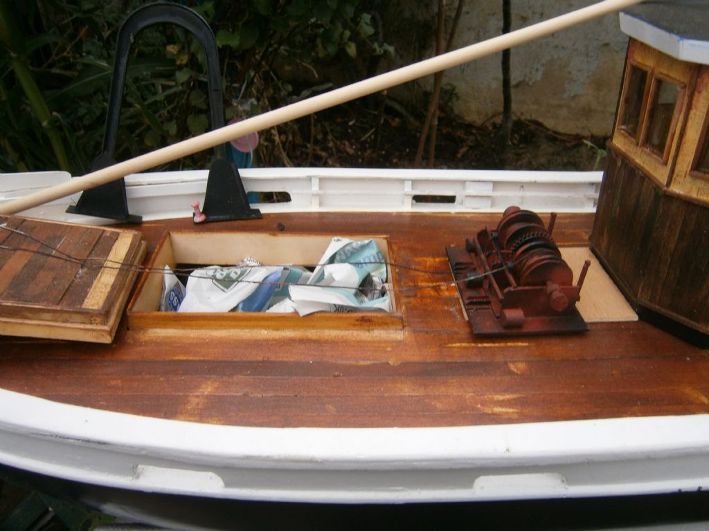

                                A bit more work on Kingfisher……….deck fitted using Ikea bind , wheel house planked using coffee stirrers, timber stain is ready to sand back will add weathing to deck and fit coaming and bulwarks next after striped garden of summer planting ready for autum planting ,
                                harvest toms in green house , plus peppers and cue cumbers , ready for seed trays its all go at the moment …plus granddad dutys …. cheers Larrry…

                                  just a quick up date , paint on going , bulwarks , complete , winch made fish hatch fitted ,
                                  will have photos when it stops raining cheers Larry…..

                                    Hello Larry
                                    Can I make a suggestion?
                                    Your planked deck doesn't look right!…..lol
                                    The deck needs a perimeter edging to finish off the plank ends
                                    It can easily put right by adding the edging on top of the planks, with some filler on the sides and using it for handrail stanchions. You can even paint the rim, same colour as the stanchions?
                                    Sorry to criticise, Larry……That's what friends are for!
                                    All the best…..Bob

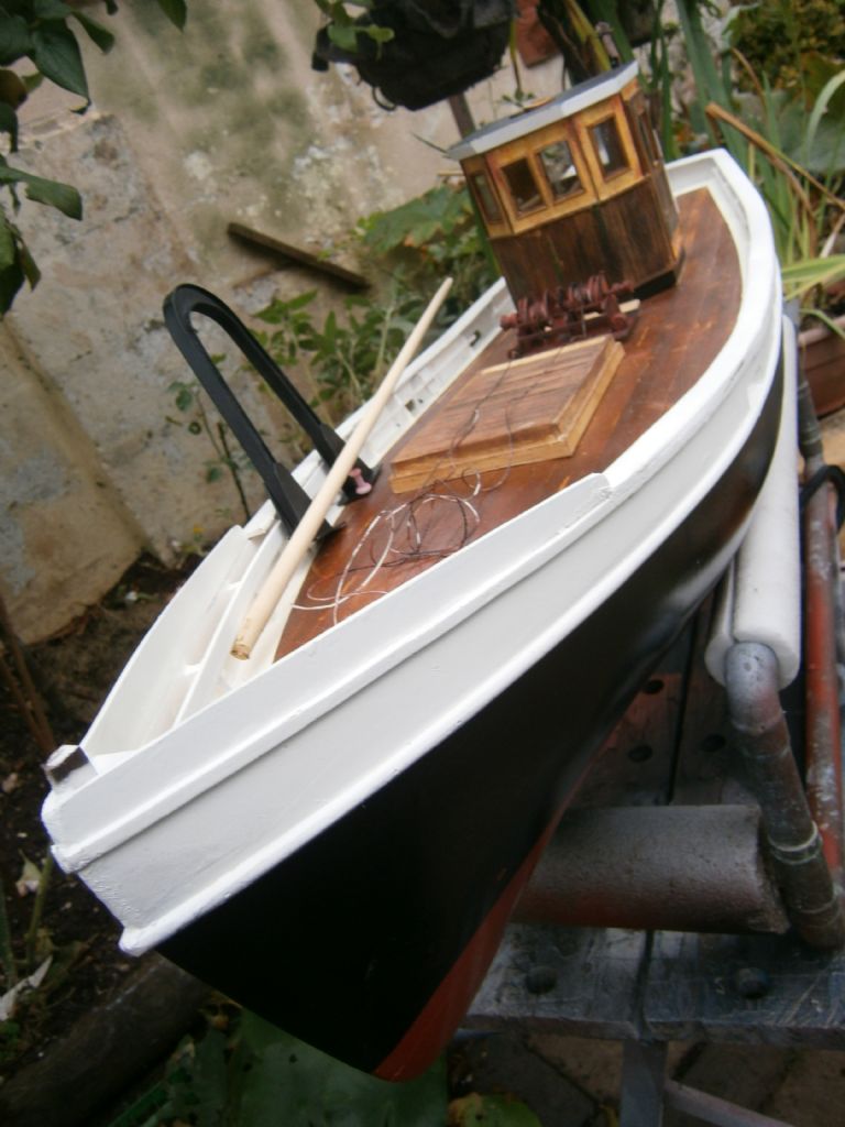

                                      weymouth 009.jpgweymouth 012.jpgThank you Bob,
                                      wait and see bulkwarks detail now being added , it as a wash port chanel all round ,
                                      nice and dirty , as small fishing boats are……. and off cause rust …..yes ……
                                      thank you for input……………………..Larry………………

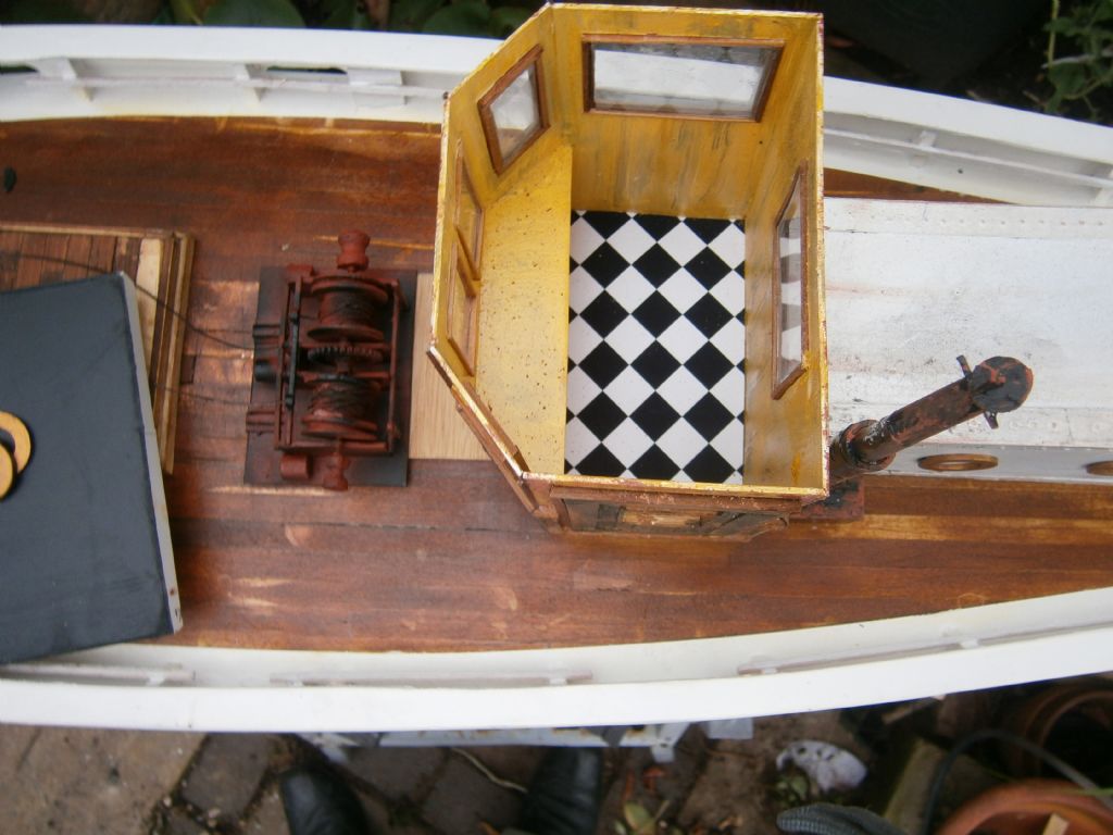

                                      #43909
                                      LARRY WHETTON
                                        @larrywhetton68737

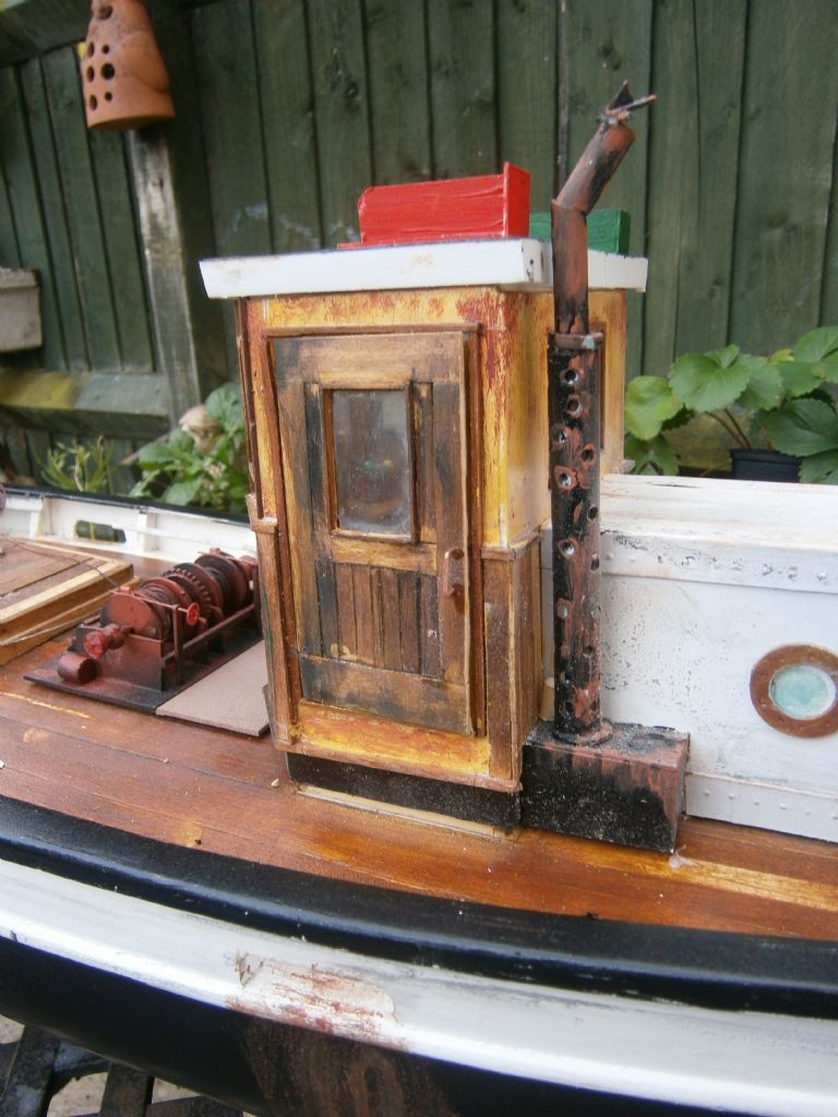

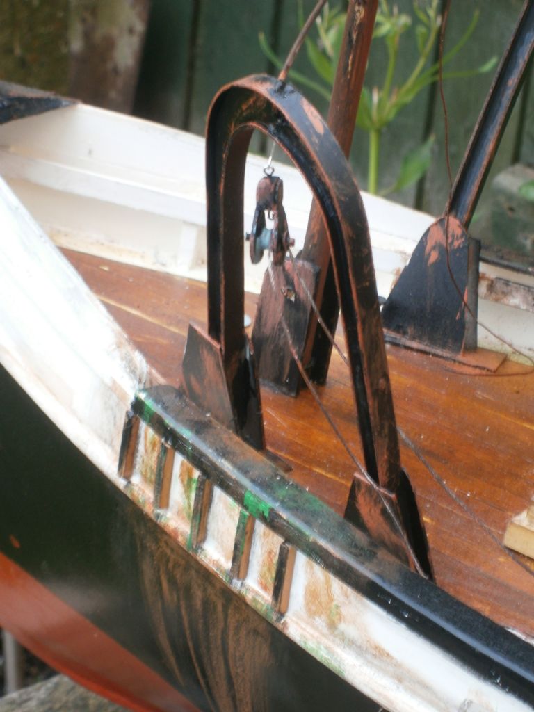

                                        kingfisher part5 016.jpgHello ,

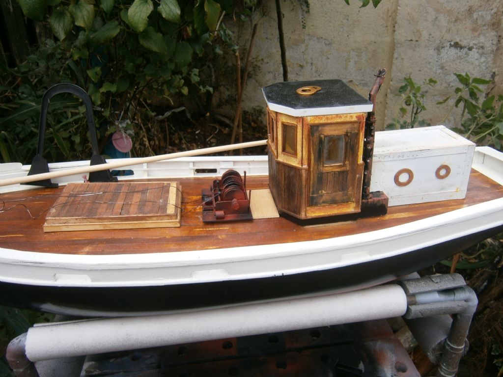

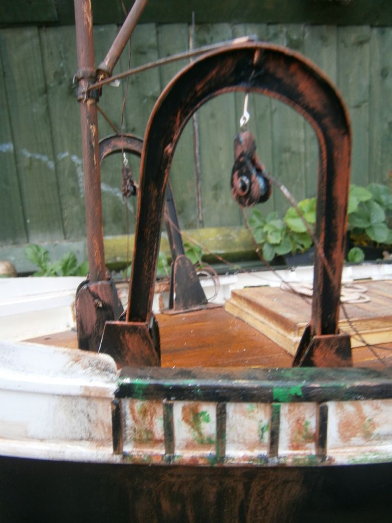

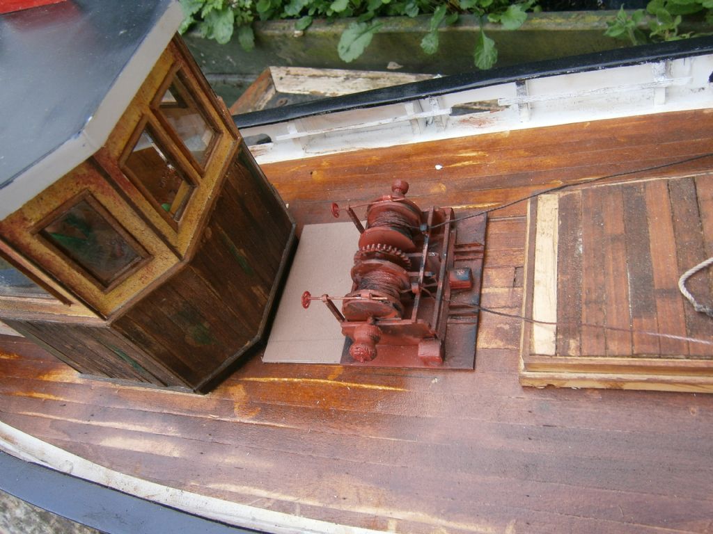

                                        Abit more progress , a bit of paint wheel house added ,. winch batt access galows started
                                        bulkwarks soughted , mast and wheel house fit out will be next…….cheers Larry..

                                        #43991
                                        Nigel Edwards
                                          @nigeledwards16506
                                          Nice work Larry love the old look, its comming along nicely…Love the winch and paint job on it where is it from?? Im collecting parts for my next build going to scratch build a stern trawler something like this hope to start soon..cheers nigelcapture9.jpg

                                            Thank you for looking , the winch was scratch built by me,
                                            i build all deck items if if can…
                                            and all my boats get the weather treatment,…….
                                            your next build looks good ,…….do have a cunning planlaugh….

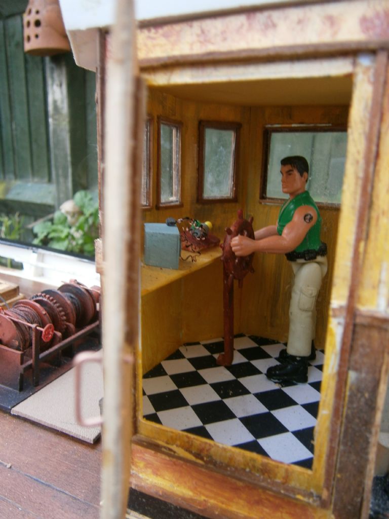

                                              kingfisher 7 (15).jpgHello,

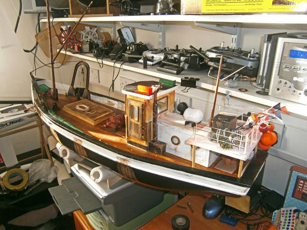

                                              Had another go at my version of Kingfisher fishing boat ,
                                              fitted gallows and blocks, wheel house skipper, a bit of dirty weathering,
                                              masts , life raft , thanks to kinder egg, and rear access deck for stowing clutter,
                                              test sail will at the weekend if the weather is good…..
                                              please be free to comment . cheers Larry..

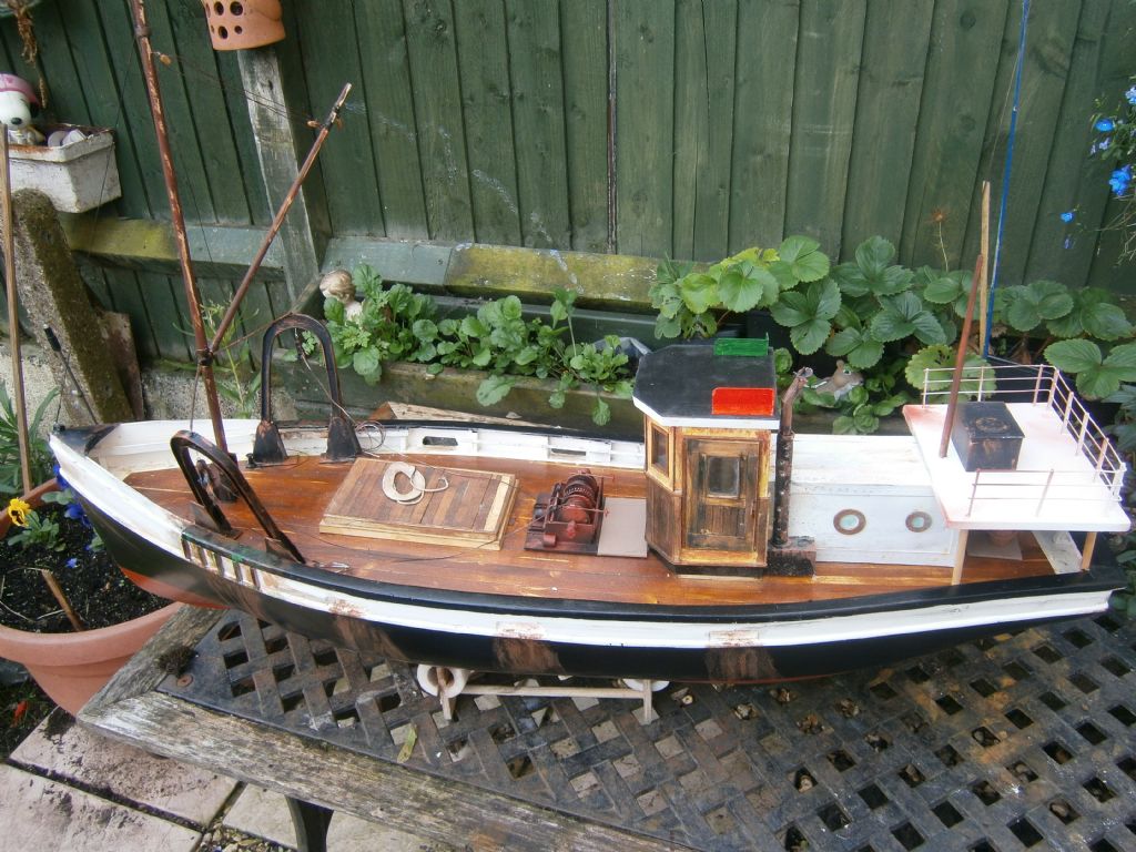

                                                  #44308
                                                  LARRY WHETTON
                                                    @larrywhetton68737

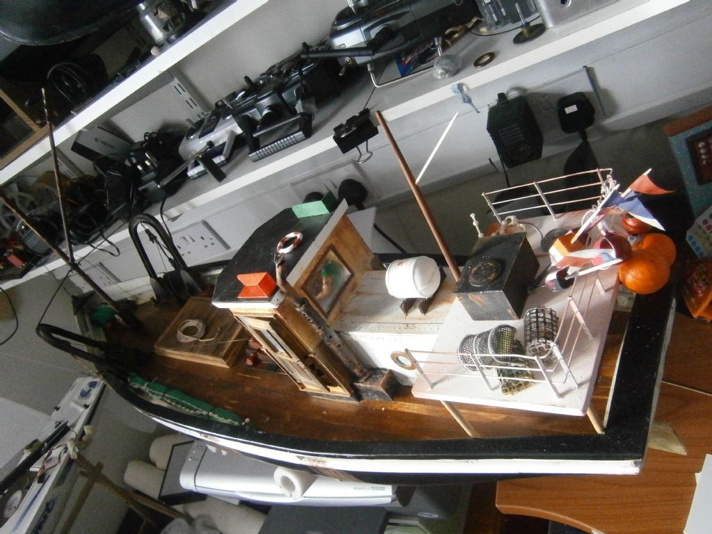

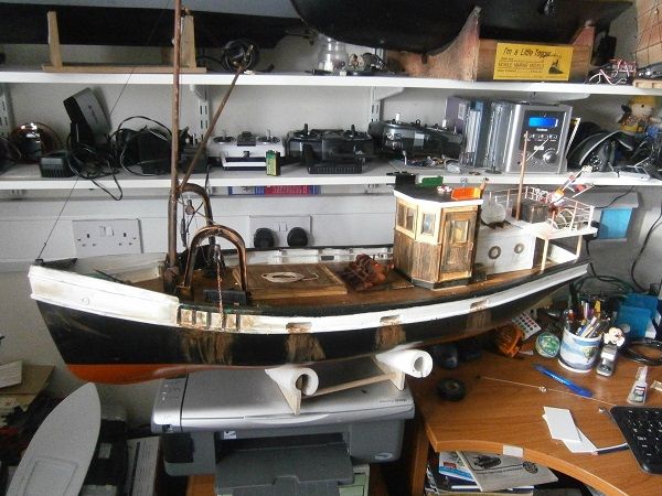

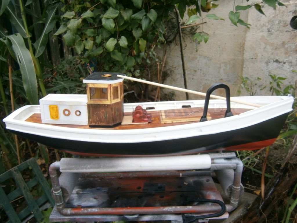

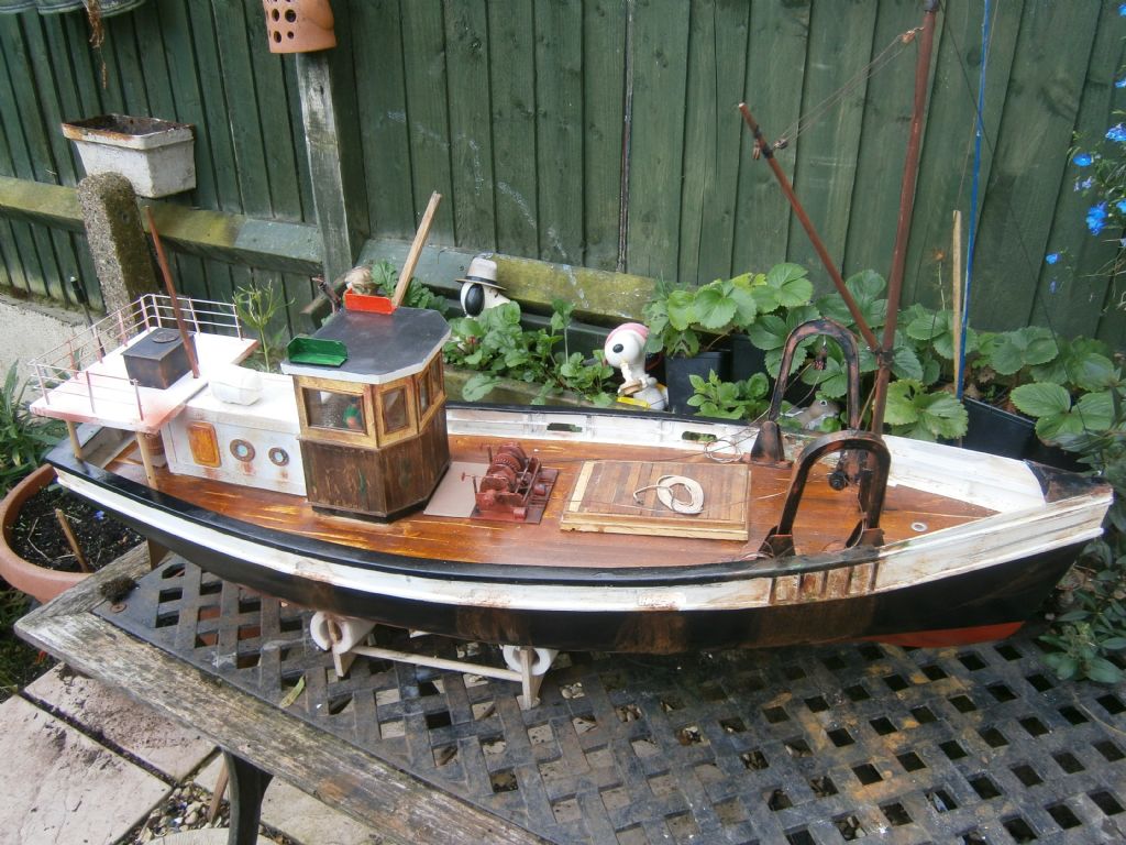

                                                    kingfisher  final 010 edit.jpg HI All,
                                                    fisher now ready to launch,
                                                    #44375
                                                    LARRY WHETTON
                                                      @larrywhetton68737
                                                      Hello ,
                                                      Launch went well , great steering model , a bit over propped 4 blade brass ordered ,
                                                      photo later cheers Larry…
