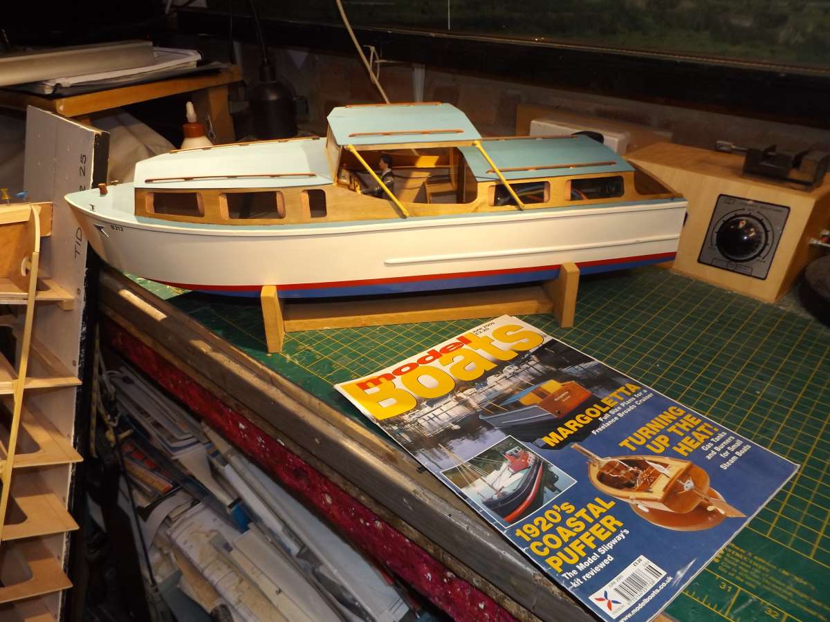

                                    I posted recently about finding the plans for Margoletta, Ray Woods broads cruiser from 2005 & got hold of a copy of the magazine & plan. I have decided to go ahead with the model for grandson. Ive not done a model like this or of this  construction before.
                                    Reading the article which Colin kindly put on features it says that the hull is finished with a couple of coats of dope or sanding sealer before painting.
                                    From what I’ve read over the last couple of years on the forum it seems more common practice these days to use Eze Kote and a fibre coating on the hull. Is that right? Is there somewhere I can read up on this please?

                                      Stephen,
                                      There are various options for finishing off the exterior of a hull. You can use the traditional way of sealing the wood with sanding sealer and painting over that and that is still OK.
                                      As you have noticed another way is to give the hull a toughened coating by covering it in lightweight glass cloth which is fixed in place with resin, either water based EZe Kote or alternatively epoxy finishing resin such as Z Poxy. Whilst the epoxy gives a tougher finish, it is messier to apply and for a cruising boat like Margoletta Eze Kote is more than adequate and a lot nicer to work with although it requires more coats to fill the weave of the glass cloth before applying primer and top coats.
                                      Fibreglass cloth 1oz 1m2
                                      On my current Silver Mist build I have used Eze Kote and glass cloth to seal the hull and it all looks good.
                                      Basically you just put a coat of resin on the hull and drape the glass cloth over it and smooth it out whist applying extra resin. You will get some overlaps but these are easily sanded out with a bit of patience.

                                        Thanks very much Colin, I wasn’t sure which weight of cloth to use so thanks for the link. You say “more coats”, I presume that’s coats of Exe Kote rather than cloth. I’m looking forward to making Margoletta as I particularly enjoy working with wood & this will be something different.

                                            Stephen, yes, more coats of Eze Kote. It is quite thin and water based so it doesn’t have much ‘body’ and thickening it is not recommended. It does however dry very quickly so you can put several coats on in the time it would take one coat of epoxy finishing resin to cure.

                                                Just another point Stephen, you will inevitably get some overlaps with the glass cloth and the occasional wrinkle but they can be easily sanded smooth. If you inadvertently sand through the cloth you can add a patch and feather the edges with sanding and it will all blend in.
                                                It is usually best to do one side of the hull at a time. Start with a coat of Eze Kote and then drape the cloth over it and pat it down with a stiffish brush. It is fairly flexible in adapting to curves but you will need to slit folds and overlap the two sides of the split. They will blend in when you add the first top coat of resin. Then it is a case of just adding further coats with light sanding between until you fill the weave of the cloth. If necessary add further coats to cover blemishes etc. Once you have got the hull smooth you can switch to primer paint for the final finishing.
                                                With Margoletta, much of the hull is flat sheet so getting a decent finish shouldn’t be too difficult. Silver Mist with its curves and planking needs a bit more effort!

                                                  Having not built a model like this before it would appear that Margoletta is a good one to start with, especially as grandson is such a fan of Swallows & Amazons as its for him. I’m looking forward to it. SLEC order is on its way.
                                                  Stephen
                                                  #126458
                                                    Hi Stephen,
                                                    I’m glad your building Margoletta as she was my first published design 20 years ago !!, although freelance I tried to add the character of the older wooden Norfolk Broads Cruiser, not sure if you had the free plan and magazine, she still gets on the water a couple times a year 🙂
                                                    The Swallows and Amazons books series by Arthur Ransome is where it all started for me .Margoletta June 2005
