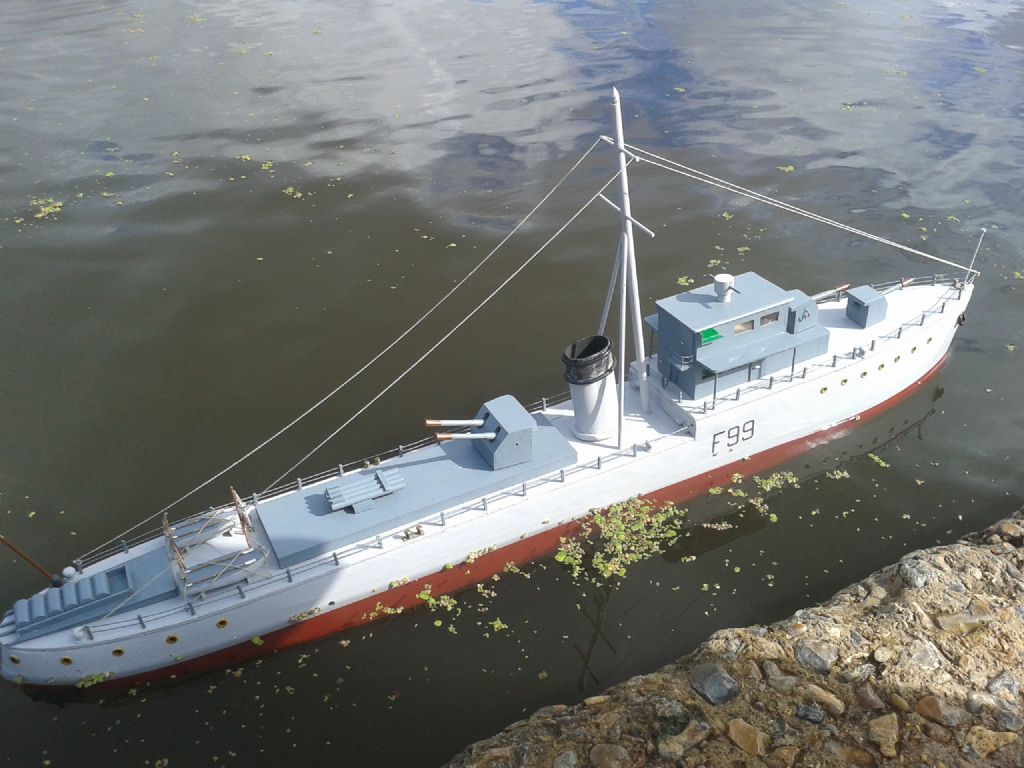

      Here is a lovely old Destroyer that I was lucky enough to pick up on ebay recently.
      20170722_114320
      The gentleman I purchased it from had acquired it in a poor state and re-built it from the deck upwards. He also had a handful of old box-brownie sized snapshots of it in it's original form (which was not dissimilar to its rebuilt state).
      On the back on one photo it is written "HMS Thunder", so I intend that that shall be her name! Although I have not found any documented Destroyer or similar sized vessel ever named this.
      The hull is from a single carved piece of timber and is quite a nice shape.
      Only had about 1 minute of time on the water before the UJ came loose on the prop, but it went well. There was an action electronics Destoyer siren with it that I just need to connect up.

          Is that the mascot on the shelf???
          ​Can confirm, very nice boat. Hewn from a single mighty oak (possibly) and finished to a good standard. A few additions and it will look really nice.
          Notr to Noel: check your nuts before sailing….

              He he, didn't notice the dog sneaking into shot. He is very easy to look after, just requires AA batteries.
              I can't work out if this is really a Destroyer or a Sloop or something, but it looks more Destroyer-ish to me.
              I am going to make the turrets rotate (once the important stuff is done like a prop that actually turns), and add some signal flags.
              One thing that strikes me is the depth charge rack at the stern prevents an ensign being flown… would a vessel such as this have a second mast of some kind toward the stern for such a purpose?

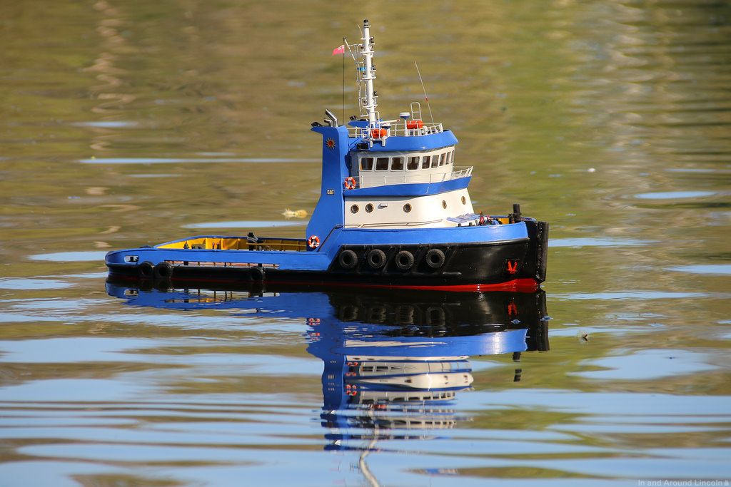

                  It would be flown from an ensign staff attached to the rear of the mainmast, or the second mast if fitted.
                  Ensign staffs were also fitted to the left of centre at the stern if they could not be mounted on the centre line.
                  #72040
                  Kev.W
                    @kev-w
                    My tug shows how an ensign staff is located on the main mast, albiet for a red ensign in this case.
