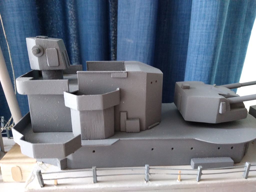

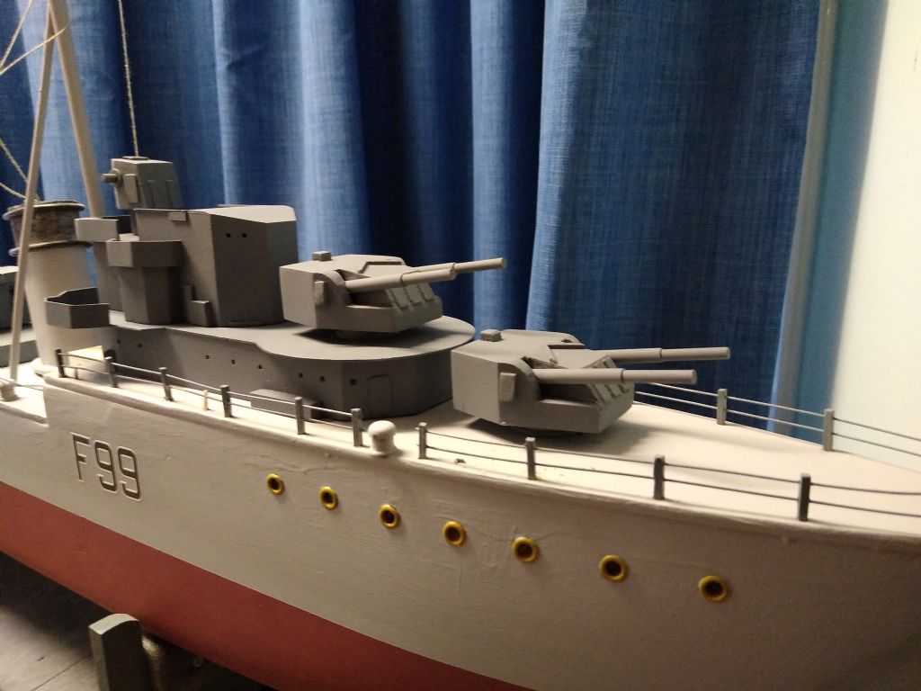

                    After nearly 2 years I have made some progress with new superstructure and guns that look more like a war standard Destroyer.
                    Bridge and A B turrets done. More detail to add still and still have to work my way to the stern, but it's been fun scratch building in balsa and ply.
                    Do need to replace the huge port holes next as it messes up the scale somewhat!

                    #82889
                    Noel
                      @noel26080
                      #82896
                        Good stuff Noel, and what a difference. Will end up to be a really nice boat, although as it was it had a certain nieve charm to start with.

                          Very nice! The forward superstructure reminds me of the L & M classes of destroyer, especially the gun mountings which look like the Mk XI 4.7", rather than the Mk VII of the J, K & N classes.
                          As an aside about ensigns: during wartime they were worn continuously from either a gaff on the mainmast or a stump mast on the aft superstructure. An ensign staff is the peacetime harbour position and when in entering or leaving harbour. It is then shifted to the sea position.

                                  Very pleased that Martin Honor recognises the look of the L&M class, because that is exactly what it is modelled on.
                                  I had to adjust the proportions a little because the forecastle is shorter in proportion on this old model than a real L&M was. I have also removed all the wobbly handrails and added some hawse pipes and windlasses. Also sports Oerlikons, a quad pom-pom and a 4" AA gun.
                                  The crack was solved by Tolleys crack cure and PVA glue, did the trick. The whole hull has since been rubbed down, skimmed with marine filler to fill the crack, and now sports 1943 Mediterranean pattern camouflage. Should put a picture up really as it looks totally different now.
