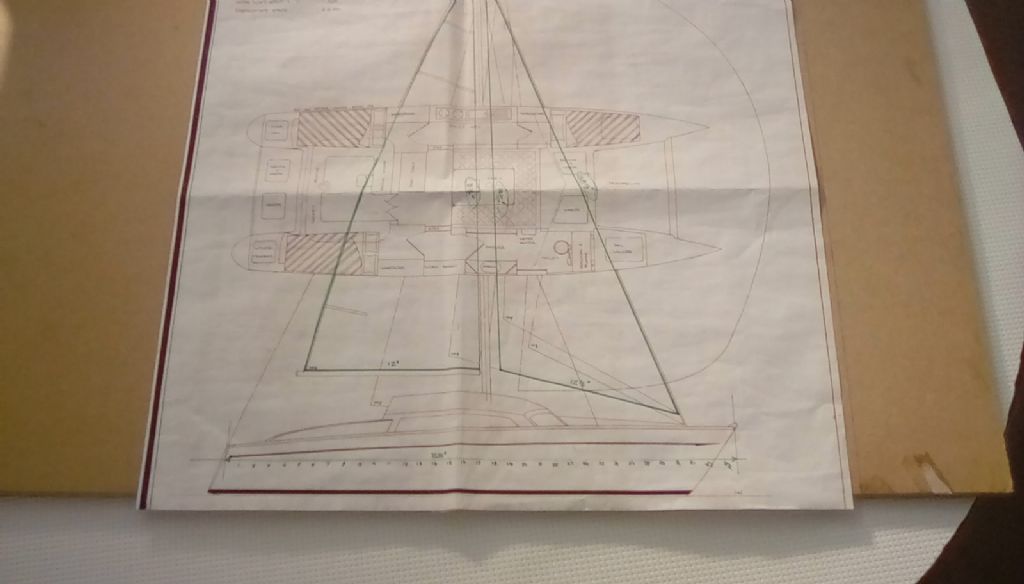

      img_20200408_153432.jpgHi All,
      This is one of my longer running projects maybe 3 years so far 😀 I had access to the builders drawings from 1978 and thinking this would make an interesting sailing model, the original boat is grp but I have made the hulls of blue foam and the bridge deck of depron & glass cloth & resin, there are some earlier pictures in my album, I now need to build the rig, I have some sails from Frank @ Nylet and with the lock down now would be a good idea to finish it off at last she is 32" long 😃

          @timrowe83142
          Hi Ray
          I have seen your album photos and have been following.
          Tell us some more. Is the rig scale? Will you be having internal or external ballast? Are you adding fins as well as the keel that look like they are scale?

            Hello Tim,
            Yep we are going stir crazy !! We can walk for exercise, go to the shops for vittals and that's about it, same where you are? The cat has had a blow over with primer and looks promising, it will have the scale rig, probably with a ping pong ball on top of the mast just incase, it will have twin detachable fins & lead bulbs as the Wild Duck, extension rudder are made to add to the scale one's, I will see if it sails without the fins? The lightweight construction I'm hoping it floats on it's scale waterline 😀 I have a bargain Hitec lever servo for the main sheeting, probably a self tacking jib on a horse.

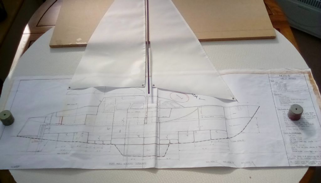

                  Morning Guy's
                  There are some photo's of my kit built H31 in my album, only the outside, no woodwork.
                  Comanche day today, I have a small scale rig GA just trying to scale it up for the mast fitting positions etc 😀

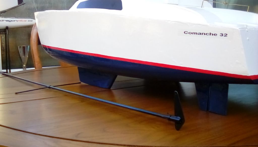

                      To do anything other than drift downwind, all sailboats need something in the water for the force on the sails to act against. A rounded hull might not be as effective as wanted.
                      So some kind of fin, even if it isn't weighted. I did read about a type of sailing punt (flat bottom, vertical slab sides) that relied on the slab sides effect when heeled over doing that job, but I suspect that if it worked that well, it would be a very common arrangement.
                      #86672
                        Hi Malcolm,
                        The full-size boat sails with the stub keeps that are moulded into the hulls, but to improve the ritbg dec 17 006.jpgghting moment I will have removable fin keels as I use On my sailing barges. But it will be interesting to see if she makes any headway to windward without them?

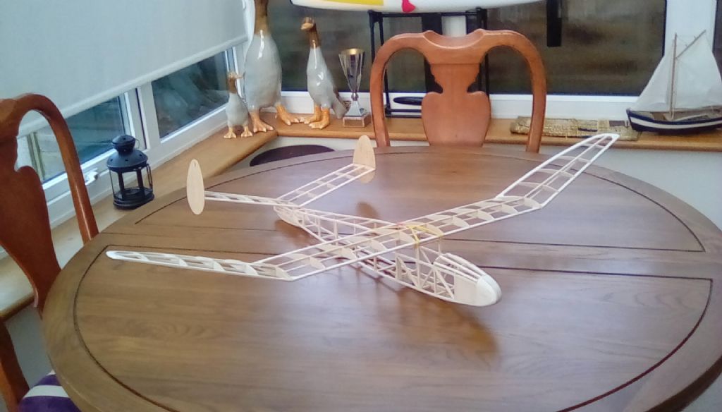

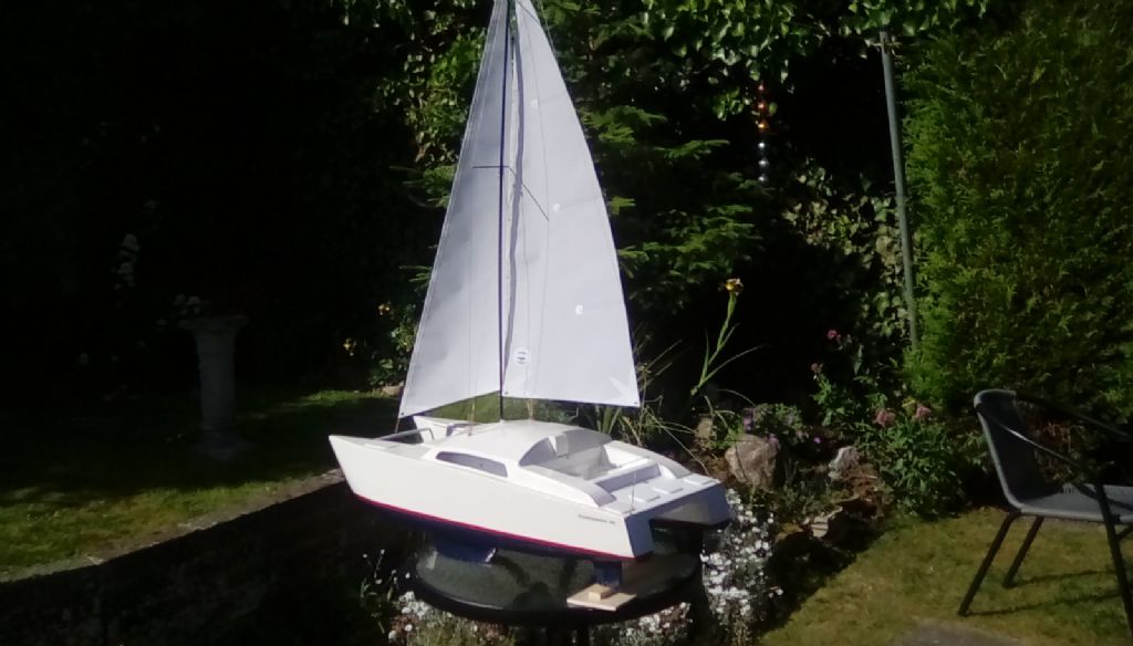

                          img_20200410_192531.jpgHi All,
                          As variety is the spice of life 😀 I have been going back to being 12 years old and built another KK Invader glider, only 52 years later, all that 1/8" X 1 /8" balsa strip really sorts you out ! !
                          Oh and Comanche sails & carbon tube mast 😃

                                I doubt that the weighted fin pictured would be needed, but I do wonder if those mini fins would be effective. An article from waay back suggested a fin area between 5 and 10 percent of the sail area was good. The writer was discussing designing Marleheads, but I expect that the principle applies across many designs, including multi hulls.
                                #86698
                                  Hi Malcolm,
                                  Yes it's going to be interesting , apparently it's not that hard to capsize a cat if you try hard or are not experienced !
                                  But unlike a monohull yacht which eventually spills the wind when it reaches a certain angle, the cat also gets wind under the flying hull which makes it happen really fast !!
                                  Time will tell 😀

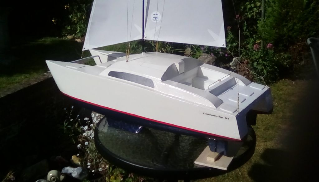

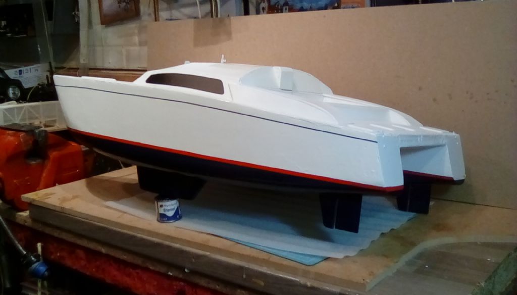

                                      #87306
                                        Another long running project this is starting to gather momentum, started with all the white spray primer I had On the whole thing, then with the water line marked on with 6mm Tamiya masking tape the bottom of both hulls Humbrol dark blue, white gloss good idea & red gloss waterline. I'm getting more interested in finishing her off now 😀
                                        The black line in tape not a great idea, now removed. Black Fablon windows.

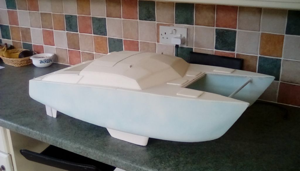

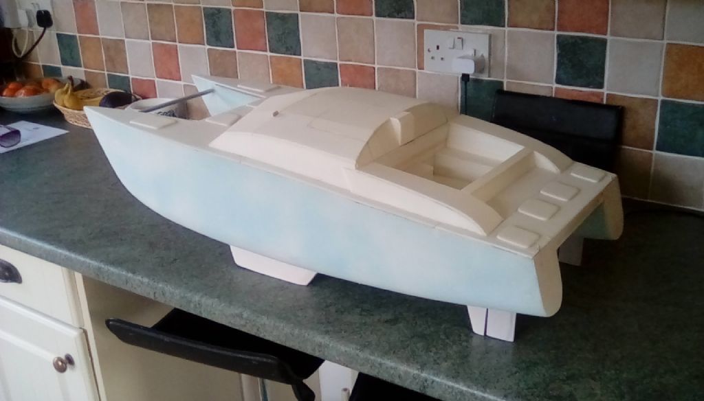

                                        #87309

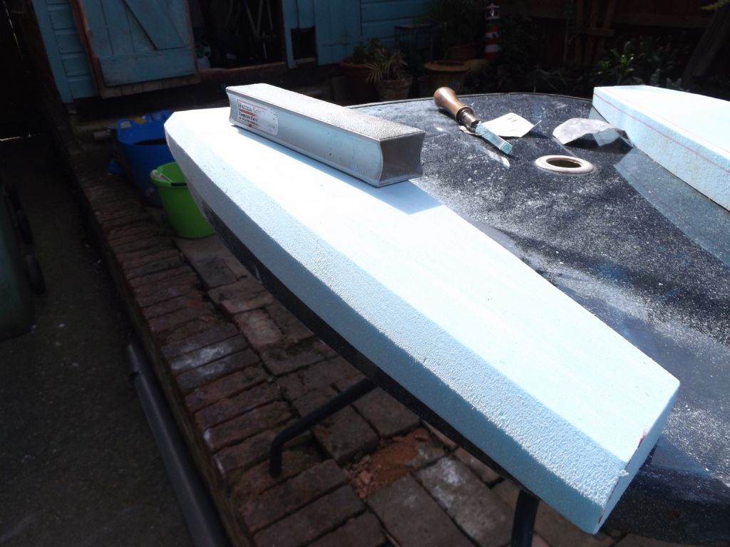

                                          com hull shaping 220419.jpgHi All,
                                          Just to let you know how this cat started life as 2" blue styrofoam, with Depron bridge deck.
                                          #87310
                                            Looking the biz now Ray.
                                            The work you've done on that foam shows that as well as other skills a bit of being a sculptor is required as well!

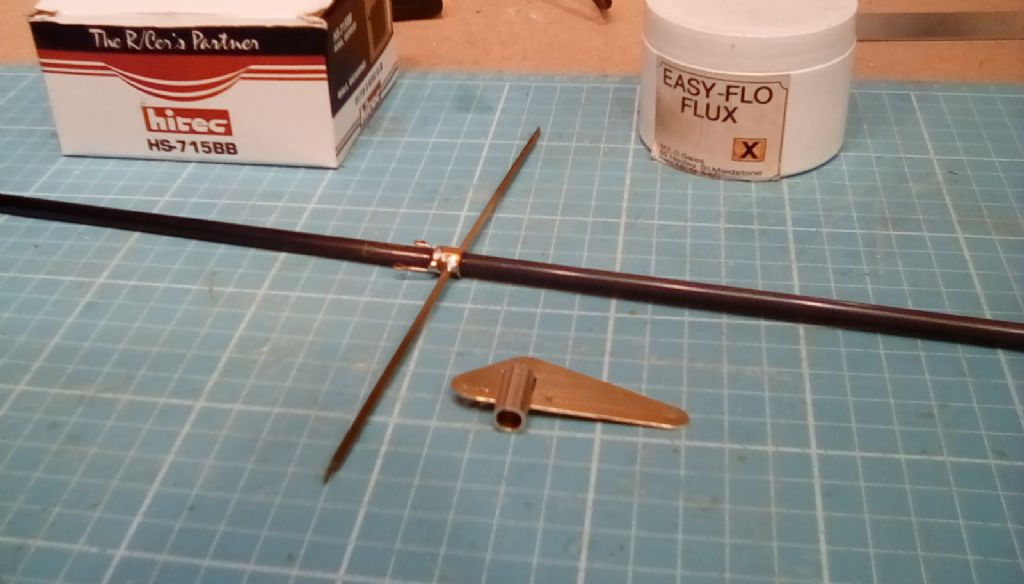

                                                  img_20200521_175551.jpgHi All,
                                                  Good day in the rigging shop (conservatory) with stainless steel nylon coated fishing trace for the standing rigging, copper tube crimps & the expensive part the 7 bottle screws and her lovely new Nylet sails, booms & more bits tomorrow 😃

                                                      Hi Tim,
                                                      Yes I'm determined to finish this one, rather different from normal monohulls but the same with the rig !
                                                      The all up weight is just 3 lbs as she stands, I have a mini servo in each hull, I'm going to install a Hitec lever winch on the bridge deck for control of the main sail & leave the jib as self tacking on a horse. This is very much barge type technology, I'm not to worried about speed on the run, not much danger of her pitch poling ??
                                                      The removable fins will be my standard 1 1/2 lb lead bulbs as used on Wild Duck about 8" deep to start with
