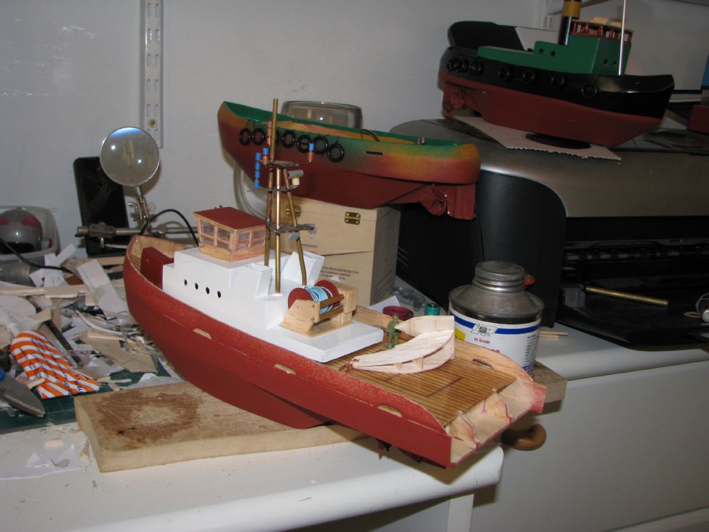

                            #40659
                            Dodgy Geezer 1
                              @dodgygeezer1
                              Have you seen the Beaver tugs on the site? 12" with a pulley-drive )though at least one builder has doubled the size and gone for gears).
                              Here's a picture of a few, with one modified stern to become an AHV…
