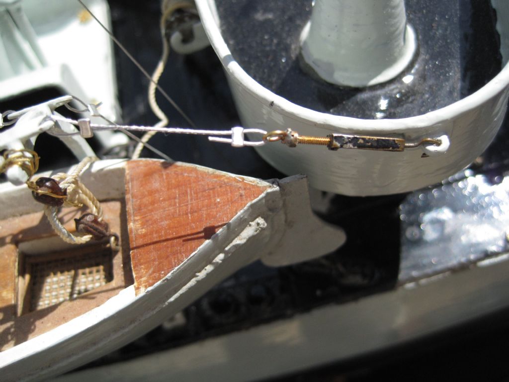

                  I have used beadalon 7 strand nylon coated stainless steel wire (I also use their very small crimping beads) :
                  Here is an example of the use of that wire for rigging
                  Ian
