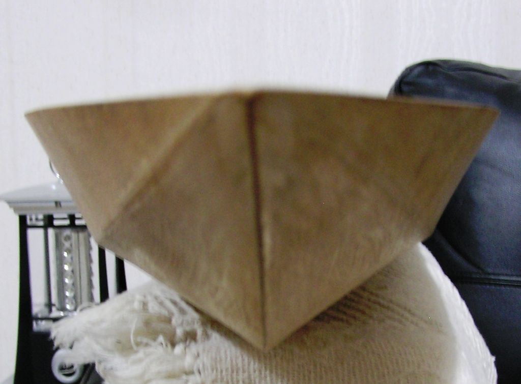

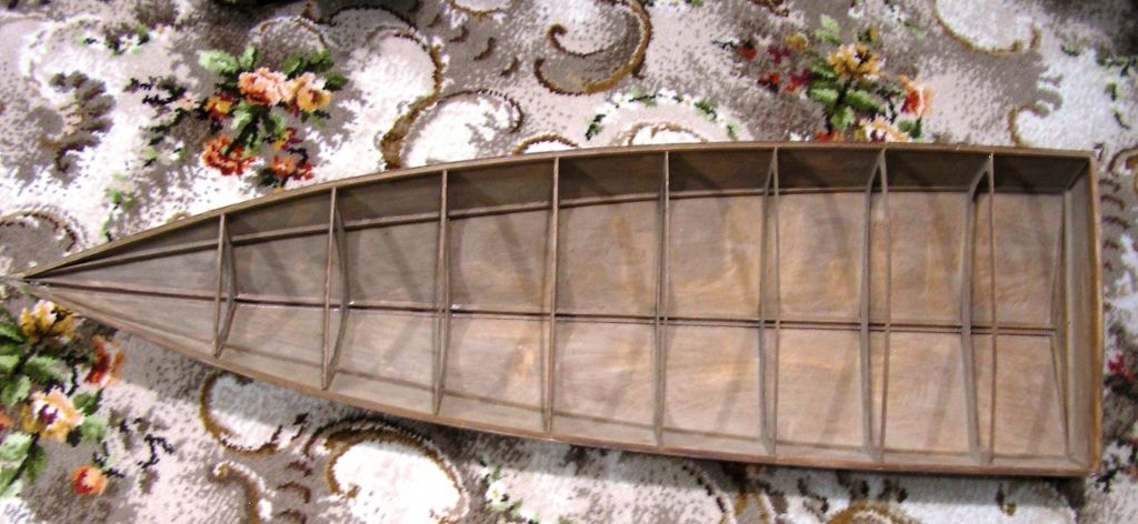

      p1010005.jpgp1010004.jpgHi Guys
      My mate received this boat today for free.
      Length 1000 mm x 300 mm.
      It was a plan in Model Boats Mag. in the 70's or 80's and was to be IC powered.p1010003.jpg
      #4371
        Vee Hull

          Looked a bit like the SNAPPER or CATCHALOT to me… but neither of those are 39" long. 39" would have been on rather the large side for those days.

            Hi Dodgy
            It has the Snapper very pointed bow but not the Catchalot drop bow.

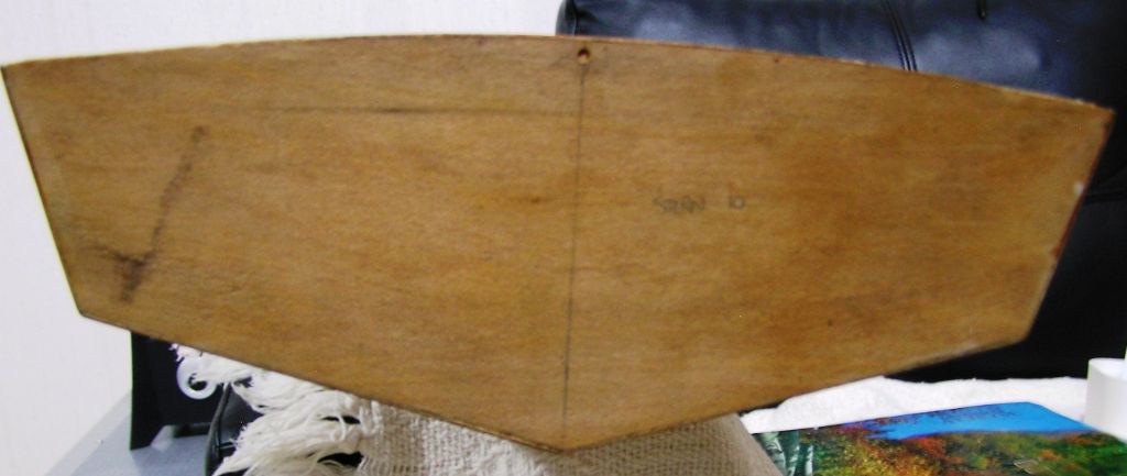

            The stern is straight up and down.
            The boat is made from 1.5mm marine plywood with a few very light stringers.
            The deck has a slight curve.
            As we have the plans of the Wolverine, we thought a straight stern slightly smaller version with a 1450kv 35mm brushless motor.

              …and no obvious prop-shaft that I can see…
              The boat bulkheads and keel also look a bit thin and delicate to me for that period. I don't suppose it might be a plan which has been scaled up a bit while keeping the original material sizes?

                He has used the 1.5mm ply in three one length pieces and glue together.
                The stringers are only 3mm square and the transom you can use it for a mini drum.
                We are think of added spray rails and strengthening up the transom.
                A few coats of vanish, making a fibreglass mould so we can make it into a cabin cruiser(aka Wolverine) or an offshore racer.
                As it is the hull is nicely made but to weak to use as a RC boat.
                It was free and it's not on the tip, also 1/2 sheet of 1.5mm plywood.
