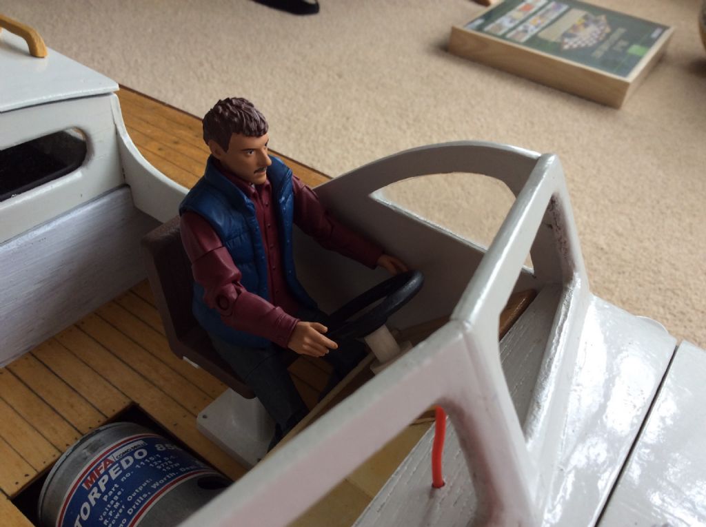

                    I never updated on here with the figure I eventually got to helm the boat!
                    He is a 5" Doctor Who character called Rory. I chose him because he is sensibly attired and his arms and legs are quite mobile.
                    I have added a moustache, which I think gives him the kind of gravitas required to helm a substantially sized and powered motor craft!

                      Hi Noel
                      Beautiful boat with a handsome pilot.
                      He waits for a fair maid to travel with him !!!!

                        By the looks of things he is sitting next to a 5,000 hp electric motor judging by the size of it !!!
                        Can you remind me what the squiggly red wire is please??
                        #72377
                        Noel
                          @noel26080
                          It is the antenna from the DSM2 receiver that is mounted in the ceiling of the forward cabin. Was the highest place I could mount it, and also convenient because the antenna could poke through into the open air.

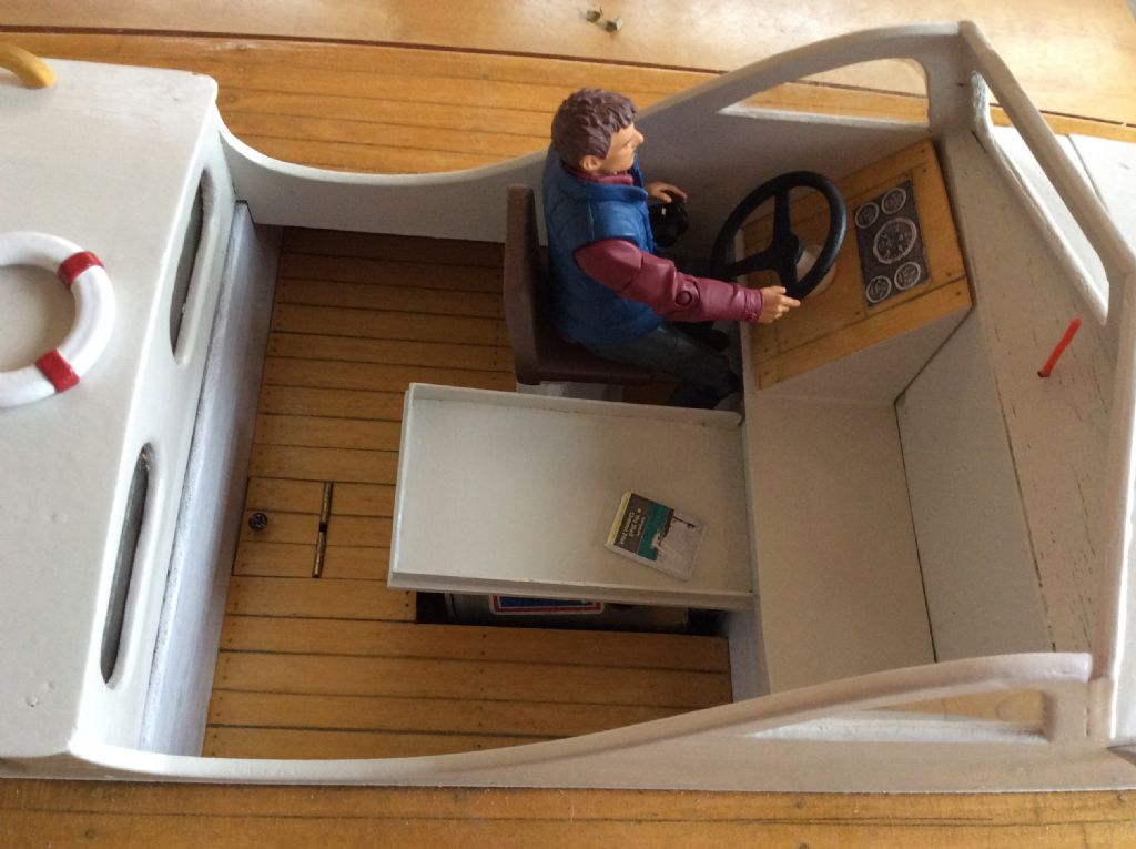

                                  After some months, have finally added an engine covering table (with miniature Channel Pilot book) and some decent instruments.
                                  There's also a little hatch in the floor so you can oil the propshaft without having to dismantle the interior.
                                  Still need to glaze the two windscreens but haven't found something suitably tinted like the suggested day/night thingies. On the lookout in charity shops etc.

                                    Table looks good Noel. I have some transparency stuff which will do for the glazing but clear only.
                                    HOWEVER I have lots of it, so you could take several sheets and experiment using thinned down paint for a tint?
                                    #74536
