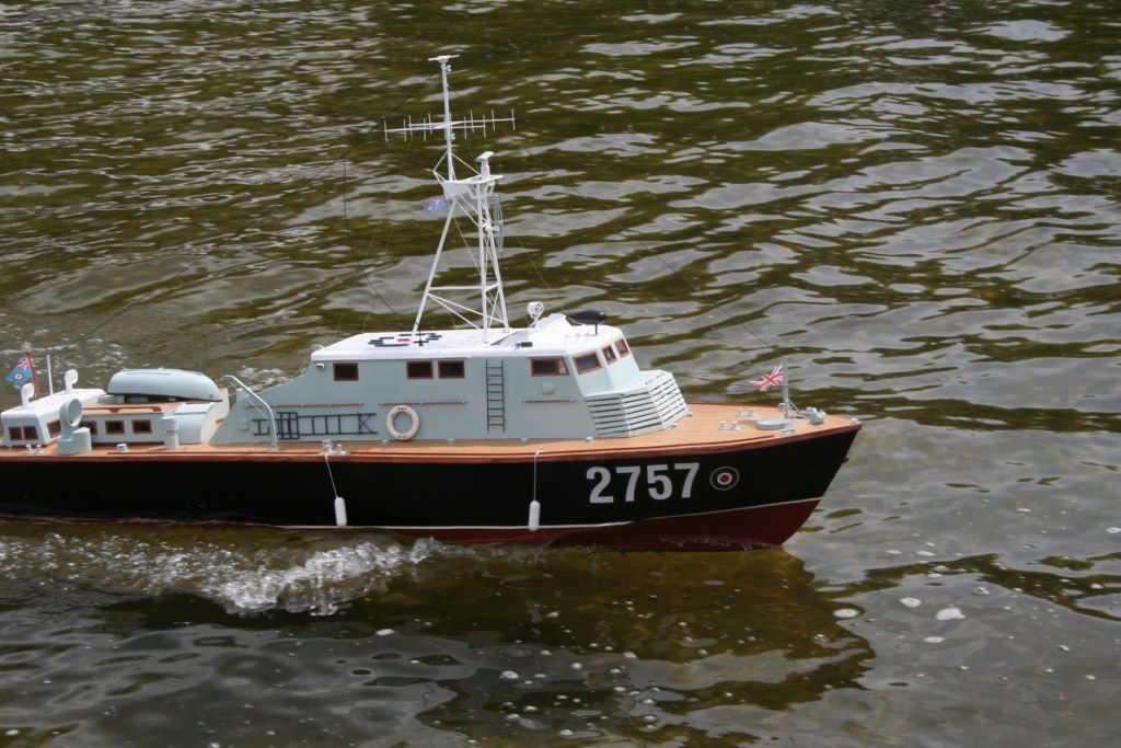

          The photo below of a 2757 model was taken at a Model Boat Mayhem event in 2007 and shows the boat with a planked deck.

            Many thanks Colin. A good planked deck always looks so much smarter than a painted one. Just a comment on the pic – the skipper should be keelhauled for running with fenders down!
            Regards, Rob
