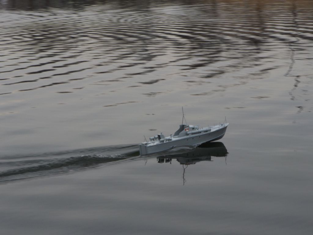

        f22 mtb71 feb 17 004.jpgHi All
        The saga starts 20 years ago when my wife and I had a look round a Portsmouth Navy day and seeing the preserved MTB 71 afloat in one of the basins, I spoke with one of the guys on board about making a model he kindly sent me an excellent drawing with the lines and sections . Now having a grandson of 11years old I had a good excuse to build the model at 1/2" to the foot, so the model is 30" long and took roughly a year to on the water. Powered by 2X 400 size brushed motors turning opposite handed 25mm 3 blade props, with a Perkins 50 Amp speed controller and a 3 cell 2200mh Lipo battery, this gives a good scale planing speed for about 10 minutes. The interesting and different features are the twin transom hung rudders and the double diagonal planking from 1/64" ply, photos of the build in "Ray's Boats" album. Now its been on the water, crew flags and numbers to complete

            Ray. That's a good speed for such small conventional brushless motors!! I like the speed 400`s, a fast little engine.
            ​The stern looks very…startk..in the picture, almost as if it has been made much too deep. Obviously this is how its meant to be, but it does look odd?

                    Pilloried for making serious comments….what is the world coming to !!! surprise
                    (Ray, you should have tried bigger props….)

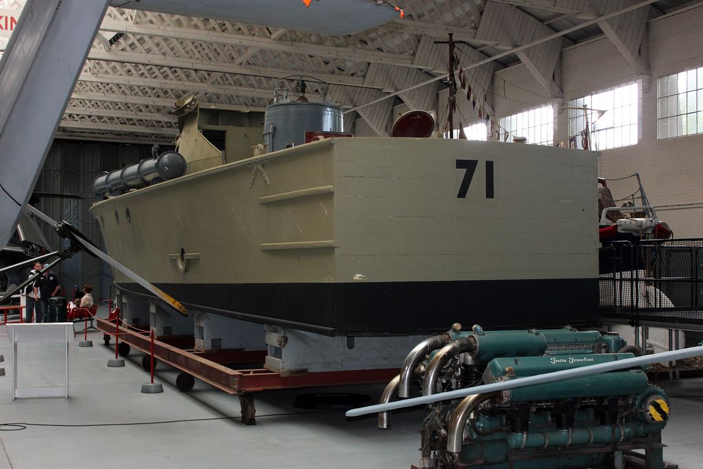

                        Dave/Ashley
                        Here is the real one at Duxford

                          Ray
                          I see no rudders….
                          #70492
                            It was used as a houseboat for years and lost her bits, only a cosmetic external restoration and paint job, they have fabricated new torpedo tubes and gun tub, hence the different colours. I nipped up to see her at Duxford before Christmas only to find out she was moved to a new location near Portsmouth for a new Coastal Command Museum ? but not been confirmed yet. I reckon Harry would put some big brushless motors and X50's to get her moving
