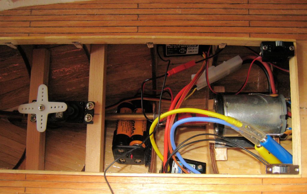

      just made a boat using a 20amp viper speed controller and did my first voyge to day and worked fine ,once i brought theboat back to me just to check on it i turned it of and then when i turned it back on it was totally dead,so went home and opened the boat up and what i noticed is when i turn the power on the speed controller light only goes to red and before on start up it flashed red and green then worked .
      can anyone help me please
      ps just been looking at it again and if i press the little button on it it flashes on the green light and then goes to the red one but still nothing
