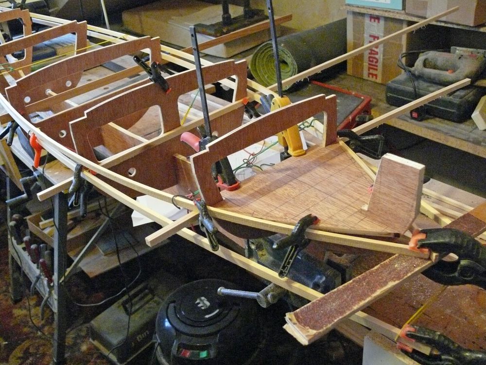

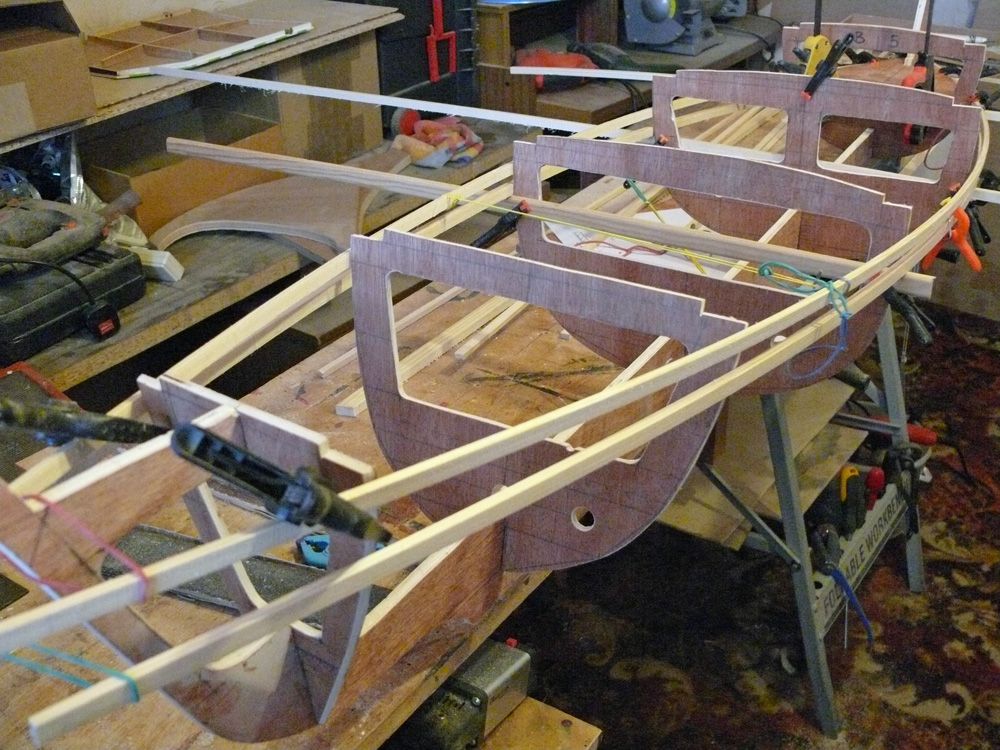

                    My intrepid progress chaser Kevin G is calling for a WIP report again
                    Well, there is progress, Captain, but not as we know it!
                    It`s called…..Organised chaos!
                    At the moment, I`m investigating the hull curvature, part way down the hull
                    Believe it or not……..It`s working out OK
                    Made a few mods to Vic`s design………Making a strong jointed structure at the stern
                    And as you can see……I`ve got round the bend with a sample plank

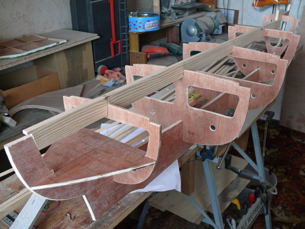

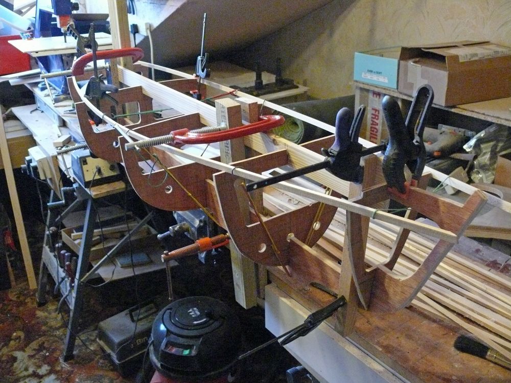

                                        The model is being built as Vic intended, viz…….the right way up and it is causing a few headaches with accuracy of build, since we don`t have a flat datum face to rest on and trust
                                        The bottom face of the keel has been left square with the bulkheads and will be ploughed off later
                                        I`ve made a top fixture plank, to locate the tops of the bulkheads, but still need to set the bulkheads athwarts!
                                        Probably an incorrect nautical term, but it sounds about right to me!
                                        Edited By Bob Abell on 13/04/2016 16:38:53
                                        #64529
                                        Ian Gardner
                                          @iangardner62867
                                          I expect when you have that nice wide inwhale in things will stiffen up, and it might be worth letting a stringer into the frames at the turn of the bilge- or are those holes for dowels to make the structure more rigid? I can't tell from that angle if they are in line.

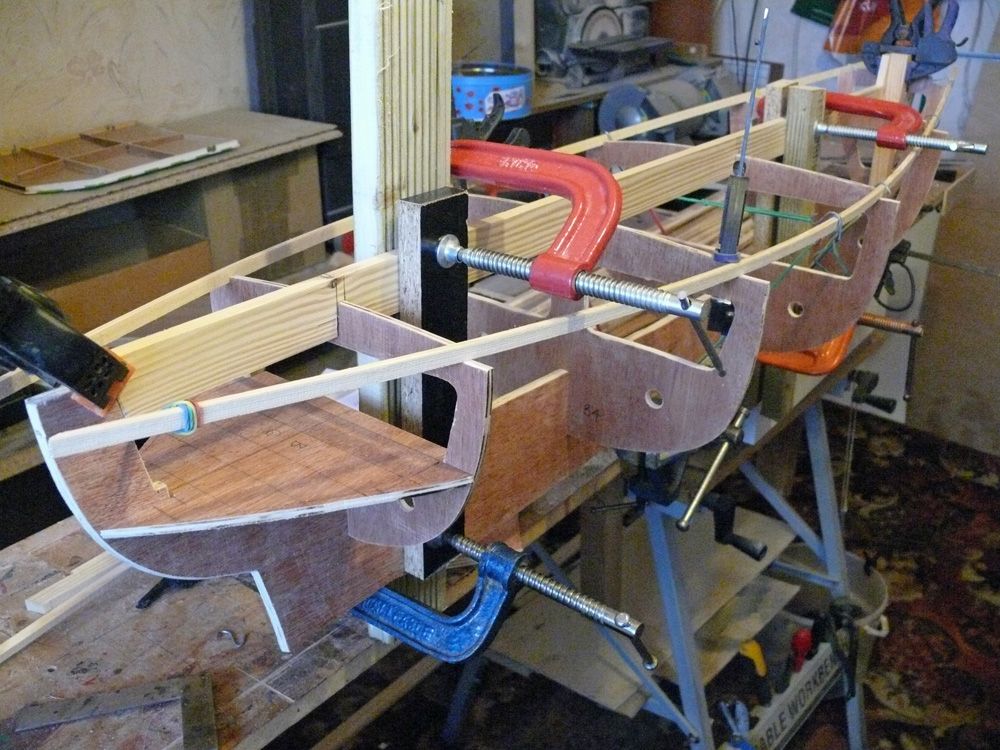

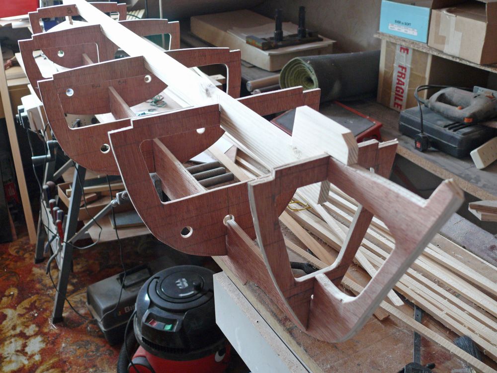

                                                    Latest state of play
                                                    Got the structure finally sorted out and ready for glueing
                                                    It was an interesting challenge and great fun
