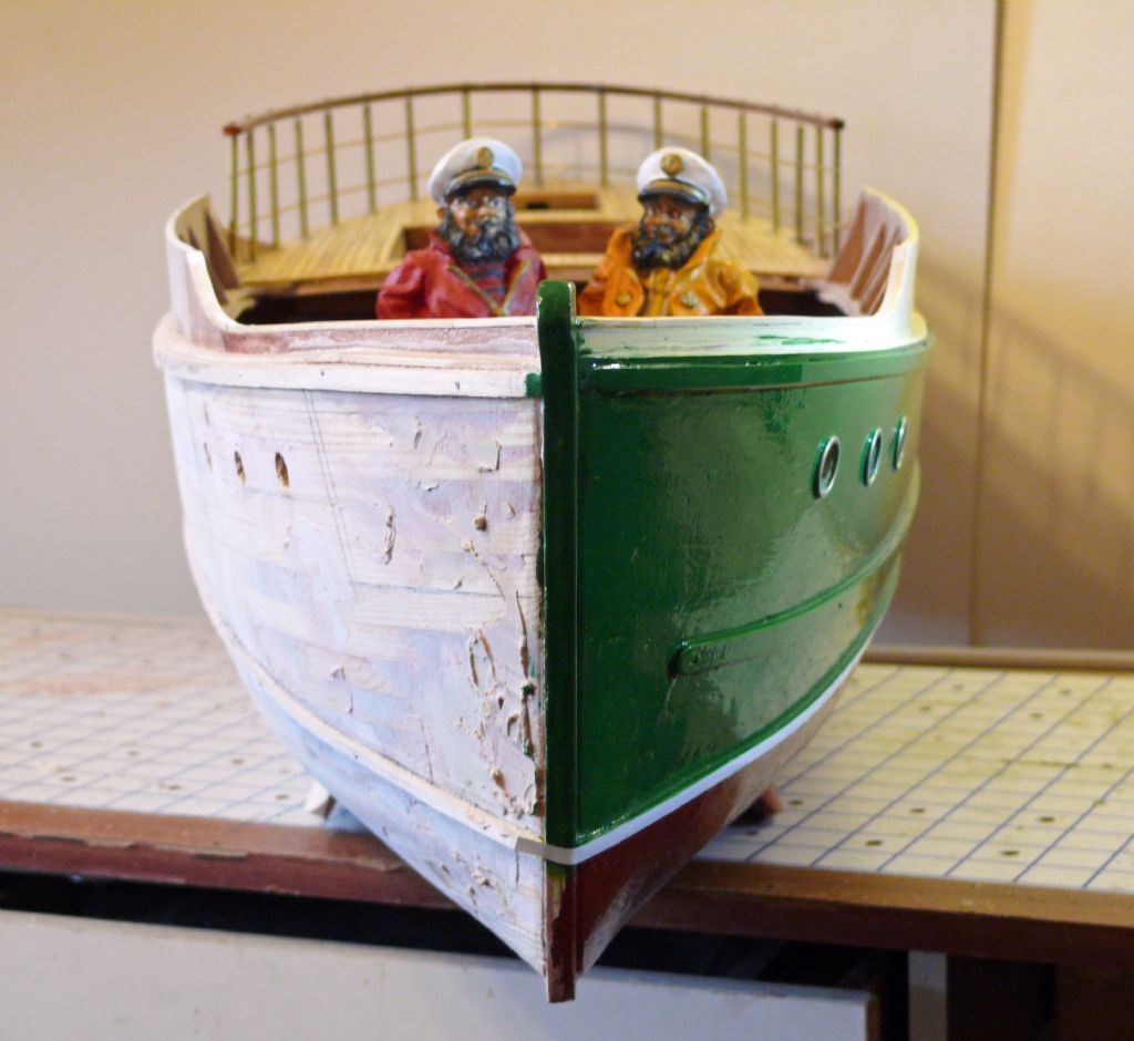

        A case of the right hand not knowing what the left hand was doing? It's a bit like the far side of the moon, nobody knew what it looked like until they sent a satellite round it. Come to think of it, the far side of the moon was smoother than the nearside….
        #68481
          Strange you say that, Colin
          I was going to call the photo…….The dark side of the Moon originally
          No doubt, there will be a good selection of more authentic port holes at the show?
          #68482
            Just to put one Doubting Thomas right……..Here`s a Half `n` Half piccy showing the unusual situation
            #68485
              So you DID ice the other side Bob after all….

                What a novel approach, Bob! And as you are going to paint each side differently there is still hope of a nice, classic white topside?smiley
                Ian
                #68528
                  Blimey, Ian, I was only joking about the different colour option!
                  Will have to give the matter some thought now

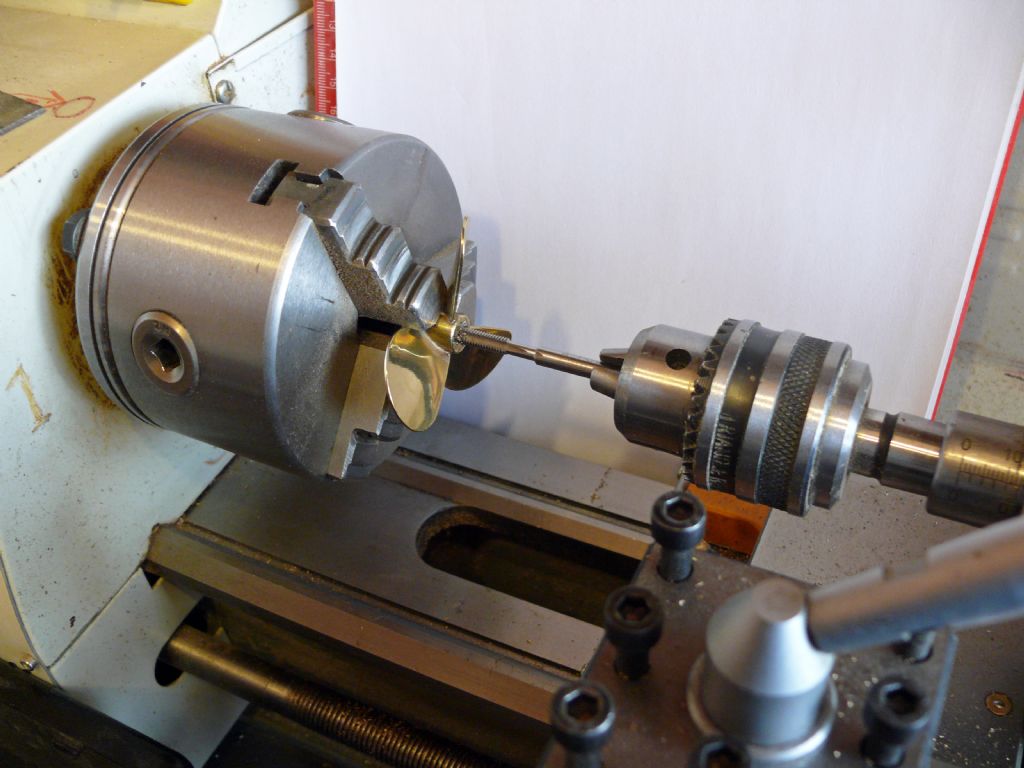

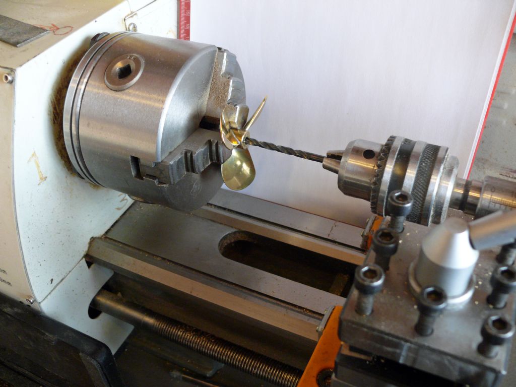

                          We had a really nice day out at the Warwick Show yesterday
                          As expected, 2BA props were unavailable……..No problem though, found a suitable prop with a through hole, that could be easily modified
                          A few pictures to please the build thread followers……Met quite a few avid readers of the thread at the show, and was nice having a chat about this and that
                          Pictures…
                          Set up in chuck…Drill the prop…Tap out 2ba…Fit to prop shaft
                          Also had to turn the O/dia down to clear the rudder bar
                          Edited By Bob Abell on 13/11/2016 16:12:49

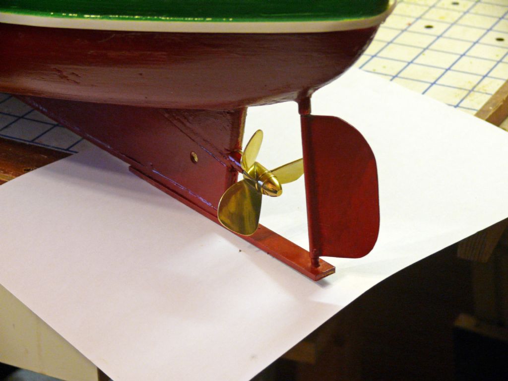

                          #68665
                            Anybody spotted my deliberate mistake……….Or the retailer`s?
                            The prop is right hand!
                            Too late now, but will have to be careful going forward………Or it will unscrew itself !

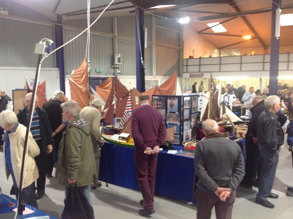

                              Scene at Warwick
                              #68680
                                Hi Bob
                                Silver Mist on the AMBO stand, very strange
                                #68681
                                  Well spotted, Ray
                                  Did you go to the show?
                                  The club have decided to visit the Blackpool Show next year…….For a change of scenery

                                      Bob – No panic. For this kind of challenges mankind invented a stuff named "Locktite"
                                      Comes in several different flavours, including one that comes loose on some deliberate force, or the appliance of some subtle heat.
                                      Combine that with a nut tightened firmly against the hub and your prop should stay in place nicely, even with violently applied throttle.
                                      Nice prop, though, it definately looks the part!
                                      Edited By Diede van Abs on 21/11/2016 16:24:24
                                      #68806
                                        Thank you Diede
                                        Nice to see you commenting again
                                        I know of Loctite, but don't like the idea of the difficult process of removal
                                        I shall go for the simple locknut and hope for the best…..Afterall, I've still got the original sheet brass version in the toolbox
