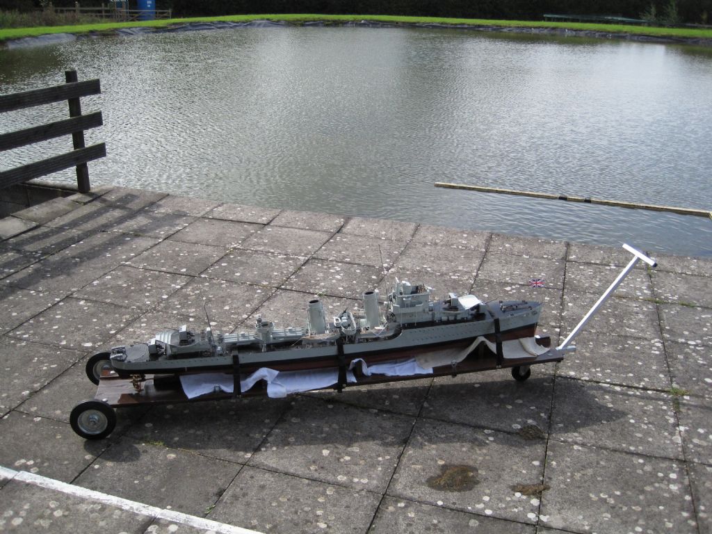

                I have a 7 ft scale model destroyer and I decided that I wanted to provide the fully sprung support of a long wheelbase van (on the launching trolley the overall length is about 9 ft). The ship is strapped down on the trolley and the trolley is strapped down to the securing rings on the floor of the van. This approach works well but there is a drawback – I have to hire the van every time I want sail the ship and that is costly.
                #64130
                shipwright
                  @shipwright
                  …. and here is a photo :
