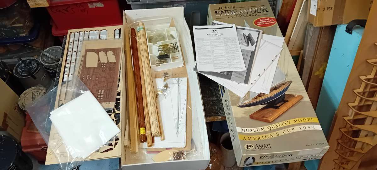

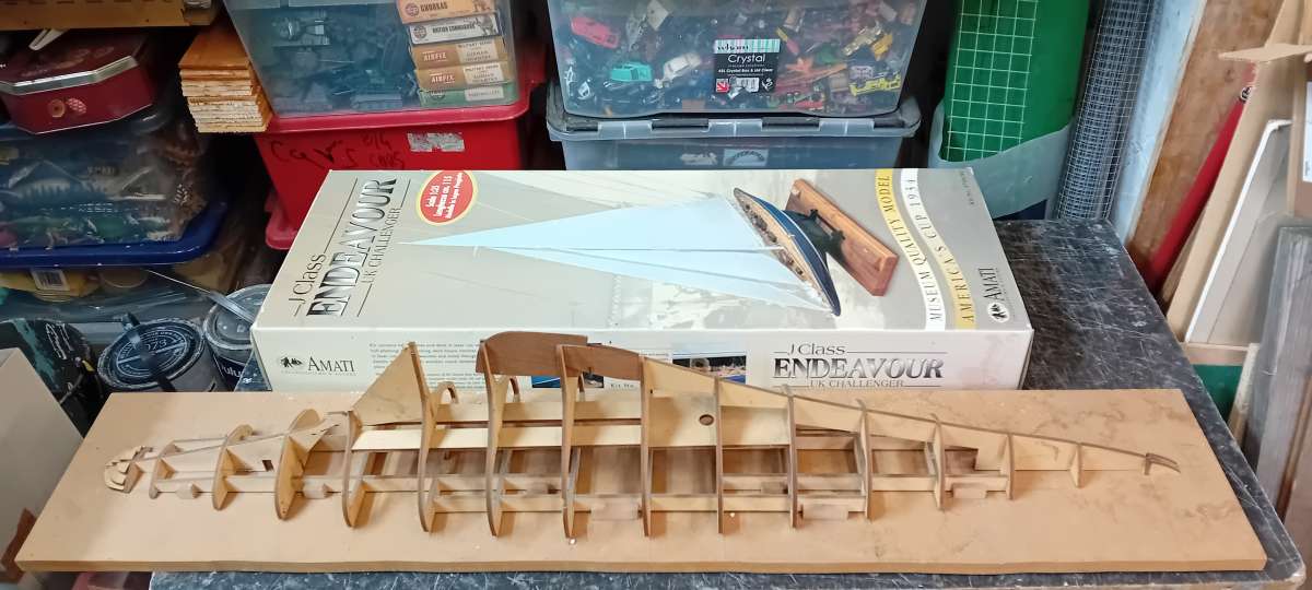

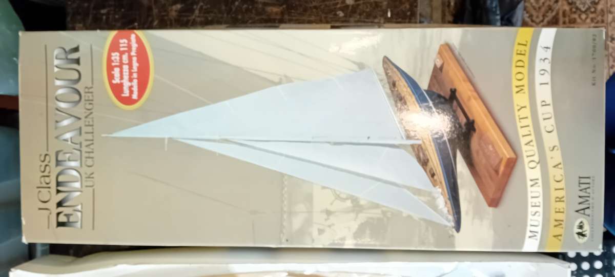

                                ANYWAY. I have a 1,/35 Amati J class yot kit to get rid of for a friend whose husband sadly passed away. Hull started on 20mm mdf build board. All bits in original box appear to be present. The chap who had it was quite meticulous. Pm me any interest.

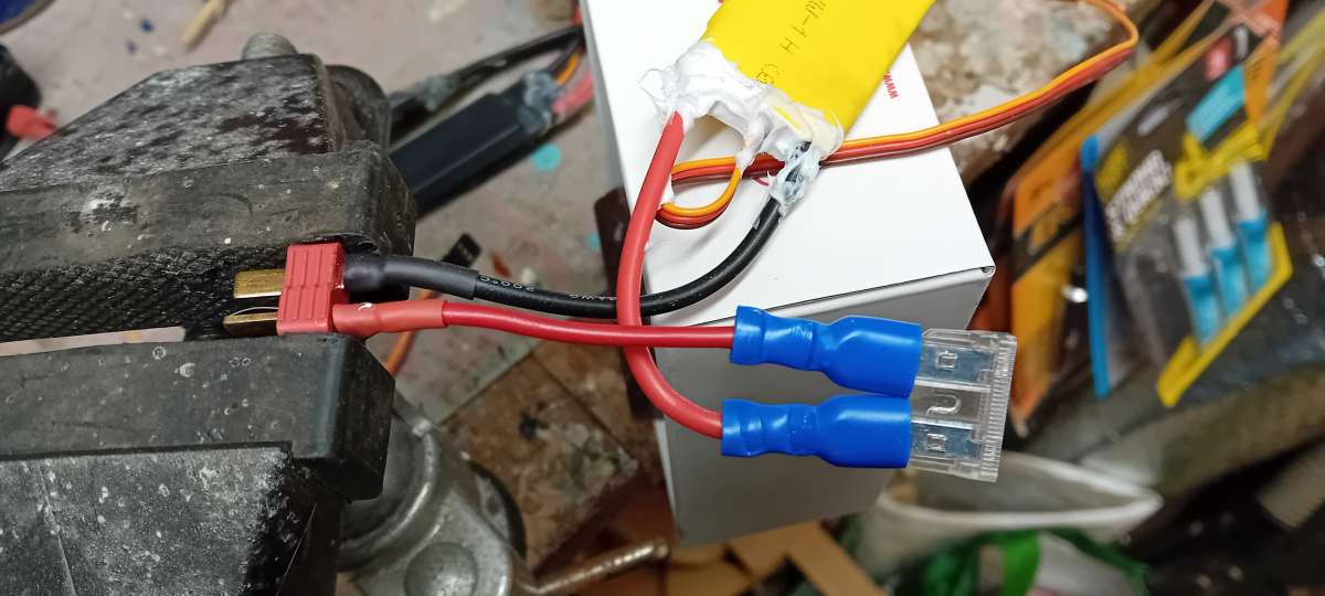

                                          Spent an hour putting connectors on various esc I have, including two reversing brushless ones. I need to test them out properly as I trued one and thought that it wasnt that efficient. However. I should put it in something with an air prop and use the wattmeter.
                                          Snap. Handy positional vice with sift jaws to hold Dean’s connectors. A tip here is to solder wires on the tags with both parts of the Dean’s together to avoid overheating and also to keep the parts aligned (snap is post-soldering!)  I fitted fuses, very easy with blade connectors and fuses. White gunge on esc is silicone to provide some waterproofing. As the esc are never run at their max, any loss of cooling is minimal. Fuses 25A on the 30A esc’s.

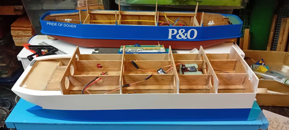

                                                      Fantastically productive morning painting Trevors corvette.  Did the deck and marked out dazzle cammo on the hull.
                                                      And, having spent most of the morning doing fiddly deck painting, I spent half the afternoon fiddly painting the HSS funnel covers which are covered in corrugated card.
                                                      ALSO stuck the first of my stickers on. The P&O ones are possibly slightly large, but the picture shows the hull without the top so they will look smaller when this is on top. For the experts among you, the letters should be closer together, and the Dover lettering is very bold but the boat is based on a publicity model. HSS in foreground looks to be the same size but is 6 inches shorter. No lettering to go on this hull, the Stena wording goes on the lid.
