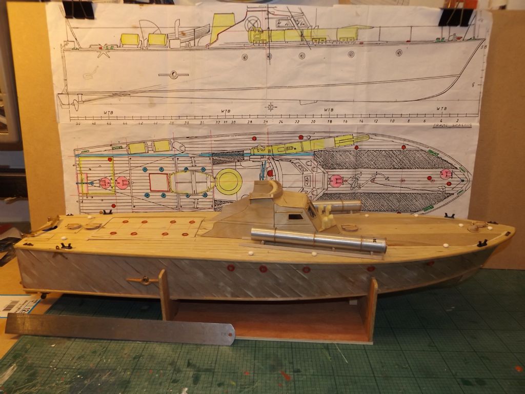

                Hi Michael,
                I imagine your talking about 25mm torpedo tubes from PVC pipe which would work fine, but quite thick walled may look a bit chunky ? I used some thin walled aluminium tubes for my MTB 71 from old garden furniture, but that was 20mm for the right scale.
                Paxolin was widely used back in the 1950's probably when Vic Smeed designed the boat, there is similar lighter material from SLEC for joining model glider wings etc, I won't attempt to spell it
