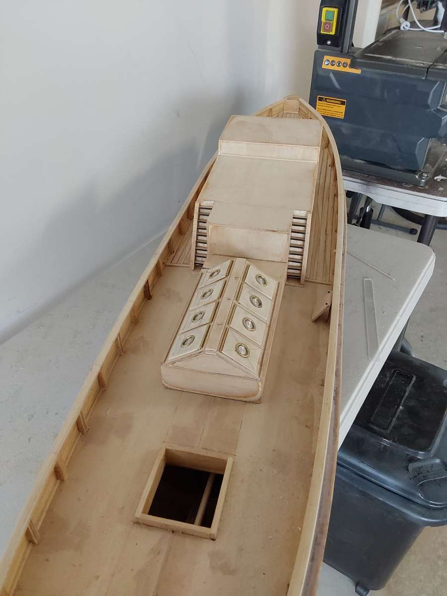

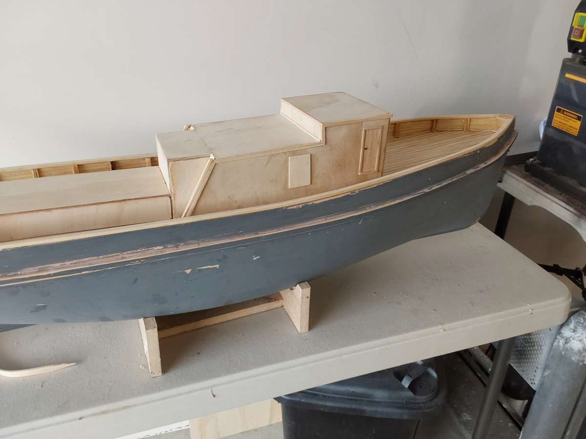

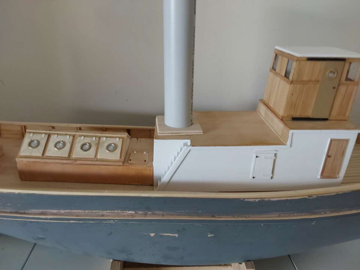

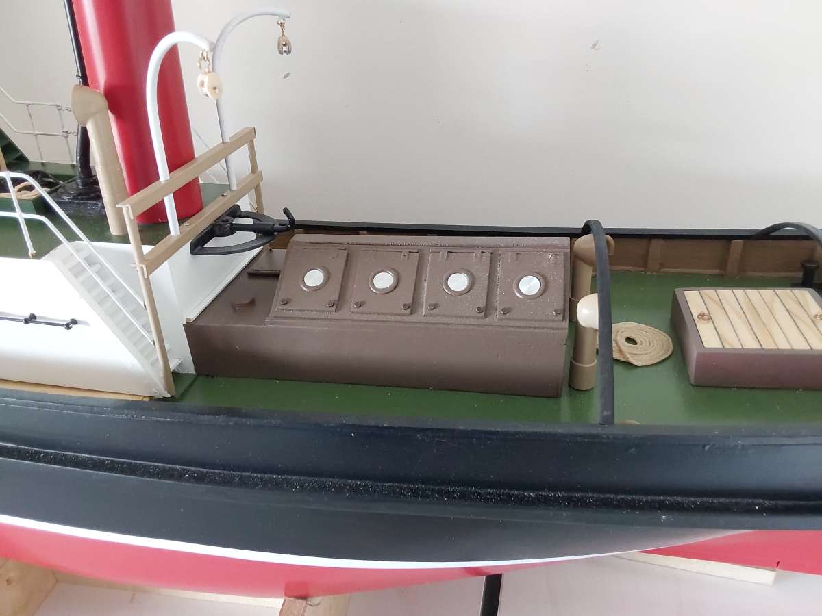

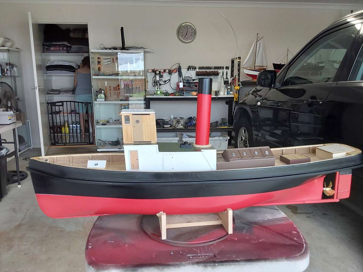

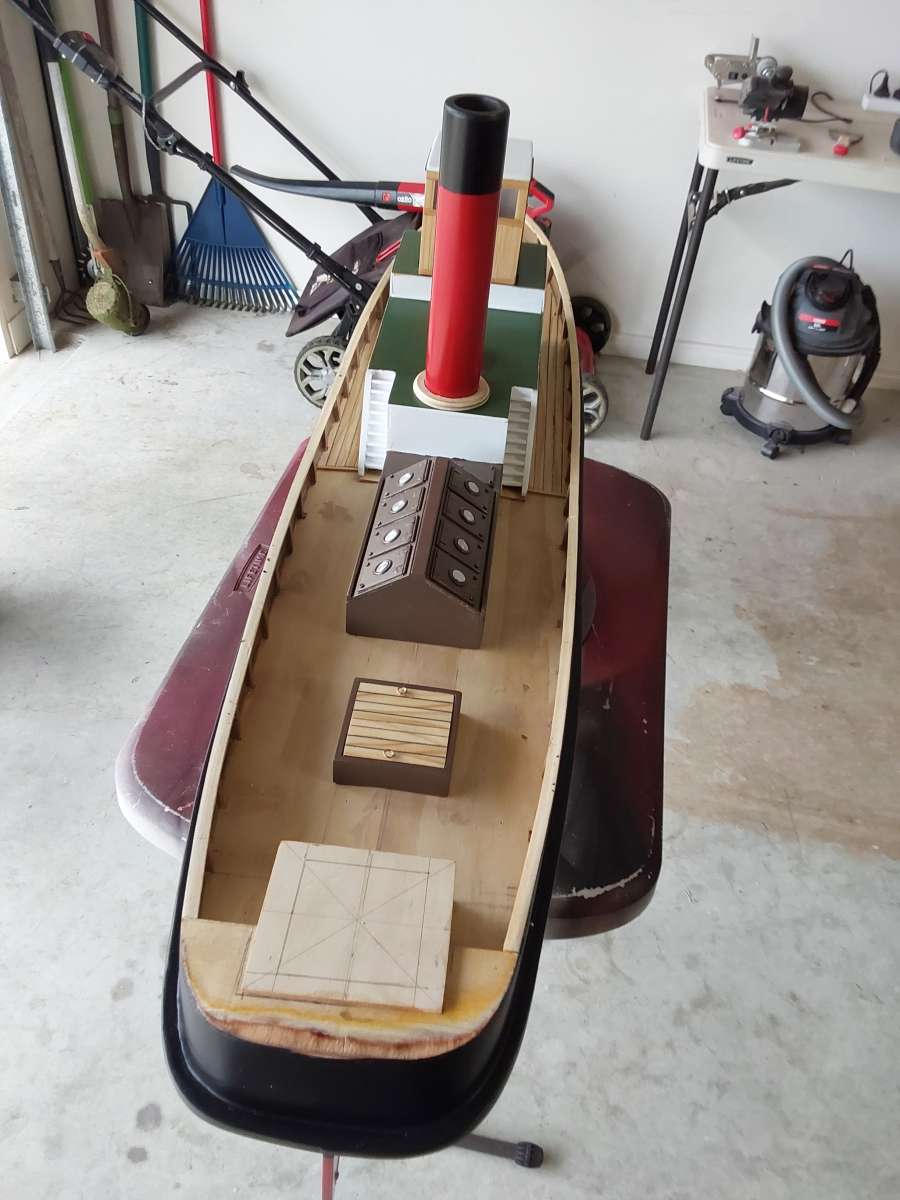

        Back from my beautiful granddaughters wedding in Canberra and straight back in harness.  The lower deck house templates have been transfered into ply wood and are loosely fitted to the deck . I still have  to make up the engine room hatch covers before sanding down and filling any discrepancy with wood filler and undercoating. It was good to get back into the workshop after a week of so being away.
        Regards to all Easty
        20241119_09355620241119_093606
        20241119_093645

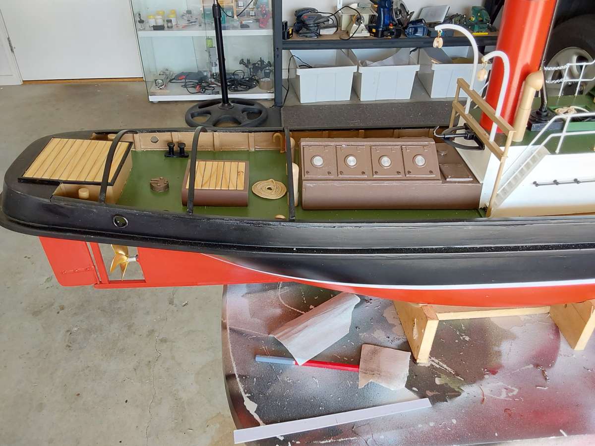

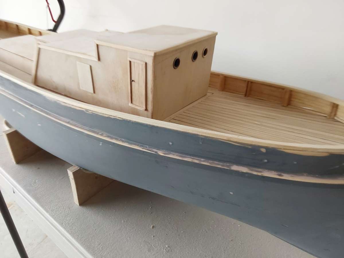

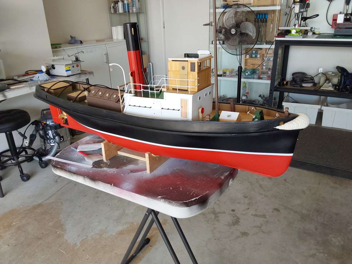

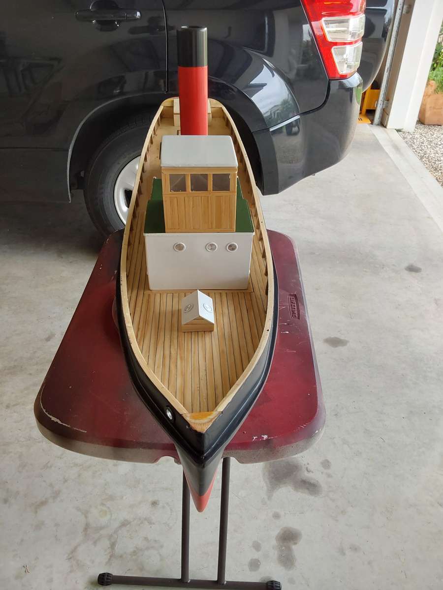

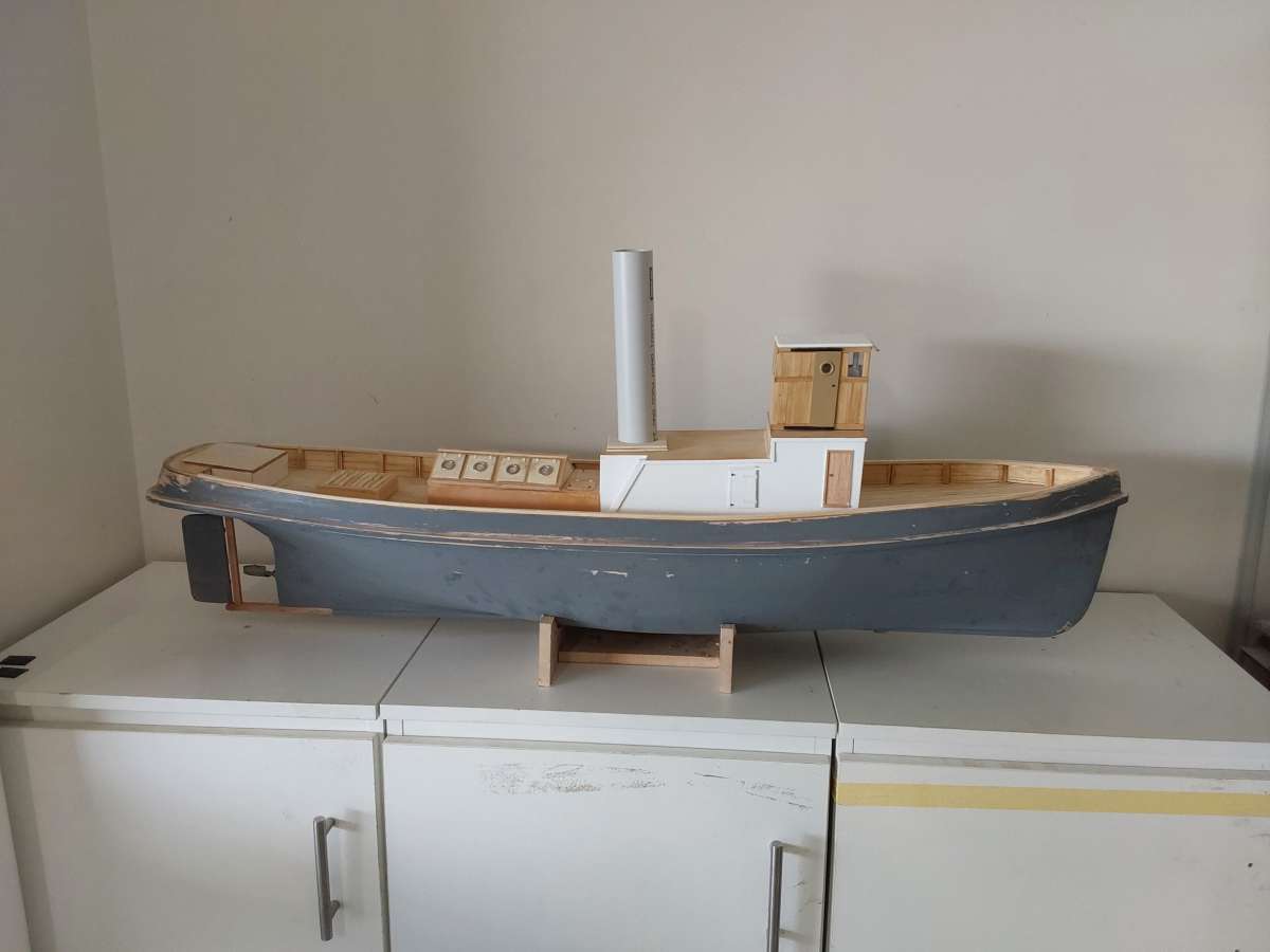

              Quick update with progress so far . Painting the hull , a job I hate doing but it seems to be a reasonable looking job .
              20241209_06581820241209_06584220241209_071521

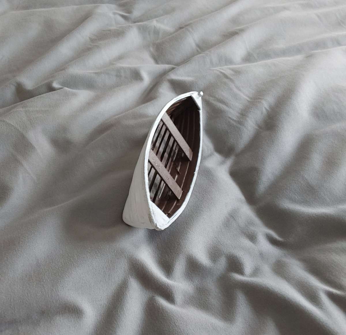

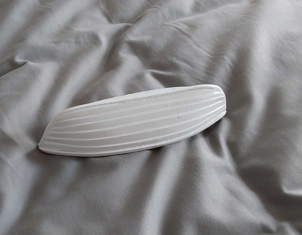

                We are in the middle of our wet season (just before Christmas and all of January)so lots of time to spend in the work shop. Next project is the tugs life boat , I’m putting a lot of thought into this as I was far from happy with the trawlers life boat I built. I’m thinking of doing a mould and clinker planking around it and releasing it from the mould and fitting ribs and seats. THATS !!! if my sausage fingers can cope with something so small. It’s going to be 😁 fun. keep a watch out for  results I’ll post picture of my endeavours good or as I suspect bad .
                #123932
                mick east
                  @mickeast46851

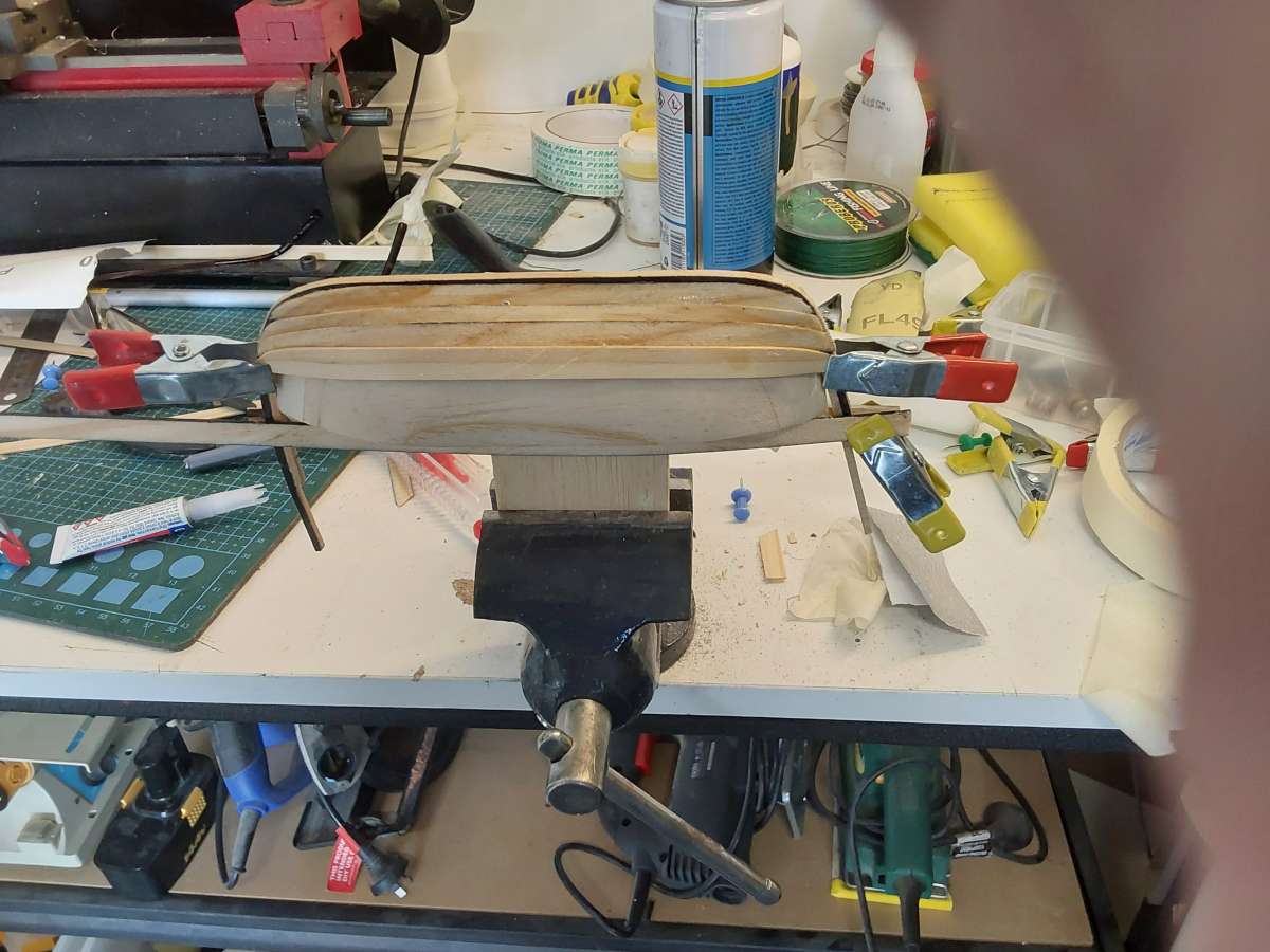

                  The technique seems to work so far, I will post the finished result when the  boat is out of the mold/plug sanded and painted
                  20241214_092848
                  #123933
                  mick east
                    @mickeast46851

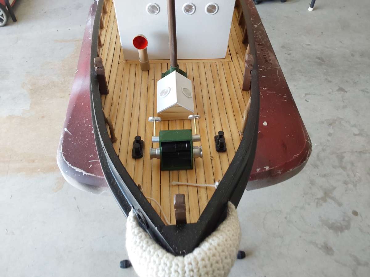

                    First coat of paint , then a light sand and one more coat . Not perfect by a long way but not too bad for a initial effort
                    20241215_15463220241215_154600

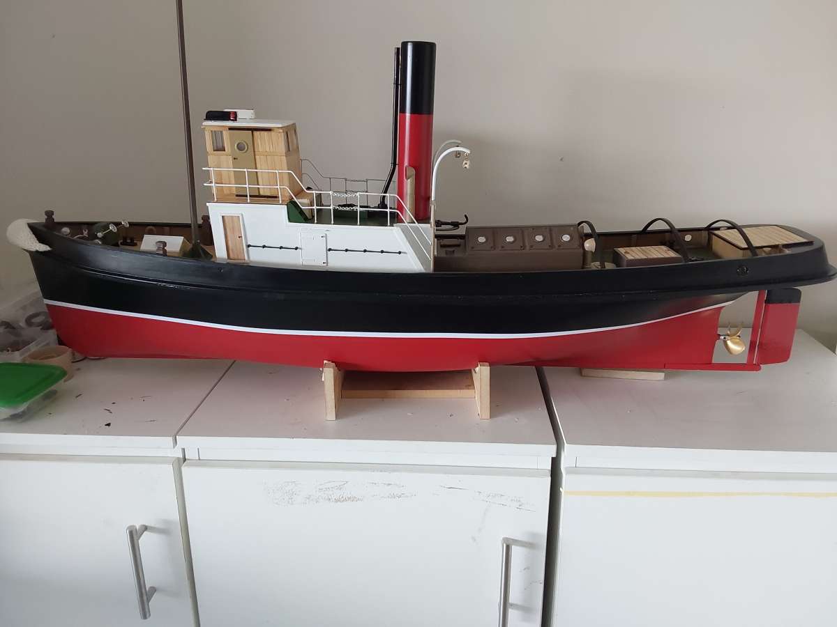

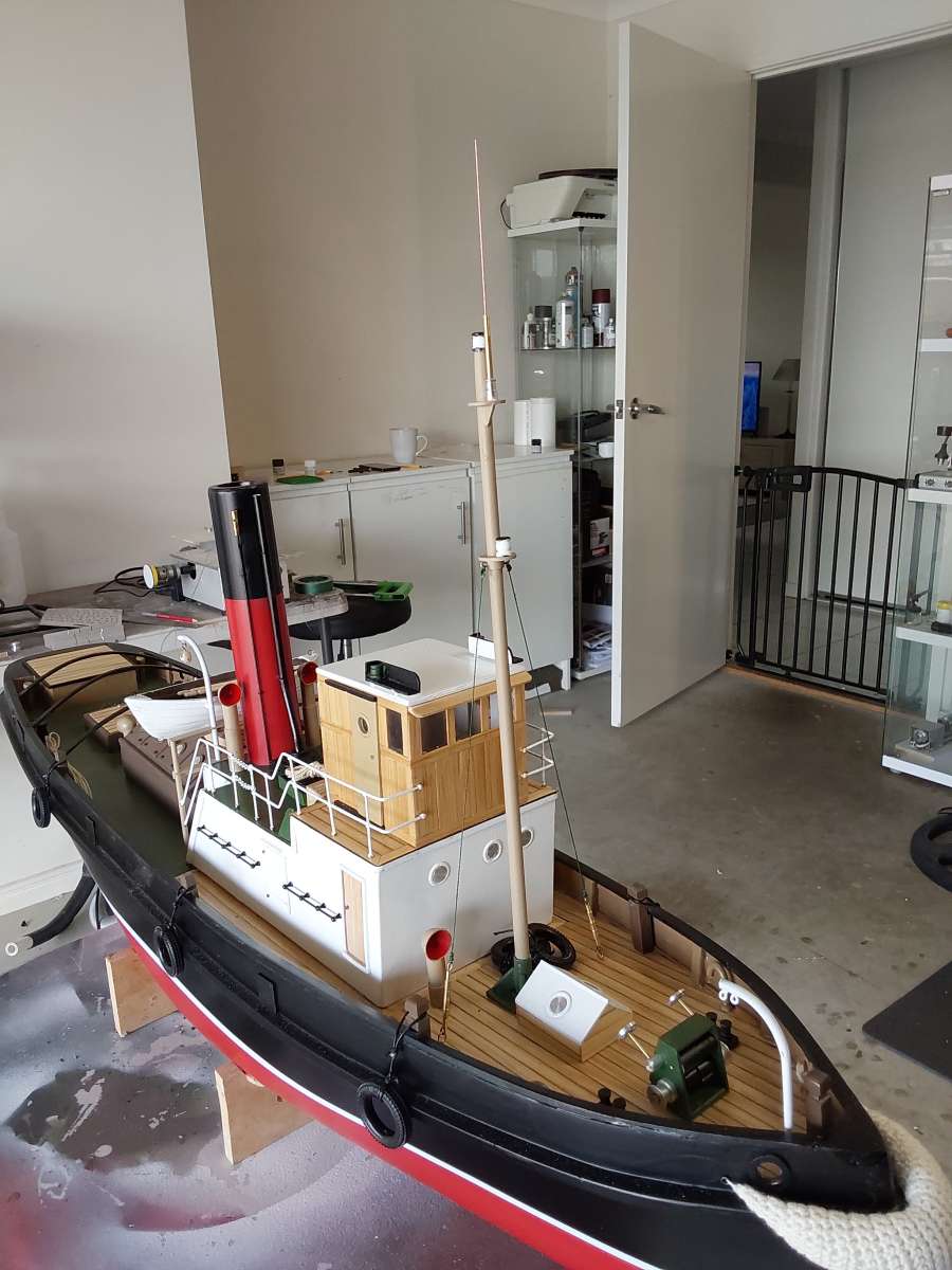

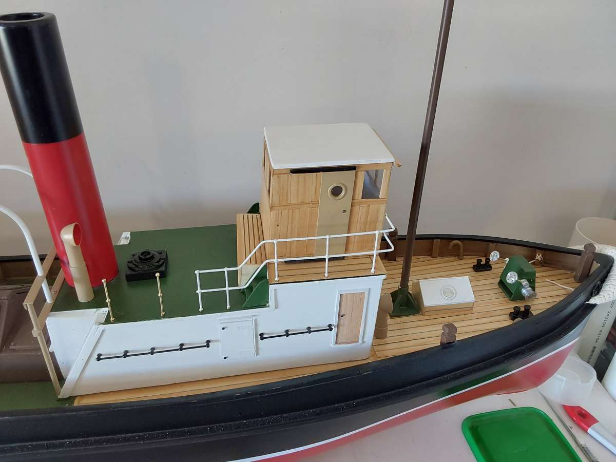

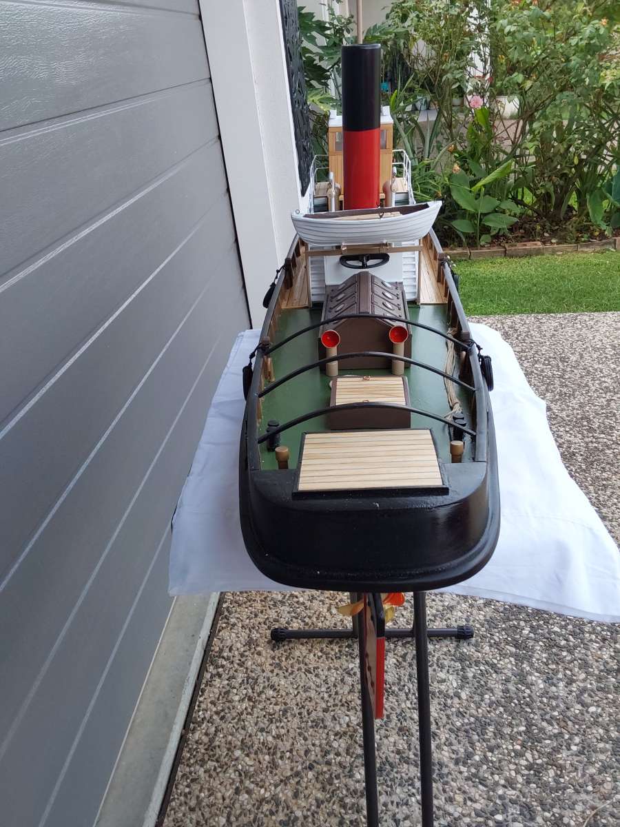

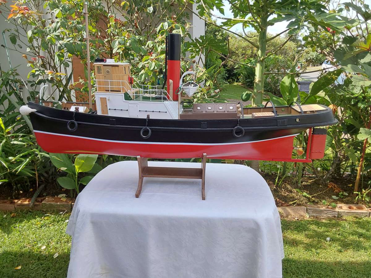

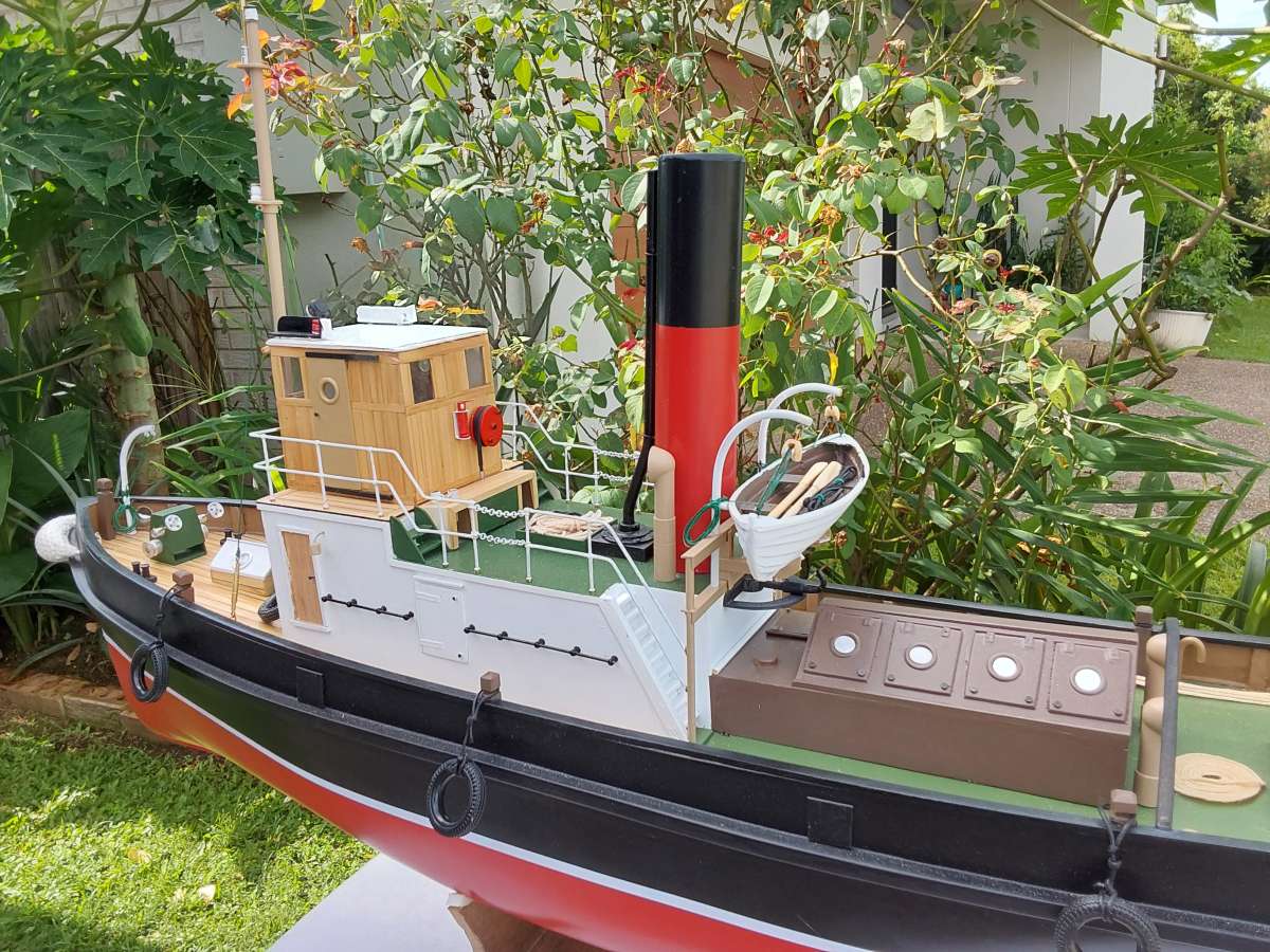

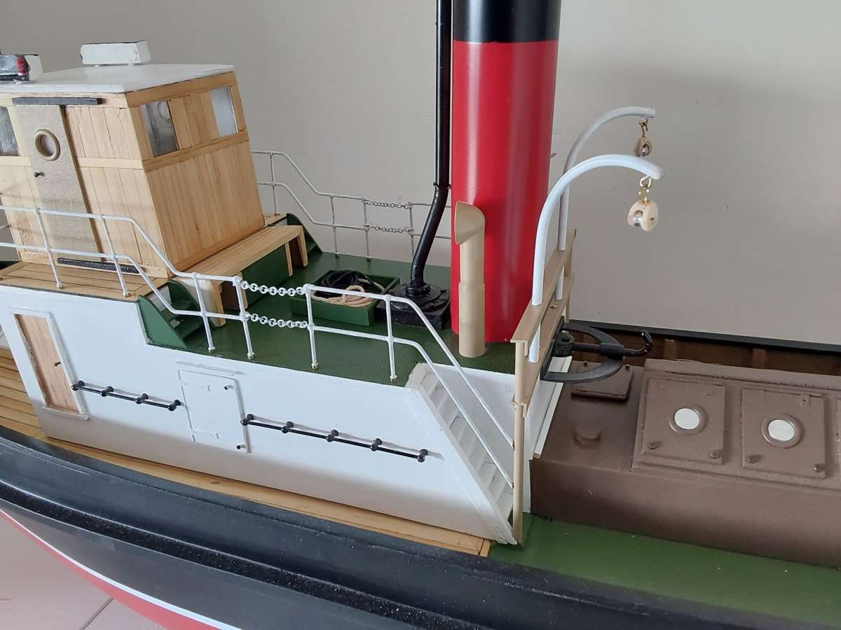

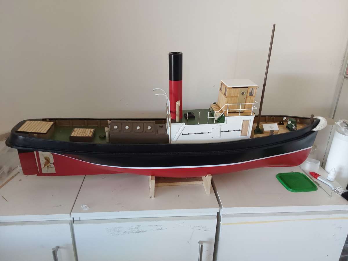

                            Getting close toʻ completion and let me say it’s been a most enjoyable build. I’ve honed my existing skills and learnt a lot of new ones along the way . It’s no where perfect but I’m happy with it and as long as you get better with each build new build that’s good enough  for me
                            20250101_14054320250101_14072220250101_14070920250101_14071820250101_14061320250101_140550
                            #124145

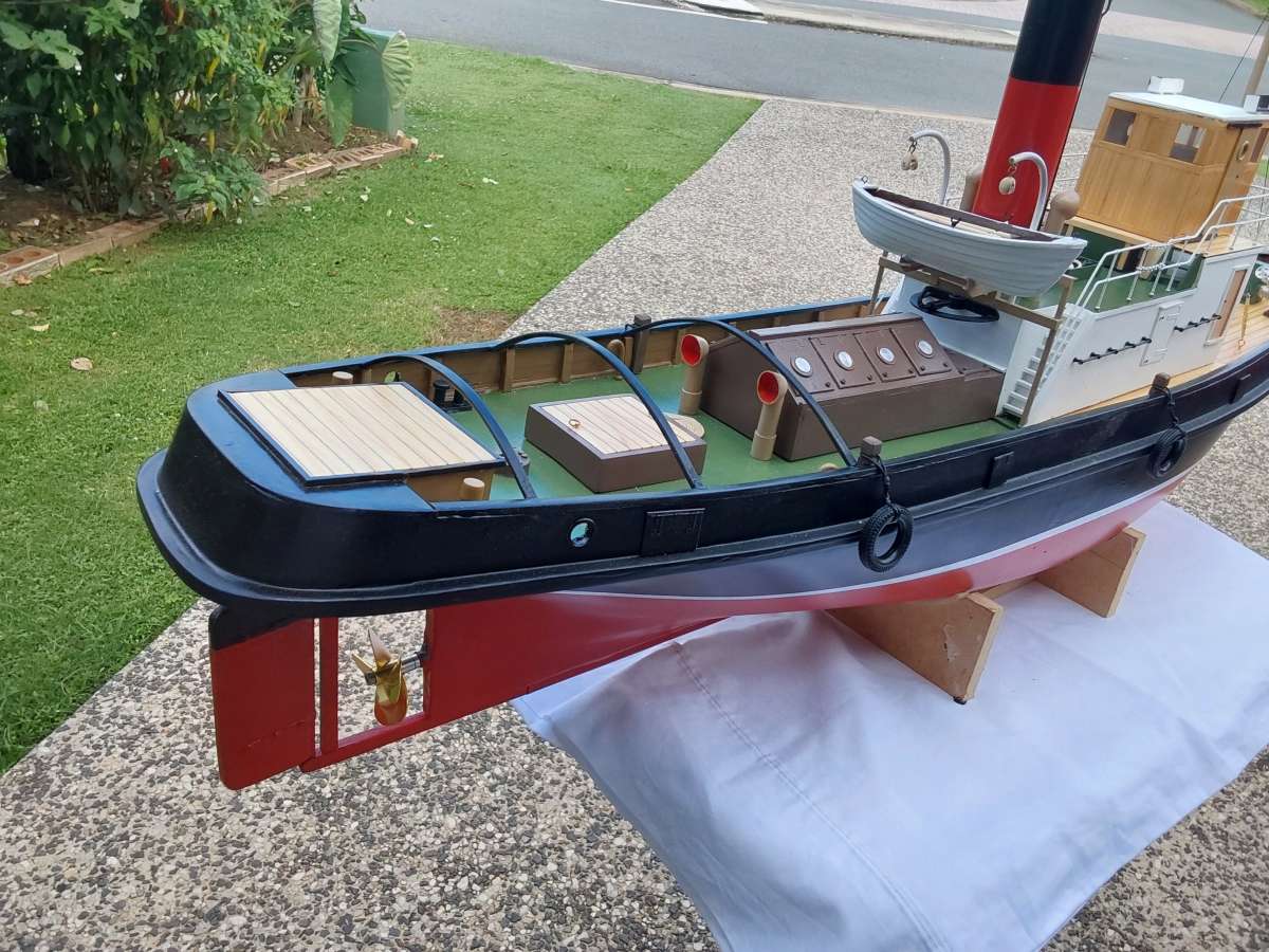

                              Looks superb Mick.  I’m intrigued by the use of boat davits in a transverse arrangement.  They can only be used for stowage as they cannot be used for launching and recovering from there so it begs the question how the boat was launched and recovered.
                              Any tug enthusiasts out there got any ideas?
                              #124153
                                Looking at the earlier photos on the Wattle website, it seems that there was only one davit on the starboard side originally. It is only a small boat so I would speculate that just the one davit was used to hoist it and swing it out by swiveling the davit across the centre line of the vessel and attaching a strop or similar to the bow and stern of the boat. The second davit was fitted later to enable it to be launched over the port side.
                                You can see in some of the photos that the davits can swivel outboard and even forward against the funnel.
                                #124156
                                mick east
                                  @mickeast46851
                                  Colin I think you are completely correct in that assumption,  that’s how I interpreted the plans.
                                  #124157
                                    Sherlock Holmes me! The photos showed that the davit(s) were fitted that way and the boat stowed above the towing hook so it must have worked. The boat would been lowered over the side empty and the crew would have climbed into it. Same process in reverse. First time I have seen that though.

                                      #124165
                                        Makes sense Colin.  I hadn’t realised from the pictures that the davit actually reached as far as over the side.  They do not look as though they do.
                                        I actually have a Joffree and that has a small davit mounted at the ship’s starboard side, fixed to the gunwhale, for raising and lowering a small dinghy.
                                        #124168
                                          Photos can be misleading in perspective depending on the lens Richard. The Wattle website photos helped to clarify things.

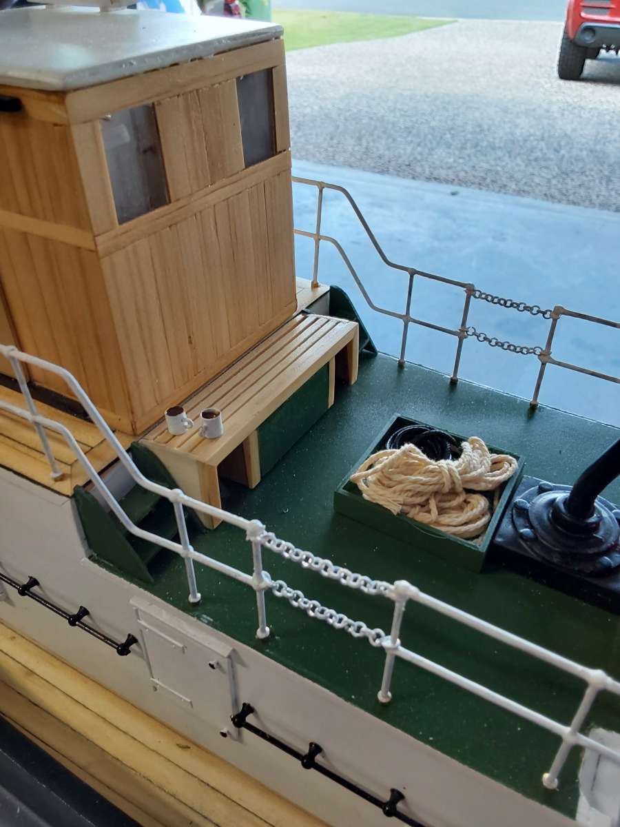

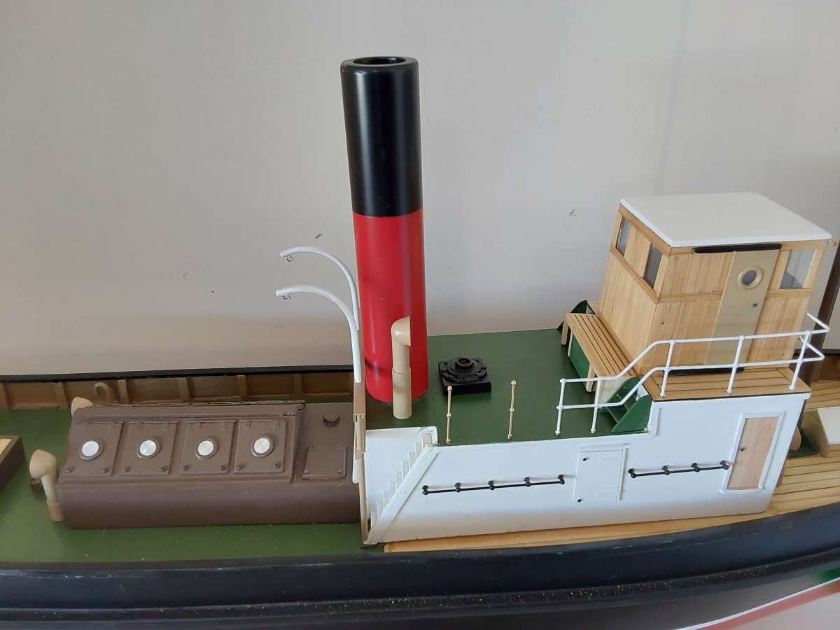

                                            As any good English man knows there is nothing a tug boat crew likes than a good strong brew

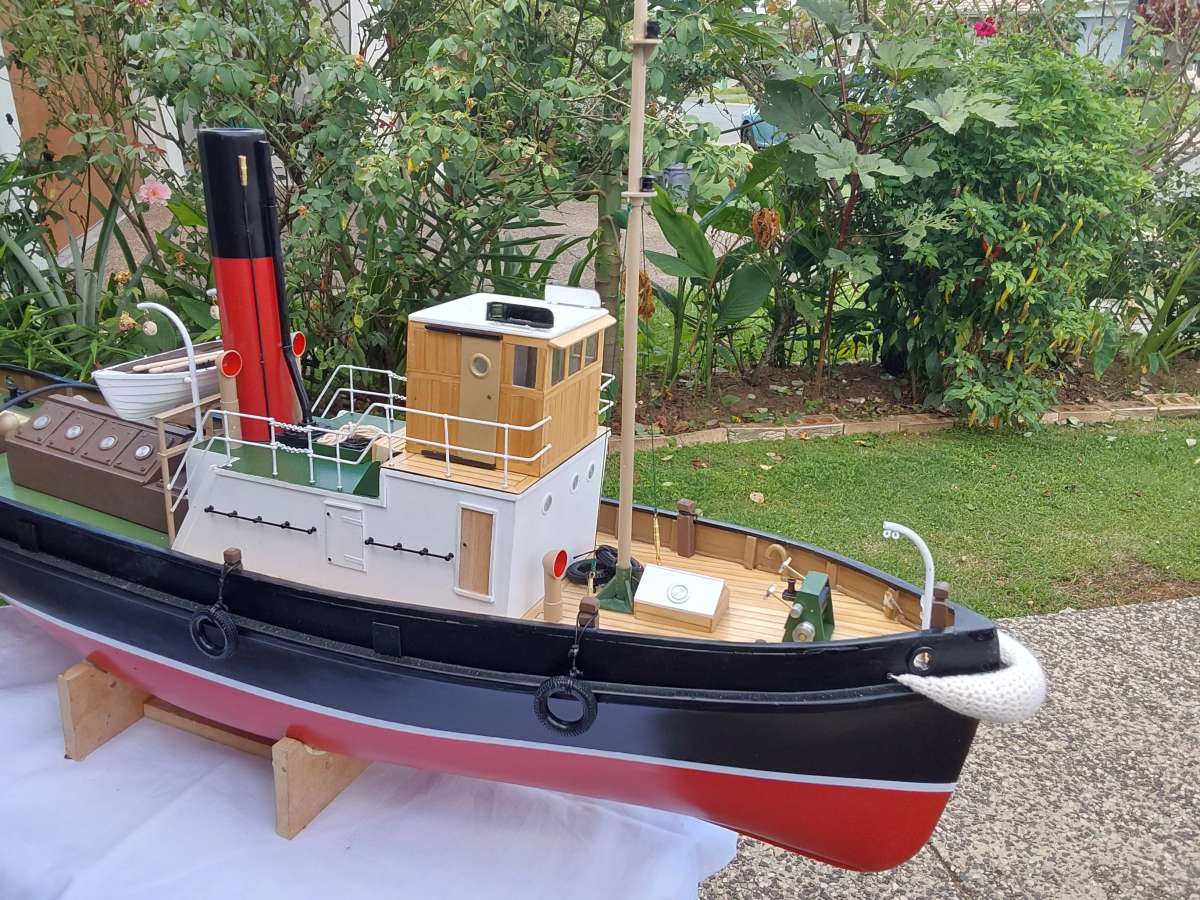

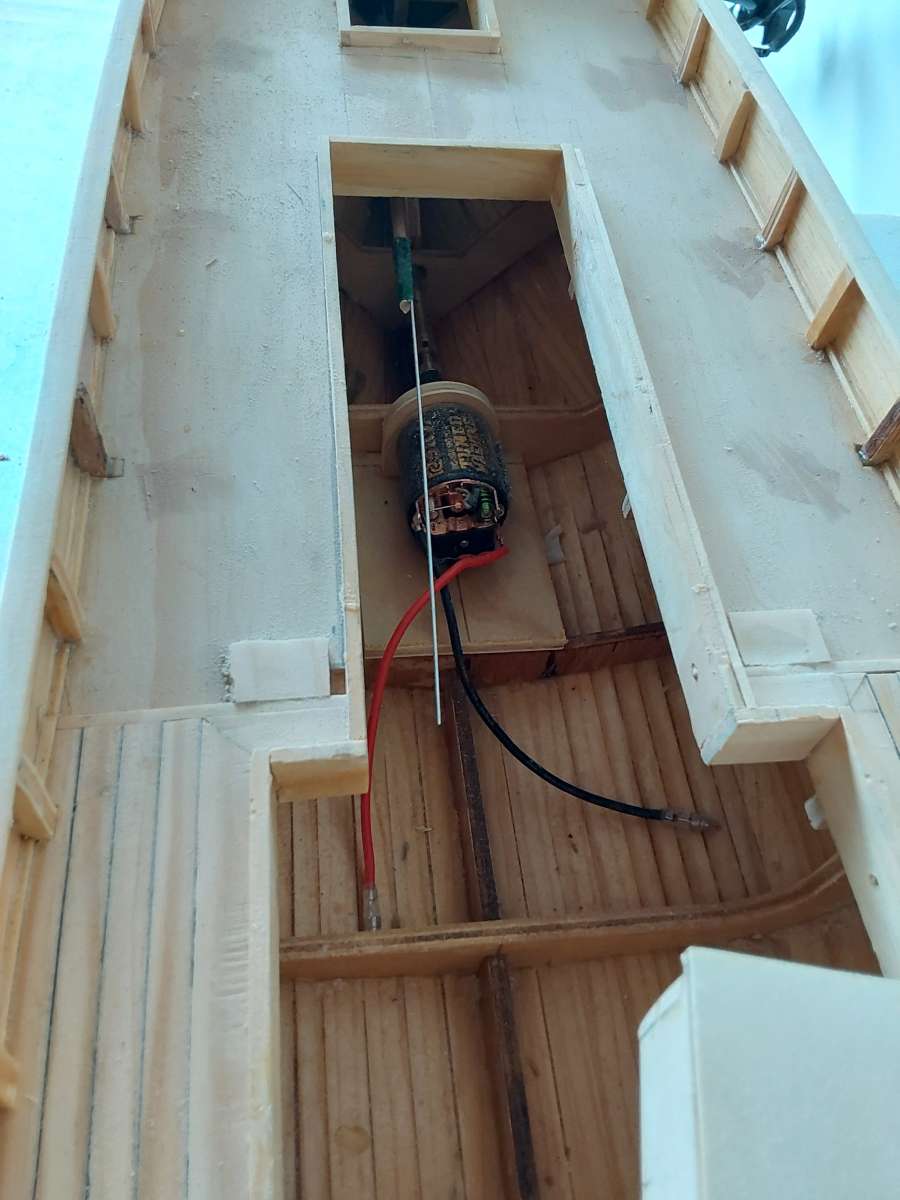

                                                  Finally finished , the electronics fitted and tested ( in bath tub ) . I was amazes at the amount of ballast needed to bring her down to the water line . I went to our local hardware super store and purchased 6kg of lead flashing thinking it would do this build and maybe the next , but no it was only just enough for  this build . It’s a heavy little bugger.

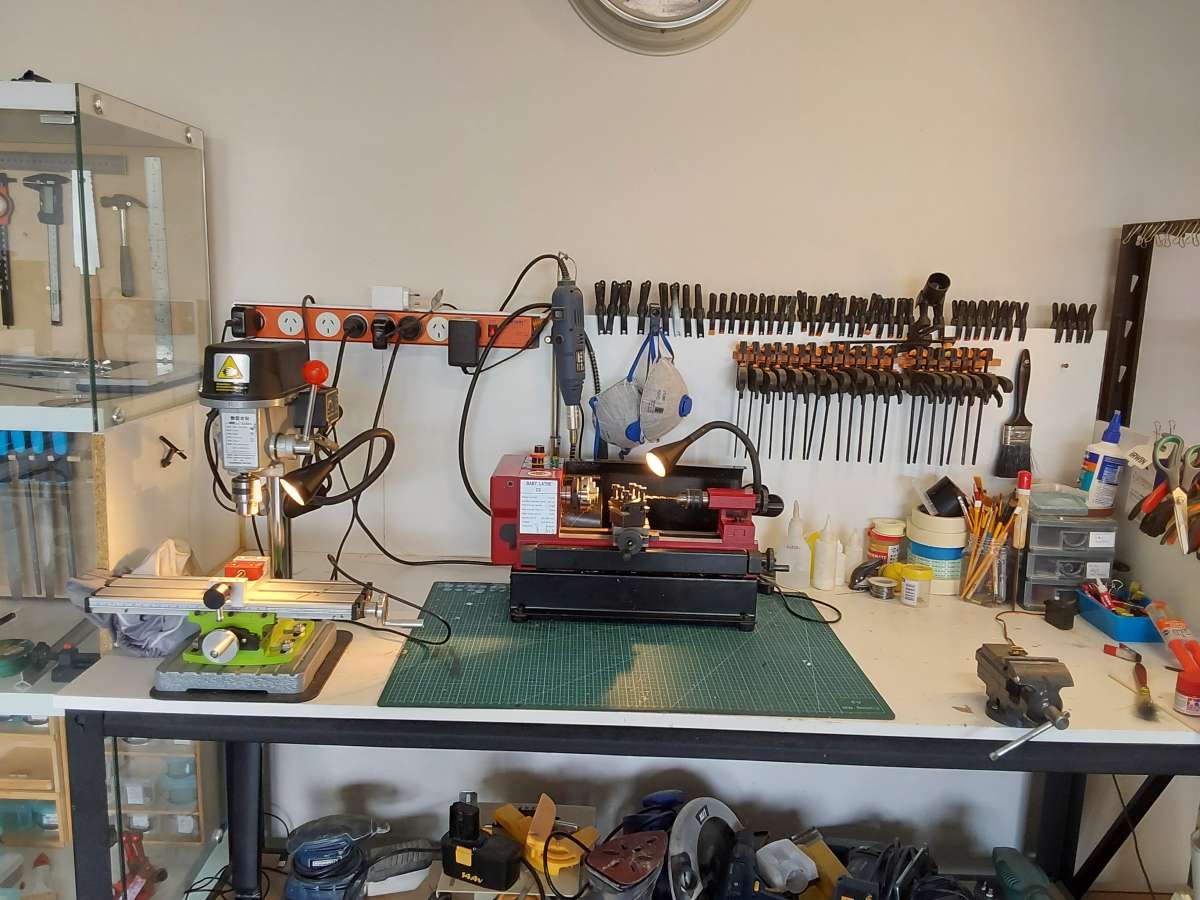

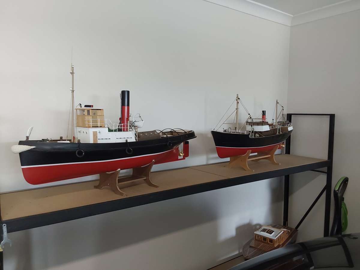

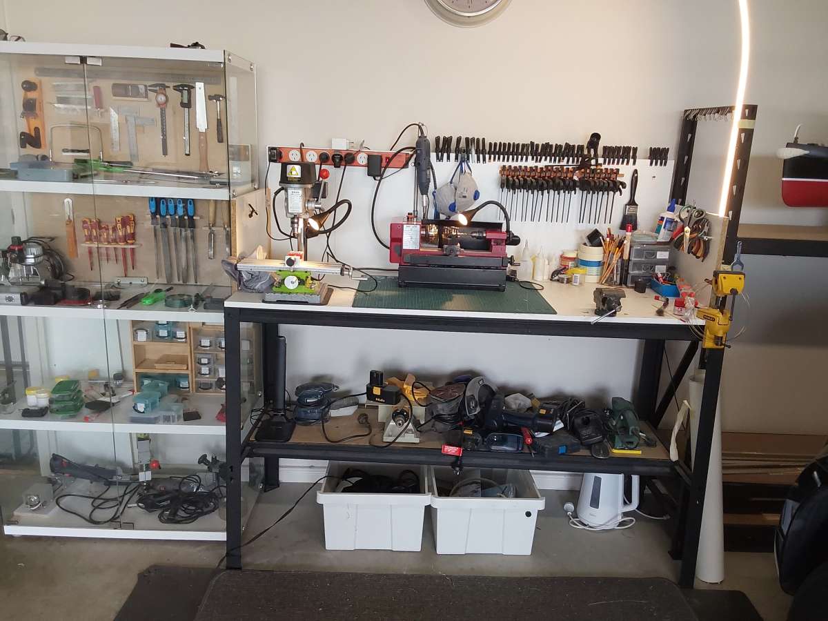

                                                    The workshop is looking a bit forlorn with nothing on the go but the top shelf is looking super good. The next build is going to be a Clyde puffer . I’m researching the welded hull puffers built for the navy during the war as fleet support vessels.  I’ve ordered a plan showing ship lines and lots of deck detail but the business is on a annual break till the end of January s o I will be twiddling my thumbs till then

                                                      She looks superb Mick.  Looking forward to seeing the shots on the water.
                                                      I must admit I thought my work area has always been a bit OTT with everything hung up and in its place but I’ve never kept tools in a glass case before.  I’ll mention that to my wife next time she is accusing me of being OCD!

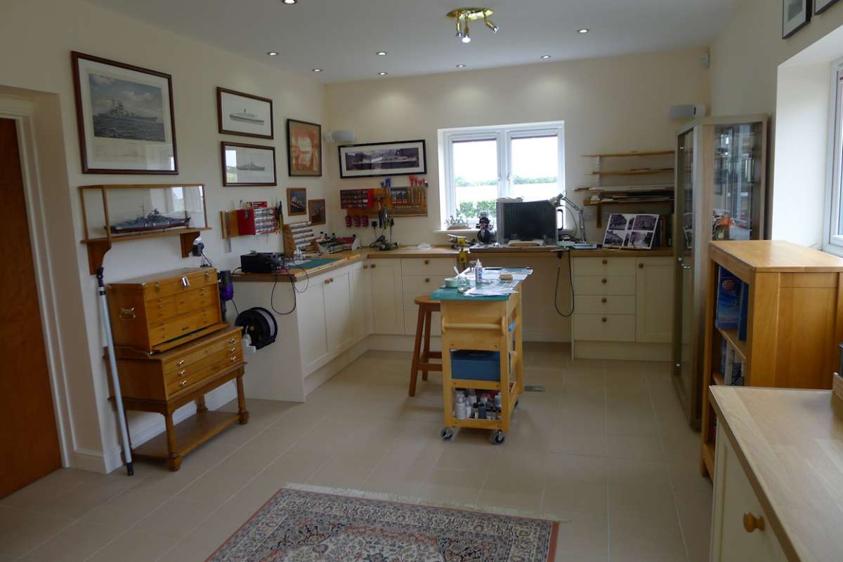

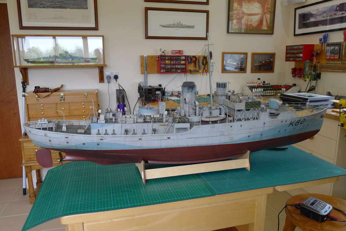

                                                      I’m very much with you, work area has to be clean, tidy, well lit and everything to hand.  After a visit to a model boat kit supplier many years ago, Mountfleet, I was very impressed with the idea of building a big model in a location that gives you access to all around the model.  He had an island in the middle of the workshop, which allowed him to walk around the model the full 360 degrees.  I adapted the idea and bought myself a kitchen  trolley as a building bench.  I also have work areas around it but the model grows on the trolley.  I also have a floor socket next to the trolley so I can use power tools on the model without having cables draped across the place.
