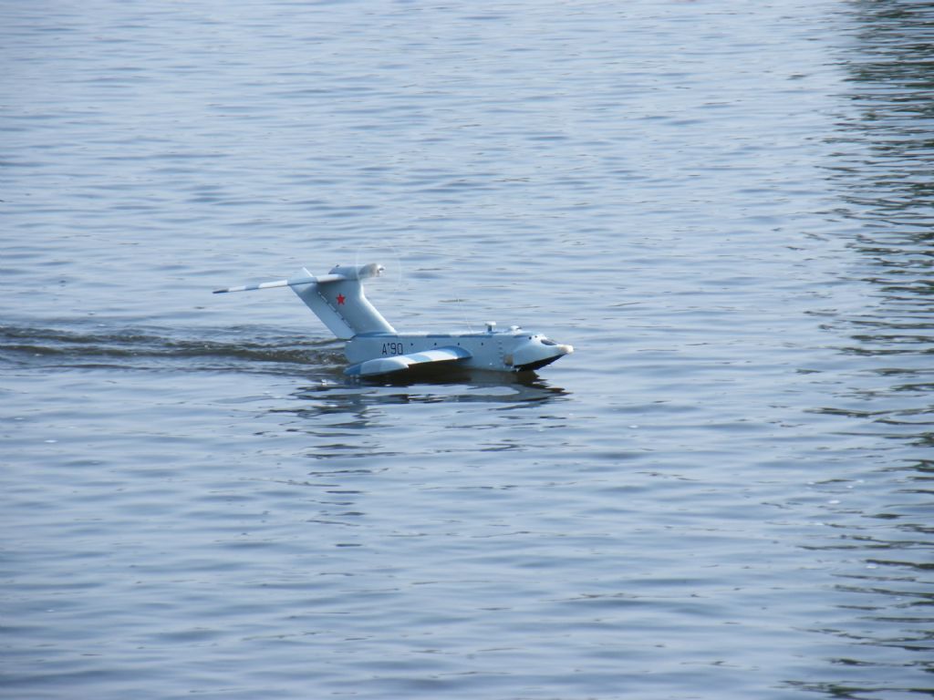

                                        I did try hard to get one of it speeding along, a few were quite good but didnt make it in the mag, poss because they were not a nice clear sharp picture of the boat, One of my favourites was JUST slightly out of focus and gave a really good impression of speed.
                                        There was daylight under the wings though that looked quite authentic.

                                                see me album. Ashley
                                                #32119
                                                  Nice picture, Ashley
                                                  Can it get actually airbourne?
                                                  As mentioned in my PM………Once airbourne, the rudder only will cause stability problems!
                                                  #32120
                                                    Bob, with a LiPo batter of 11.1V potential, it does indeed take of ! (as per prev posts)
                                                    Yes, if I wanted to ACTUALLY fly it I would need to have built it like a plane and have ailerons etc As it stands, I can just whack the throttle to 35,520 RPM and not worry about flight. Its a shame I put so much incidence on the wing as they undoubtedly are the cause of the sudden lift I experienced.
                                                    The difference between going fast and takeoff in about 10 feet is only 1.5V (my 9.6V pack verses an 11.1V Li Po) <and to a degree the slightly lesser weight> but this equates to 5,550 RPM .
                                                    SO, about another 3/4 of a volt would probably just have it “on the cusp” ….safe to shove the throttle forward without too much risk of flipping..
                                                    IF a larger `plan were to be made, I suppose you could link the flaps and rudder together to provide some rudimentary control when it was just in the margins of flight? I would certainly build it a tiny bit larger if was to build another one.
                                                    Ashley.
