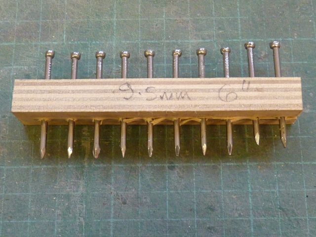

              As an alternative to drilling holes and fitting real rivets, you could simulate them with a spot of thick superglue in each corner of your base plates. Alternatively you could impress the rivet heads from the back of the base plate using a tool made up of a small block with 4 pins, similar in principle to the process I used on Spider J's hull plating shown here.
              Another option would be to use photo etched rivet heads stuck in each corner. I have not done this to simulate rivets but I have used it quite a lot to simulate bolt heads and tails
