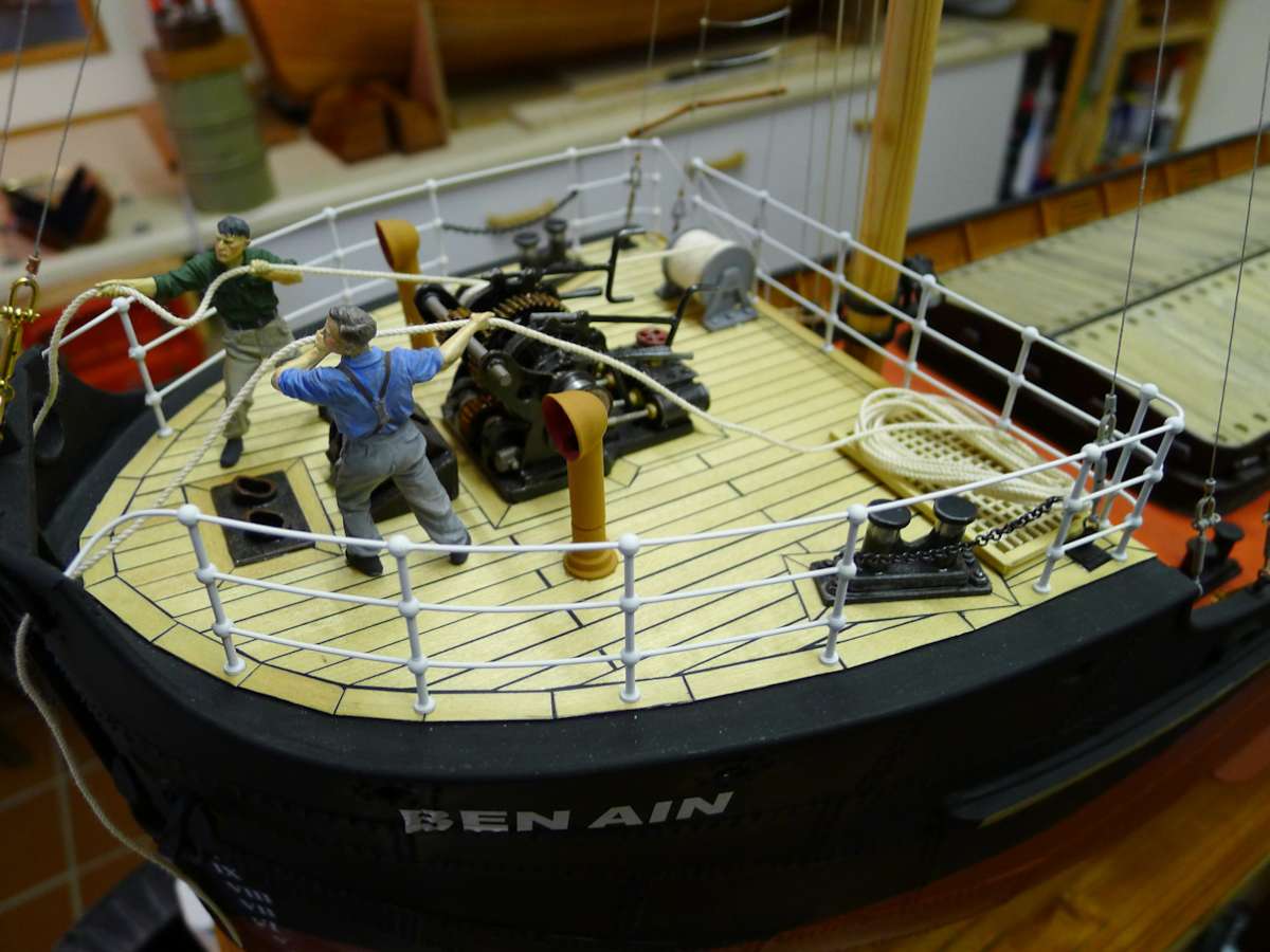

                    Going on to slightly more sophisticated techniques is going to be an easier path after a good understanding of the basics has been acheived.  Consequently while I disagree with the thought that smaller jobs made of multiple joints will probably fall apart, a sound understanding of the concept of heat transfer can help you acheive some quite complex small jobs as well as making you aware of what you shouldn’t try.  Using solders of different melting points is one technique but even the handrails shown here were all soft soldered in place by using the rails to heat the solder.  Every joint is soldered seperately and nothing fell apart.
                    14-03-12-12BenAinConstruction666

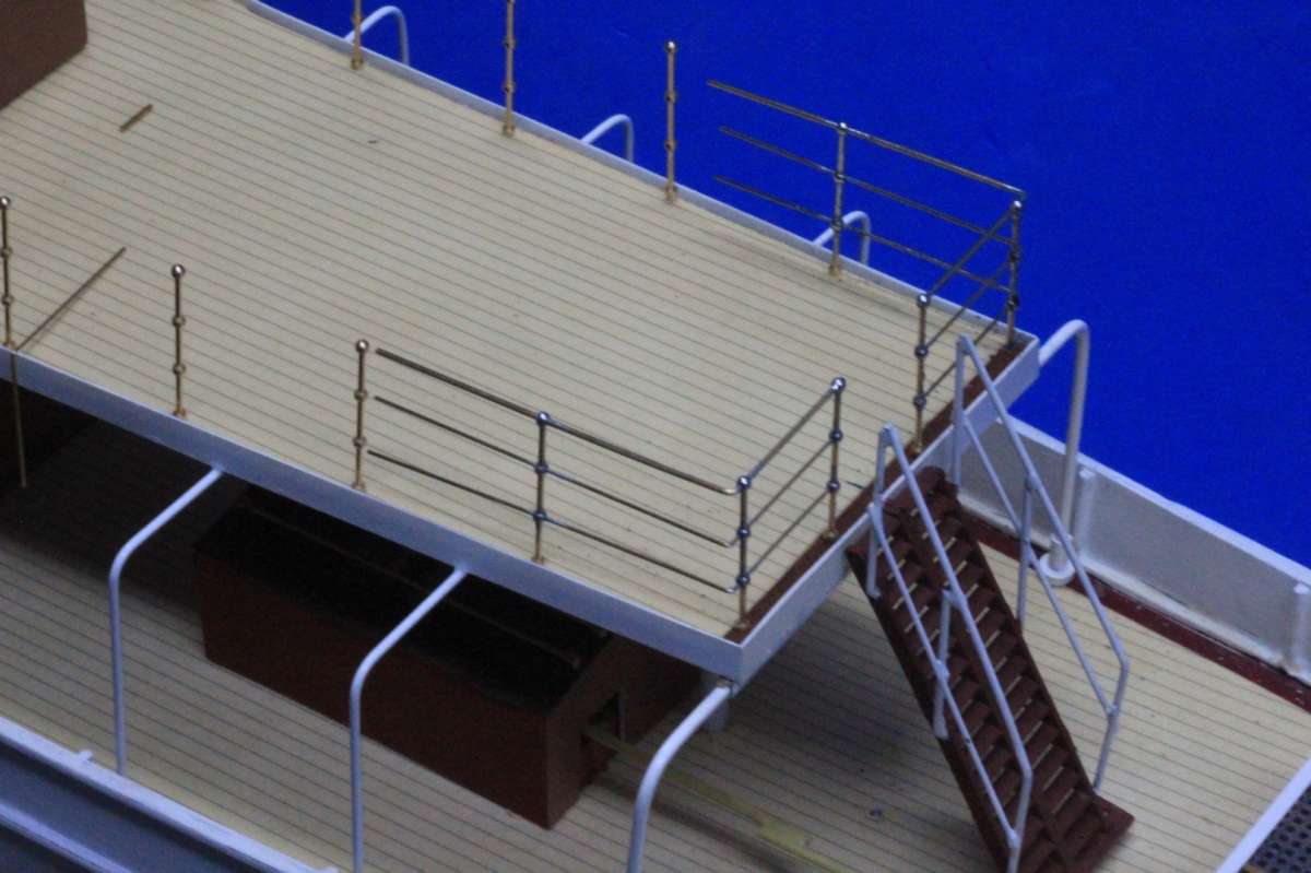

                      I do think it is worth mentioning one other method which nobody else I know seems to use. Handrails, as in Richard’s post above, are always a fiddly job and for these I have always found Carr’s solder paint to produce a neat result whether using pre drilled stanchions or just wire to wire joints. You do literally paint it on and apply heat to the wire adjacent to the joint and it melts around it to give a very neat result. I described this in my recent paddle steamer Bilsdale article and the image below shows it in progess. You can see how tidy the joints are and very little cleaning up is needed. In this case pre drilled brass stanchions were used but I have had equally successful results at smaller scales by making up a wooden jig off the model to hold the uprights and rails in place, solder painting the whole section and applying heat along it in one operation. The section is then removed from the jig and any excess snipped off and filed.
                      I’ve no idea how ultimately strong the joint is structurally, it’s certainly adequate for what I have done. But, as Len says, it’s horses for courses, and the solder paint is excellent for delicate built up constructions.
