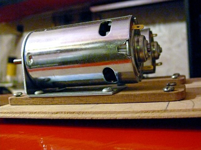

                                      Big problem!……..Not enough room for the water cooling pipes!
                                      But on closer inspection, the motor base has a cutout in the bottom. If I cut out the wooden base………….There`s just enough room for 3/16 dia tubing!…..Phew!
                                      Saved again!…………………….Bob
                                      Edited By Bob Abell on 24/01/2010 08:32:28

                                                    Is there any sense in fitting an air fan to the motor coupling……..To avoid the water scoop method?
                                                    I`m a bit concerned about the scoops getting blocked up with duck muck or weed etc
                                                    It was normal for industrial motors to have fans built in as standard
                                                    Seems a good idea to me………Bob
