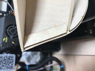

            the front is quite a severe bend, and not much give in the balsa. The rest is a pretty straight line. I did a test fit and it will break if I force it. Wondering if I can steam just the part that actually bends rather than trying to soften the whole thing.

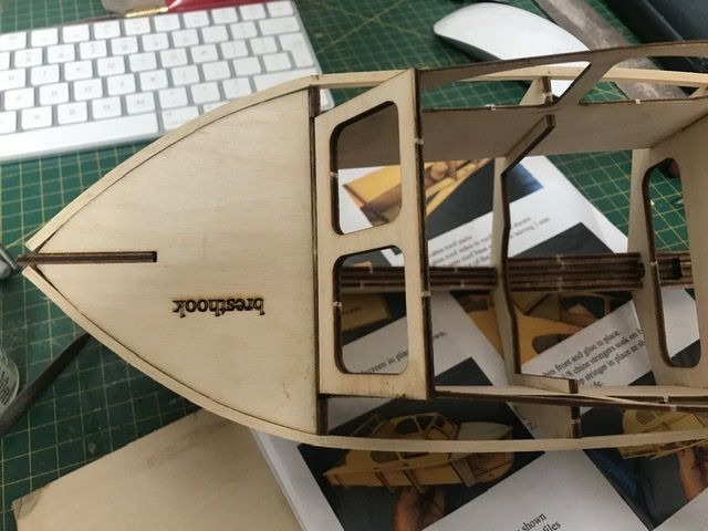

              Most of the old plywood designs had substantial breast hook and similar for the chine at the bow this reduces the need to bend the strip at the bow, Not familiar with Mr Tom design, but would be interested in a shot of the drawing ?

                ce3ed8eb-4eb2-4a6a-951c-f83ab5330645.jpegThanks Ray
                Not sure what this particular balsa is, but after soaking and leaving to dry a little the super glue did hold it around the breast hook. 64838f99-b322-4f82-a678-1ec9e20c109a.jpeg
                #100891
                Andy C
                  @andyc56856
                  Looks like I need to tidy up the very front part but happy enough so far

                          tome for the hull sides. Looks like I need to shape the stringers to give something to add glue too. Any suggestions, I was thinking just sandpaper. I have permagrit sanding blocks, but what sort of angle am I looking for.

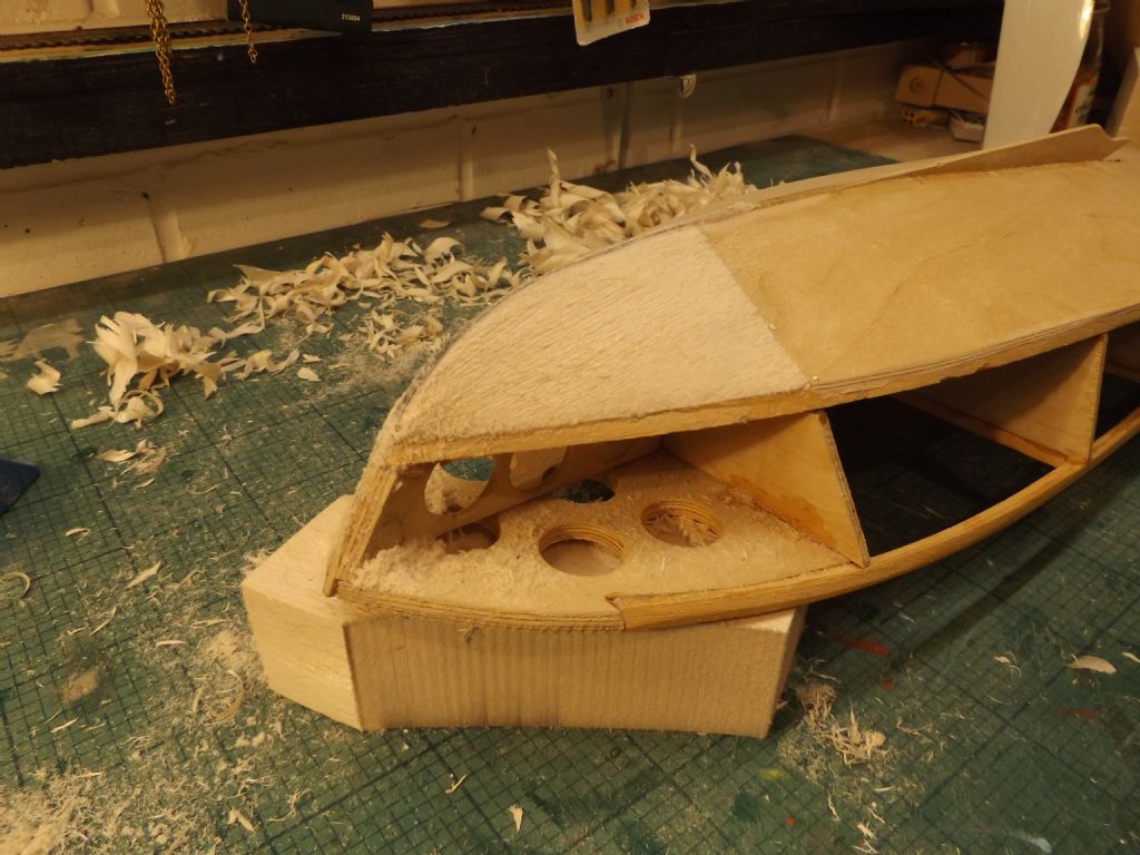

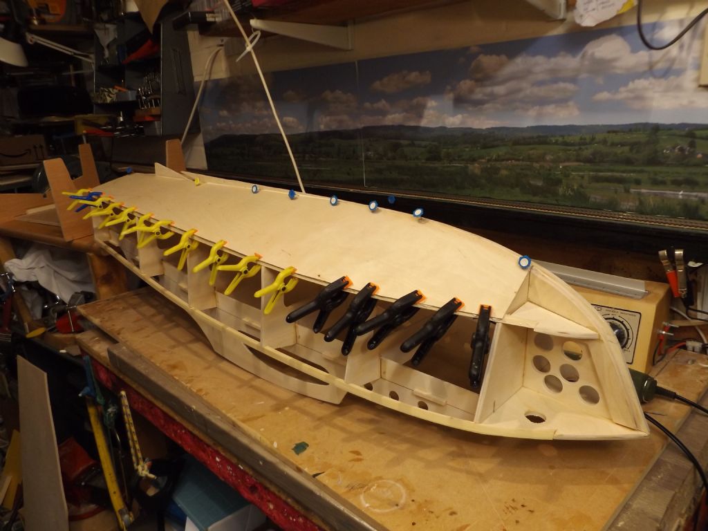

                                sh wd sq oct 16 006.jpgHere we go Andy,
                                Before you worry about rubbing down to shape you need parts added ! the stem doubler should be pre bevelled but as it's fixed I suggest a balsa infill be glued on to allow you to sand the stem to the same angle as the stringer at deck level. the chine stringer also stops shy of the stem so I also suggest you add another stringer to the fixed on to give you some meat to sand down, this may sound extreme but to have gluing surfaces I see no alternative really.
                                I also think fixing the bottom skins will be difficult, so I'd use balsa block or lamination of balsa to fill the gap below the chine. Although this design is mentioned as a Les Rowell design I doubt had this method of construction in mind, this is the way he would have built it as his Sea Hornet runabout. I hope this helps Regards Raysh wd sq oct 16 001.jpg

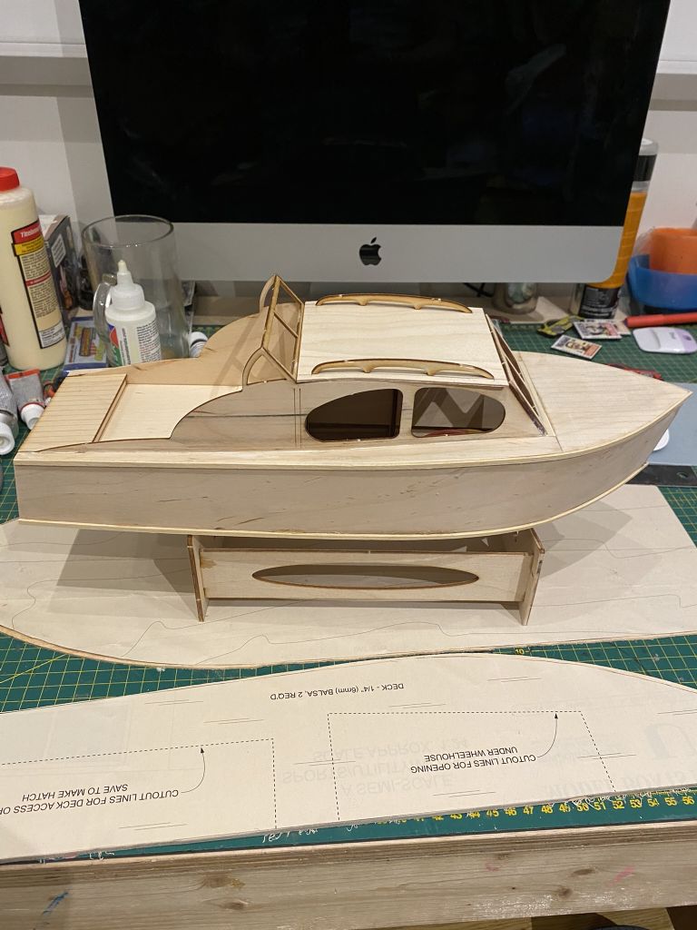

                                  not posted updates on Mr Tom for a while, but have made progress.
                                  AndySide view
                                  #103533
                                  Andy C
                                    @andyc56856
                                    Deck part in the photo is from a boat my son is currently building. More on that in another thread.
