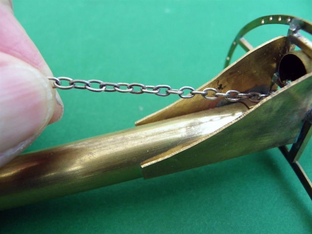

          I have been watching the magnificent build of the Wahine, lately concerning chain. Not wanting to hi jack the thread, thought I would say a few words on chain. I don't normally make large models, but recently started making a mast top assembly for an iron square-rigger from brass (Just for illustration purposes). I required a short length of chain to support the yard truss. I made this piece from tinned copper wire. Each link is soft-soldered. It was a bit tedious, but I didn't require much of it. At larger scales, I don't think it would be much trouble to make studlink. At a few links a day, a long length would soon be built up. I never did like the idea of 3D printing! I soldered two needles next to each other (at the eye ends). Wrapping tinned copper wire round them gave me the oval shape. The resulting oval "spring" was slid off, and the links cut with a scalpel. After each link was added, I painted the joint with flux, and soldered it.
