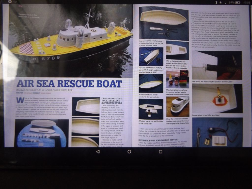

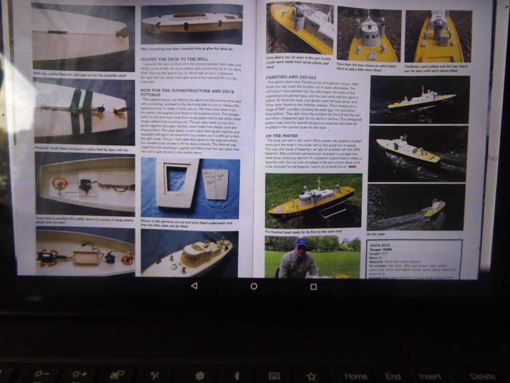

                          tw29 a.jpgHi Sinking,
                          Mr Google is your best friend if you searching about for model stuff, This Vac formed hull is a standard hull available with a variety of different tops ie, Pilot boat & Police launch etc etc.
                          This is the magazine article from the web excuse the photos of my tablet
                          Edited By Ray Wood 2 on 28/08/2022 17:23:44

                            The article can be found on the advert & is easily readable.
                            Click on the article thumb nail to make it the main view and then put your cursor over the image and right click and select "save image as" from the dropdown menu. You now have a very readable build article.
                            Article
