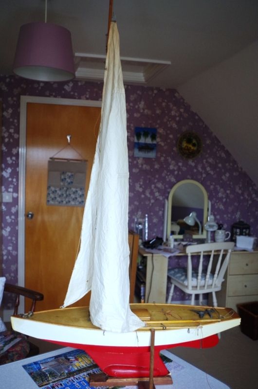

      At Christmas I was given an elderly model sailing yacht in need of restoration. It had lain unused in the DT department of a local school for at least 20 years and was destined to be thrown out unless someone took it away. So my daughter, who is a teacher at the school, thought it would be something for me to work on.
      She is a fair-sized boat: 76 cm overall, 23 cm beam with a 112 cm mast, 41 cm main boom and 28 cm jib boom, and seems to be of an all-wood construction.
      Most of the running and standing rigging has disintegrated with time and the sails are starting to fall apart.
      So, I have several questions.
      1. Is she of a known class? The hull reminds me of the Star class of yachts, although the rake of the stem is not quite right.
      2. What is the best line to use to replace the rigging? I was thinking of an un-waxed whipping twine.
      3. What is the best material for the sails, and is there a recommended supplier?
      As a former racing dinghy sailor I am more used to full sized boats than models, but I enjoy a challenge and would like to see this boat back on the water.

          Looks like either a Star, or one designed by somebody who liked them.
          The lightest venetian blind line that you can lay hands on is a good rigging line, both standing and running. Doesn't stretch, low surface friction. I've also used a fishing line that I believe was called "salmon backer" but the label fell off the reel years ago. Again, braided and non-stretch.
          If you know somebody who is willing and able to sew, an old poly cotton shirt makes fine sails. Otherwise, Nylet, Housemartin, Sails etc will either have the right sails listed or be able to do bespoke ones.
          It looks like a free sailing pond yacht, it will need to be sailed at a suitable venue – one with access all round. Such venues are not as universal as they used to be, remote control allows sailing in many more places. With modern components, fitting a radio is much easier than it used to be.

                She looks very like the 30 inch sharpie in the 1950 Daniels & Tucker book "Build Yourself a Model Yacht" (where all the dimensions are in good old inches but correspond pretty well). The layout of the fittings on the deck match as well.
                The Vintage Model Yacht Group website has an example in their What is it? pages, with lines and sail plan:
                http://www.vmyg.org.uk/pages/gallery/whatis/my76.htm

                  Thank you Tony, and all who have welcomed me to this forum. From the plans she certainly looks like a 30" Sharpie. I will check the dimensions to confirm. Being a "Build it yourself" fits in with coming from a school, she was probably a DT class project at some time in the dim and distant past.
                  It is very useful having the details of the sail plan, both standard and reduced. Now when I have some suitable material I will sweet talk my wife into getting out her sewing machine.
                  Expect several more posts on here as I ask questions and show any progress made. My intention is to use a light touch and refurbish where possible rather than replace.

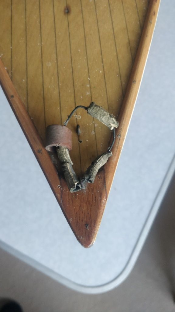

                      I've made a start. Mast and spars have been sanded down and the first coat of varnish applied. Patterns for the sails made, some suitable fabric has been found and my wife hopes to make a start on them this afternoon.
                      Another question. Does anyone know what the piece of kit in photograph is for: The pieces, which are threaded on stiff wire, are rock hard now but probably were once soft rubber. Would this have been a home-made bow fender?
