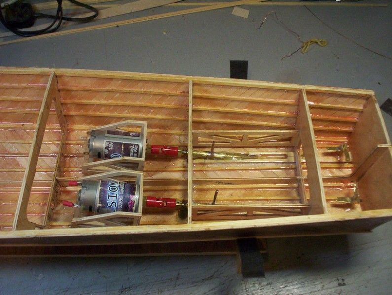

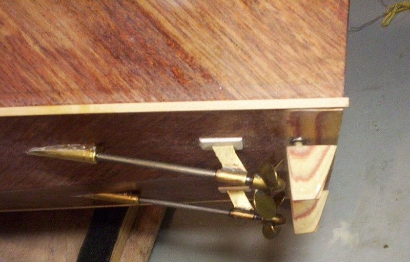

          Hi there Peter – are you going to build the model as per Plan single prop? or twin prop or even triple prop as some of these boats were? If you do a search on Mayhem – I build this model using Vic Smeed's plans as a reference and also I used an awful lot of original material from Vosper. My model has twin props both rotating in the same direction as per original. Props are 32 mm diameter 3 bladers and Mtronik motors vision 600s.

                  Simplicity is sometimes the best policy by keeping it single prop – although I am not a great lover of brushless motors – I prefer the old ones (plug in and play ) instead of having to programme but that just me ..
                  The motor Dave Milbourn has mentioned will no doubt do the job – the thing to remember is – when Vic Smeed originally drew the plans up for 99% of his plans it was to use with materials that were available at the time. When the RTTL plans were originally drawn in the 1950s there wasn't a great choice of materials to build the craft from or was there a very good choice of motors to power the craft – compared to what we have these days.
                  Taking that into consideration we can now build a model using lighter materials and therefore requiring much less power to propel the model in the motor apartment to achieve a greater speed and this is why when I built my RTTL I only used 4mm ply for the bulkheads and I removed the centres of all of them which, if you have a look at the plan which Vic has drawn. you can see he has left several bulkheads 'solid'. He also uses a very thick keel which I reduced down to 4mm in thickness.
                  Hope this has given you some food for thought. John
