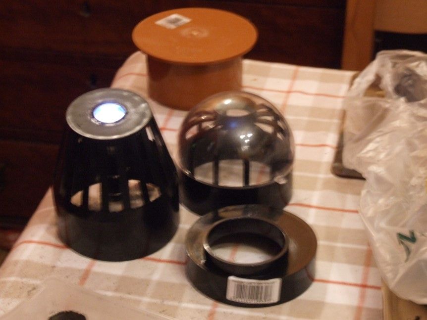

            Len, I saw an article in a model boat mag..not sure which one, whereby a chap had built essentially a ROV out of plumbing parts, large stuff, 5 inch sort. Ideal..right colour (can get in Yellow I think) and easy to put together.. all the bits and domes usually have screw together ends, can get glue specifically for the pipe-plastic..
            Should be easy with i bit of thought. Use the sort of pumps that Paul T is using for Thor for your thrusters

                Some Days, Weeks, Months, ok years !! ago I started (Still on build list) to build a ROV from bits of piping ( was told not to get any more Boat bits) or else,
