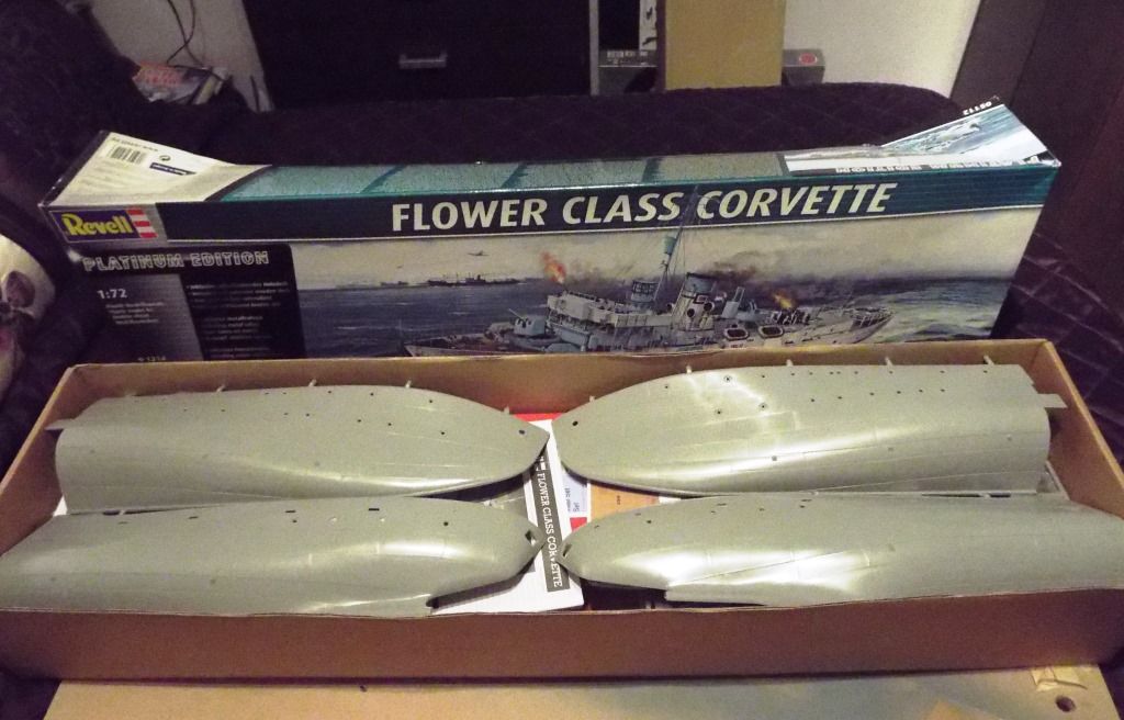

      I started this back in January 2017 for a group build on another forum.
      We were given until December to complete our builds, unfortunately I didn't make it and is still on going.
      The problem is apart from life getting in the way, I also suffer from getting bored when I only work on one build at a time.
      I never attempt to replicate any particular vessel, I prefer to use what I like to call builders licence.

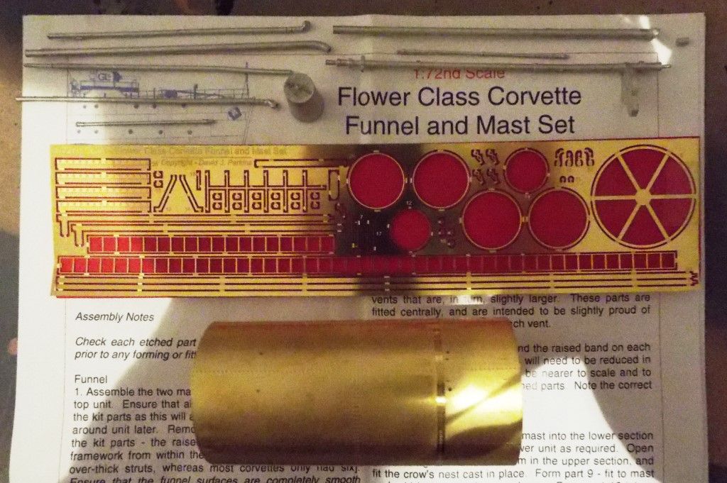

      The kit itself is the Platinum version with photo etch and wooden decking included.
      I have purchased several after market items such as GLS PE kits, stanchions, weapons kits, etc.
      This is the build so far, starting from opening the box.
      A little flash here and there and some fit issues, but nothing that can't be corrected.

      GLS Funnel Set.

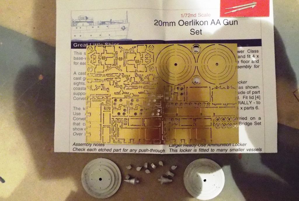

      GLS 20mm Oerlikon.

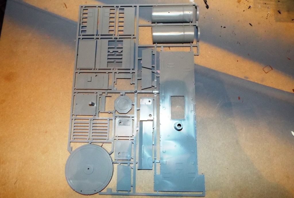

      Box Art

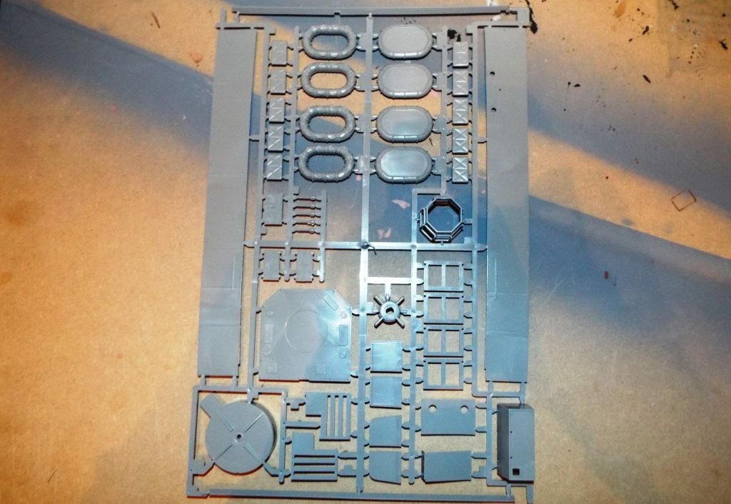

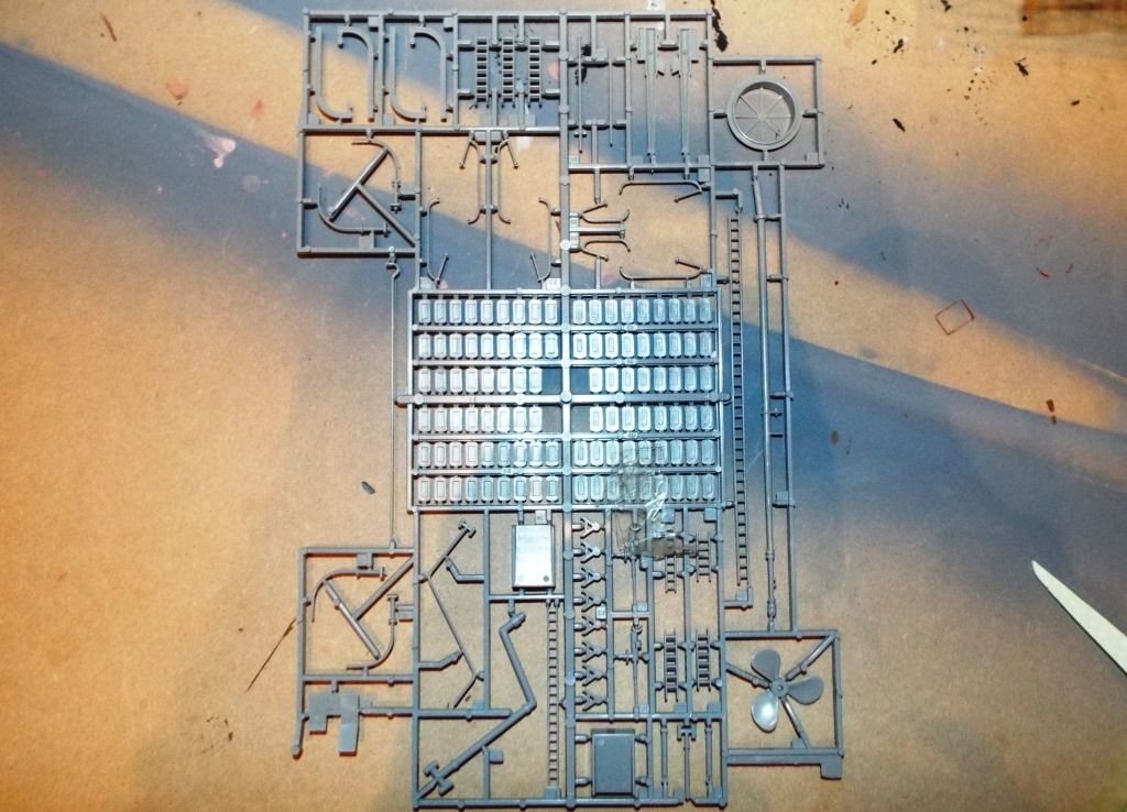

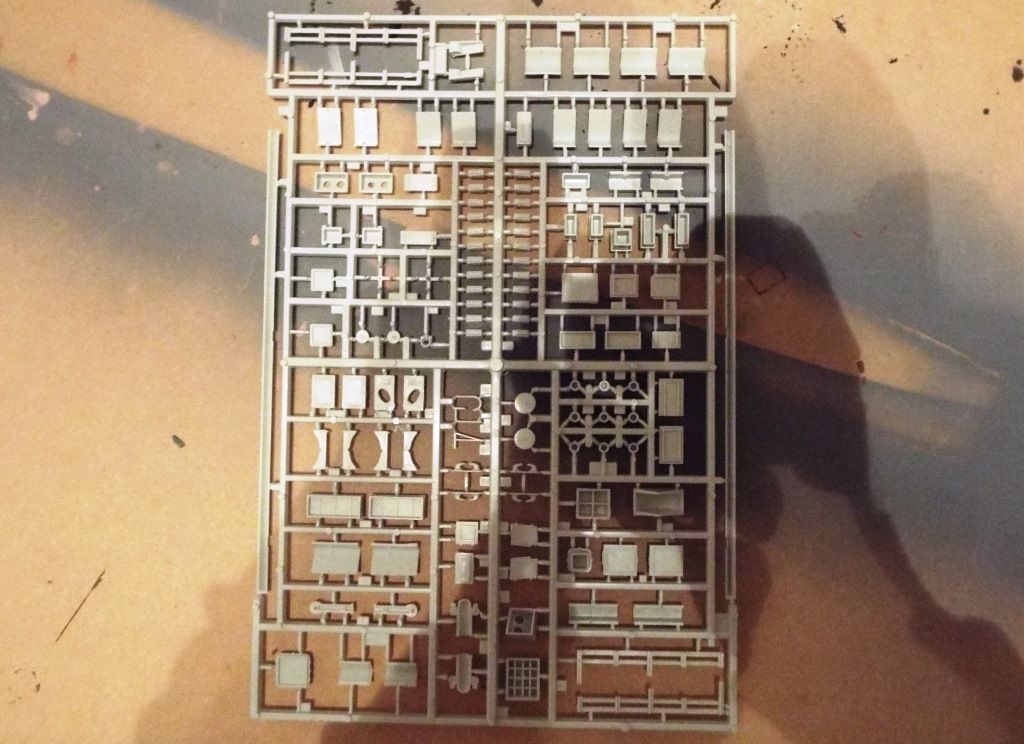

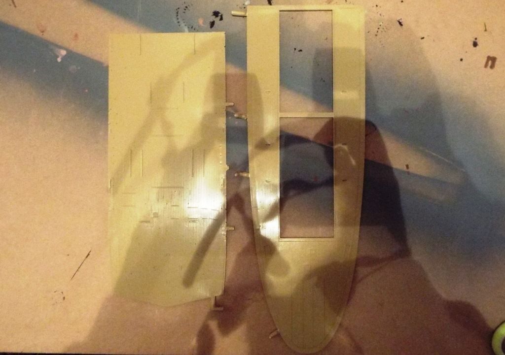

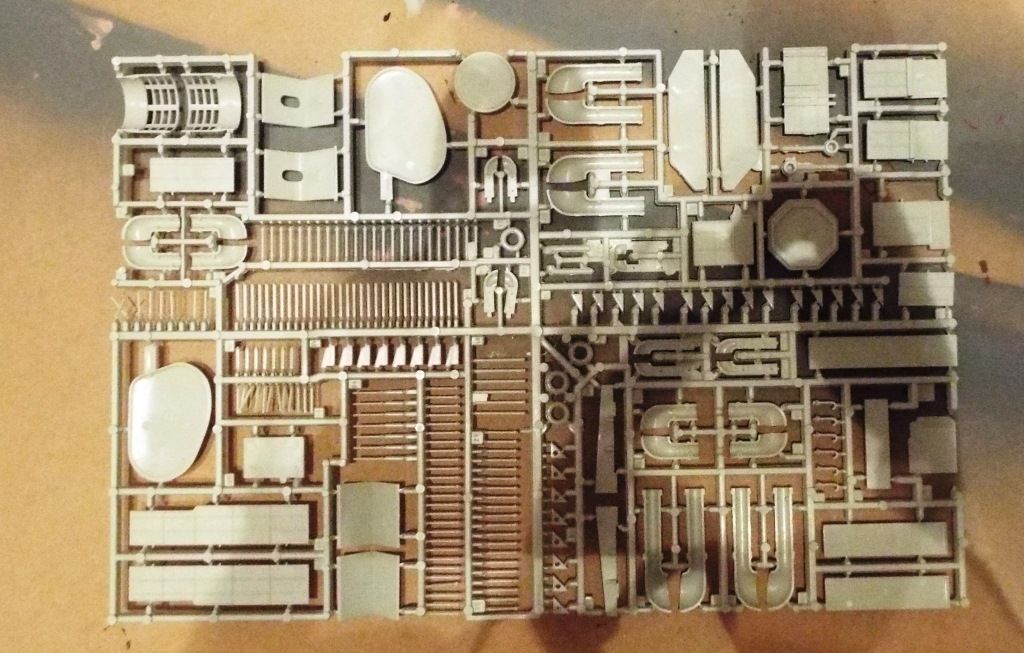

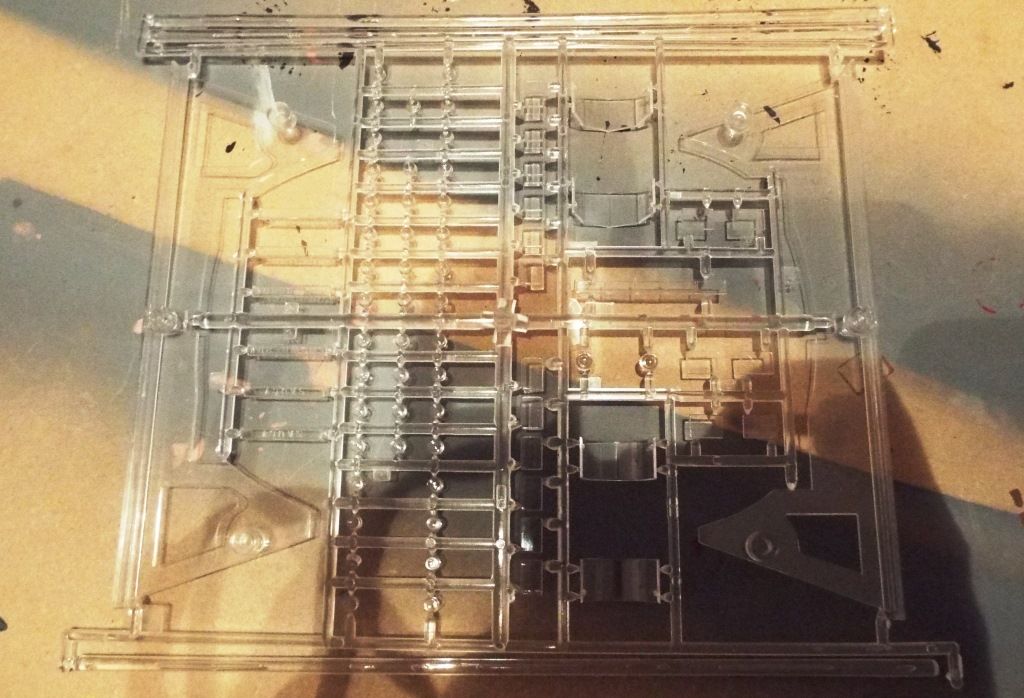

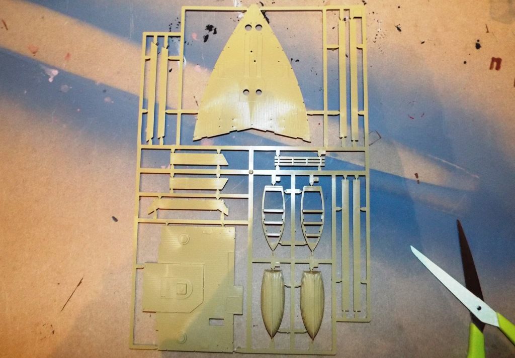

      Box ContentsSprue Shot 1

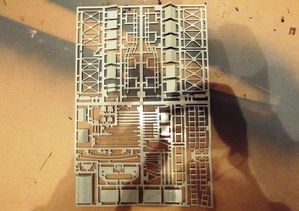

      Sprue Shot 2
      Sprue Shot 4
      Sprue Shot 5
      Sprue Shot 6
      Sprue Shot 7
      Sprue Shot 8
      Sprue Shot 9
      Sprue Shot 3

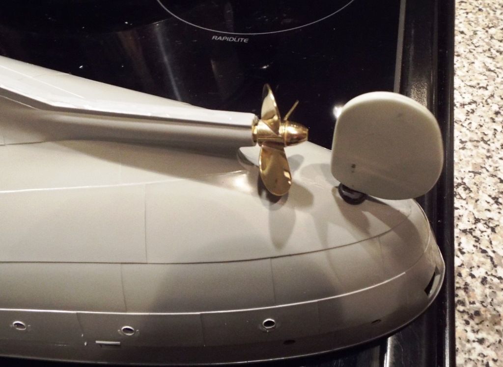

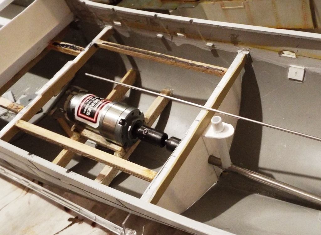

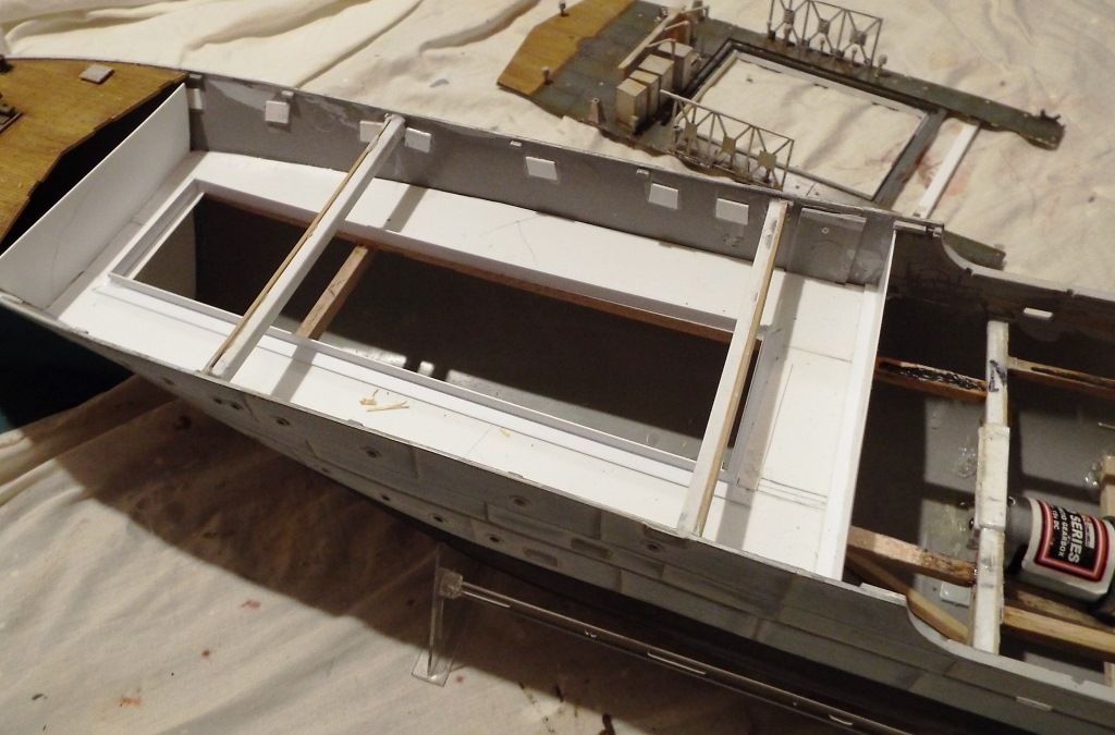

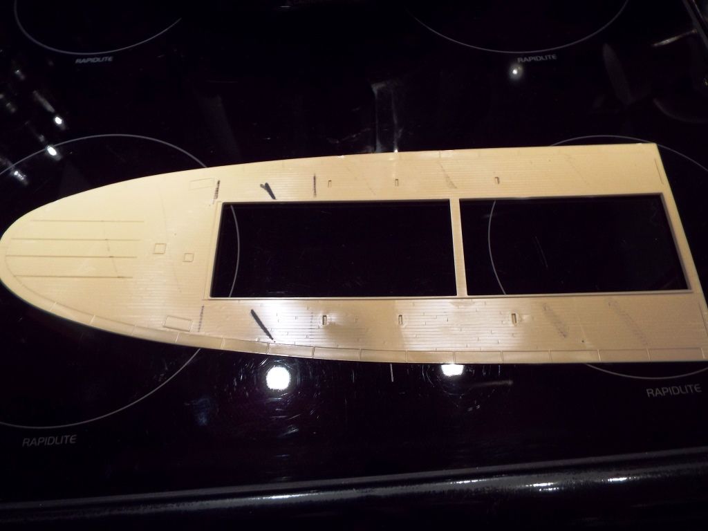

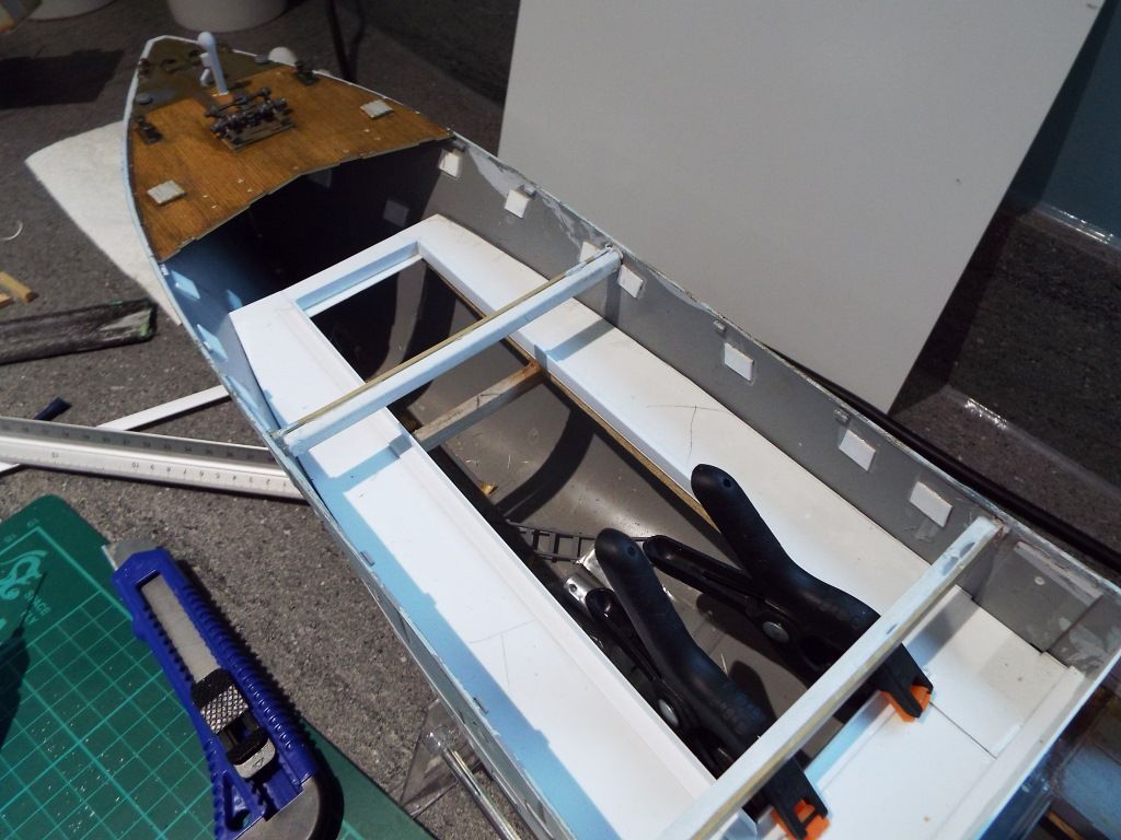

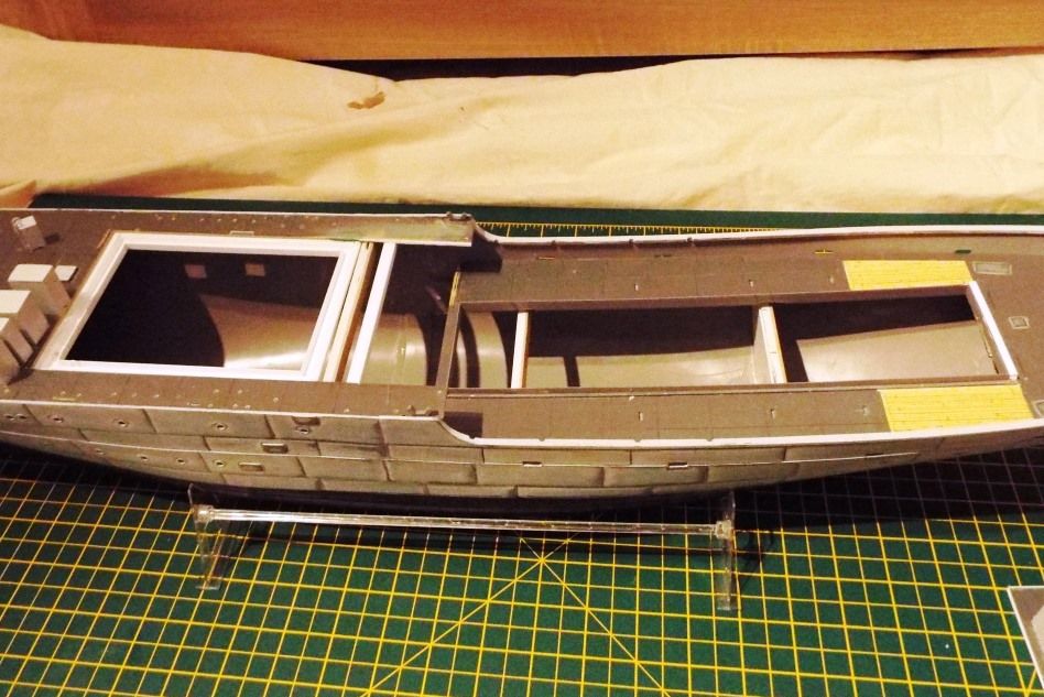

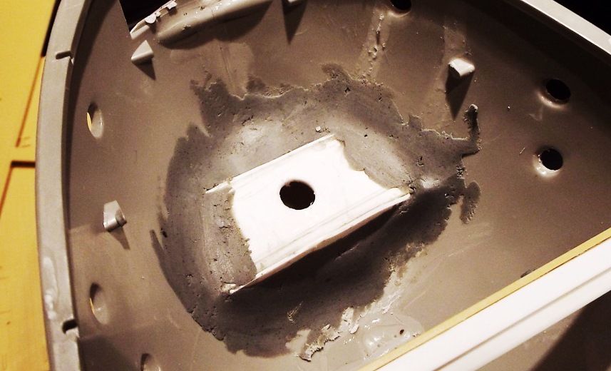

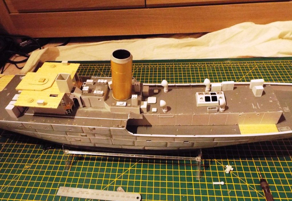

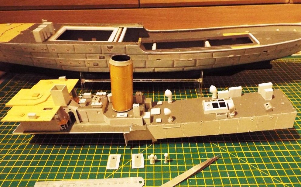

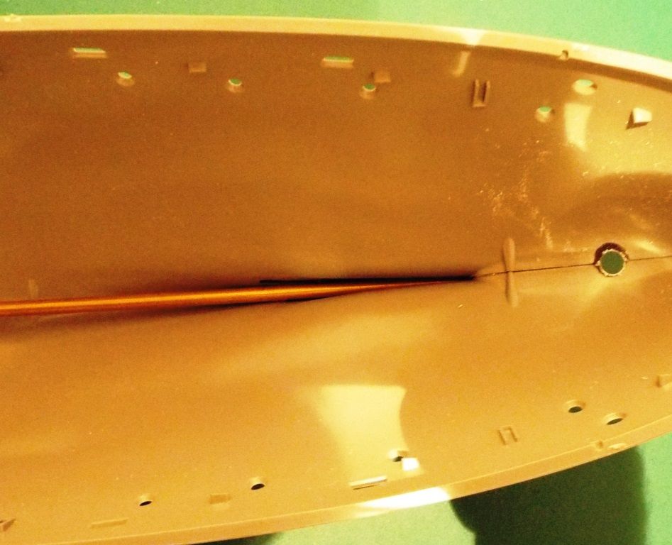

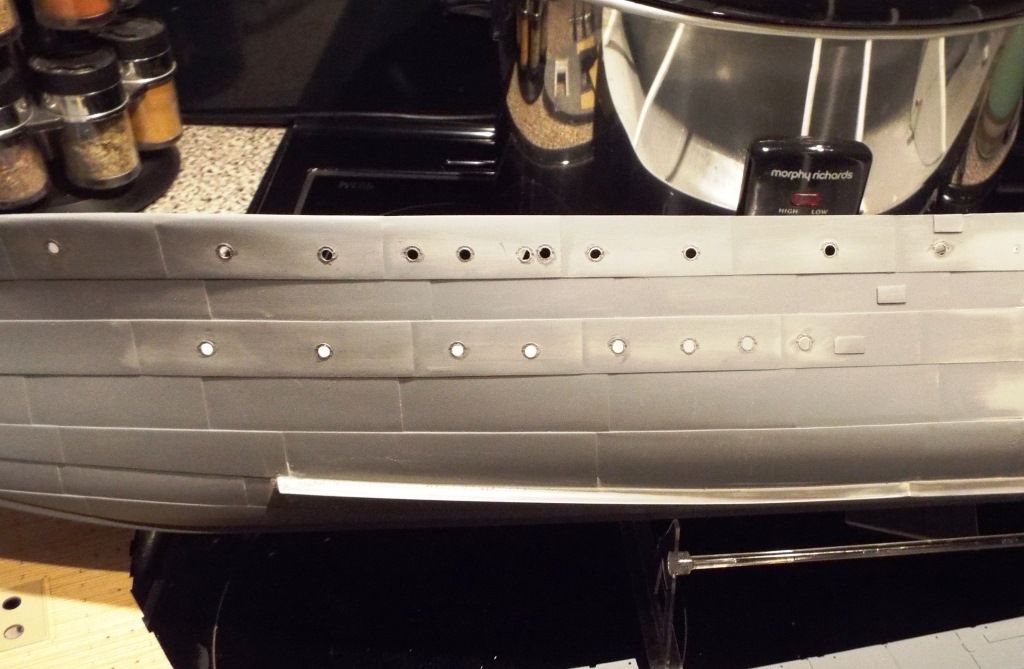

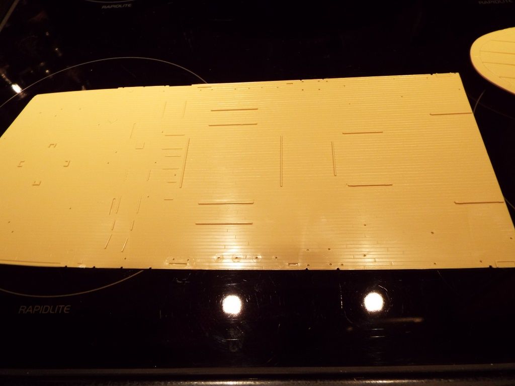

            bracing for waterproofing.jpgbracing for waterproofing 2.jpginternal decking..jpginternal decking.jpgrudder aperture.jpghull re enforcment stern.jpginternals (2).jpgprop tunnel opened up.jpgprop & rudder fitted..jpgpe portholes.jpgmoulded planking removed 1.jpgmoulded planking 3.jpg
            Edited By ojays on 18/02/2018 23:21:14
            #75901
            ojays
              @ojays
              I forgot to put the txt in on the above post and now it won't let me edit and add.

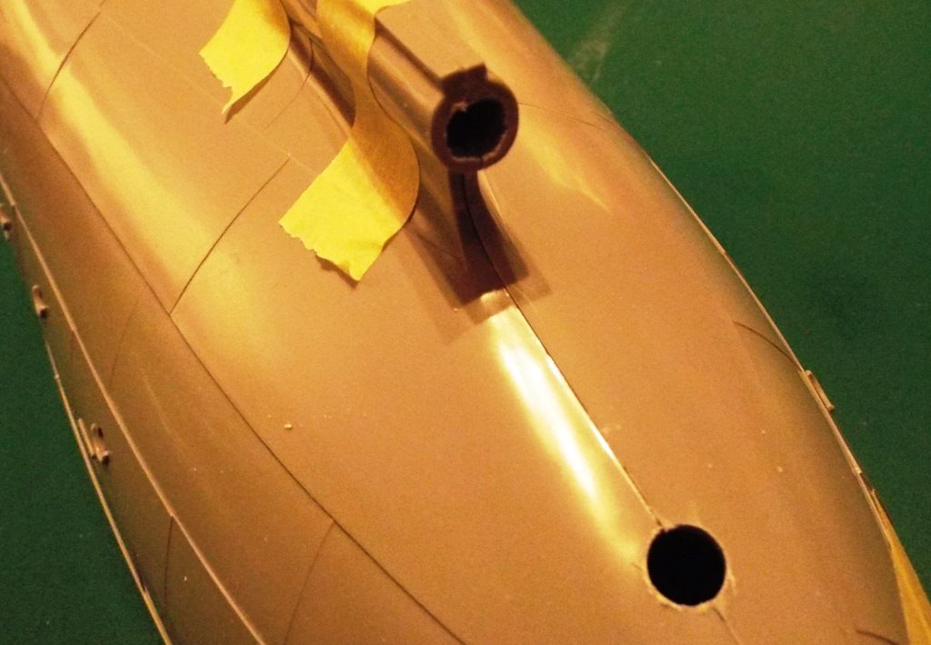

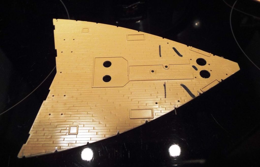

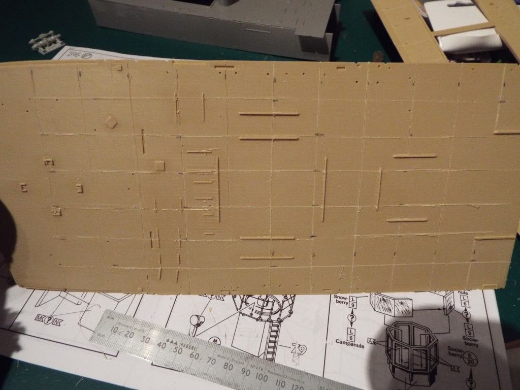

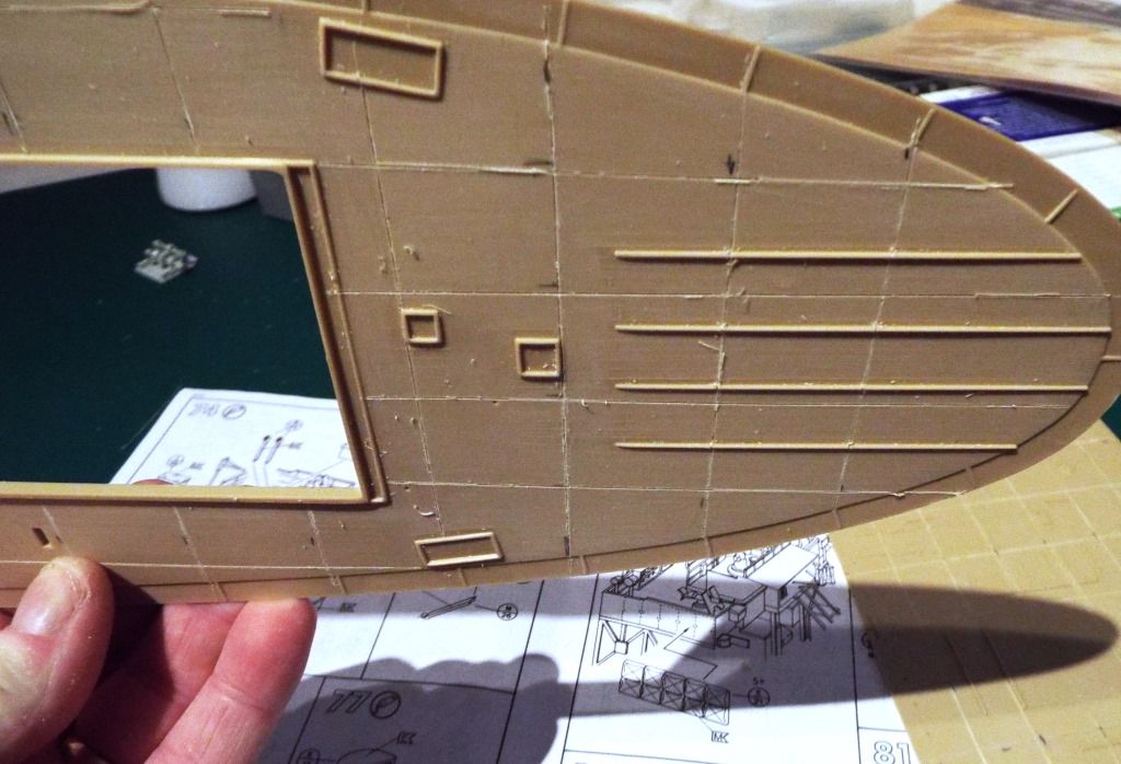

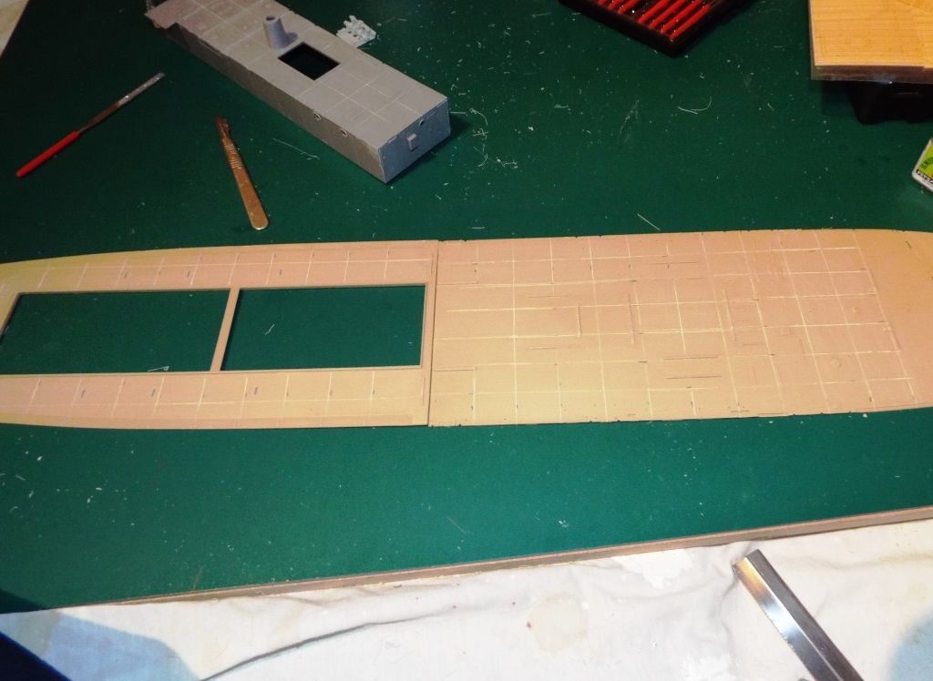

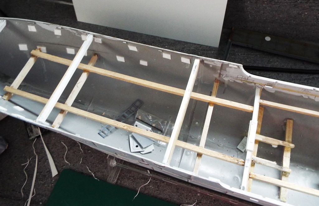

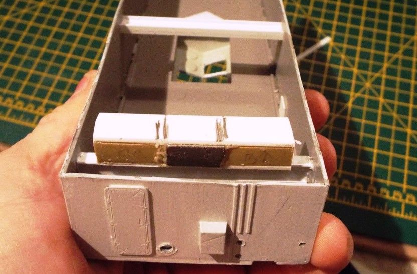

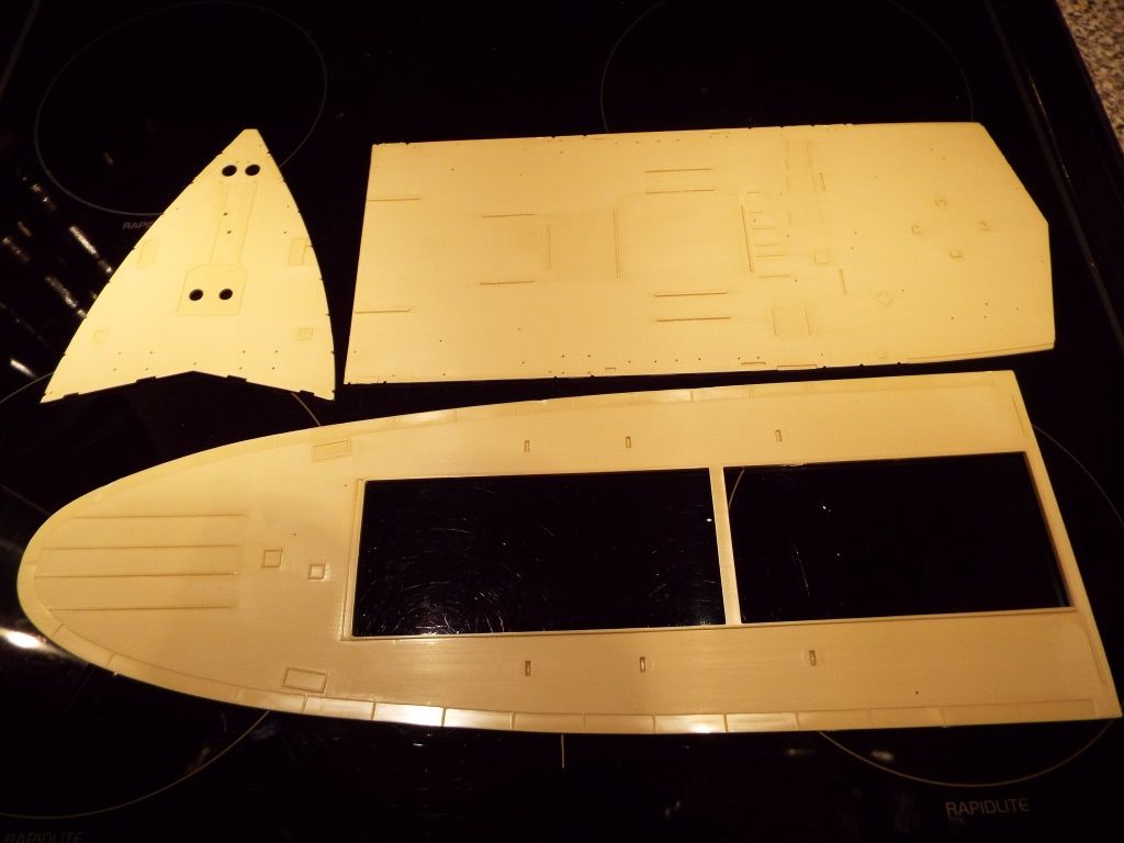

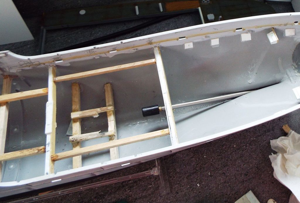

              Work done there is moulded decking removed and sanded down, bracing in the hull to make it more secure and be able to fit internal weatherproof decking.
              Holes for the prop shaft and rudder assembly.
              More to follow tomorrow.
              Edited By ojays on 18/02/2018 23:25:45
              #75911
              Malcolm Frary
                @malcolmfrary95515
                Does the internal weatherproof decking have somewhere to drain to other than over the coaming and down the insides? I arranged troughs on mine to drain through holes in the hidden bulkhead on to the after deck. It worked reasonably well in conjunction with the false deck under the gun area. I wouldn't want to trap any water above the waterline, especially in a flat area where it could slosh about.
                #75923
                ojays
                  @ojays
                  Posted by Malcolm Frary on 19/02/2018 09:39:44:
                  Hopefully there won't be any water ingress, as there will be a rubber membrane between the decks and the hull sides.
                  I use the rubber from windscreen wiper blades as here on my schnellboot.

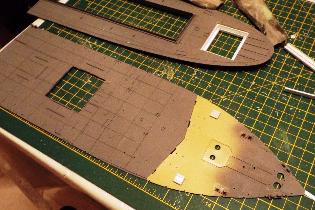

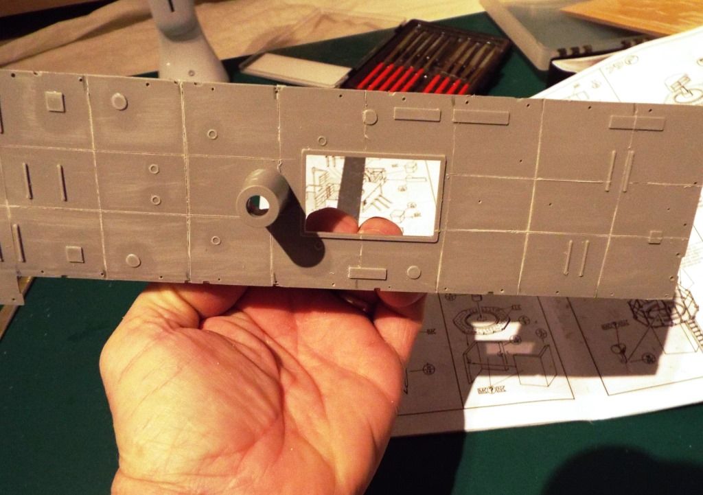

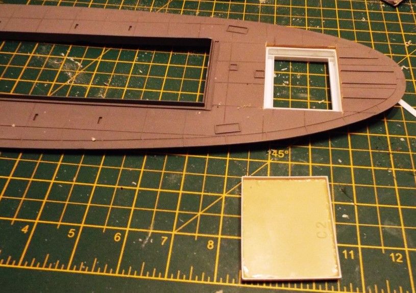

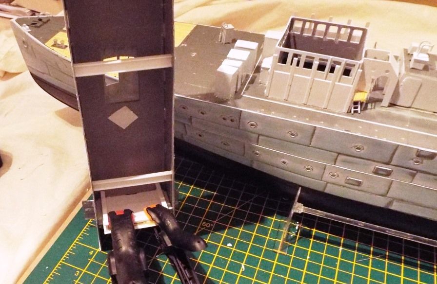

                    After removing the moulded decking, I scribed in deck plates where it would not be covered with the wooden overlay.
                    Next was to open up areas of the deck for access hatches, the extreme rear one is beneath the depth charge railings
                    I use very strong magnets for securing hatches, as I don't like screws/catches showing.

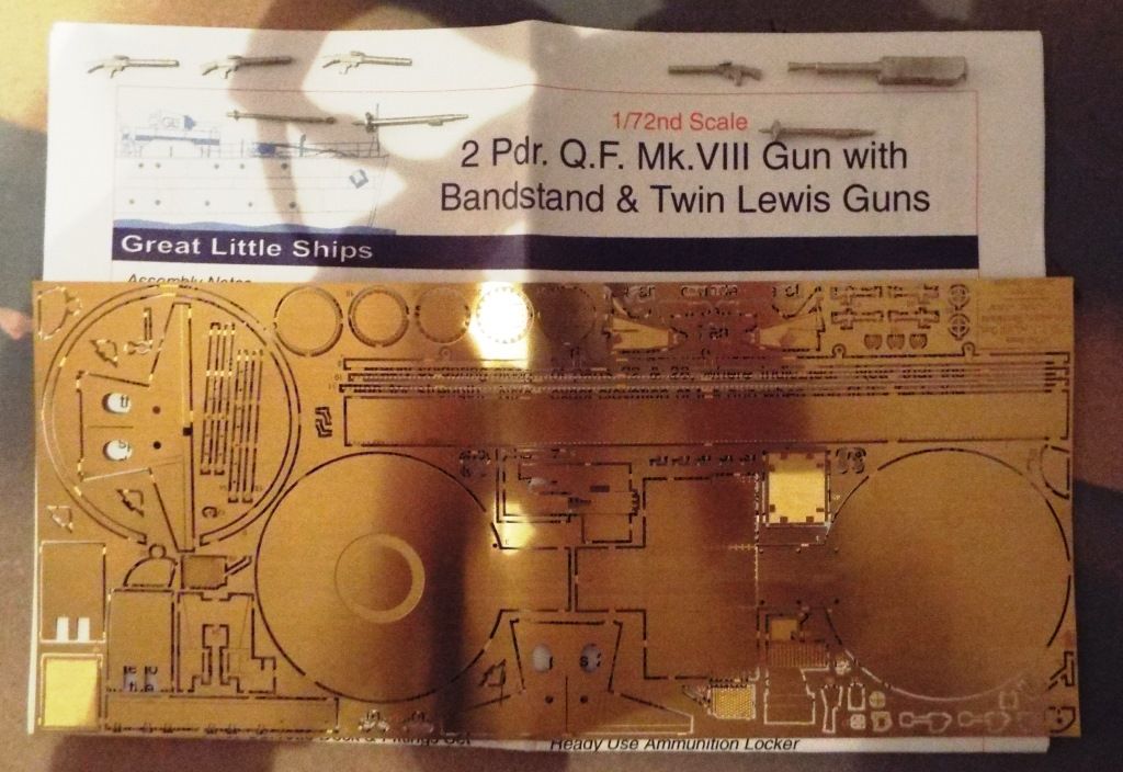

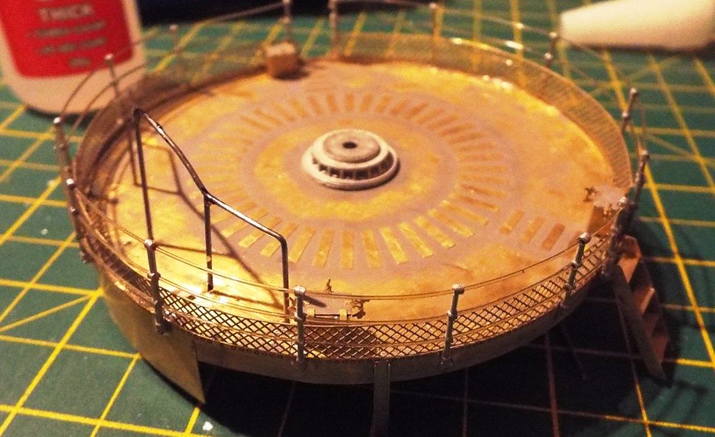

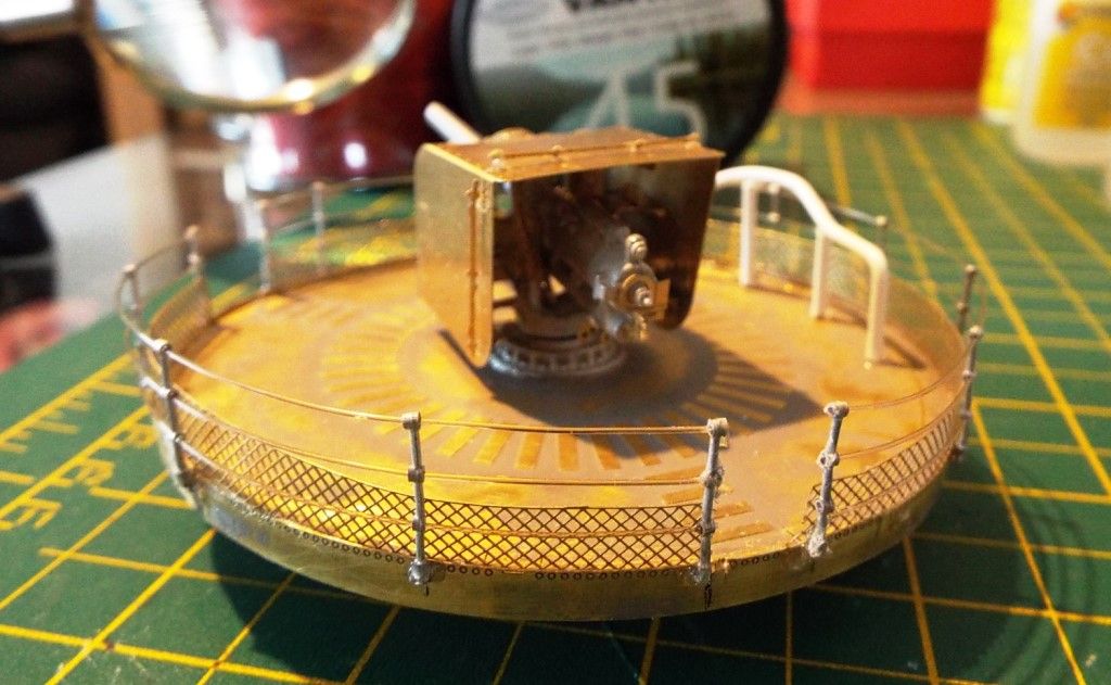

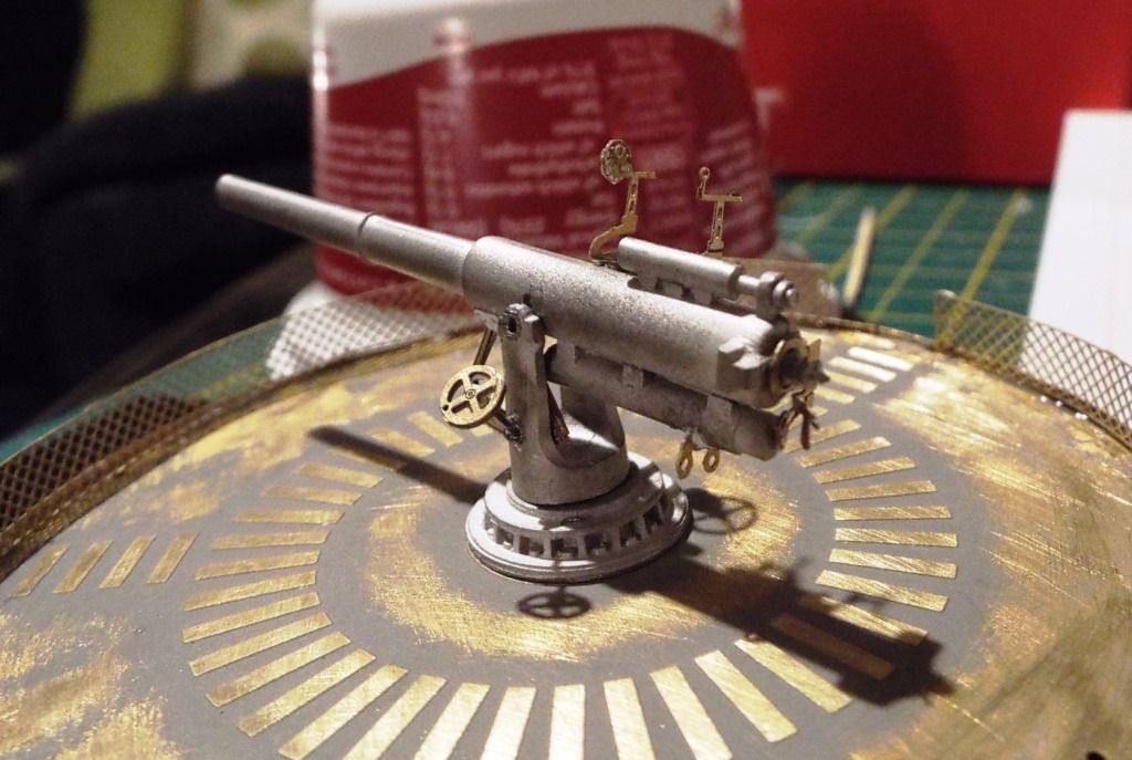

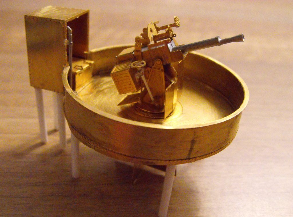

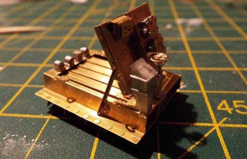

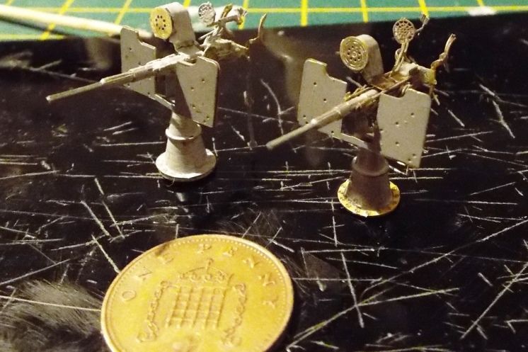

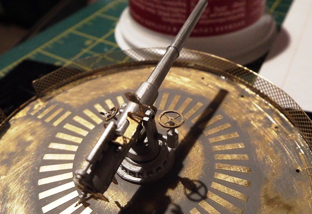

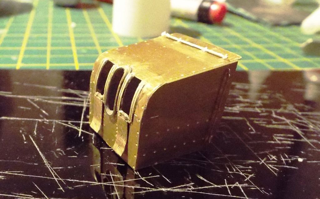

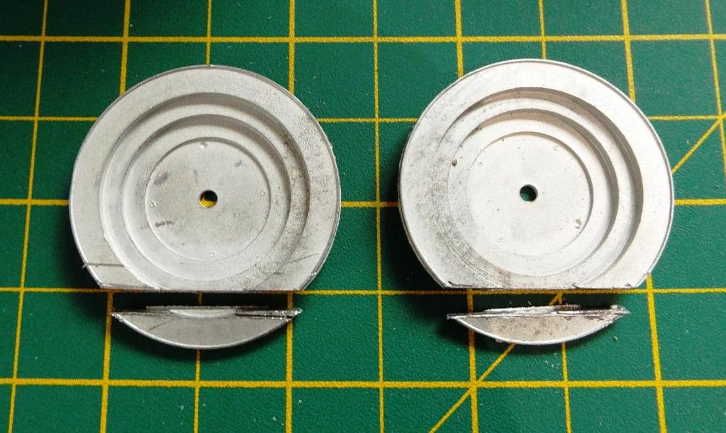

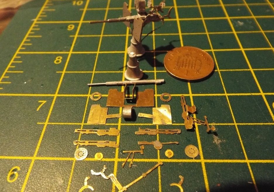

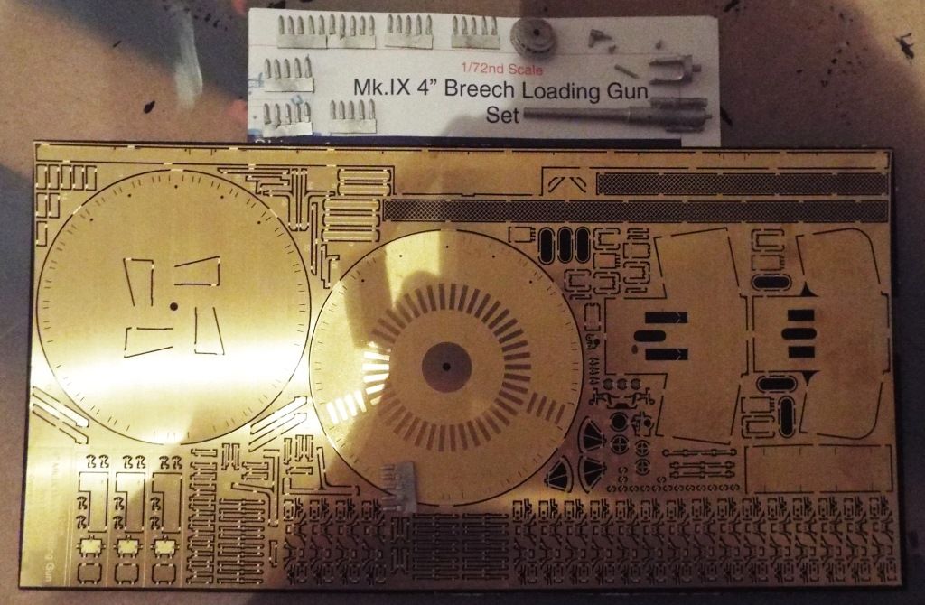

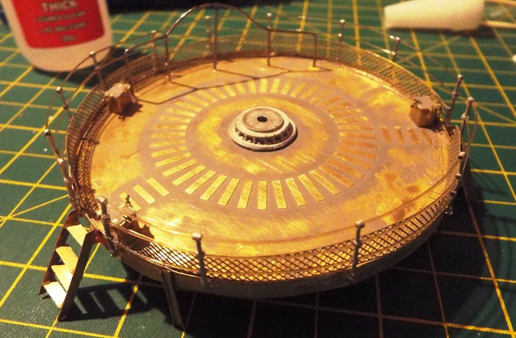

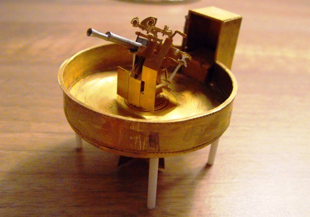

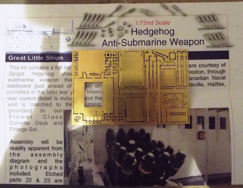

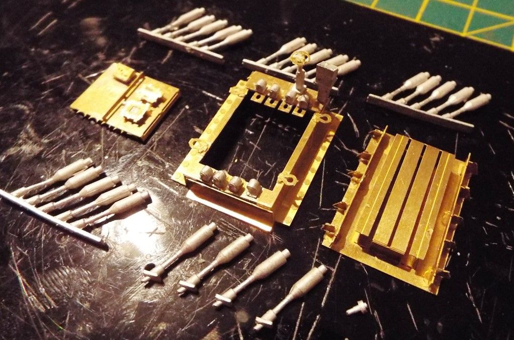

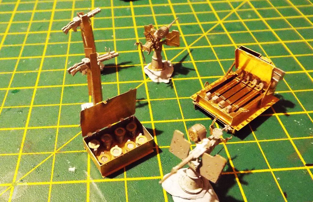

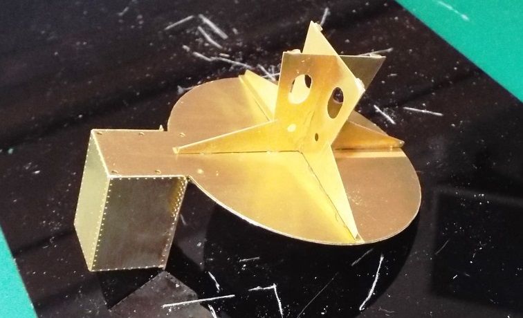

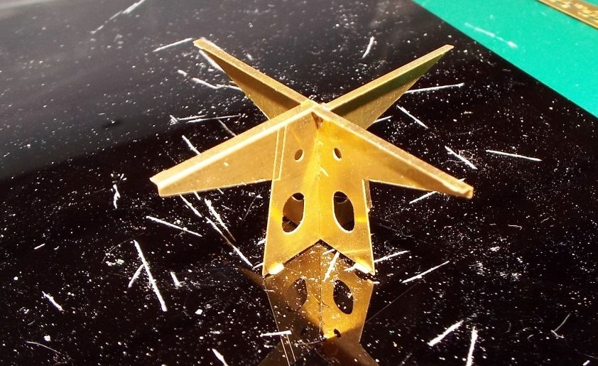

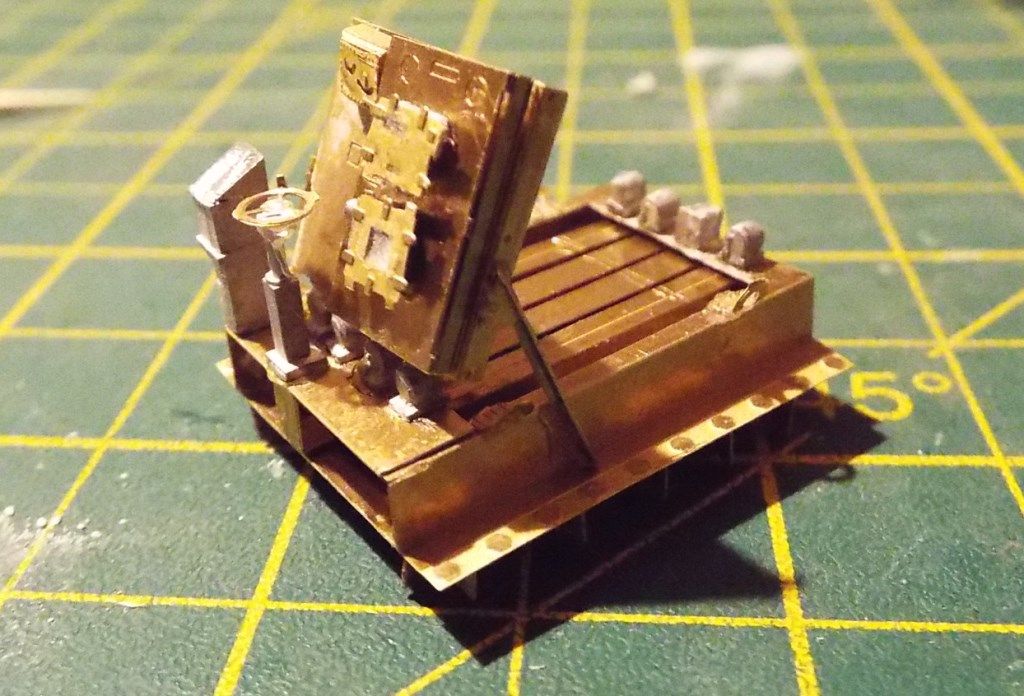

                      Some of the GLS photo etch to be mounted around the deck etc.
                      4 pdr main weapon and bandstand, 2pdr Quick fire weapon and mounting, 20mm Oerlikon, Hedgehog depth charge projector.

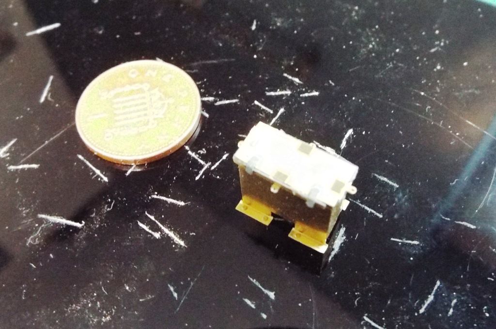

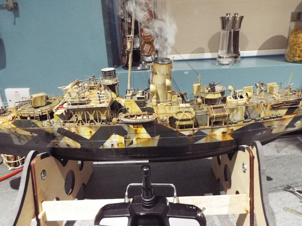

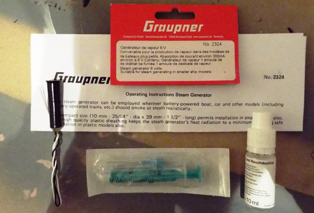

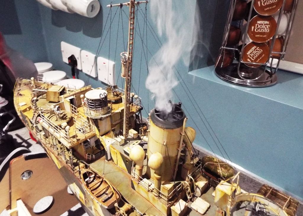

                        Jumping ahead, finally got the smoke working.
                        #81401
                          @timrowe83142
                          That's pretty impressive Ojays.
                          How long is the boat? There is an amazing amount of detail to squeeze in.
                          I am also intrigued by the servo arrangement. It looks almost like some kind of mechanical mixing. Can you explain how it works?
                          Great job and you must be very pleased.
                          Tim R
                          #81407
                          ojays
                            @ojays
                            Posted by Tim Rowe on 10/03/2019 12:37:37:
                            Tim R
                            Thank you for your positive comment.
                            Unfortunately that photo is of my Italeri 1/25 S-100 Schnellboot inadvertently posted in this thread.
                            It is for the Lurssen Efekt on the outer rudders. It turns the outer rudders outward by 30 degrees allowing for better speed and economy. Whether this is true with the model is debateable.
                            I tried to remove the post from the thread, but I couldn't edit it out.
                            The full blog for the S-100 is on this group if your interested.

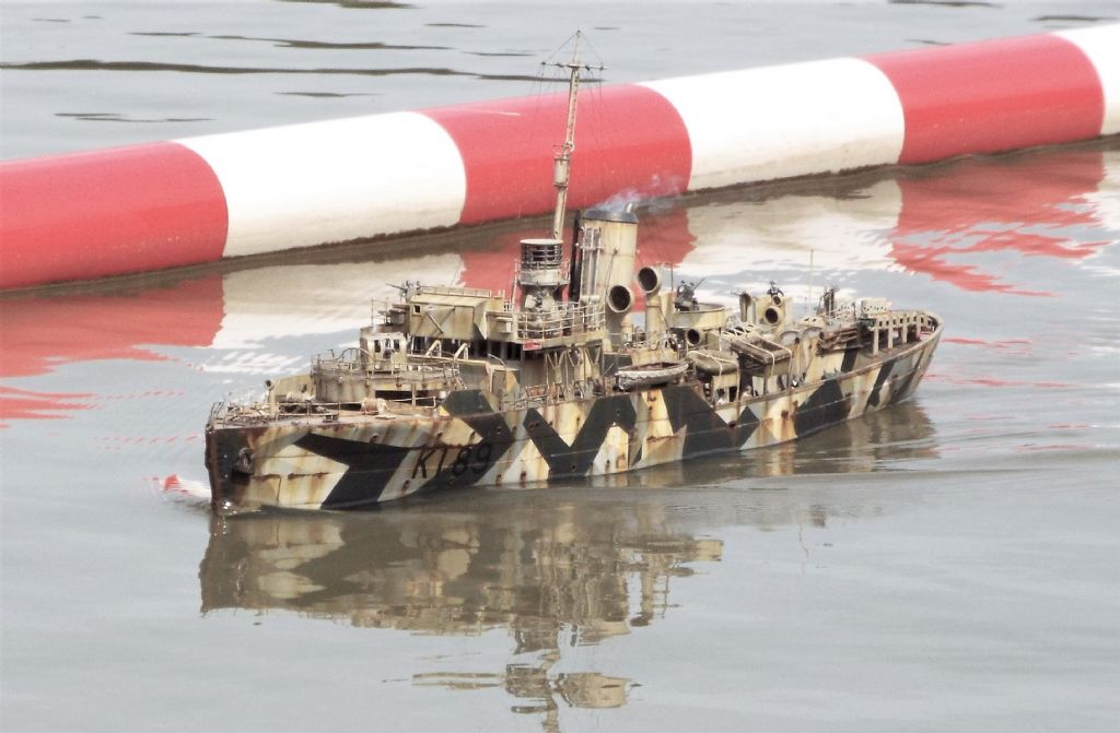

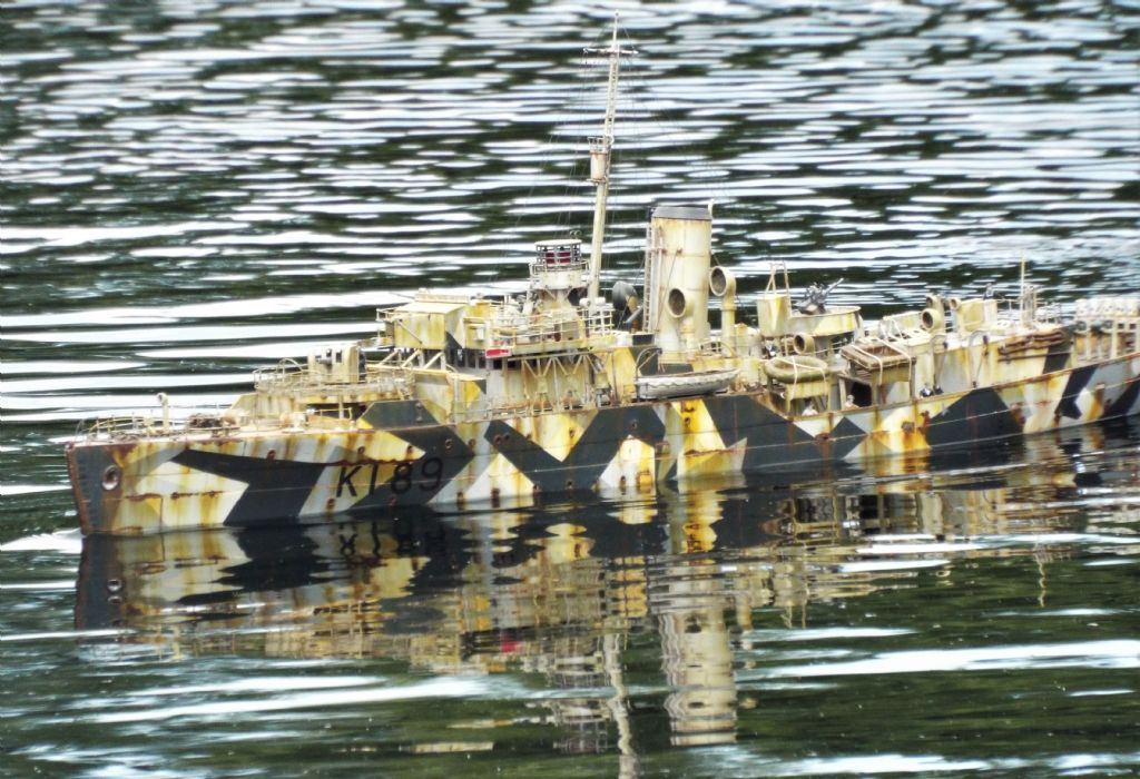

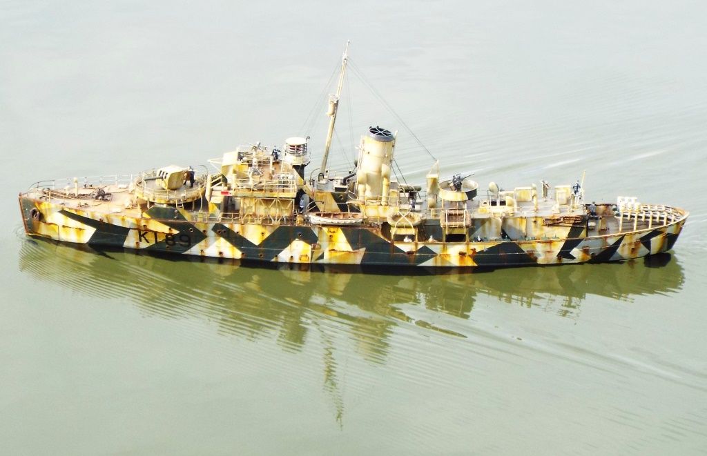

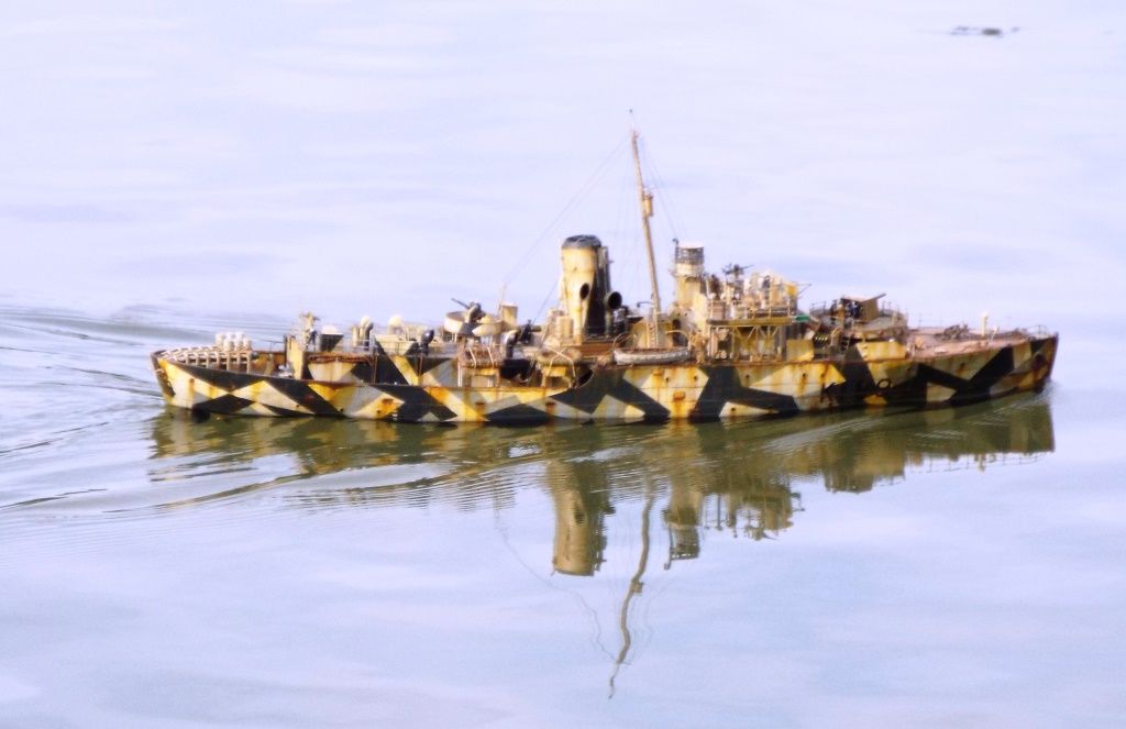

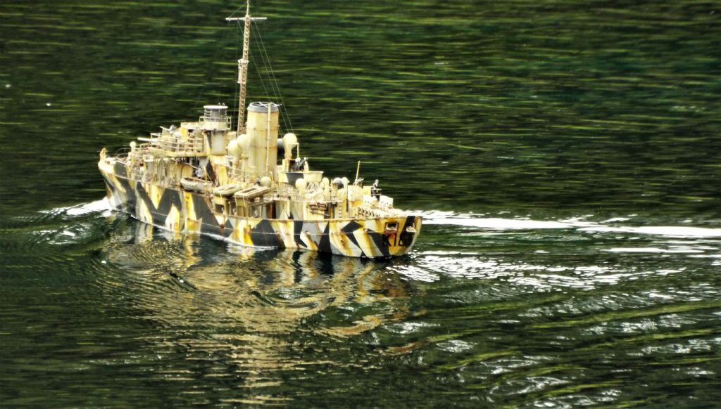

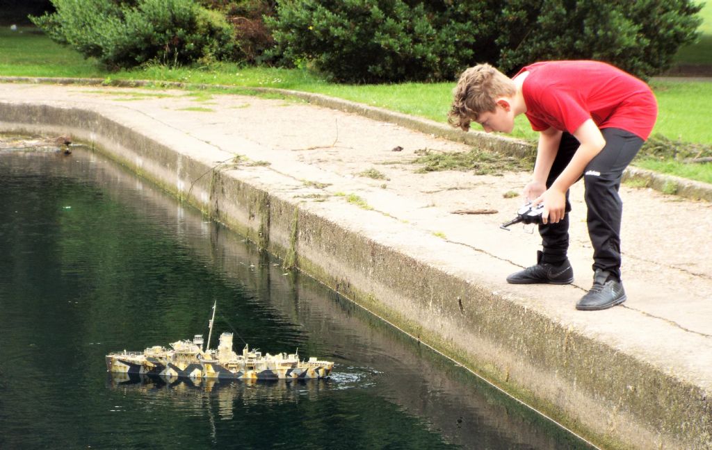

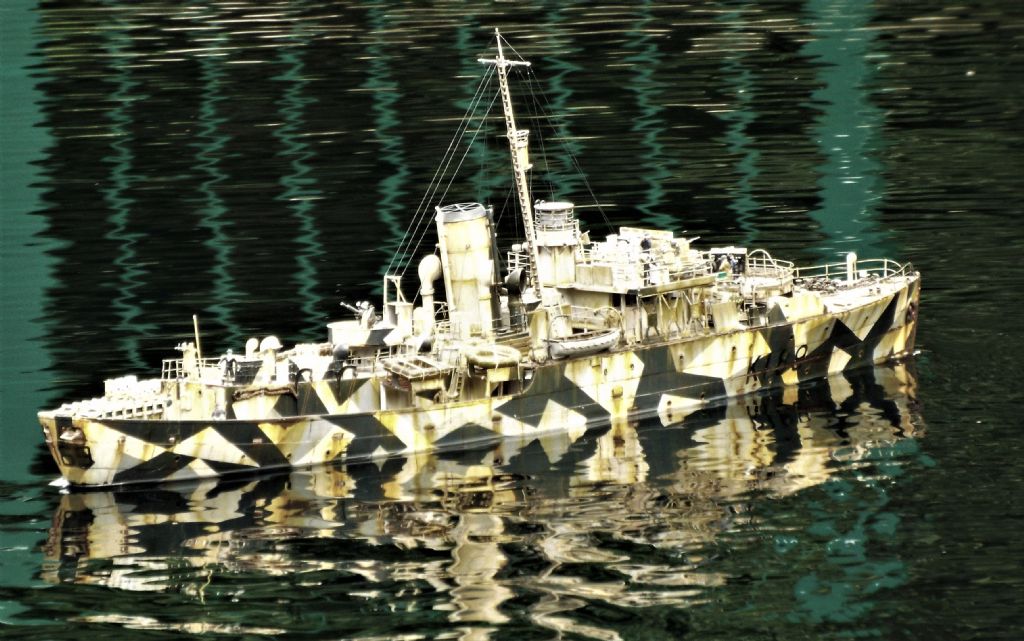

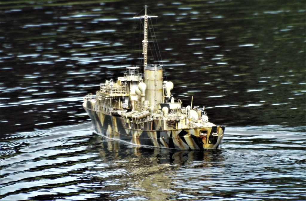

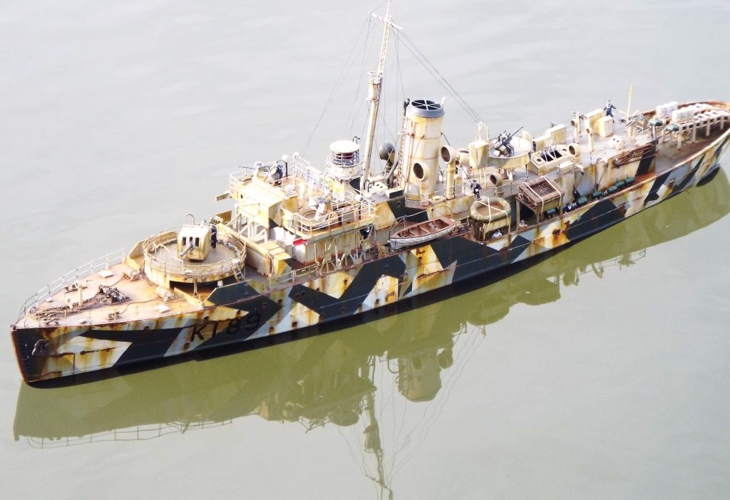

                              Finally made it to the lake.
                              Unfortunately left the bottle of smoke at home.
                              Maiden On The Lake
                              Maiden on the lake 2
                              Maiden on the lake 3
                              Edited By ojays on 10/03/2019 22:04:15
                              #81609
                              Malcolm Frary
                                @malcolmfrary95515
                                Looking good – be careful of that camo scheme, mine has the "as instructions" Wester Approaches paint job and has a tendency to hide on dappled water in flat light.

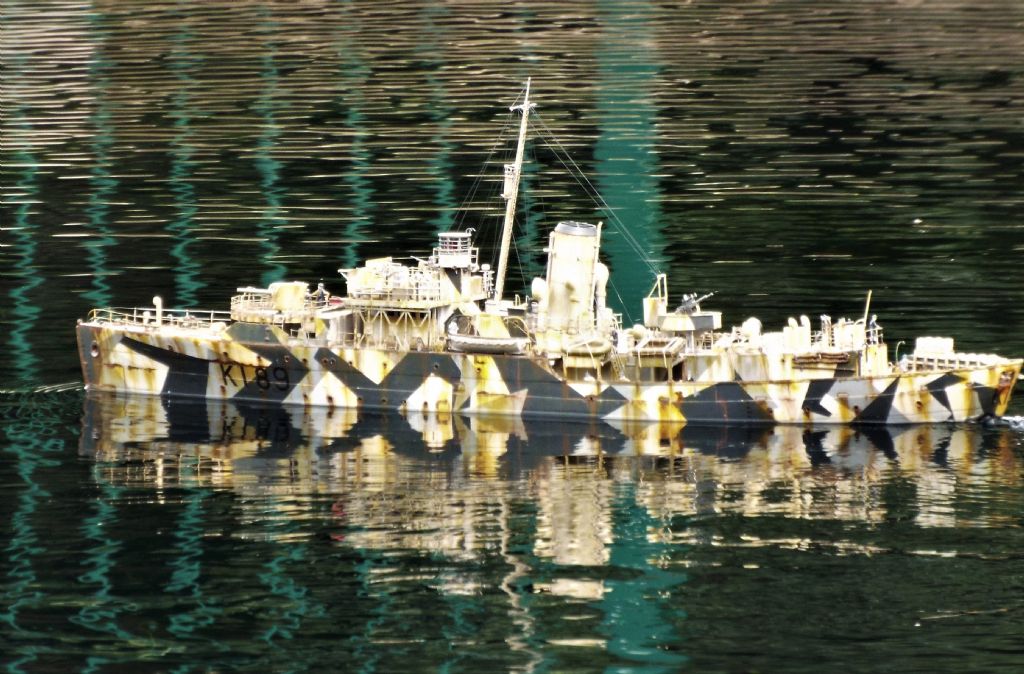

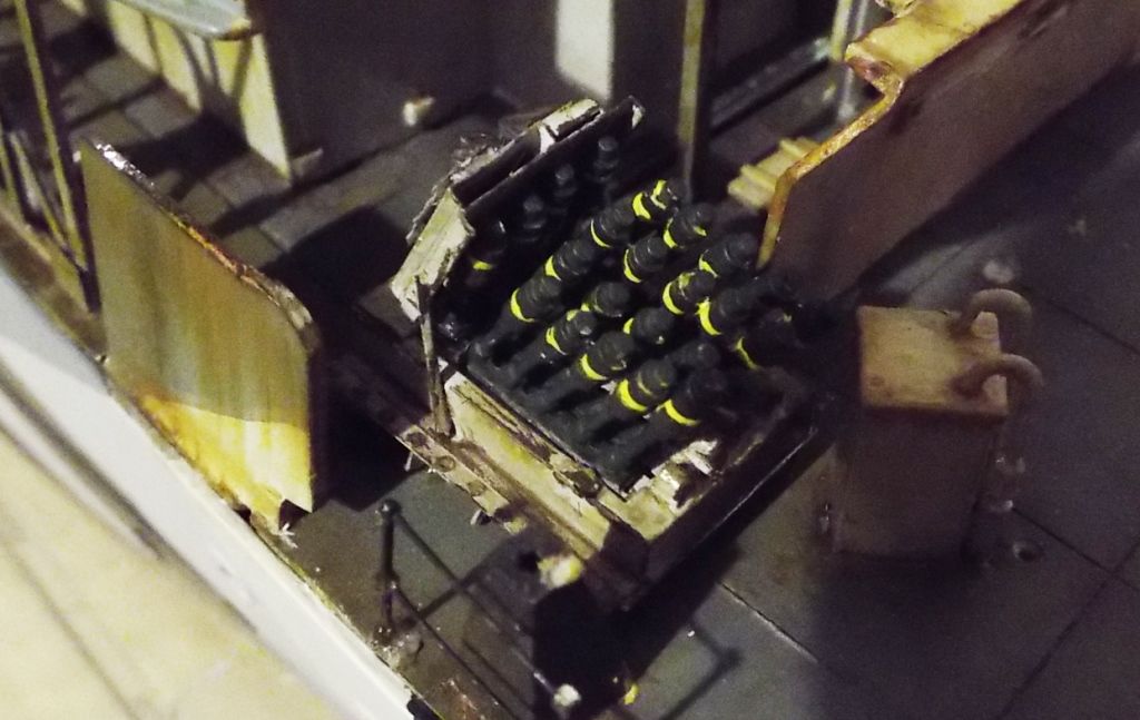

                                  Some more up to date pics.
                                  Edited By ojays on 22/08/2019 23:58:08
                                  Edited By ojays on 23/08/2019 00:00:54
