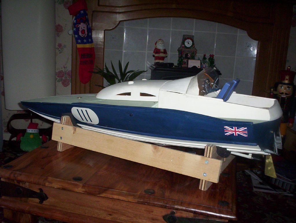

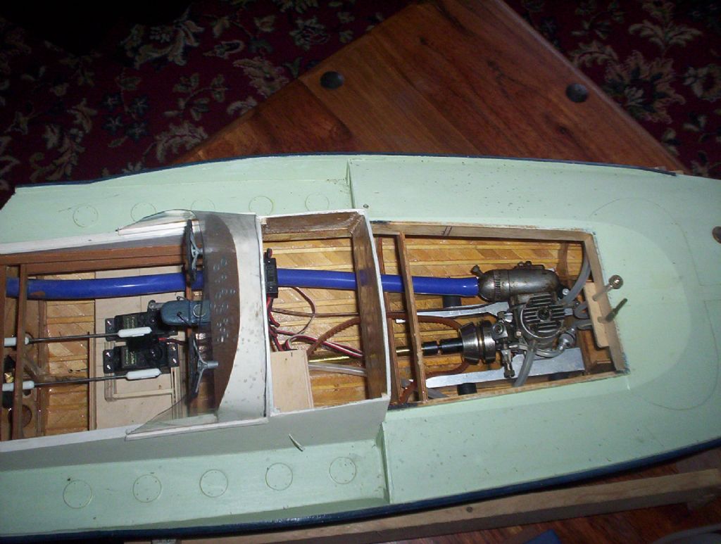

          hi there
          I also built this model many moons ago. My version was I.C. powered by an Enya 19 glow. The problem with the Surfury model is that it was basically designed to go 'fast' in a straight line. It doesn't like cornering very well and anything below plaining speed – it is like a 'waddling duck' to say the least. I have plans to rebuild it some time in the future along with many other projects – but – I was thinking I may go for the brushless motors this time. What size, I am not sure yet. Also, I was going to go Lipo technology batteries – and this may be all new to yourself – but – if not – I would suggest this is the way you go for this type of hull.
          If you are dead certain sticking with the original motor that you have – I would be inclined to go for NiCad technology 9.6 volt and something like 5000 mAh doubled up – giving you 10 amp for longer running time. Have a look on Component shops website under ACtion they can give you a good idea of what you require for speed controllers etc.
          John
