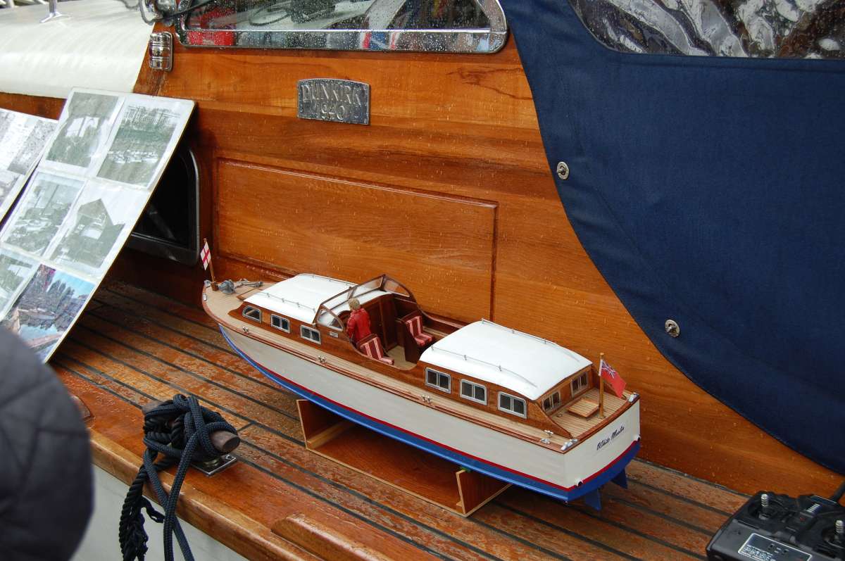

                        Hi Michael,
                        Good luck with White Marlin, my prototype model is now onboard the the real one, and I have made so many friends in the Dunkirk Little Ships Association, such a great hobby to be involved with 🙂
                        Regards RayDLS3 White Marlin Model

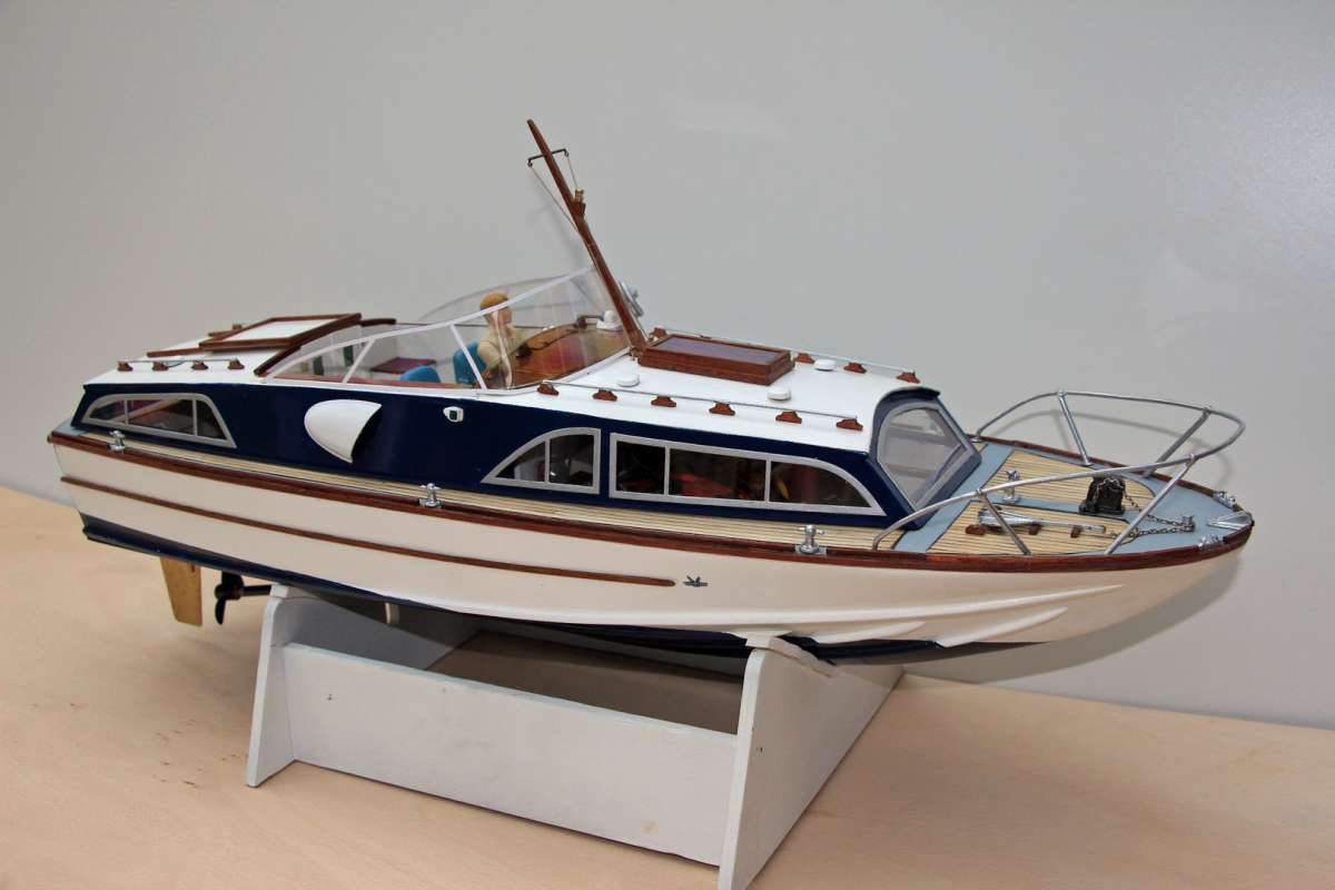

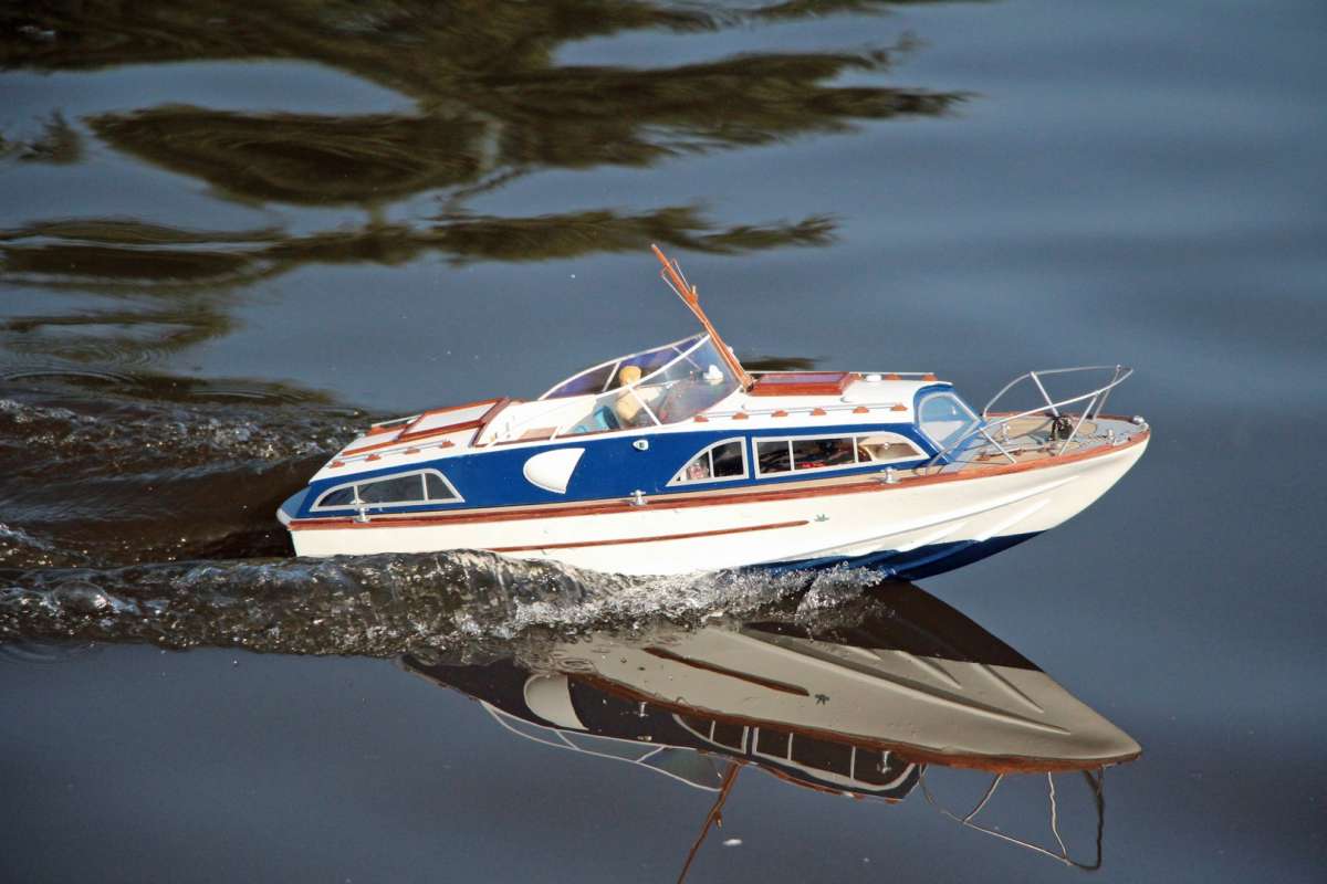

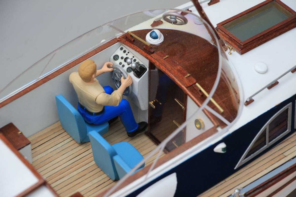

                          FinishedIMG_9544 FinishedIMG_9548 Michael,
                          Just looked at my instruction book. The list is headed ‘Materials used in the building of this model and available on the SLEC website’
                          All the glues, fillers, glass fibre, tools etc are available on the SLEC website but many of them  are not essential and just nice to have such as the Permagrit block and razor plane. While it is useful to cover the hull in GRP tissue it is not mandatory, you can just fill any blemishes or gaps, seal and paint it. If you have several plan builds under your belt then the materials, glues and tools you used for those will enable you to construct the Huntsman. Glues in particular are a personal choice. I don’t use cyano superglue as it gives me an allergic reaction, other people can’t use epoxy for the same reason.
                          The recommended two blade propeller works well but I substituted a brass one which was more expensive but looks and performs better.
                          The Huntsman kit is very cleverly designed designed and goes together extremely well but it is not simply something where you can just glue the parts together together, you do have to build it as with all other model boat kits. In fact standards do vary widely between manufacturers, SLEC are one of the best ones but the offerings from others can involve a lot of skilled work!

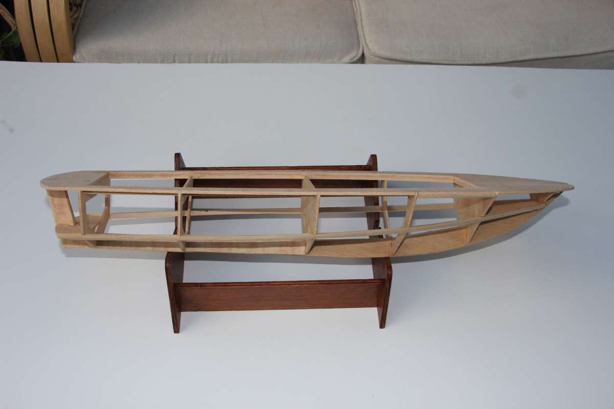

                                    Hi, building Huntsman or Swordsman boats what angle are the bulkheads or ribs set at. Slec say the bulkheads are not vertical so how are these set up. A tutorial on the model boat mayhem site puts these bulkheads as vertical using an engineering square. As this construction is unclear could someone please help clarify.
                                    Kind regards Michael.
                                    #120751
                                      Michael,
                                      I built both the review Huntsman and Swordsman kits for the magazine. The frames are not vertical. The relevant part of the instructions reads:
                                      Now slot each of the frames 9-14 into the keel; position this assembly on the deck and glue each of the frames in turn to the deck and keel. Add the transom former 15 across the back of frame 14 (Pic#12). NOTE The frames are NOT at 90 degrees to the deck.
                                      These kits are very accurately engineered and when you slot the respective pieces together everything self aligns. It is very clever. In fact, one method of glueing is to clip all the pieces together and you have a self supporting and correctly aligned structure. Then run Deluxe materials Superphatic glue along all the joins where it ‘wicks in’.
                                      Due to the accuracy, it is essential to follow the instructions exactly or you will be in trouble. All the information is there in the Building and Picture Instructions but not everyone reads them! Big mistake!
