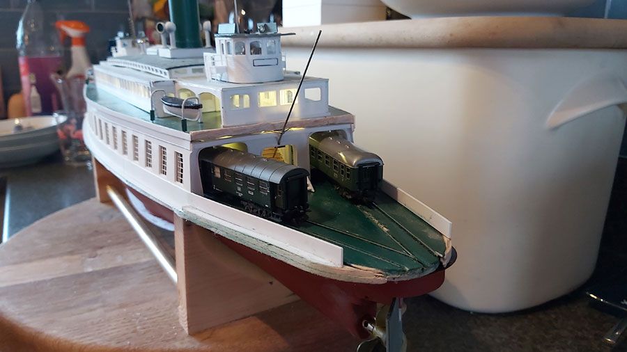

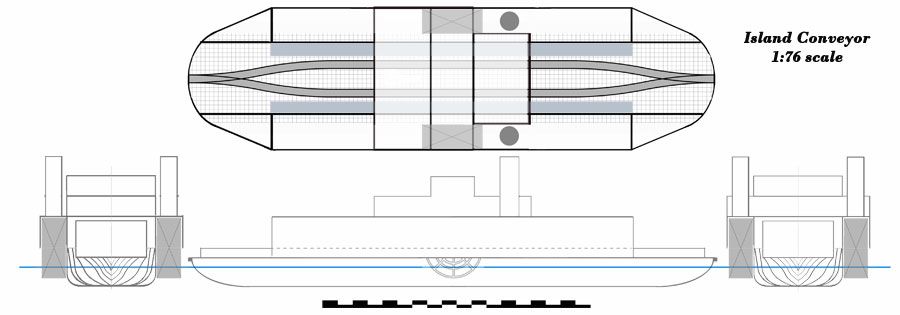

      So a while ago I had this daft idea of building a train ferry. Logical because I like trains and I like boats….
      My original idea was something like this:island-conveyor.jpg
      and this is what I have several months down the line.
      It's purely freelance and I've no idea if it's even viable as a boat but I've enjoyed building it so far.
      BTW. It's just under a metre in length and it's 1/87 scale(ish) so that I could take full advantage of HO scale model railway accessories – cheap off Ebay. It seems no-one in UK is really interested in HO.

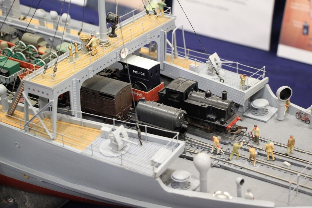

                  There are two WW1 military rail ferries around. One was indeed built by Nick Brown's Dad and I saw it at Wicksteed and Warwick. The other, Admiralty Train Ferry No. 3, appeared on the Portsmouth Model Boat Display Team stand at the Midhurst Modelling show and is pictured below.

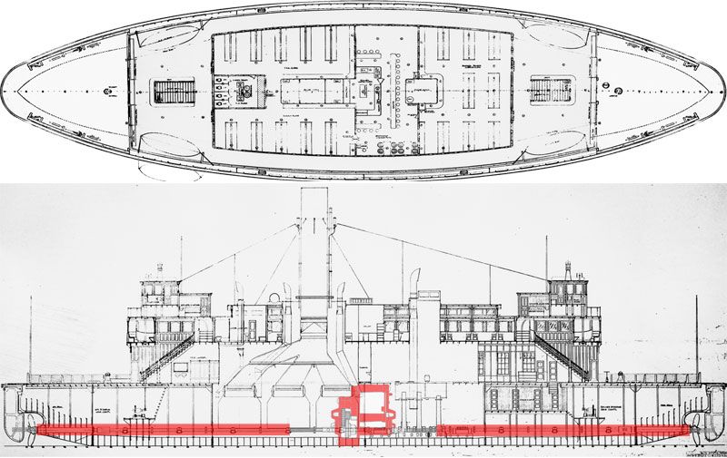

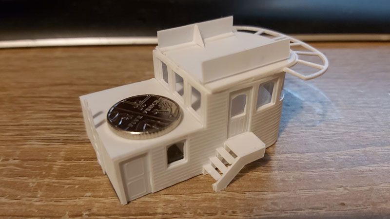

                        So HMS Block of Flats is now officially on a back burner. I have a more exciting project to work on.

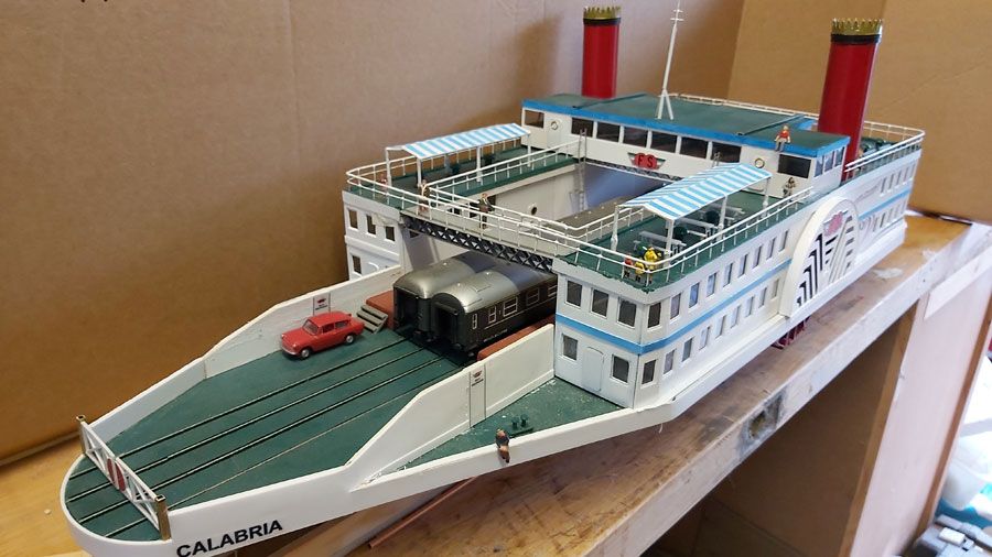

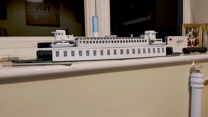

                        Someone mentioned a N gauge railway ferry? Well here it is (so far)
                        Closely based on this:
                        This is what I have so far:
                        It's been fun designing all the various parts, cutting them from 20 thou styrene then assembling them. This is about a weeks work using nothing more than a few photos and this plan.
                        When finished, the boat will be loaded with 6 DB/CIWL carriages depicting the fictitious vessel Fehmarn operating the Germany-Denmark crossing out of Travemunde on the Baltic coast.

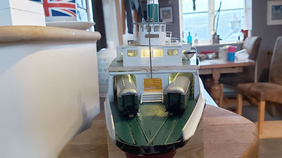

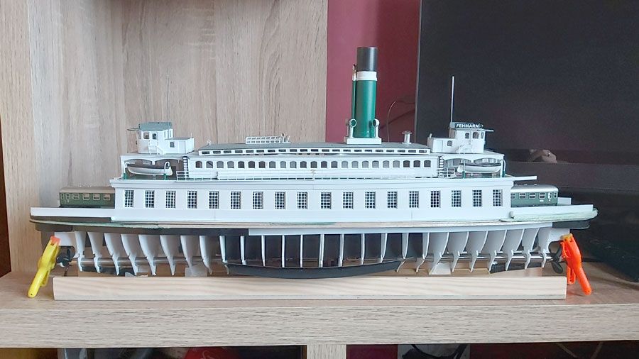

                                          So after a month of apparent inaction, a progress report.
                                          A slight miscalculation on my part regarding the dimensions of the motor/gearbox assembly has meant that I've had to increase the draught of the ship, resulting in it looking a bit 'fat' under the waterline.
                                          Oh well. It can't be helped and it's too late to do anything about it now and anyway, as I said, it's below the waterline so I can't see it.
                                          The steering assembly's been a bit of a mare too. For simplicity and convenience I've decided to operate both rudders from one servo. This means that I have to cross the cables or rods(haven't decided which yet) in order for the rudders to operate in synch. To top it all, I have less than 10mm of space to play with due to the positioning of the rudders and the train deck (where the pegs are).
                                          BUT…..
                                          It's getting there. Slowly.
                                          #85169
                                            Great work Andrew. Would not worry about fatness under water (all those Christmas feasts) as this will give you more leeway with the ballasting and in addition make the boat a bit heavier which always gives a better on-the-water look.
                                            #85362
                                            Andy F
                                              @andyf73386

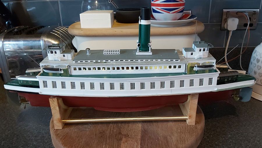

                                              I've finally got the hull more or less finished, even built myself a little stand to but the boat on.
                                              I need a slight re-think on the gearbox though. I think I overdid it a bit with the fibreglass resin I used to seal the inside and it doesn't sit right any more.
                                              Problems problems crook
                                              Lots more to do on it but it's still getting there… slowly.
