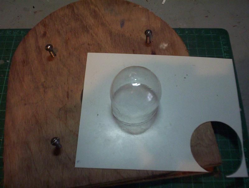

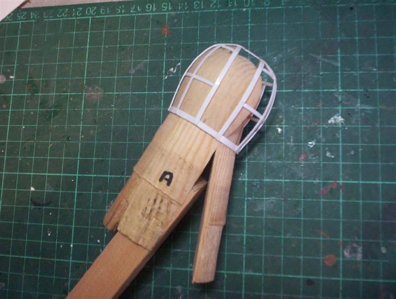

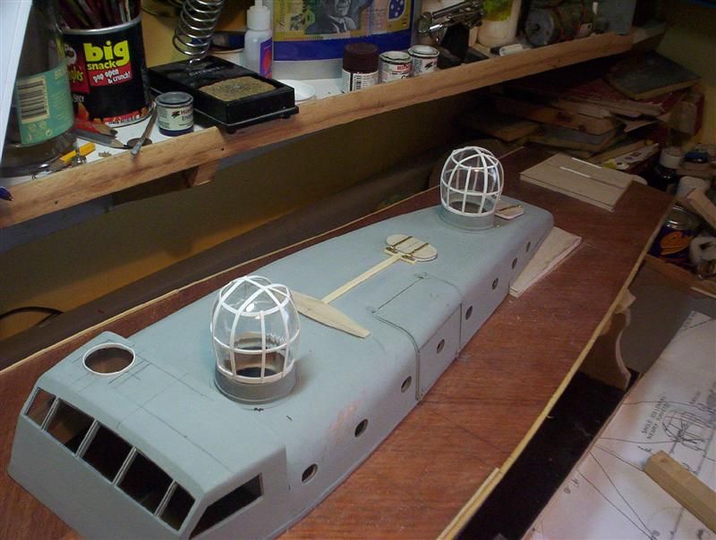

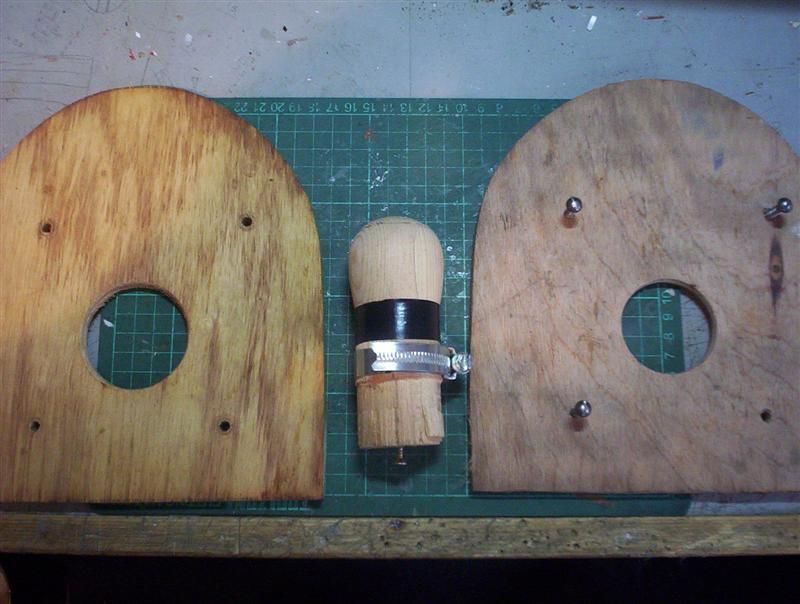

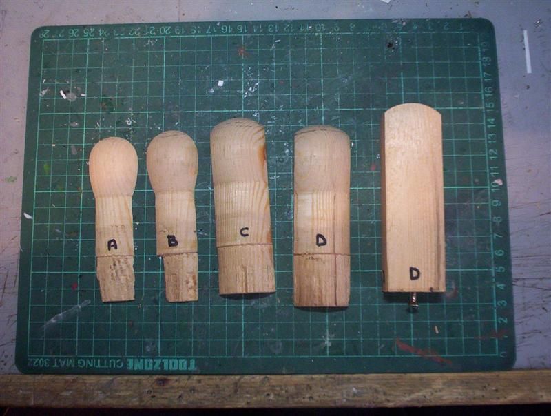

                          The method I used to create these gun turrets is fully explained on Mayhem on the build I did on there of the 63ft Whaleback launch – but here are a couple of pics to give you the idea. It was done in an oven to warm the clear plastic up and then I pushed the mould into the soft plastic to create the shape of the gun turret. It took one or two attempts but in my opinion it looks far superior than a lightbulb painted.
