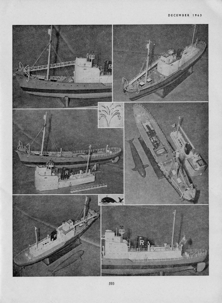

          Here is the article Trevor.
          (To enlarge click on the photo, when it opens click again.)
          Wishing you every success with the build.

              Hi Trevor, Tony has beaten me too it with the article, I've still got mine because it was the second model I built when I was 12 years old. mine didn't win any prizes but I was very inexperienced and I didn't take to gum strip finishes either.
              Two points that might interest you, the hull is small and best built light so you can get some ballast right in the bottom, otherwise it will be very tender. If bulding it again would plank with .8 mm ply and if I do I would enlarge it to 36 or even 48 inches, it will be more seaworthy.
