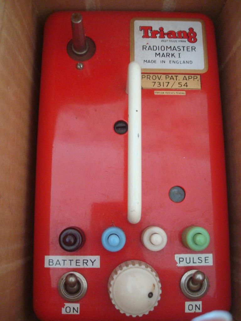

              Your info has been most helpful, thank you. One other question:- Would you know the purpose of the various knobs/switches on the TX box?

                You've grown up in the era of radio affected modelswink, so I'm sure you'll know the downfalls of old gear.
                The transmitter was the radiomaster, here is a picture that should help.
                Being an old school pulse system of the mark / space type, the four buttons are just left , right and motor control. The round knob is for control adjustment, the arial is sectional an should just slot together. and I think the rest is obvious.

                  Hello again Charles. All is understood.
                  You have been more than helpful, cannot thank you enough,
